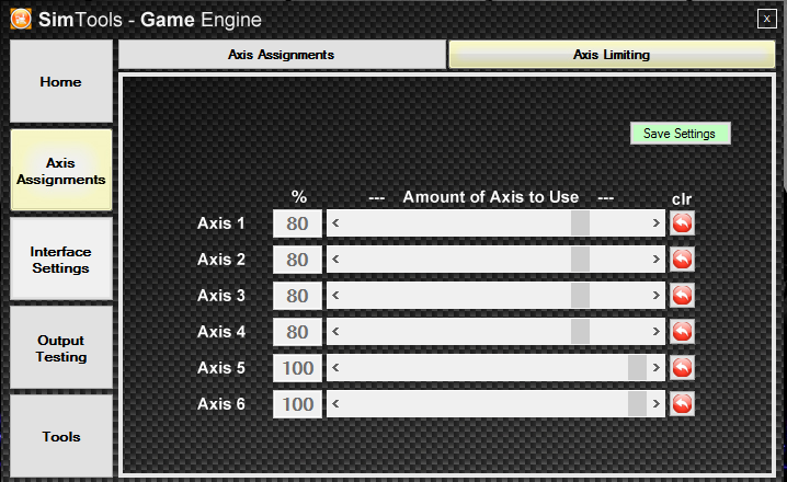

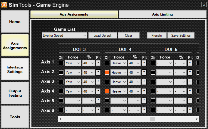

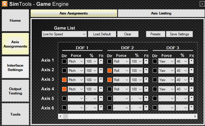

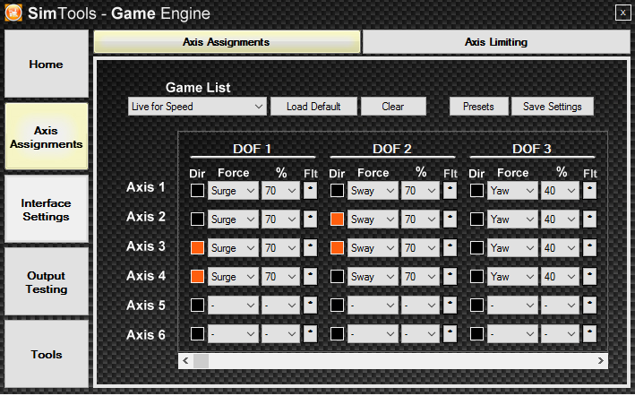

    I followed the instructions in the Documentation section. Now the problem is, movements of the 4DOF model dont suit to the acting forces form the game (LFS). But when i move the model manually through the output testing, everything works how it should. Also when turning off the mini servos move to an bad position, how can i solve this?

    It would help if you posted pictures of all of your settings.

    Yes of course, here are the pictures, the rest is on the default settings.

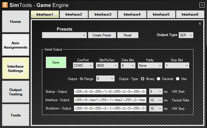

    What code and hardware are you using?
    The Interface Settings look to be like some mixture between JRKs and Arduino settings, with unneeded options.

    Can we get a pic of the sim, the axis assignments setting seems strange.

    I am presuming these from @eaorobbie: https://www.xsimulator.net/community/threads/problem-with-pololu-micro-maestro.4920/#post-47686
    You have too high an Axel Assignment percentage total: https://www.xsimulator.net/community/faq/axis-assignment-percentage-totals.120/
    Axis DIR settings should have movement following these conventions: https://www.xsimulator.net/community/faq/which-way-to-set-simtool-axis-movements.230/
    What path did you use to patch LFS?
    Does Game Manager turn blue and say Connected when LFS is running?
    Did you run LFS and do a couple of laps before patching? If not then unpatch, run some laps and then repatch.

    Your axis assignments don't make a lot of sense to me.
    But I would have to see the sim to tell you for sure.

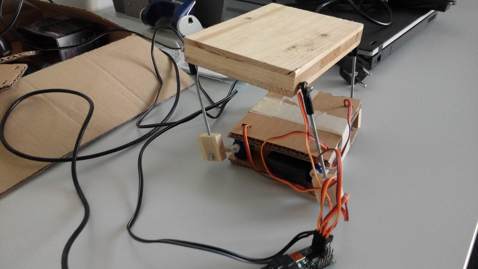

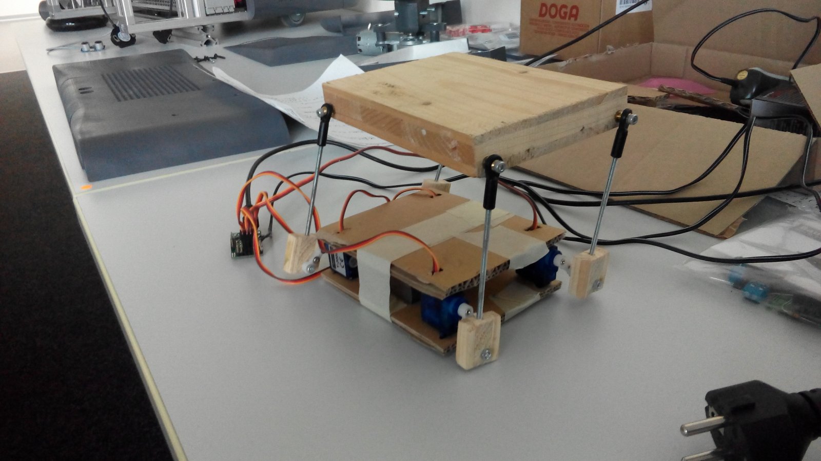

    @yobuddy , these are the pictures of the model:

    @JohannesNicklas
    That model does not look very stable, does it stand pretty stiff when not in use?

    @yobuddy The model stands not quite stiff, but its only for tests because we have to make a hexapod too.

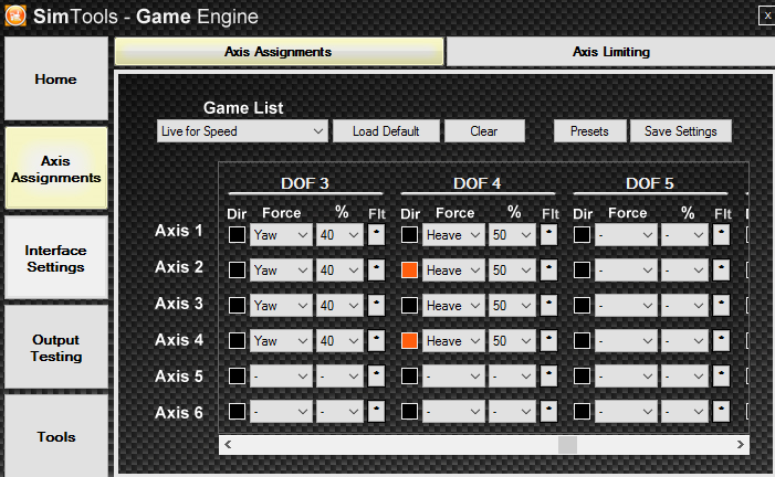

    I was setting up the PC newly and installed all softwares. I confused roll/pitch with surge/sway. Now the axis can be driven seperately and heave and yaw work fine. The only thing is, that surge and sway ar interchanged, maybe I have only a fallacy^^. And the problem is even, that the sim makes an uncontrolled movement instead of standing still,when turning off

    It's just a bit confusing as it looks like if you were to sit on it, it would just fall over?

    Construction is not the most stable, but adequate for the purposes.
    I am only responsible for the control, the construction of the real sim is someone else part.

    If it were to be built full size it would be very dangerous. :D
