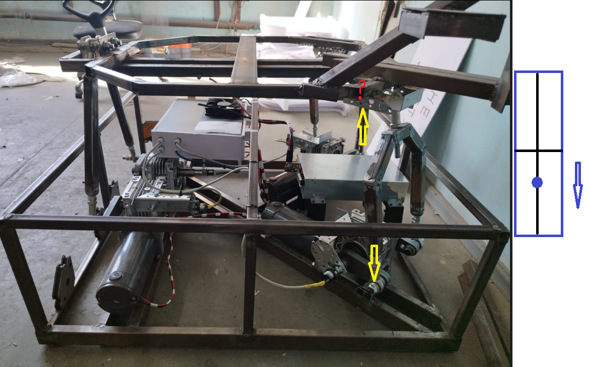

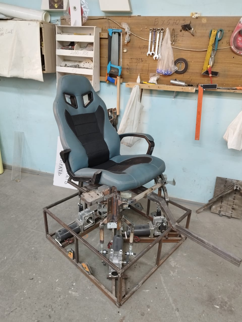

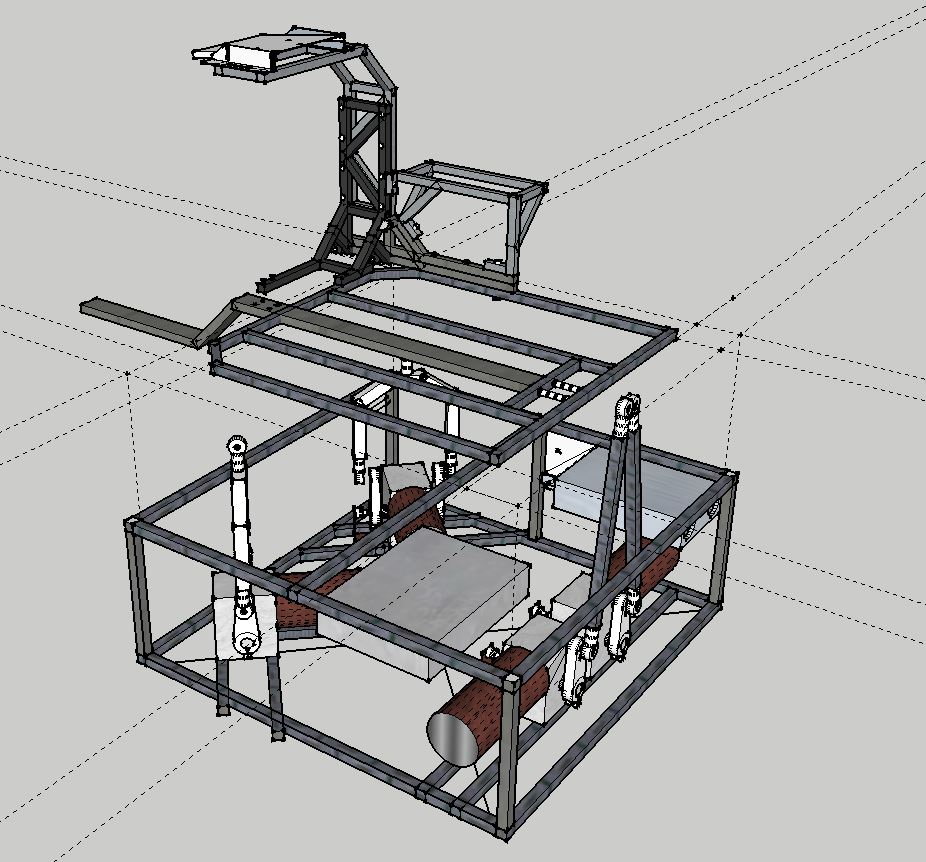

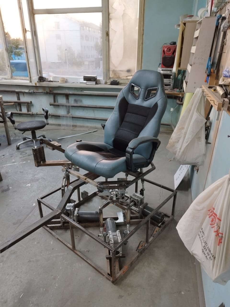

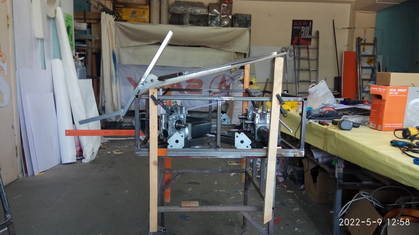

    Hi all!
    I would like to introduce myself, my name is Victor. Was boring and I decided to design and build a mobile platform for myself. At the moment, I have built an almost completed frame of the platform. Temporarily used an office chair for fitting and general understanding.
    Below is some description and photos.
    Components:
    SMC3utils
    SimTools
    Arduino UNO *2pcs
    Hall sensors *4pcs
    Motor drivers (X bridges)
    Used 4 motors 300W 24V with gears 50:1 300W.
    Power supply 24V 2500W. mains supply 220V

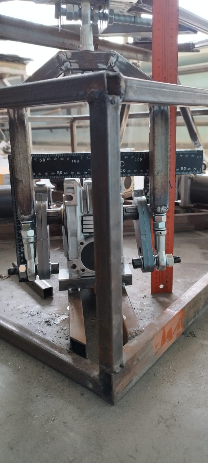

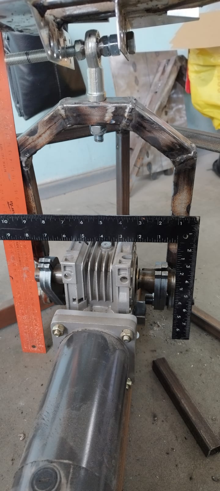

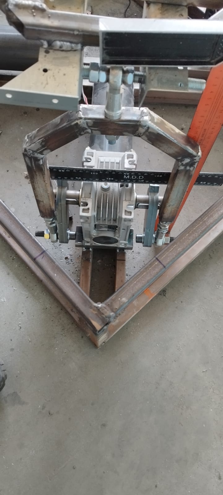

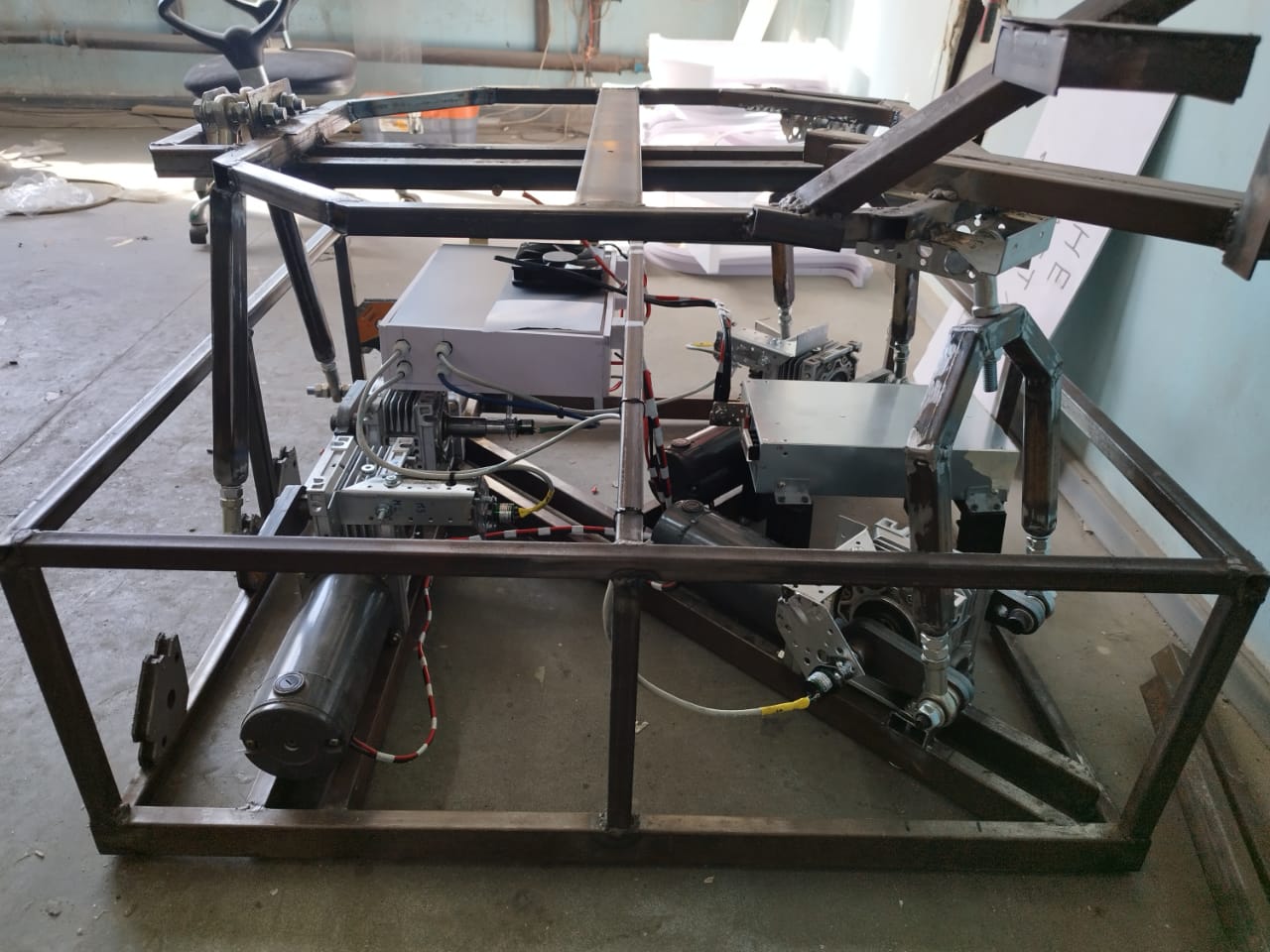

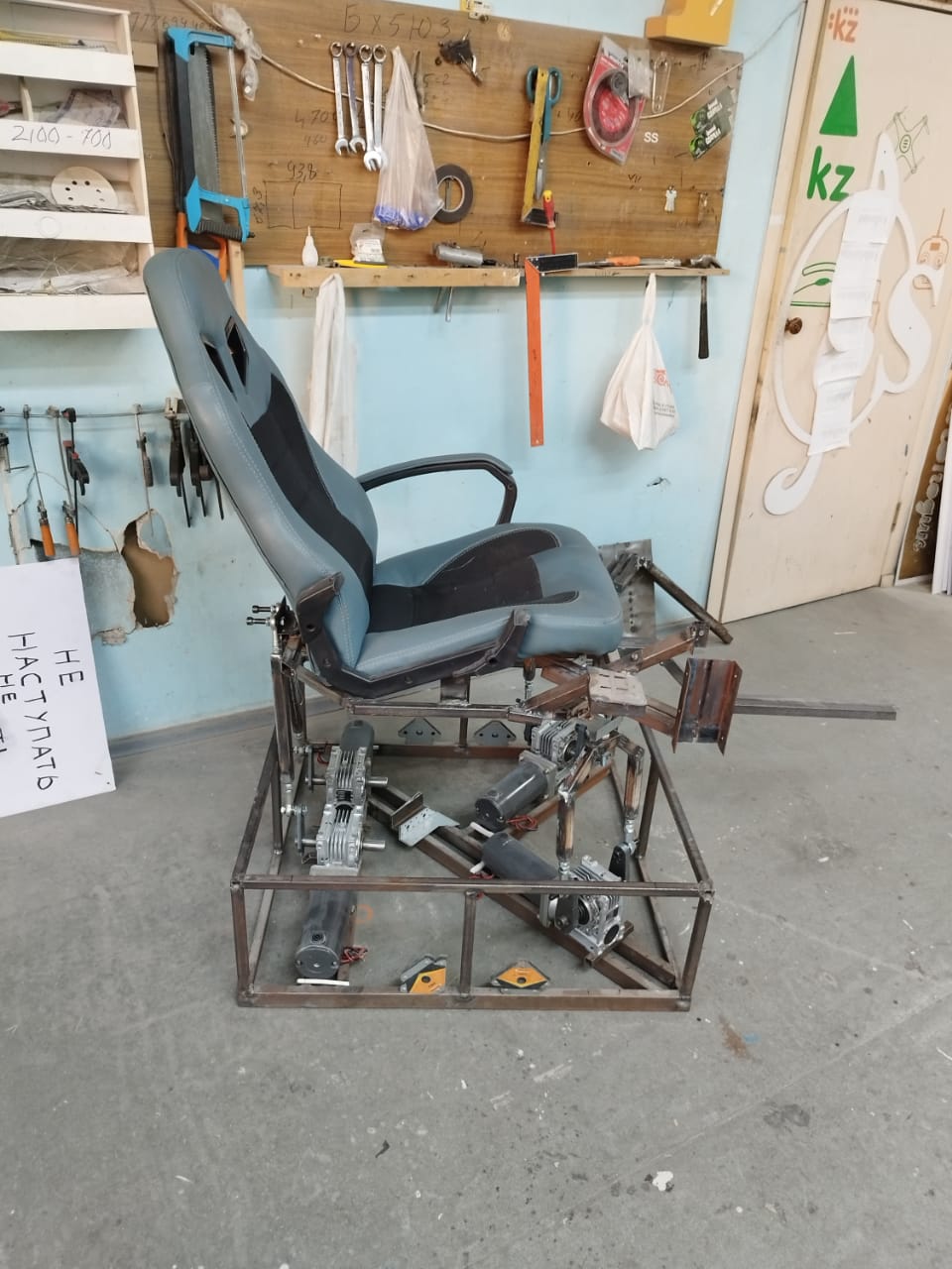

    I assembled all the components of the platform the other day, I decided to check whether everything moves without distortions, etc. And on the front levers I noticed that they touch the reactive levers.
    Eh, I'll have to make the levers wider.
    I plan to mount the Hall sensors directly on the gearbox shaft, but have not yet decided how, I think through helical gears or through a belt drive.
    Or maybe restrict the lever movement programmatically?

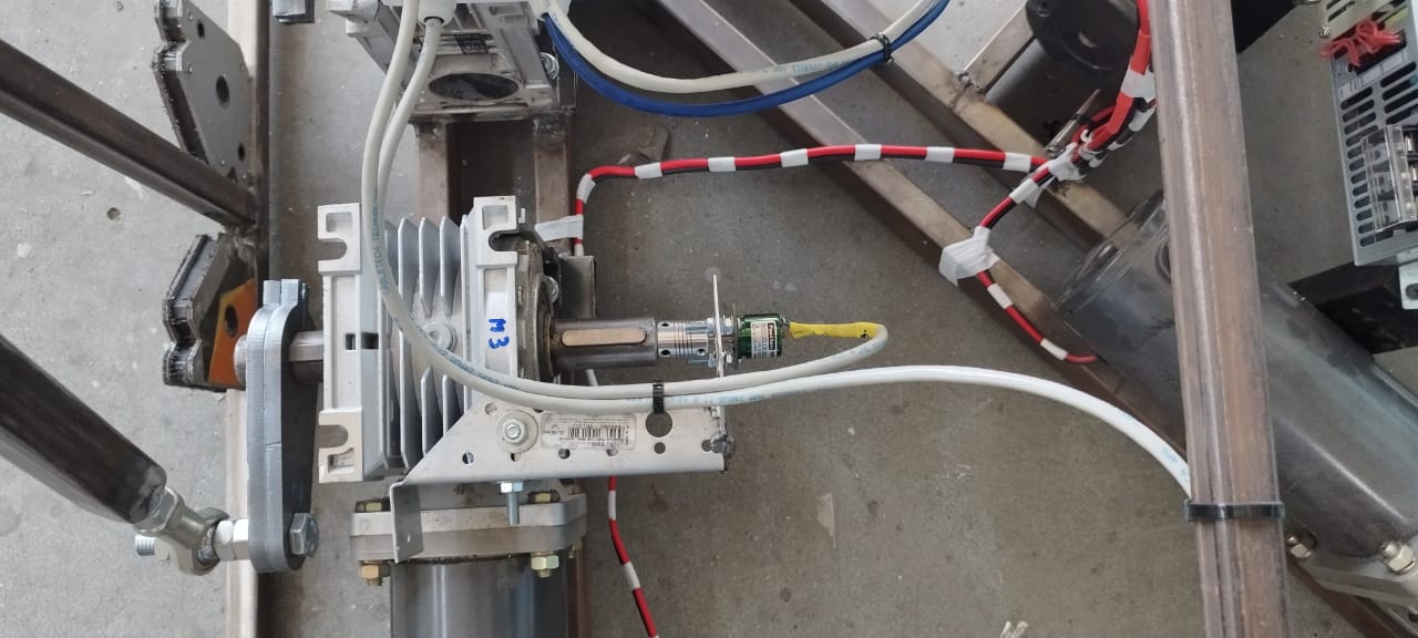

    Hall sensors, power supply installed. It remains to connect all this and you can make the first start.
    I also received a DIY License SimTools v2 Edition. As soon as I launch everything, I will purchase the Pro version.

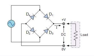

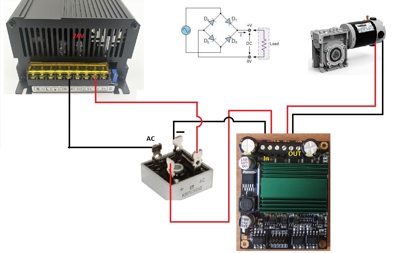

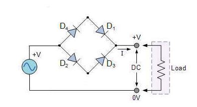

    Following the diagram, I drew connections, added another capacitor, but I'm not sure which is right.
    If I supply + and - to the diode bridge from the power supply, then what will be on the AC contacts of the diode bridge?
    In theory, a diode bridge from a constant makes alternating current, something I'm completely confused :(:grin
    Perhaps I need to connect contacts to the AC from the power supply, and already output + and - to the driver as expected?
  12. Gadget999
    1,959
    11,983Coins
    +484 / 10 / -0
    A bridge rectifier converts AC to Dc
    Your power supply already has one inside
    What you need is 2 diodes
    One to protect the positive terminal from reverse voltage
    And one on the negative terminal to protect reverse voltage
    Are you sure you need diodes ? The power supply may be ok

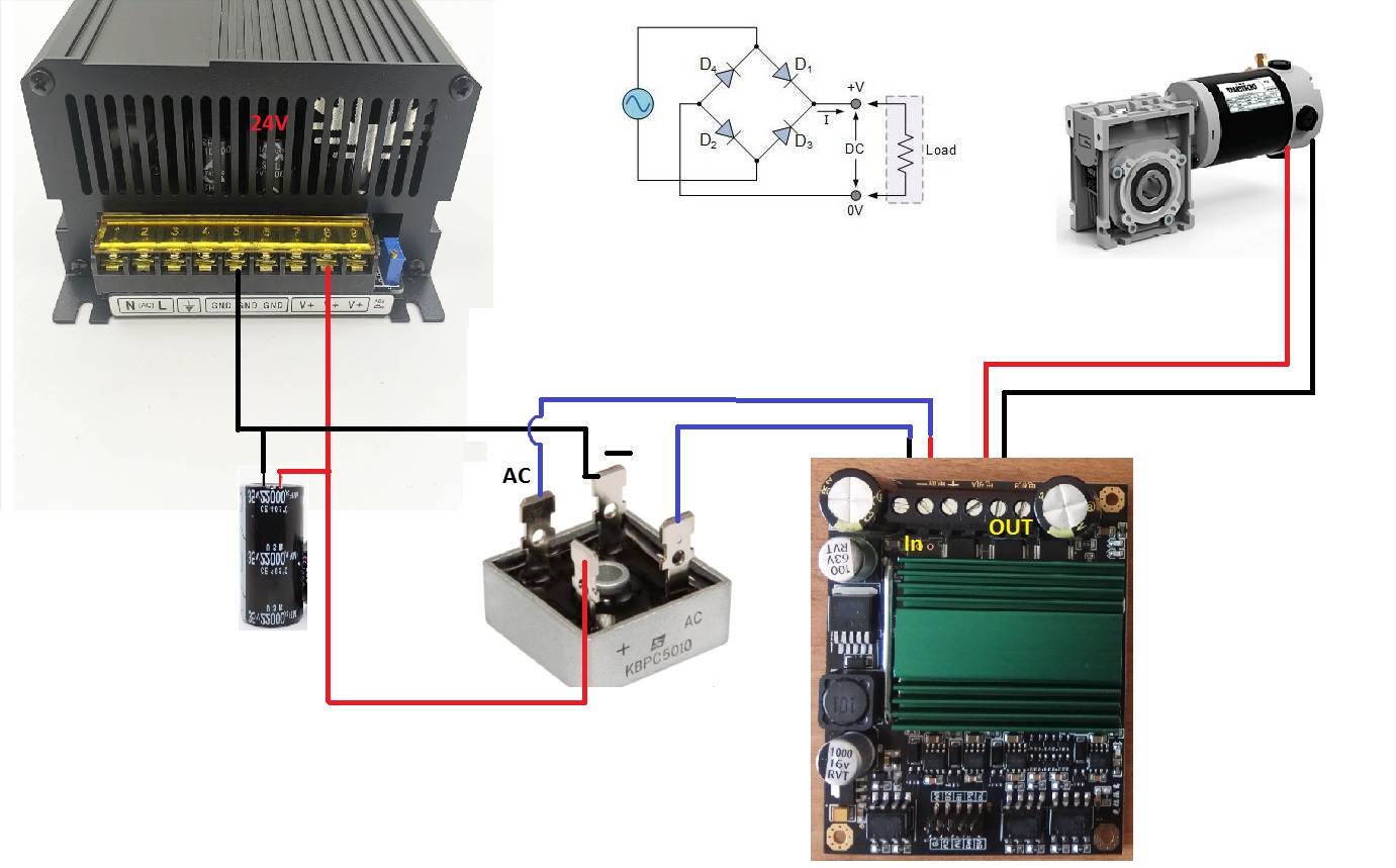

    Thank you for your recommendations. I found a post where they used bridge diodes and this helped solve the problem of regenerative energy from motors https://www.xsimulator.net/communit...mms-and-arduinos-osw.6948/page-31#post-117116
    Therefore, I decided to do the same for myself, but from the information received I got confused about what to connect where:)

    So I think it will be right, now if someone else confirmed this:

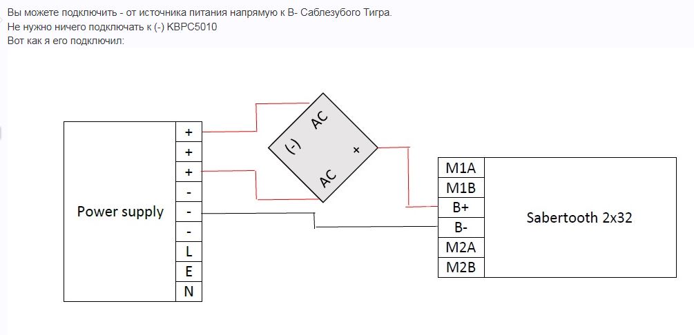

    In general, after the research, I found three options, two from @BlazinH and one from @Pino Pistolidas, all three work according to the authors.
    That's why I'm thinking about which one I'll use.
    The only confusing thing about the Pino Pistolidas example - is that using both AC terminals doubles the current.

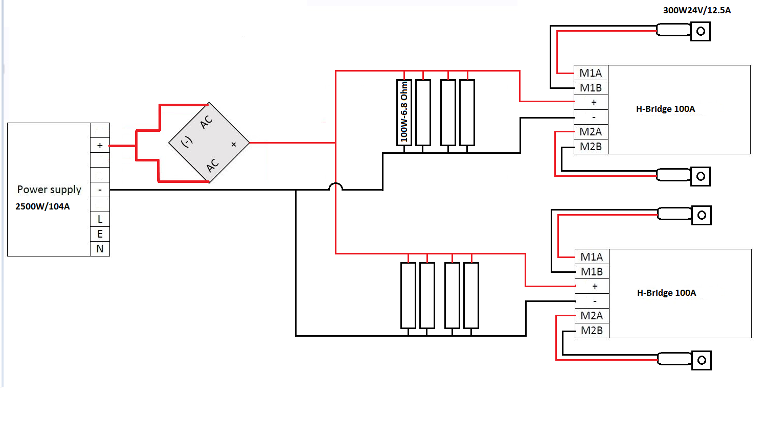

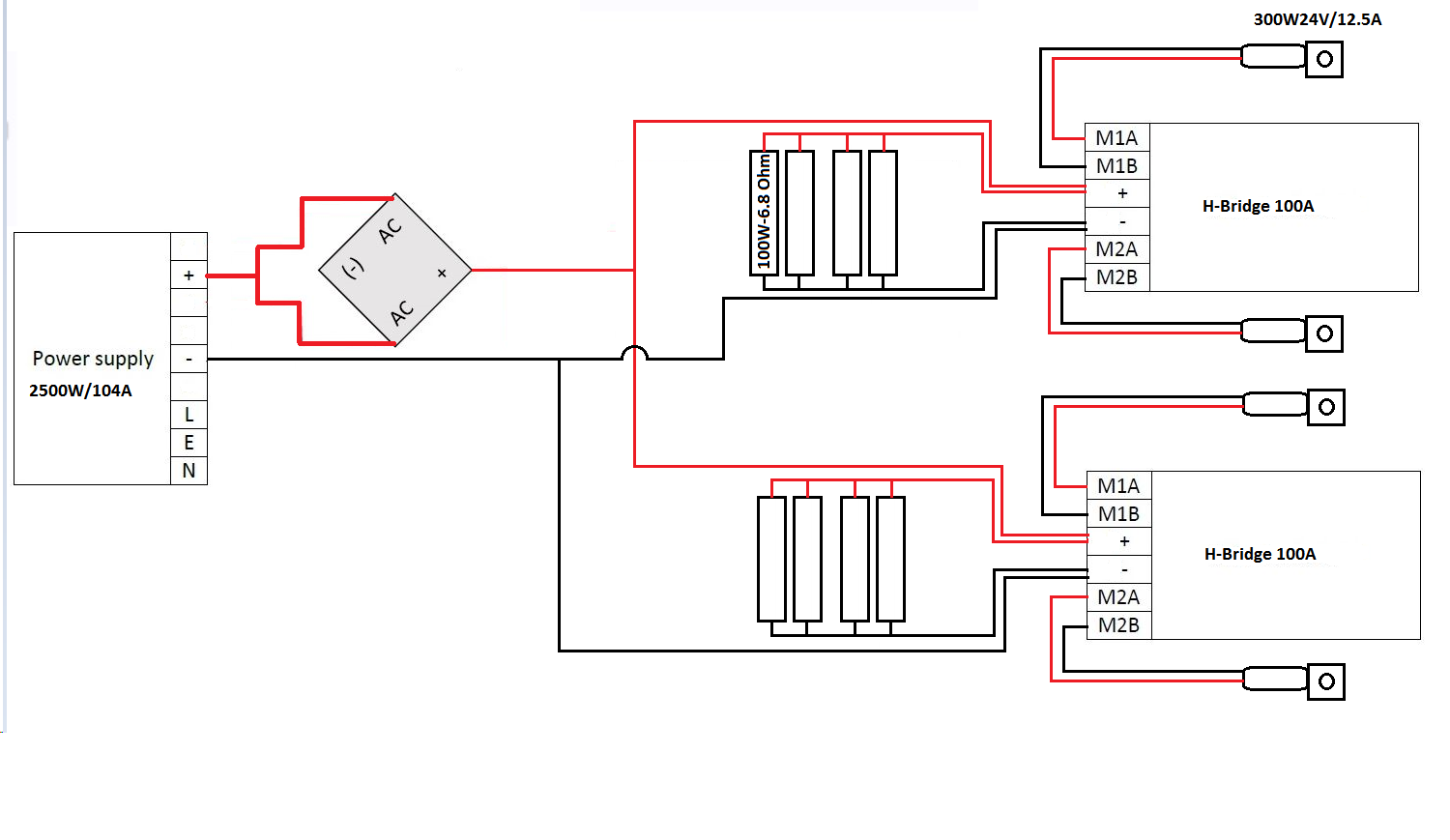

    So, I figured out the diode bridge, but how to connect the resistors?
    I made a diagram, who can tell if it is correct for my case?
