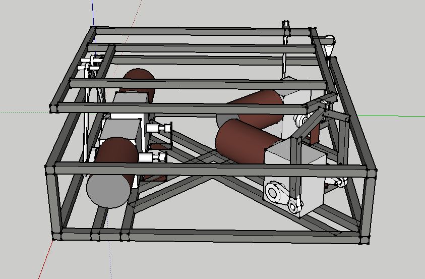

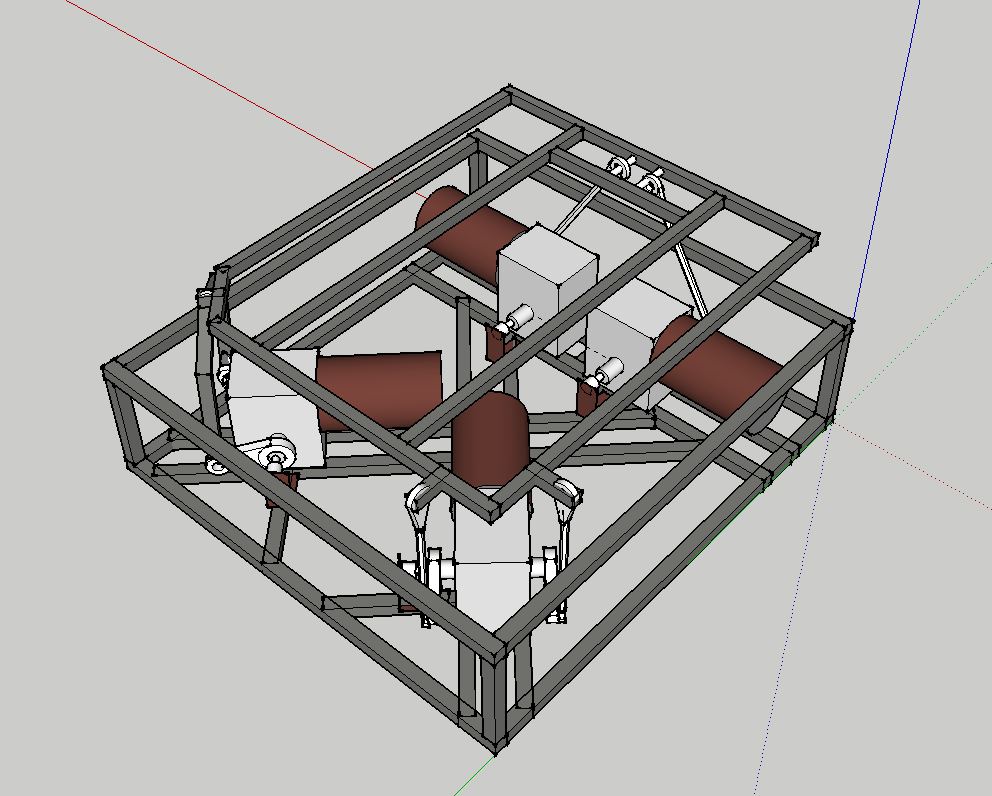

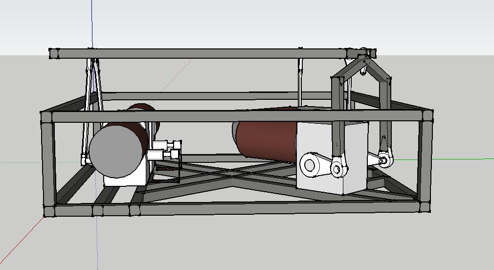

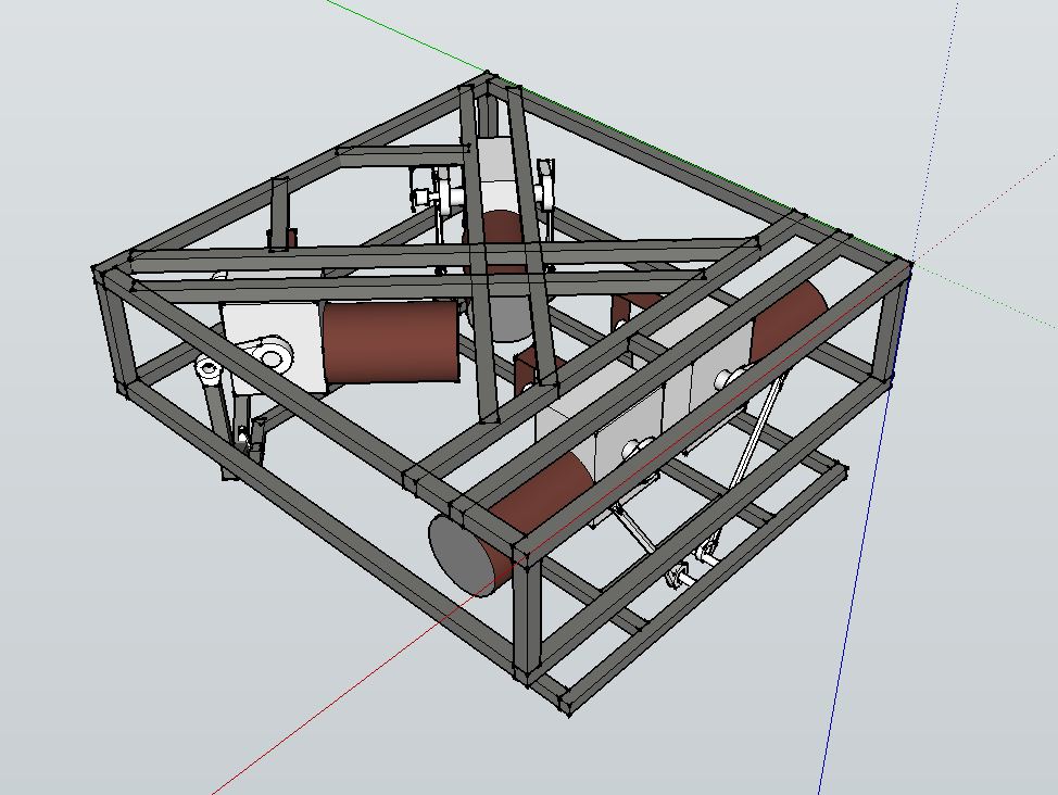

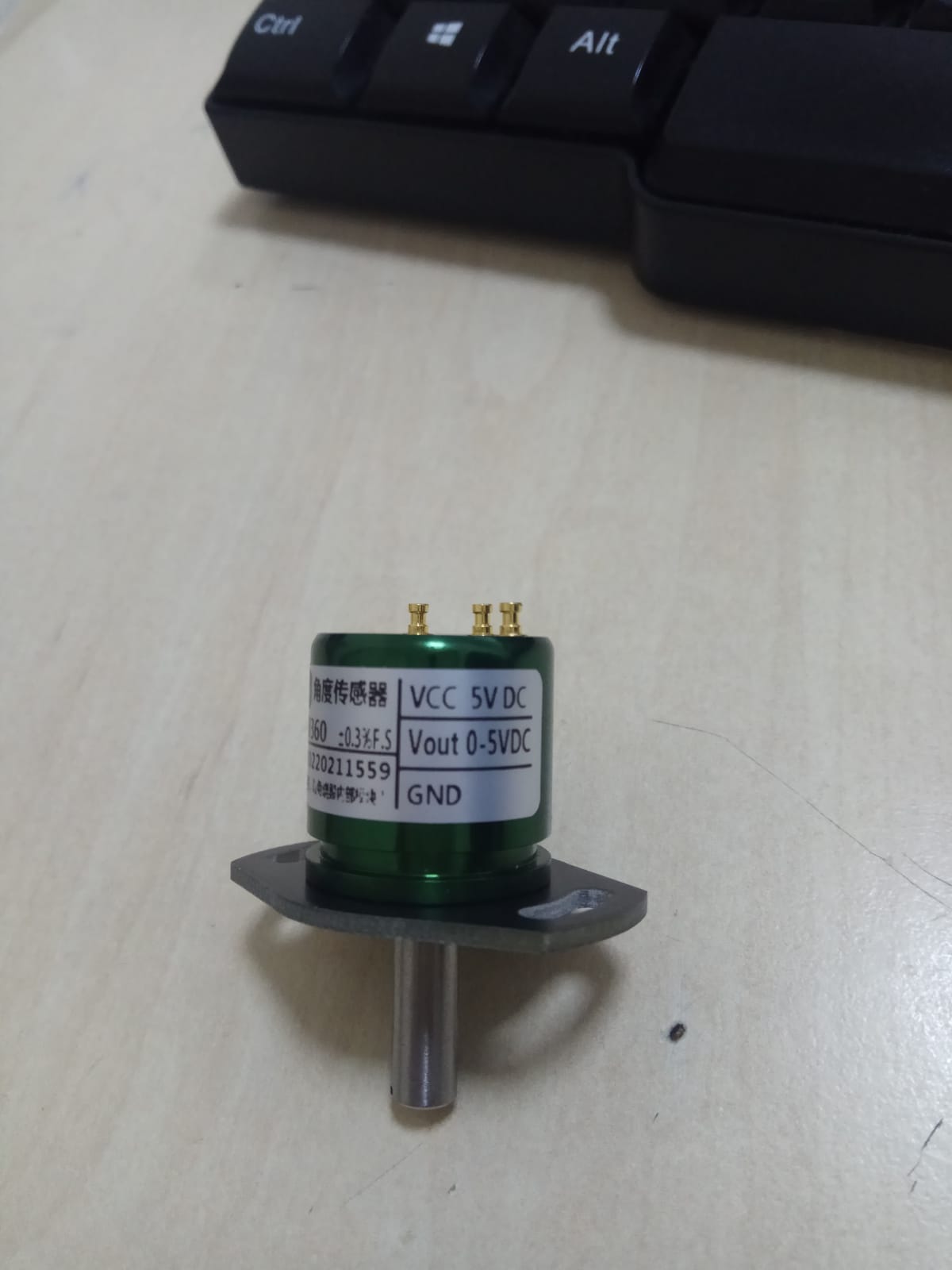

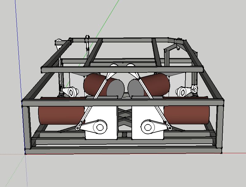

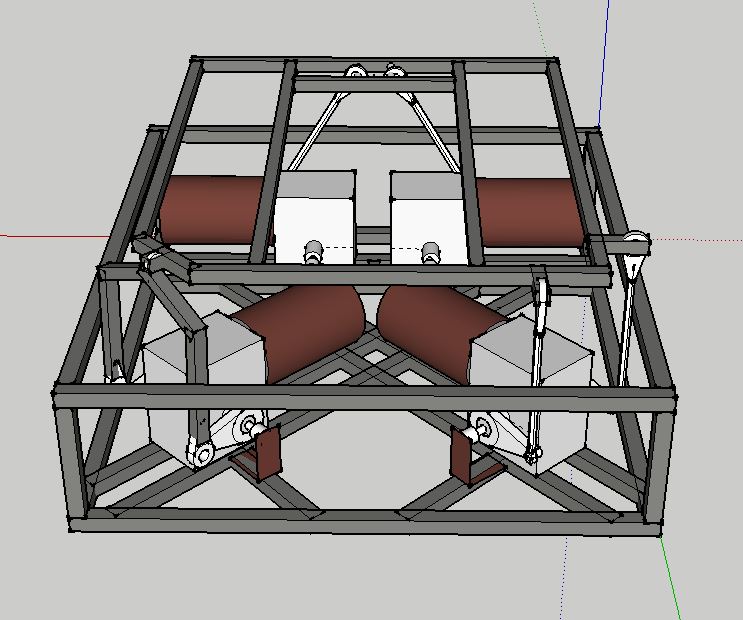

    Hello everyone!
    I am starting a project to create a 4DOF platform.
    As I could, I drew an approximate layout in the sketch app.
    With the location of the front motors and fastening jet rods have not yet decided.
    Motors ordered Chinese 300 Watt 24V 1800 rpm, with a 50:1 gearbox.

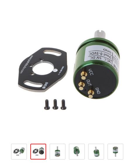

    Hall sensors are also from China Arduino UNO R3 - 2pcs. But the situation with drivers for motors is not clear. Sabertooth is not delivered to our country. While I am studying the question of which ones are suitable from those available in China. Picked up a few options.
    I post screenshots below. Criticism and comments are welcome.

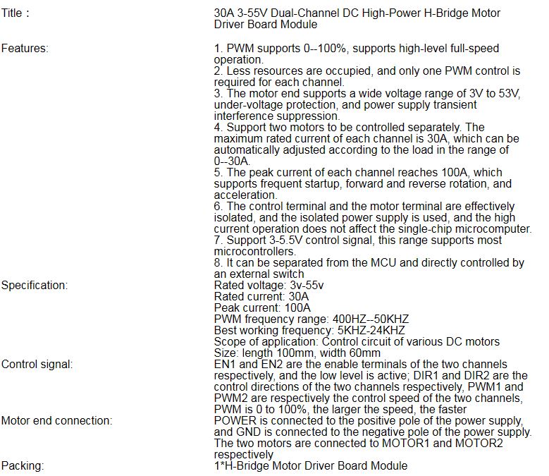

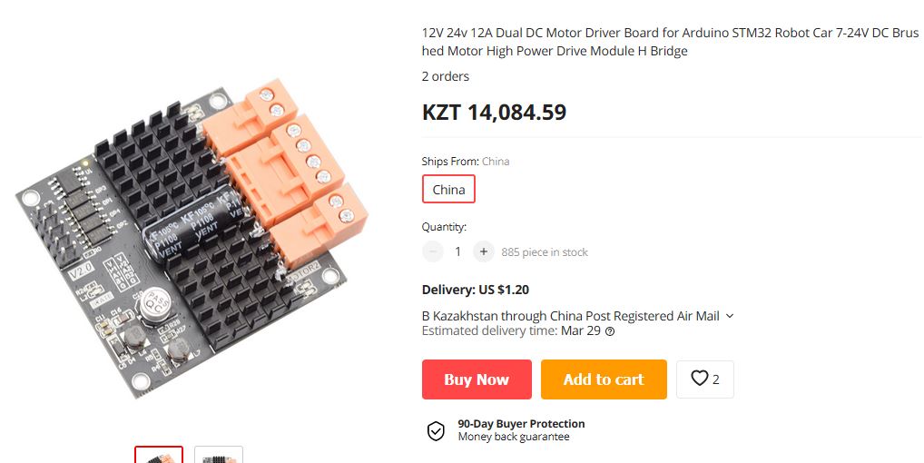

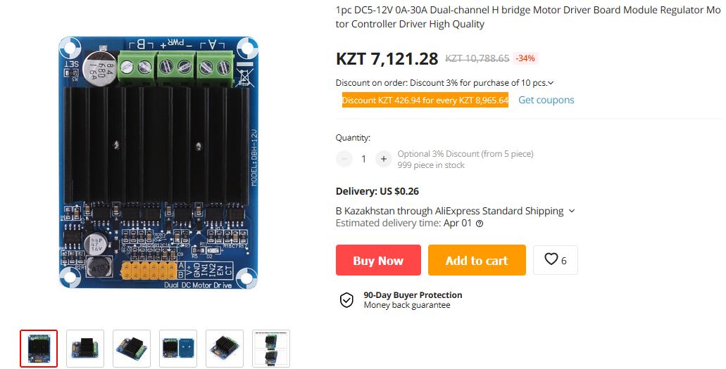

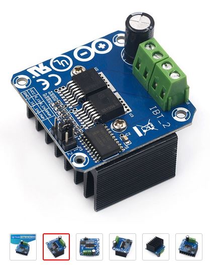

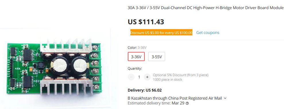

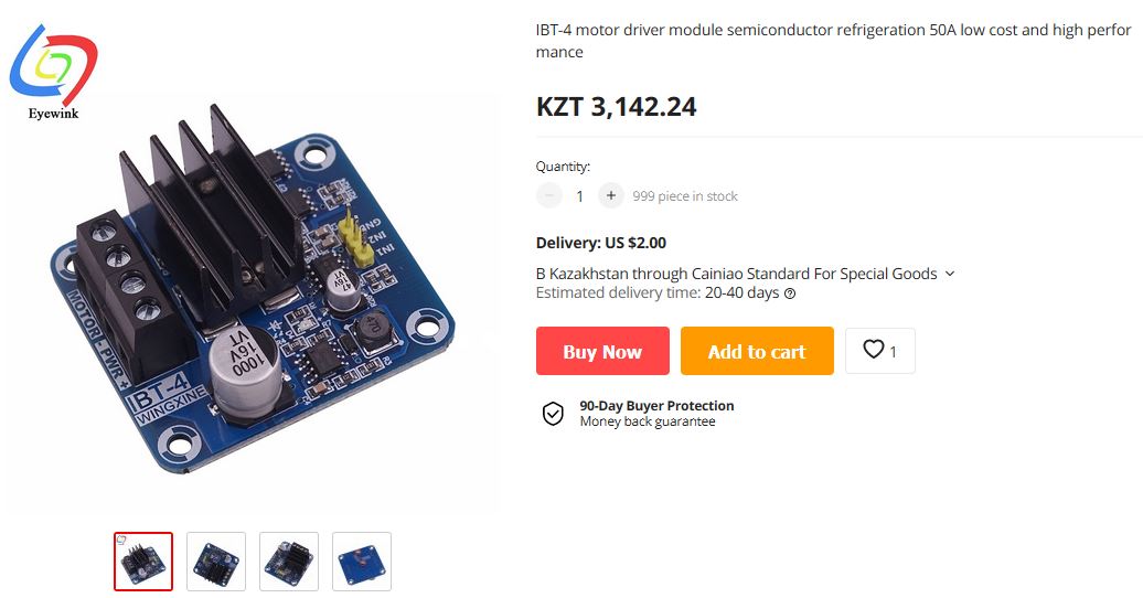

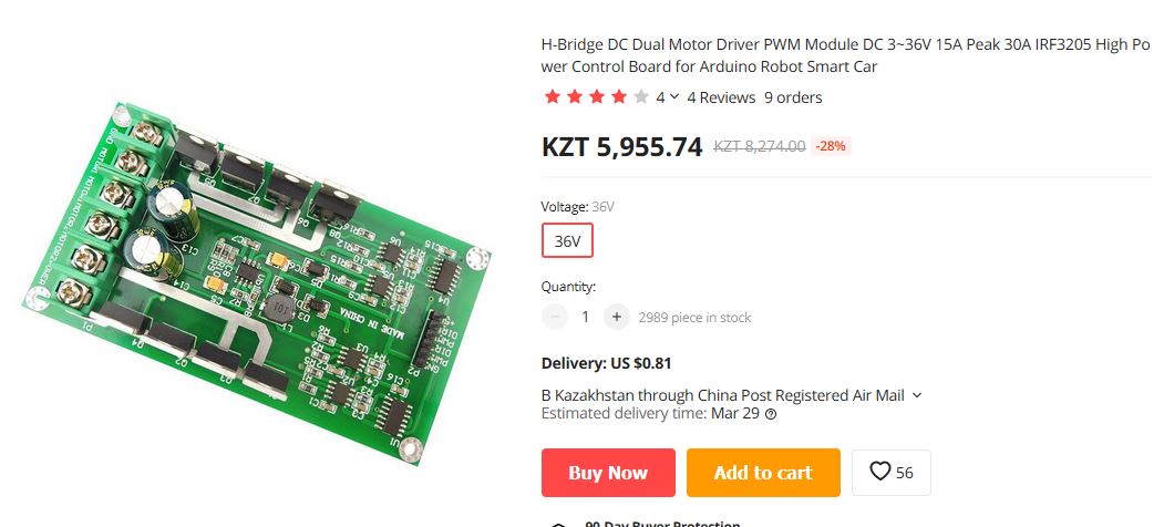

    According to the available drivers, one of the following:

    I also found this driver. It is also in question whether it will fit, the price is almost like for a sabertooth))

    When it comes to selecting drivers why not simplify and ensure existing code is available for the Uno: https://www.xsimulator.net/community/faq/arduino-code-for-use-with-various-hardware-and-simtools.31/
    Personally I would suggest selecting hardware compatible for the various variations of SMC3, given it has a companion app to provide easy and informative access to configuring settings.
    With respect to the design you could perhaps consider a pivoting V shaped bar between the top and bottom frames to prevent unwanted torsional rotation, but still allow traction loss style movement, albeit from a limit pivotal point. This a slightly different design but similar to what I mean in terms of visualizing the motion: https://www.xsimulator.net/community/threads/prilads-4dof-dc-motor-sim-rig.6157/

    Hello @RufusDufus !
    Can you tell me if this connection is correct? :think
    21,580
    151,094Coins
    +11,028 / 56 / -2
    @RufusDufus was last active on Oct 17, 2021, so it my be a while before he has a chance to respond.
    SMC3 MODE1: Supports a PWM output pin plus two Motor Direction output pins.
    MODE2: Designed for H-Bridges that require direct drive of Highside and Lowside switch inputs. In this mode one switch is driven as a direction pin and the other with the PWM output however the PWM duty needs to be inverted whenever the motor changes direction with the direction pin.
    You need to figure out if your hardware is supported and if so which Mode yours is.
  8. kalbasator
    kalbasator Active Member
    Dec 28, 2021
    105
    Kazahstan, Almaty
    400Coins
    +37 / 0 / -0
    3DOF, DC motor, Arduino, Motion platform, 4DOF
    The problem is that the manufacturer of this driver could not say anything (on Aliexpress ...:grin)
    Okay, when I get these drivers, I'll try at random
    Thank you very much for your support :thumbs

    Tell me what mode in SMC3.ino did you use with a 100A drivers?

    iirc
    #define MODE1

    Thank you very much for your replies.
    Tell me, if a resistor is required for the driver and what denomination?

    no resitor required

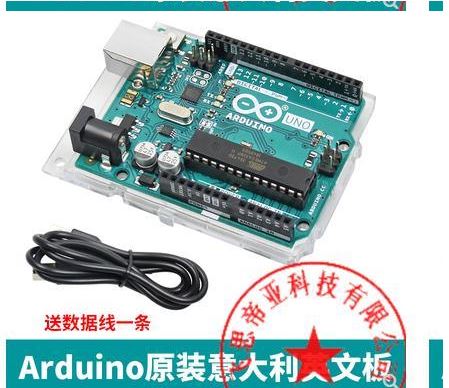

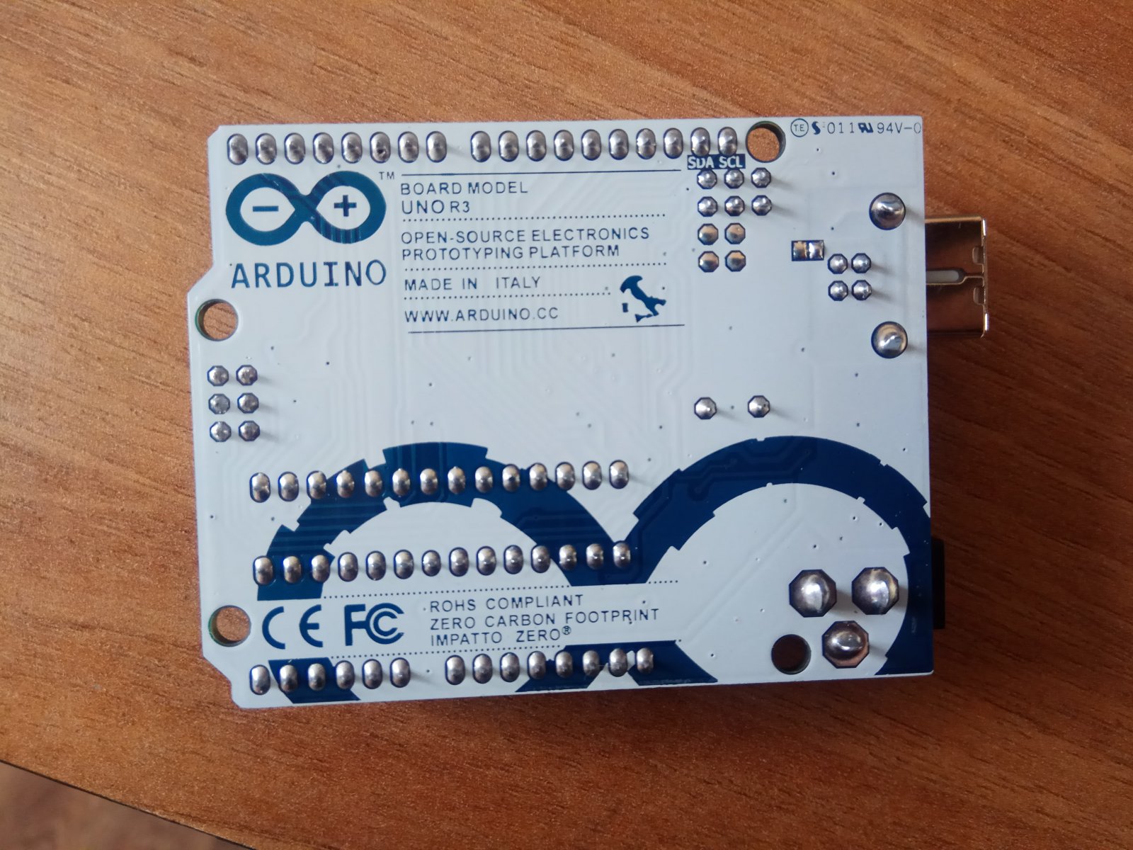

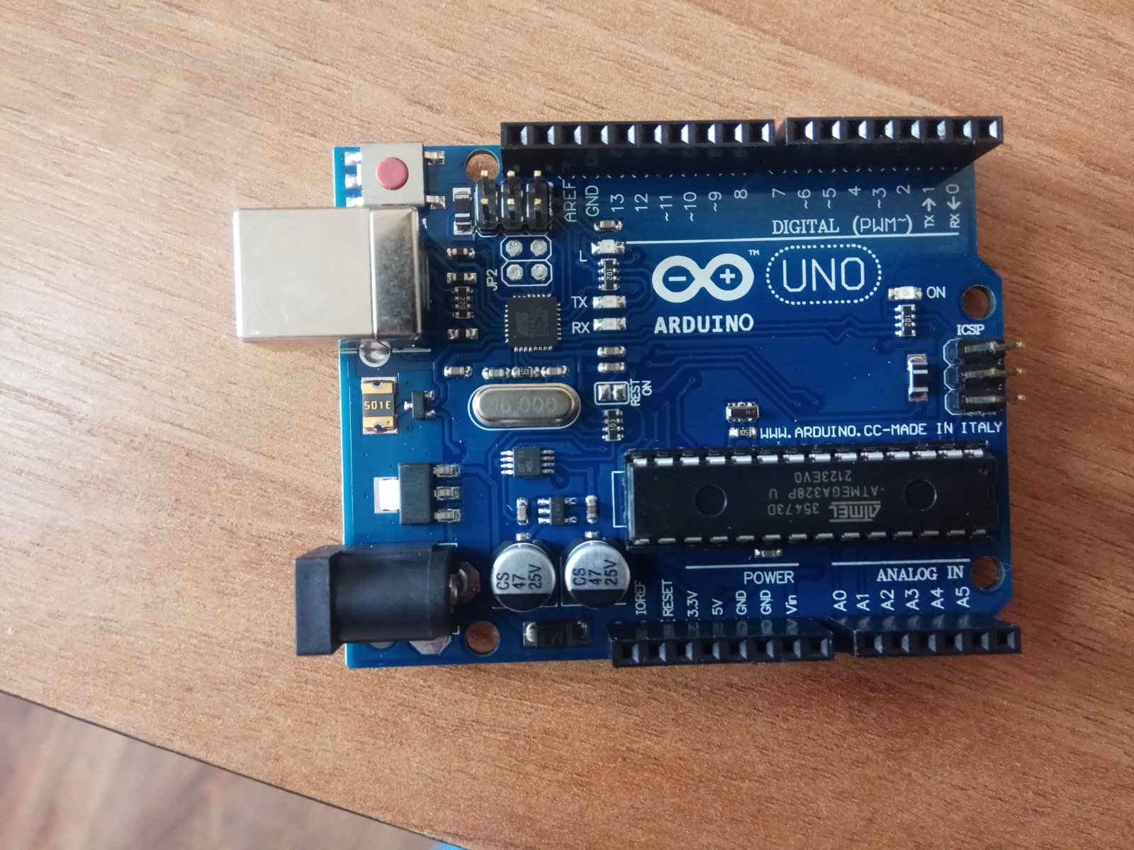

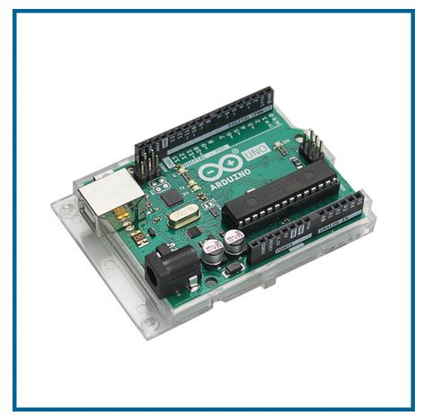

    After a long wait, the ordered components gradually began to arrive. I received an arduino UNO, I ordered it on Aliexpress, the order came not the one that was in their photo.
  17. kalbasator
    Dec 28, 2021
    105
    Kazahstan, Almaty
    400Coins
    +37 / 0 / -0
    The order was like this,
    and received this

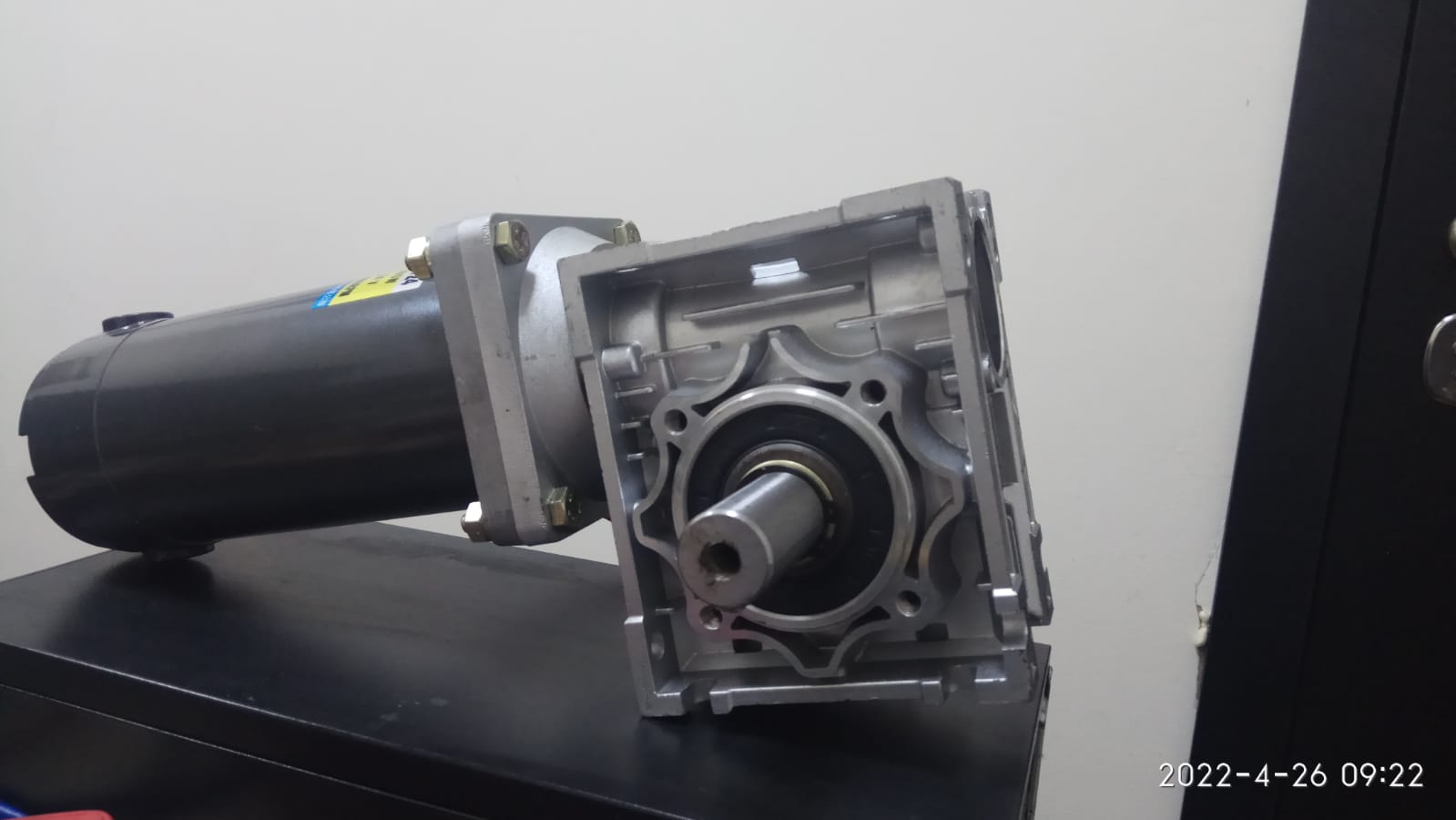

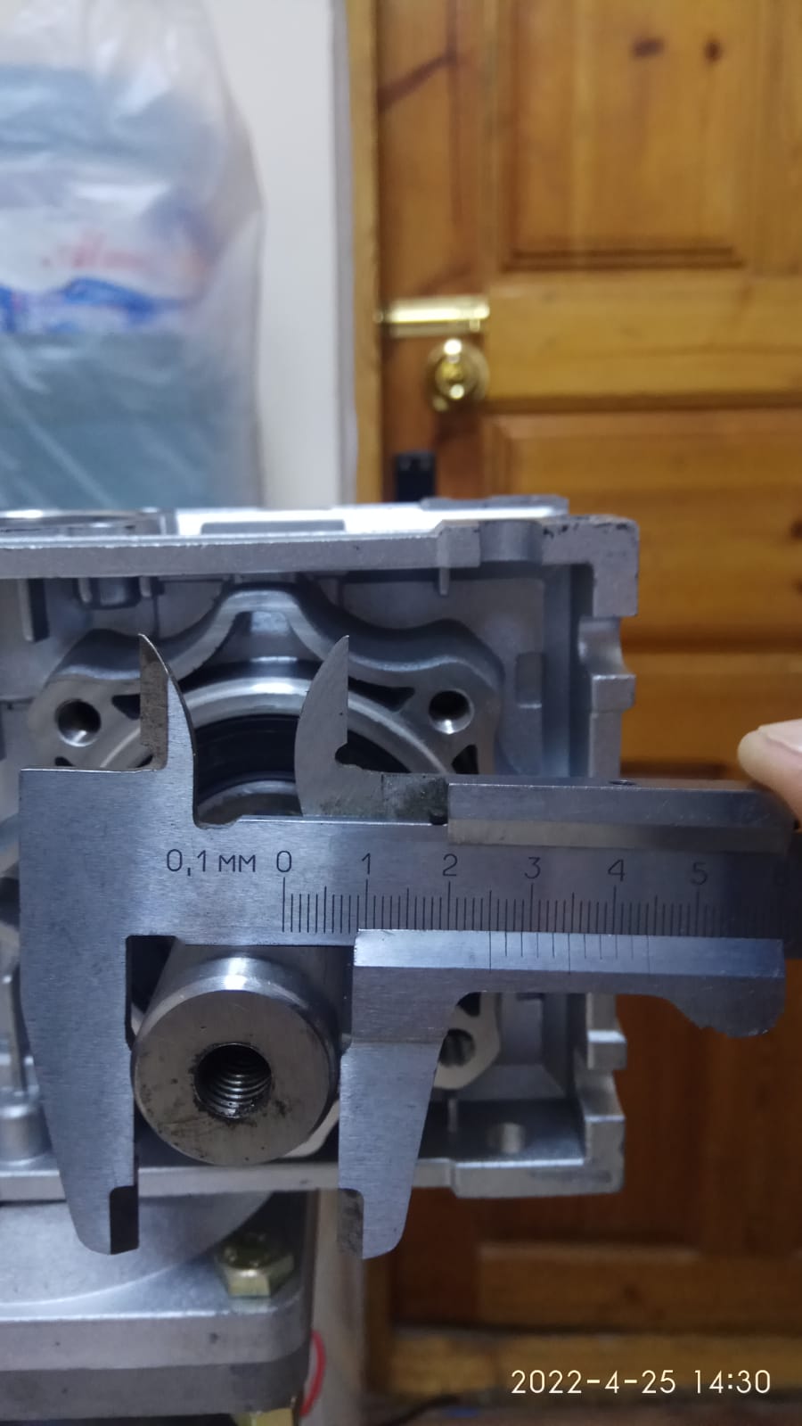

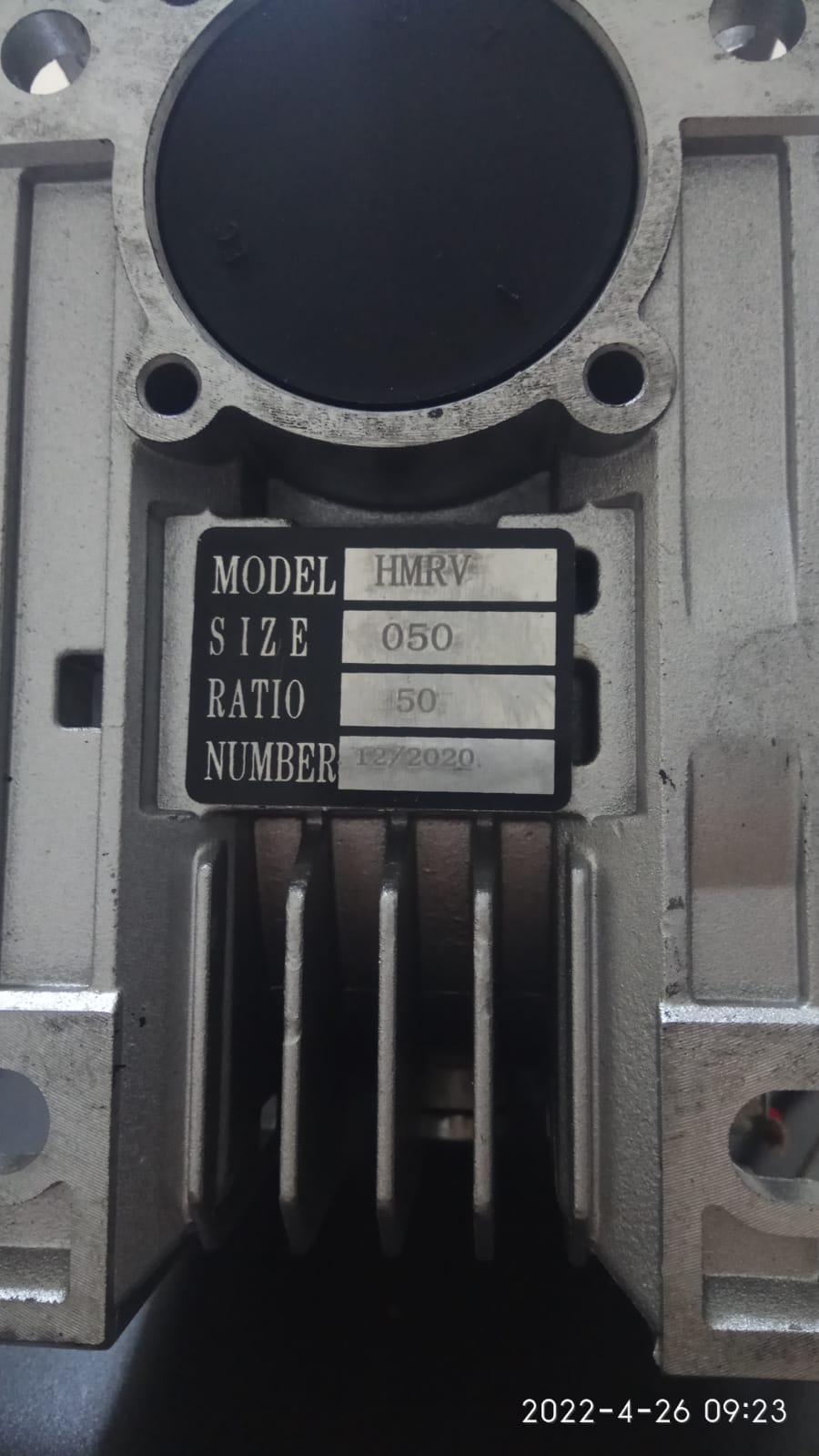

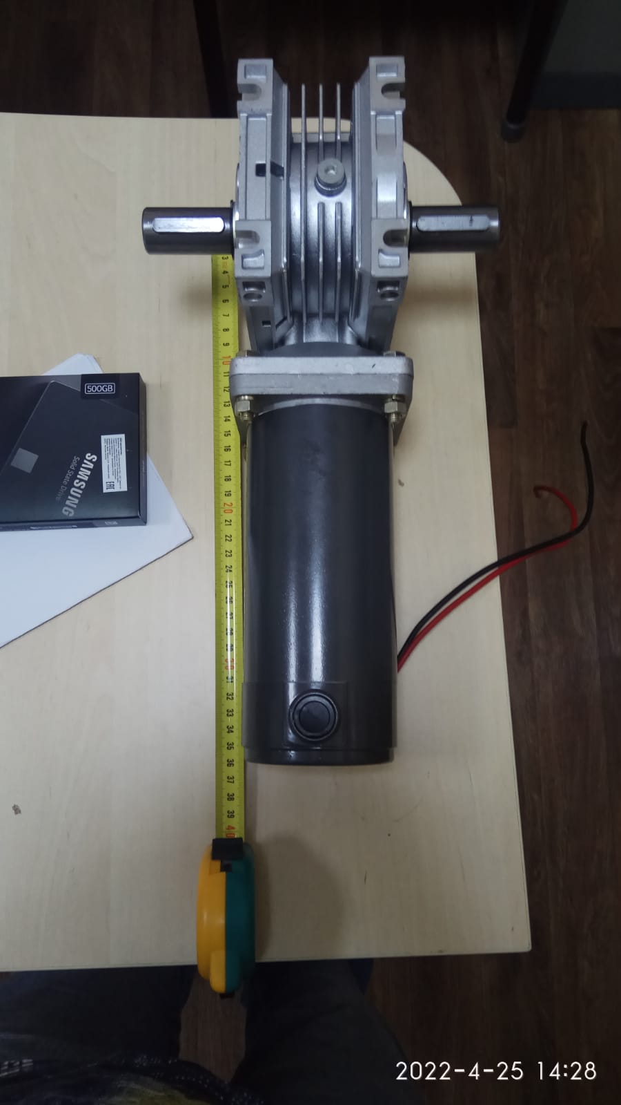

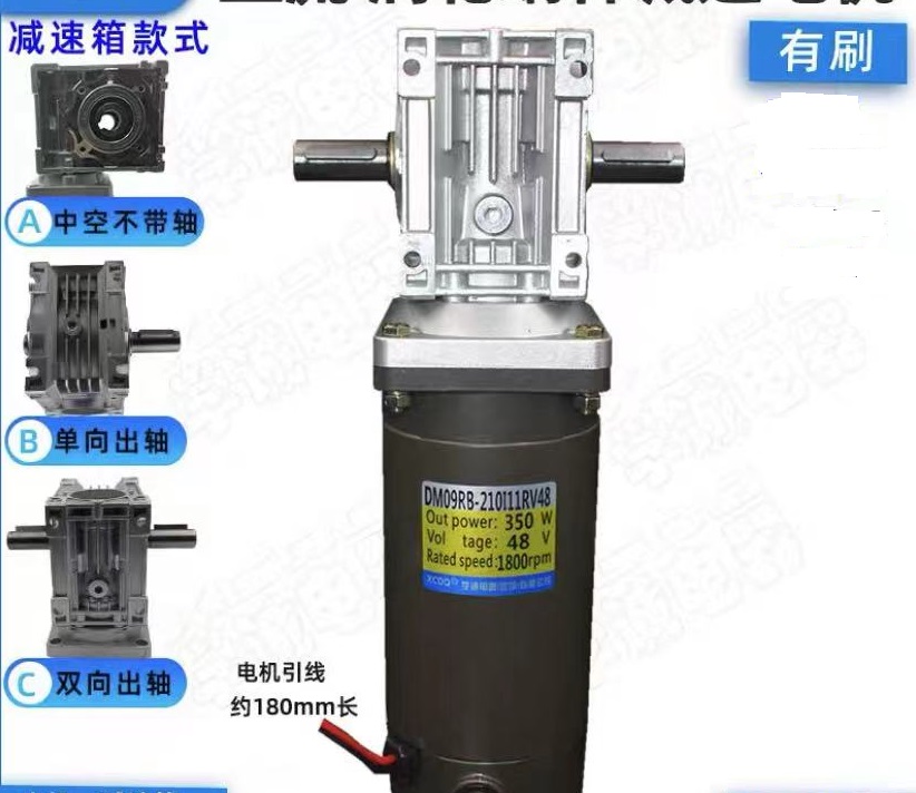

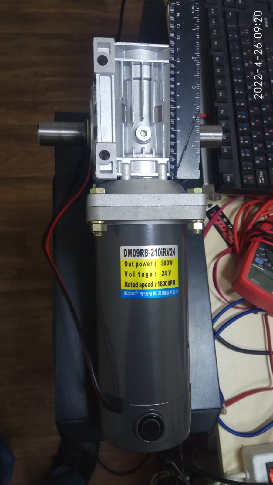

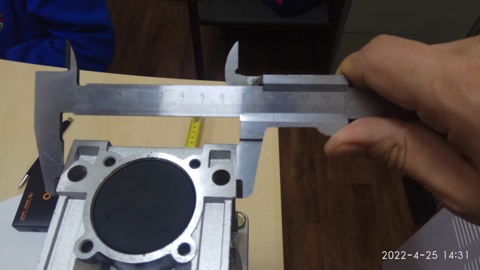

    Gear motors have arrived. When I ordered them, I expected them to be large, but I did not think that they were so large. This week I plan to start manufacturing the platform.
    There is also the question - which power supply is suitable for such motors. I think that two power supplies of 700 watts will be enough.
