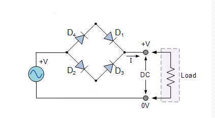

    Hi @SilentChill my 2 Server PSU are linked in parallel with blocking diode fitted to each output to stop power going back to the each psu so far have to say touch wood no issues with them at the moment , a friend of mine suggested you may need these blocking high power blocking diodes in series with each power supply output just a thought :)

  4. insanegr
    insanegr !N$@n€
    Jan 14, 2014
    503
    Athens
    16,726Coins
    +499 / 1 / -0
    never had thought we could use it like that:thumbs.
    i know you are referring to the metallic one(may need a heat sink on it for high amps) but i am showing this photo just for the symbols.
    it should be wired like that right?

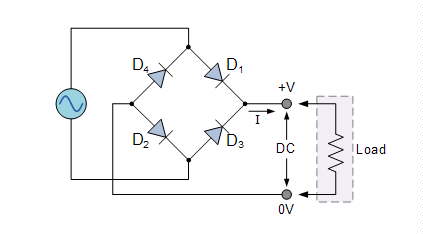

  5. BlazinH
    BlazinH Well-Known Member
    Oct 19, 2013
    2,145
    Oklahoma City, USA
    16,674Coins
    +1,839 / 32 / -1
    If it's like this, then yes.

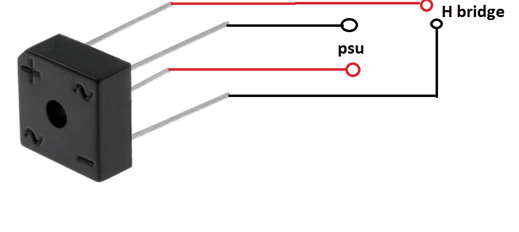

  6. wannabeaflyer2

  7. BlazinH
    Oct 19, 2013
    2,145
    Oklahoma City, USA
    16,674Coins
    +1,839 / 32 / -1
    Another way to connect the bridge rectifier just occurred to me. Since we are not using it to convert AC to DC, we are only using half of the bridge. Therefore, with the wiring as shown above, the other half of the bridge only works when we reverse the polarity leads from the power supply. But still only half of it is being used, just the other half. Therefore, we can instead wire it as shown below to use both sides of the half bridge at the same time and double its stated amperage capacity with the only trade off being that the power supplies are no longer protected if you mistakenly connect its power leads backwards. (note: while the diodes will be able to handle double the stated current rating, this assumes that the leads being used internally are large enough to also handle the additional current)
    Basically it just uses it like a single diode.
    :! Note:The diodes that are in series serve no useful purpose so you could also wire it so it only uses two of the diodes in parallel. Then if a diode goes bad you can just swap over to the remaining good diode so its like having a built in replacement for each diode. Of course, you could also leave it wired as shown and just eliminate a diode from the circuit if one goes bad.
    • Informative Informative x 3
  8. SilentChill
    2,645
    20,596Coins
    +3,570 / 34 / -0
    Awesome thanks @wannabeaflyer2 and @BlazinH. Think I will go with the bridge rectifier as they are cheaper :D I will have to get 12 of them to stop any back current going from each MM hopefully that will solve any issue if there actually is one o_O
