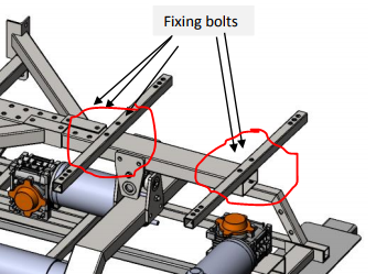

    Mostly finished assembly of my new P3. The default Pitch Roll and Sway were completely wrong. I figured it out (I think) and have Asseto Corsica working well, but Project Card 2 (UDP) is completely wrong. Is it common for different games to be so backwards in motion?
    Also, I am not sure how to test and balance the rig. I know its important, but I don't have anyone that could spot me with the motors disconnected. How can I tell how out of balance I am?
    Also the mounting bolt head that attaches the frame base (part that doesn't move) to the sway/yaw traction loss motor, seems too tall. The unit wobbles on the head of that bolt (the four corners of the base are higher up). Should there be feet/levelers on the bottom of each corner of the traction loss base?

    "Also the mounting bolt head that attaches the frame base (part that doesn't move) to the sway/yaw traction loss motor, seems too tall. The unit wobbles on the head of that bolt (the four corners of the base are higher up). Should there be feet/levelers on the bottom of each corner of the traction loss base?"
    If I understand what you are saying, you are talking about the moving frame pivot point locating into the bearing which is welded onto the lower fixed frame. It is an interference fit and you need to push the upper frame into the lower frame until the upper frame sits on the rollers.
    Regarding:
    "Mostly finished assembly of my new P3. The default Pitch Roll and Sway were completely wrong. I figured it out (I think) and have Asseto Corsica working well, but Project Card 2 (UDP) is completely wrong. Is it common for different games to be so backwards in motion?"
    As Norbeast said, you will need to set up profiles for each sim. Within the Axis Assignments screen, at the left of each Axis row there is a checkbox called DIR. Select that next to the axis that seems to be going in the wrong direction. On my P3 rig I have all three axis checked for DOF1, axis 1 checked for DOF 2, all 3 axis checked for DOF3 and axis 2 checked for DOF4 and DOF5
    As for balancing the rig, there is no real easy way of doing it other than getting some friends to help. I was able to get it close based on seeing restricted movement looking at the traces when viewing SMC3 however I was only able to get it right when I had friends helping me.
    I disconnected the control arms and sat in the seat with friends holding me upright. My friends were able to tell me where the weight was and what difference it made if I shifted my weight. With that knowledge I was able to get out, adjust the balance forward to back and side to side. Forward to back is quite easy because there are three positions where the universal joint can mount to the moving frame and then fine adjustment with seat rails (assuming you have seat rails).
    But it's the side to side balance that is a lot more difficult and time consuming. I had to elongate and slot the seat mounting square section steel so I could push my seat over to the right. That wasn't enough for me and I then had to re-drill where those seat mounting box section drill to the long frame. That pushed my seat even further to the right. I then slid my pedal box over to the right (my pedals are mounted onto aluminium extrusion giving me the ability to independently adjust each pedal left to right) and then had to re-drill the wheel mounting plate to push my wheel over to the right. I can add some photos if my explanation is confusing.

    I slotted the two sets of 3 holes at each end of the seat mounts and also re-drilled the two mounting holes circled in red. I think I moved aprox 10mm.
    With all those changes I was able to get the balance close enough.
    You know its about right when, with you sat in the seat the whole upper frame will rock side to side with very little weight shift. Once you have the side to side, you can then adjust front to back so there is a little weight over the front of the rig as suggested by Norbeast.

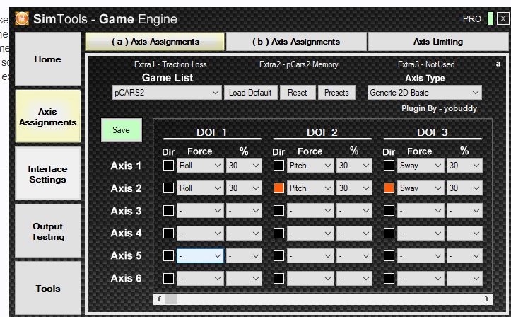

    Axis is swapped in project cars 2, i cant figure out to fix it. Anyone can make a motion profile?
    Thanks!

    The Dir being checked orange or not in Axis Allocations determines how each axis moves, this is how SimTools expects the Axis to be configured: https://www.xsimulator.net/community/faq/which-way-to-set-simtool-axis-movements.230/
    You do need to create a unique motion profile for each game, here are the steps to do so, including Dir settings: https://www.xsimulator.net/community/faq/steps-to-create-a-motion-profile.228/

    I also have problem with roll and pitch wrong, i can change it so it works right in game engine and press save with the game name in game list.
    But when i start the game axis is still wrong?
    I can´t see how to make a motion profile?! i dont understand the guide, is there a youtube video with that?

    For roll one Dir should be checked and the other unchecked. For pitch, surge and heave on a 2DOF both will be set the same.
    Take it one step at a time to make and refine a motion profile: https://www.xsimulator.net/community/faq/steps-to-create-a-motion-profile.228/

    Output test in GameEngine use default profile for testing, pls disable all DOF in game profile.
    Add only Pitch on Axis1 and Axis2 with default settings, run game - if pitch inverted - use DIR checkbox on both Axis, If Pitch make tilt on side, use DIR on one of the axis.

    Noorbeast posted:
    "For roll one Dir should be checked and the other unchecked. For pitch, surge and heave on a 2DOF both will be set the same."
    Strangely enough, for my DofReality P3 rig its the exact opposite.For roll, both Dir is checked however for Pitch, only 1 Dir is checked.
    I guess you just play around until it feels right.
    Andy

    That suggests the wiring for one motor is around the wrong way, this is how SimTools expects the Axis to be configured: https://www.xsimulator.net/community/faq/which-way-to-set-simtool-axis-movements.230/

    It doesn't surprise me if one is wired incorrectly, but it works so I'm not gonna complain too much.
