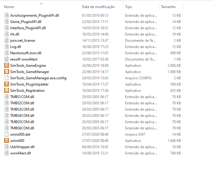

    hi all, where can i download the dll of LFS plugin?

    Any plugin download requires access, either via paid membership or forum activity coins: https://www.xsimulator.net/community/faq/coins-and-how-to-download-plugins.2/
    All plugins are located here: C:\Users\YourUserName\AppData\Local\SimTools\GamePlugins
    But can you please explain what your issue is or what you are trying to do?

    sorry my friend.
    1. I thought I needed to put a game-specific dll file into the game folder.
    2. I thought the liveforspeed plugin was free

    You should use the SimTools PluginUpdater to install any plugin: https://www.xsimulator.net/community/faq/how-to-install-plugins.310/
    But in the case of LFS it is installed by default when SimTools is installed, so is both free and fully usable, specifically for testing purposes.
    Do be aware that LFS needs to be run in first person mode before it is patched for motion, as that generates some required file: https://www.xsimulator.net/communit...run-in-first-person-mode-before-patching.365/
