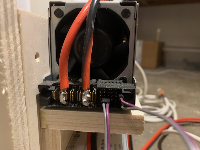

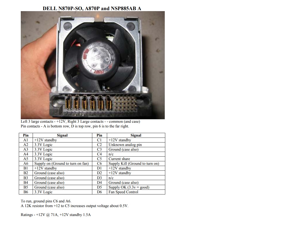

    I got da power

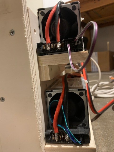

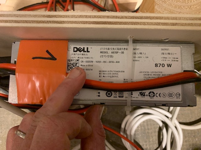

    So I got a good deal on three Dell A870-00 server power supplies, 870 watts each (that should deal with any power spikes) plugged them in, little green light but no 12v, no fan.
    This is normal, I needed to find the pskill and fan pins and ground them in order to turn this thing on. After a few hours trawling the net, and a lot of Radio Control forums, I found some tips, a quick guide, and a pinout posted by someone (precious stuff!). And the post on Xsimulatot about modifying server PSU's.
    Basically, I just attached C6 and A6 to ground using some breadboard jumper wires and everything was hunky dory, multimeter reading 12,3V. I used a 300ohm resistor via a breadboard when I first tested things out as people suggest that it decreases the risk of a catastrophique failure if you connect the wrong pins together, but removed this later.
    The soldering was messy, some people solder all three power connectors together, i did this on the first PSU, but decided just to solder the middle pin on the other supplies to my 10awg cable as it was difficult to solder properly du to the large size (and me worrying about overheating some delicate component and frying my supply.
    I have been messing around with my setup for a few weeks now as I try and get things working, and these supplies are excellent. I accidentally shorted one for a second which sparked and the led went yellow instead of green. After 10 minutes rest I plugged it back in and the led was green again.

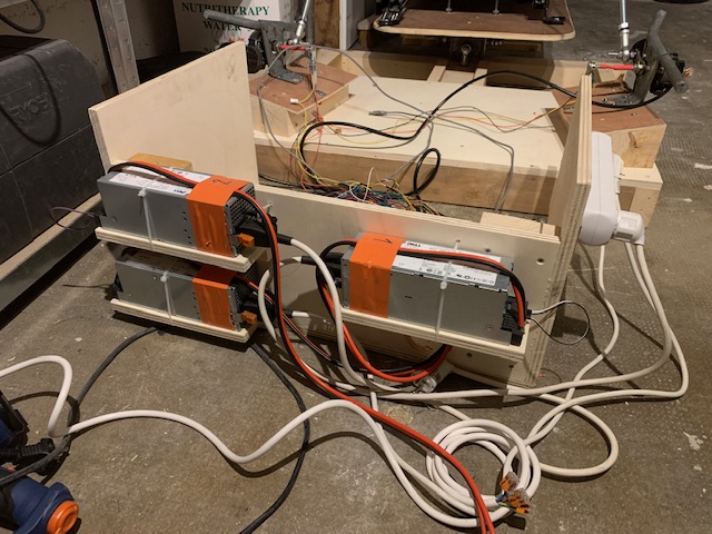

    After getting the server power supplies working (very quick and easy in the end) I tested my three motors (car windscreen wiper motors, no technical details available for power and torque, but they are very very difficult to turn by hand so I guess they have a fairly high gear ratio) and all three rotated fine and quickly. Tested with a wattmeter, they draw around 125W when connected directly to 12V.
    I made a wooden case to house my PSU's, motors and electronics in order to keep things a little neater, and tidy it up/protect it while I tried to get the electronics to work.
    Oh, and the supplies are very quiet, although they havent had any serious load yet.

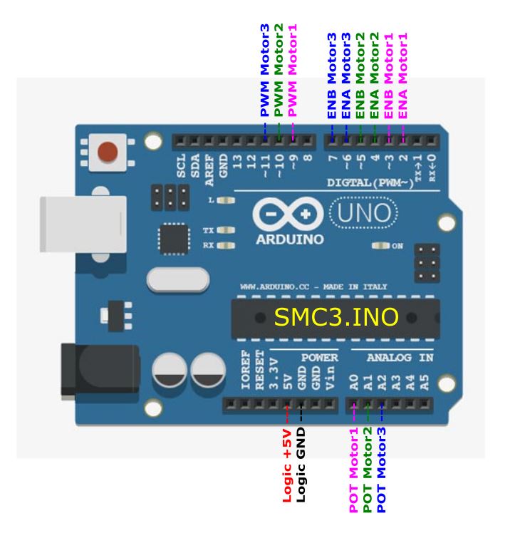

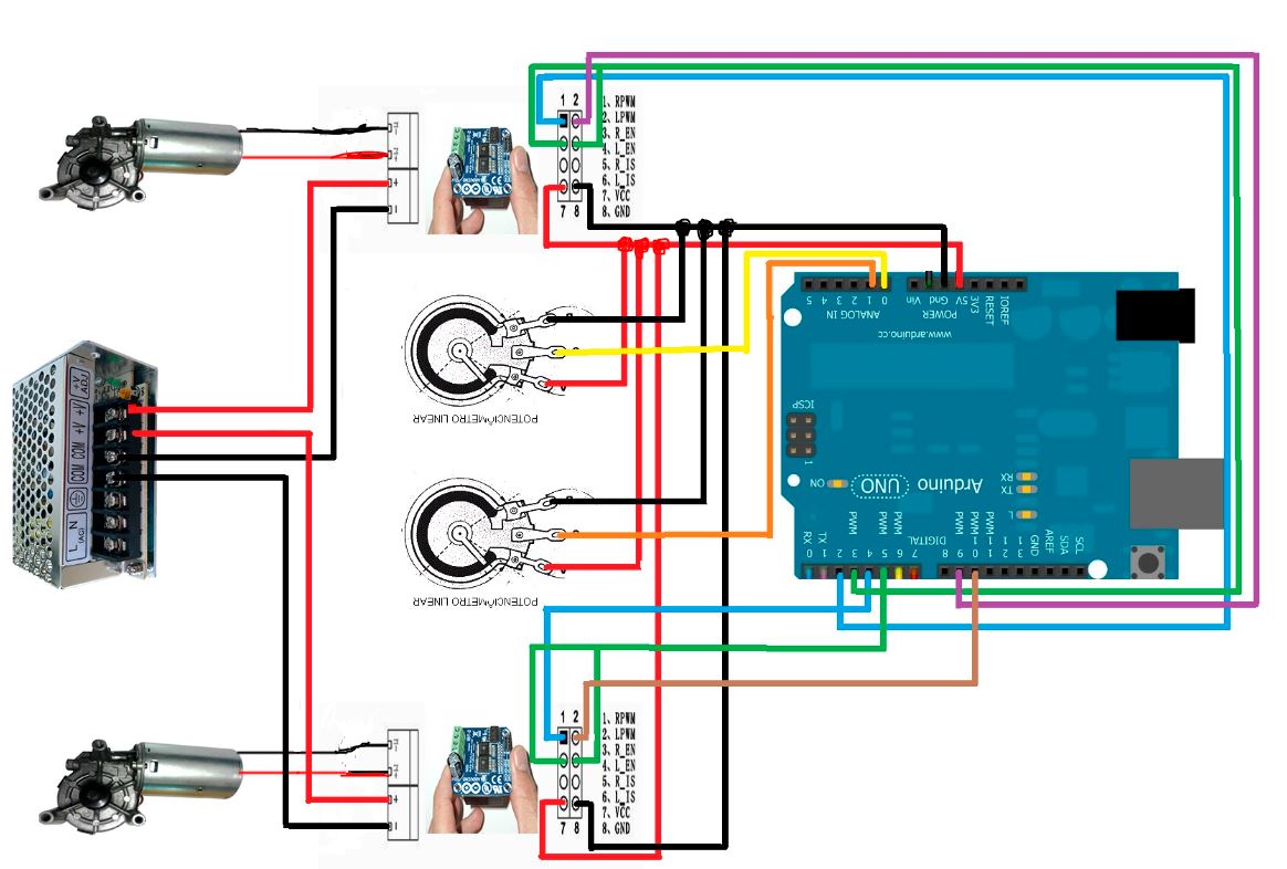

    The wiring is actually very simple and I understand it better in words than in pictures (although the pictures confirm)
    One circuit is the 12V electrics: power supply to motor controller (IBT2) to motor, all at 12v with decent thickness cable to carry the large current. The motor controller will listen to the Arduino and decide when and how much to turn the current on, or if it needs to be reversed.
    The next circuit (the electronics) runs at 5V from the Arduino, which gets its power from the PC via USB. It contains the Arduino, potentiometers (which sense the motor position) and motor drivers (In my case IBT2 controllers).In this circuit, everything needs to be connected to +5V and 0V/ground.
    The next bit is the only complicated bit. The two or three potentiometers have a middle wire, which connects to the analogue inputs on the Arduino with a variable voltage depending on their physical position (ie the position of the motor shaft to which they are mechanically connected.) This tells the Arduino the actual motor position at any one moment.
    The Arduino will receive information from the game that you are playing via simtools, which will tell the Arduino in what position the motor should be. The Arduino knows where the motor is (via the pot) and knows where it should be (via simtools) and will tell the motor controllers to adjust the voltage supplied to the motors in order to achieve this position.
    The inputs on the IBT2 motor controllers are connected to the outputs of the Arduino. The Arduino tells the motor controllers what current/voltage to apply to the motors (using PWM/Pulse Width Modulation). In other words how hard to drive the motor and in which direction, and can eventually brake the motor by reversing the current until the motor stops. So I just faithfully applied this bit of the wiring diagram posted on the xsimulator site with this basic understanding of what was happening.
    And when I tested it, the bloody thing just worked first time! For me, this was like magic. It actually worked!
    Practically speaking, I used a breadboard in order to connect all the 5V electronics to the Arduino, using a pack of cheap jumper cables that I got on amazon, I think that there were 40 male-male, 40 female-female, and 40 male-female wires and I paid around 12 euros. I also got 7 different coloured rolls of 20AWG wire to attach the pots, I soldered them with my 7 year old Daphné who held the wires in place as I couldn't find my third hand, thanks Daph!
    The motors I connected using 10AWG tinned copper wire. It's bloody thick stuff. It was expensive too, but I didn't want to be a fire hazard, so I checked to see what wire gauge was adapted for a 300W motor at 12V (my wiper motors draw 125W at maw output, but I will eventually get better motors). Anyway, 10AWG was recommended for 25-30amps. But this stuff was so thick that it wouldn't fit in any of the connectors, so I had to thin the wire ends for the connectors. Just really annoying. The IBT2s are supposed to handle a maximum current of 43amps. But the screw-down connectors can't handle the cable size adapted for that! I know that the norms are conservative for cable thickness, but... I still don't understand the mismatch. Anyway, when a week later I needed to extend my wires in order to connect an actual chair, I bought 14AWG wire which is fine for my lower-powered wiper motors, and I will revisit this topic of wire size another day.
    Anyway, I built the circuit.

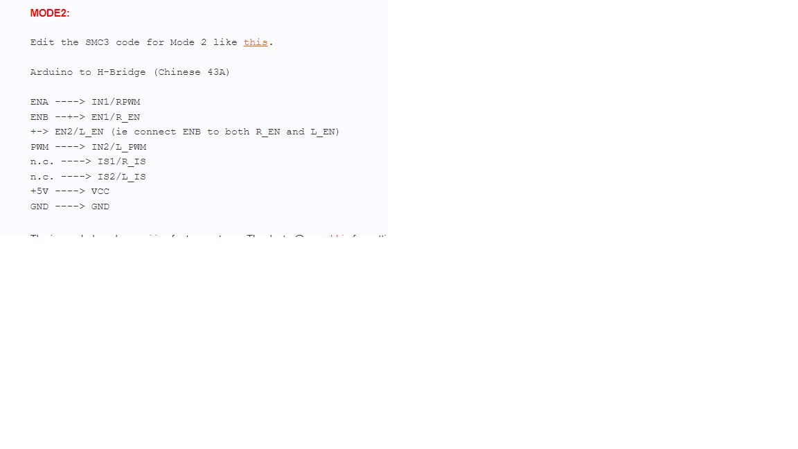

    Edit the SMC3 code for Mode 2 like this.

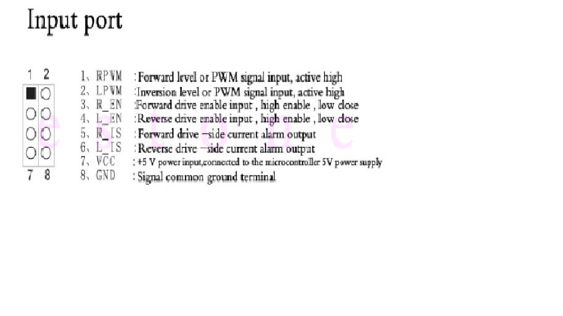

    Arduino to H-Bridge (Chinese 43A)
    ENA ----> IN1/RPWM
    ENB --+-> EN1/R_EN
    +-> EN2/L_EN (ie connect ENB to both R_EN and L_EN)
    PWM ----> IN2/L_PWM
    n.c. ----> IS1/R_IS
    n.c. ----> IS2/L_IS
    +5V ----> VCC
    GND ----> GND
    This last bit was a tad confusing, here is a crappy quality ibt2 pinout
    ibt2 pinout.jpg Just connect it as shown, the R_EN and L_EN wires should be joined together.
