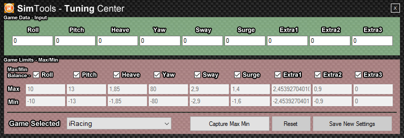

    What Game are you playing and can you take a pic of your Tuning center please.

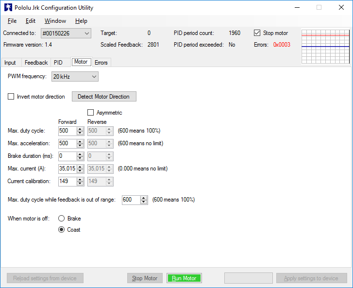

    @Bernd Manger Thank you for the comment :) I think my problem is not the PSU shutting down, but the motor driver errors. The JRK counts an motor driver error if motor output A is shortend to ground or vin. The PSU shutting off is a consequence, but not the problem itself. In case I put a battery in bewtween I would still get motor driver errors which result in basicly no motion when the occur.
    @Nick Moxley I am testing with iRacing driving a RUF Track. I put in the JRK settings as well. My axis assignment:
    Surge 21% Roll 15% Sway 55% Pitch 20% Extra2 6%
    Other axis are not assigned anymore.

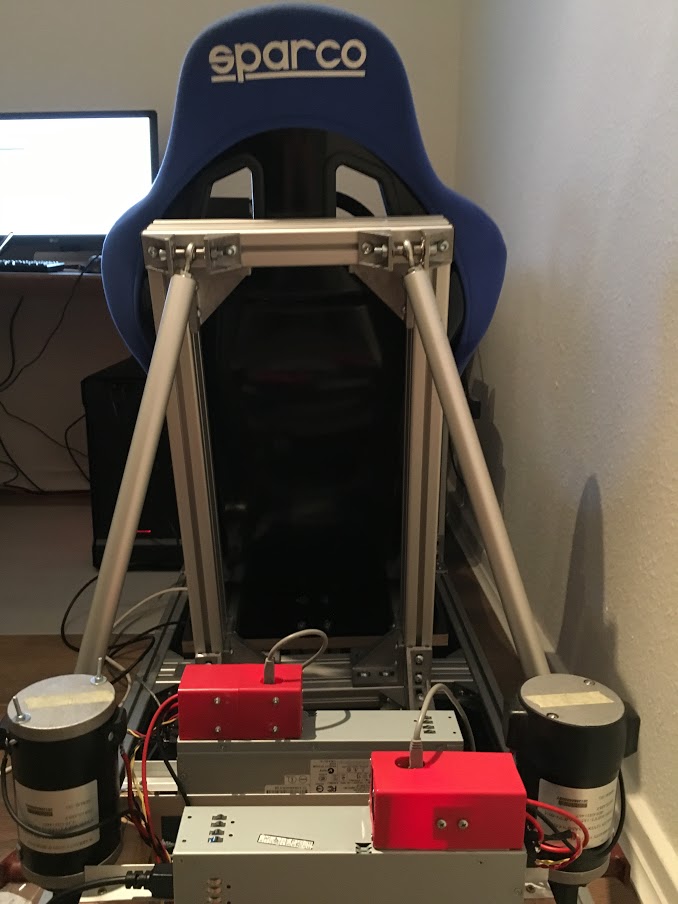

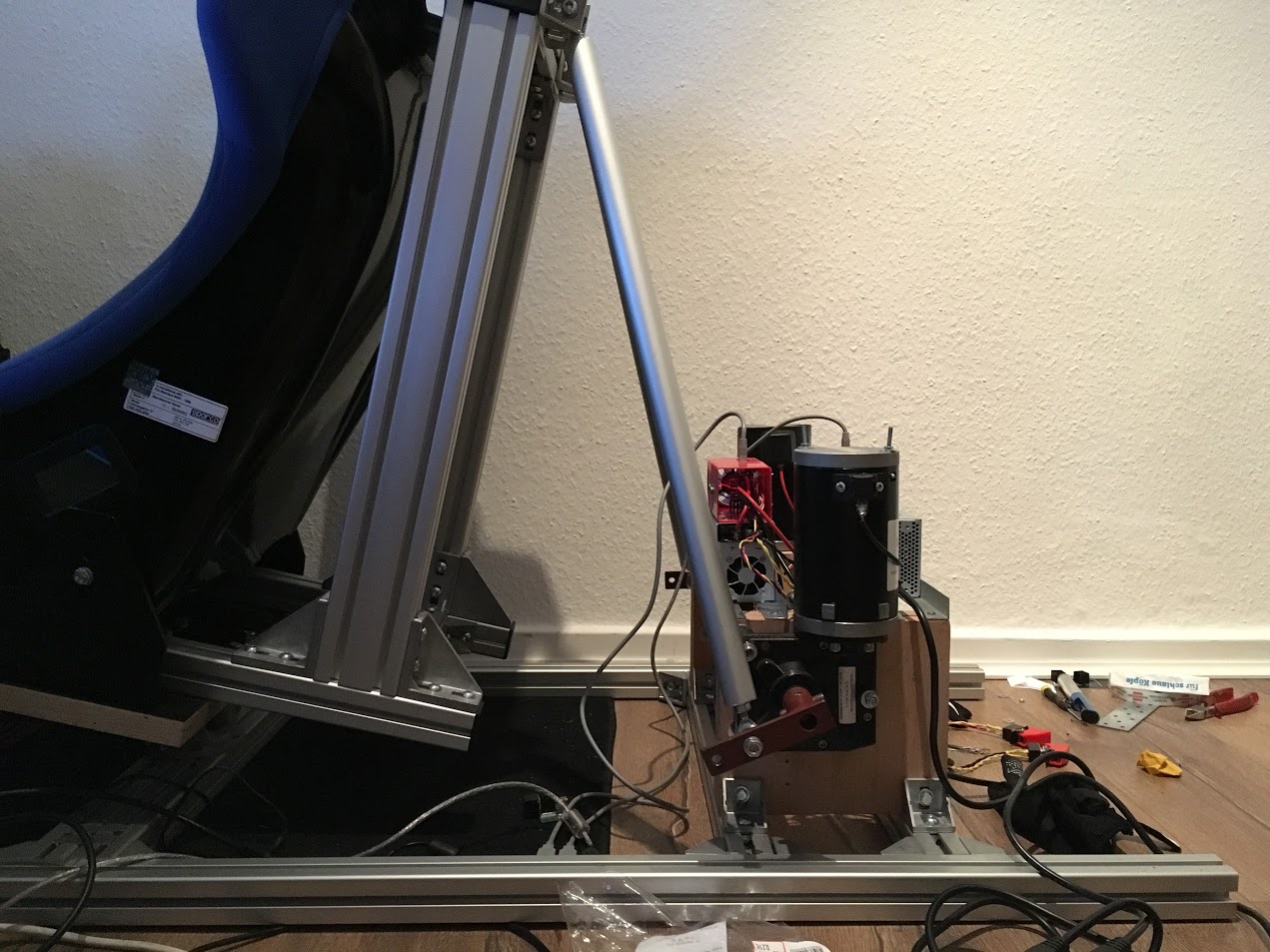

    I added some pictures from the built as well, maybe someone sees an major fault in it. Something I will try is to lengthen the "pushrods" and move the motors a little farther back, to make angles less steep. Someone suggested that in an very early stage of my build and I have some left over material to lenghthen them 120mm.
    The CTC I use right now is 50mm. In case more information is necessary, I will gladly provide more.

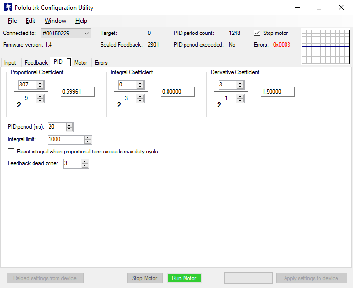

    @Nick Moxley Thank you :) I watched that video before and thought I did things ok, but it seems I have been wrong. I did turn down the P a lot to 0.2. I am still getting some Motor driver errors but not as many as before and the sim keeps running. Now I have another problem. With these settings my seat moves way too sluggish. There is no texture on anything. I get most of the slower motions (sway, roll, pitch) but there are no bumps, or anything that comes close to faster movements. I cannot even feel the shifts anymore.

    @noorbeast I uploaded a video of the JRK graph. I am driving with a Occulus, so I cannot watch the graph while driving. The "screen capture" is done with a phone, sorry for that, but the quality seems to be ok.
    These are the settings that work on both sides without problem:
    P=0.2 I=0.025 D=0.6
    From what I get out of Richs video Nick posted I would have to increase P to make the lines more like each other, since they are way apart in the first video. Once I do that, one side looks and feels better, the other fails. I did a video with the graph as well(the non failing side):
    In this video I put P=0.5 and D=1. I is unchanged.
    I turned a few laps with one side on only, than switched that side off, and turned the other side on. Right side works like a charm, the left side shuts down with my lovely motor driver errors. I can make a video with the shutting down graph as well, in case that helps.

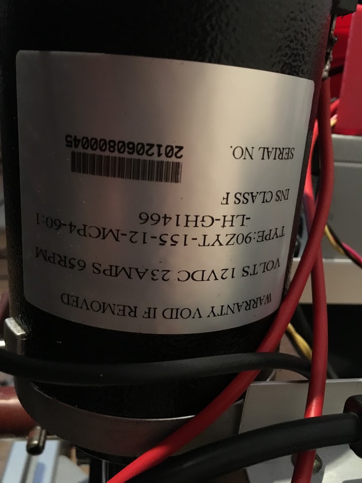

    What are the full specs of the motors you are using? JRKs have issues with high W motors.

    @noorbeast The motors are form motioncontrolproducts. 90zyt-155 with a 60:1 wormgear gearbox.
    I changed the PSU left to right, and the error went with the PSU, wich kind of surprised me. I replaced that PSU two times already. Once in my initial search for the error. I recently got two PSU for free and switched the not working side again. I still have one PSU I never tried :D

    @Avenga76 explained in his thread very nicely what Max acceleration does, and found I the use of break duration in the same thread, as well. Thank you, I kind of misunderstood that before! I set 20ms of break duration, so one PID calculation, and put Max accel. to 300, so it takes two PID calculation or 40ms, to go from full forward to full backwards. I did a few Laps in Laguna Seca with the RUF and it ran fine! I upped the P to .6 and and D to 1.5 and did more laps. My "problem side" shut down once during a crash, but never during normal driving, with hitting curbs too hard etc. It feels already pretty good. I get bumbs and it feels like bumps in a car, that has suspension, not like bumps in a Kart :D
    I need to tweak a bit more with PIDs I think, and maybe reduce the duty cycles a tad and add a little more P.
