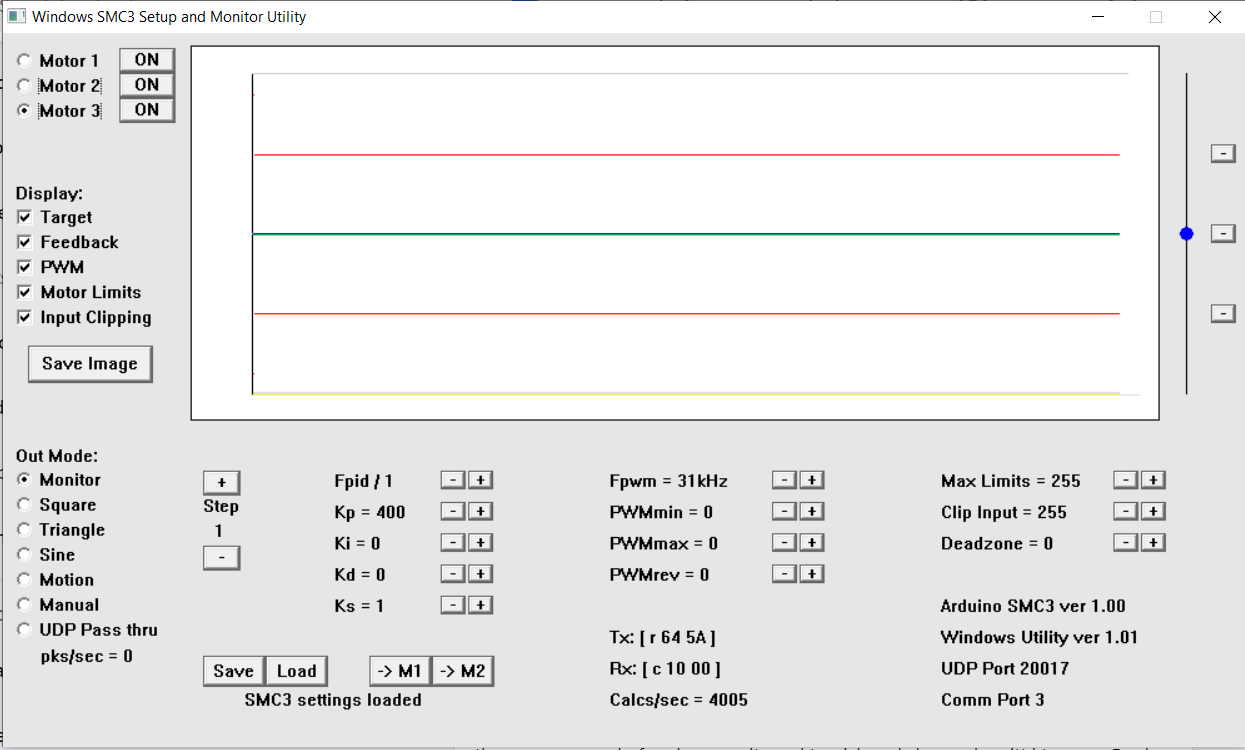

    It *appeared* that it was easy to adjust the pin #8 vs. #9 - but time will tell.
    Now I'm into the testing portions. I was able to figure out verify/compile/upload to the arduino and everything seemed to go well there. I then went forward with the SMCutility testing and ran into several problems.
    First problem is mechanical - I used hot glue (specifically the strong stuff for automotive dent repair) to connect the motors to the potentiometers. I didn't think there'd be a lot of torque between the 2. My "weakest" looking glue attempt has held strong throughout testing (motor #2), but after 3 attempts on motor#1 it keeps just twisting out from under the glue. I'll do some searching on other methods - I've seen just tubing used though so I don't understand why this is being iffy.
    Second problem may have to do with my attempts at adjustment in the arduino. At first motor #3 was relatively unresponsive. Discovered the pin 5/6 on the IBT wire had let go, so that seemed like an obvious fix. After soldering, I thought maybe the motor was in the clipped portion of the feedback, so I bumped it trying to get back to a normal position - and bumped it the wrong way. This made it hit my potentiometer mount and dislodge it, so some work there. Then when I went to fire it all up again and re-test, when I loaded SMCutil, motor #3 just started oscillating in place, and either the IBT or Arduino is "beeping" constantly. I turned everything off and inspected over all of the wiring again and couldn't find an issue. Has anyone run into this?

    It is a good idea to use a flexible coupling between the motor and pot, see the FAQs here: https://www.xsimulator.net/community/faq/how-to-connect-protect-a-potentiometer.13/
    Can you please post pictures of all of your current settings.
    With the oscillation have you tried adding some Dead Zone in the SMC3 settings. You can also try swapping the IBTs around and see if the problem follows, if it does the IBT is likely the culprit.

    I have no tried to edit any SMC3 settings.

    PWMmax is not set, these are the initial setup steps, please see 9: https://www.xsimulator.net/communit...3dof-motor-driver-and-windows-utilities.4957/
    8. Set Kp to about 400
    10. Do the above for each motor

    Yes, that is what I've done. Motor #2 worked perfectly. Now as soon as I connect the USB #3 oscillates and I have the beeping noise. I turned the PWMmax back down so I didn't get any movement. Both motor #1 and 2 started to move around 46, motor #3 around 50.

    That may be a hardware fault, as I suggested you can swap IBTs around to confirm.

    Does it only oscillate when mechanically connected to the pot? Could potentially be a bit of backlash or flex / movement causing the pot value to change slightly.
    Maybe try disconnect the pot, and turn the pot by hand until the motor stops and see if the oscillation also goes.
