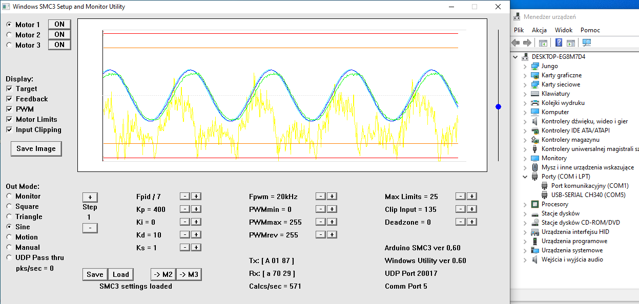

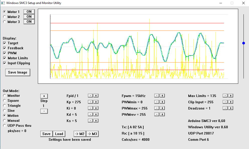

    I've been currently building a 2dof rig for quite a while now, but unfortunately came across a hurdle with my main PC. The motion is not linear, it's very jerky. For some reason everything works fine on my laptop. I've read a few posts with similar issues and still haven't found a fix. Here are some things I tried doing to no avail:
    • Ground isolating my windshield wiper motors
    • Replacing my MM shield with another one
    • Replacing MM shield with two BTS7960
    • Replacing my Arduino Uno
    • Adding chokes on motor power lines
    • Replacing potentiometers with hall effect sensors
    • Replacing cables with ones with shielding
    • Replacing server power supply with a car battery
    • Soldering cables directly to the Arduino
    • Adding gas dampeners
    • Trying different USB ports
    • Removing every other USB device
    • Removing my GPU and running my PC with integrated graphics
    • Connecting my PC power supply to a different outlet
    • Reinstalling SMC3 and SimTools
    • Running the .Net framework fix utility
    The next thing i'll do is try yet another PC and switch my PC's PSU later. Everything seems fine in SMC3.
  2. SeatTime
    2,573
    If it works OK in SMC3, then you have successfully tested most of your hardware. Is it also jerky in-game? Also are your simtools interface settings correct?

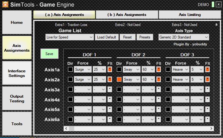

    Yes it's very jerky in game. When I try it out in LFS as soon as my car spawns in the whole motion rig jumps scratching my wood panels ;(. Here are two videos, one in SMC3 displaying a sinusoidal signal and in SimTools when i slowly move the sway slider from -20 to +20. You can imagine how much it jumps when slam the slider from one side to another.

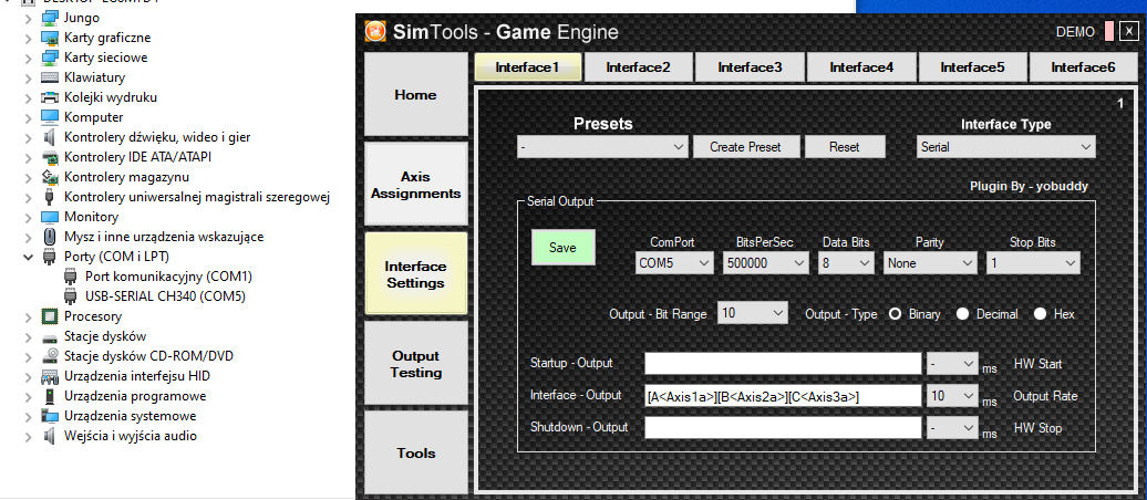

    Edit i forgot about my SimTools setting:
    21,592
    151,215Coins

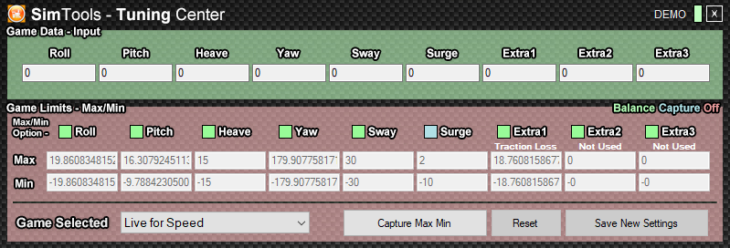

    The videos need to be made public on YouTube, they are currently private so can't be seen.
    It is generally not a good idea to use filters until the main motion profile is fully sorted. Filters should be regarded as the final tweaks, once everything else is sorted, see the tips here: https://www.xsimulator.net/community/faq/steps-to-create-a-motion-profile.228/
    Can you please include the Tuning Center settings.

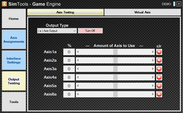

    Can we also see the settings for the Default profile, as that is what is used for Output Testing.

    Here are my Tuning Center and Default profile settings. Also I added the filters since I had nothing to lose. They did make the motors less audible.
    21,592
    151,215Coins
    Looks like you need to capture the Max/Min TC values, including for surge, then tweak from there. I would expect most of those values will be much lower. It is not unusual to use a larger Min than Max for surge, to simulate gear changes, but yours are excessive. Leave that gear change tweaking until last.
    So to recap, the Default profile is what Output Testing uses, don't use filters for now and check the motion again in Output Testing with sensible default Axis Assignment values.
    Do follow the tuning tips, including capturing TC values: https://www.xsimulator.net/community/faq/steps-to-create-a-motion-profile.228/

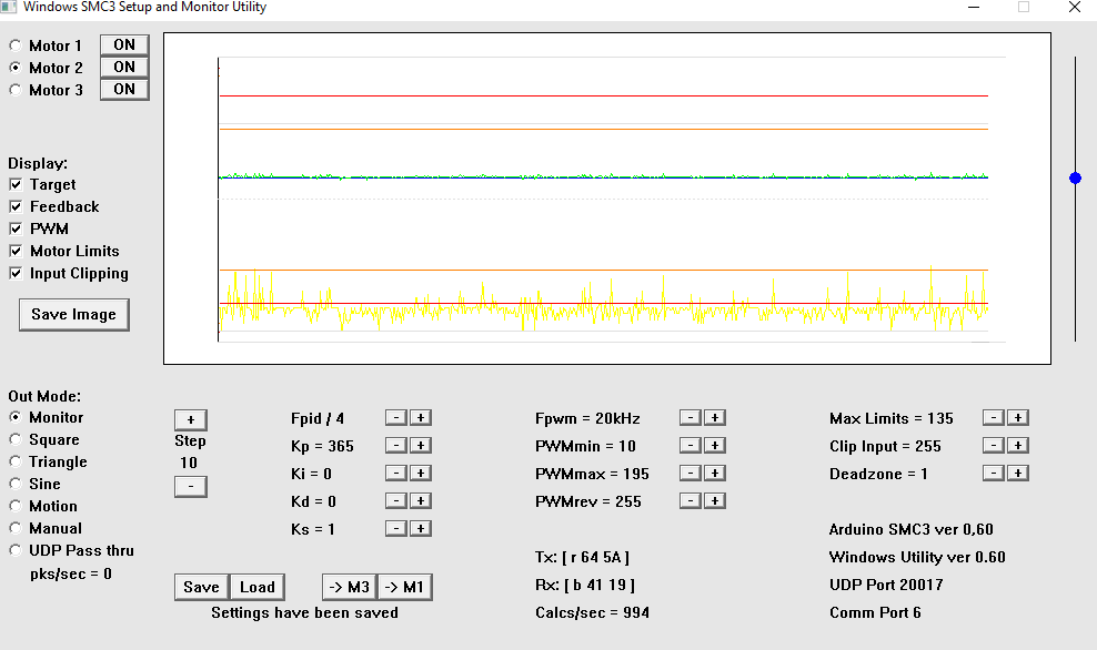

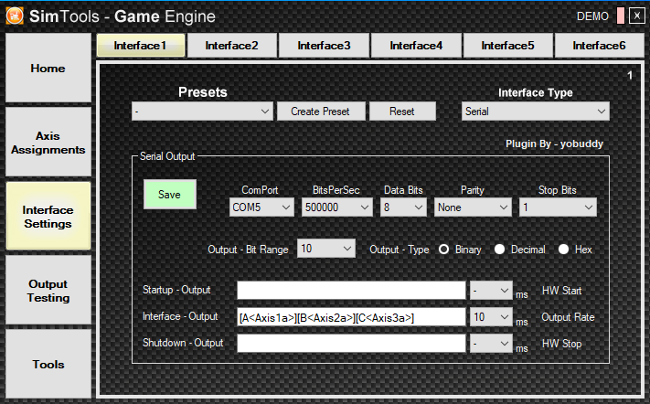

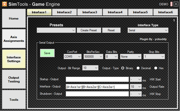

    Alright, so I did as I said but stopped at configuring the GameEngine Interface settings and went ahead and tested my (a) Axis output before configuring DOF settings. It shakes just as violently as before. It doesn't matter if I connect my filter or not.
  11. SeatTime
    2,573
    Why are you using com port 6 in SMC3, but com port 5 in Simtools? They should be the same....please set Simtools interface to com port 6.

    +13 / 0 / -0
    I just switched the ports when I was plugging in my Arduino. It makes no difference what port I use whether I plug it in my front USB ports or directly to my motherboard. I changed it back to 5 and once again everything seems to work fine in SMC3, but in SimTools it shakes.
    Edit: Sorry but I can't change it back to port 6 since I reconnected my USB cables in different slots. There are two USB 2.0 slots which I haven't tested so I'm going to do that now.
    Edit 2: I checked the USB 2.0 slots and as I suspected there is no difference. It seems it doesn't matter which USB port I use.
