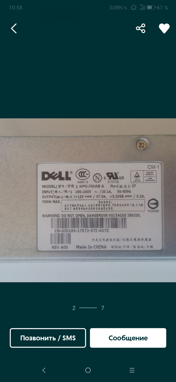

    Unfortunately, with my 100 kg, I cannot carry out tests, settings (the power supply goes into protection, there is not enough current)

    I just ordered a Dell 700w power supply from the server, I hope that this time it will be enough

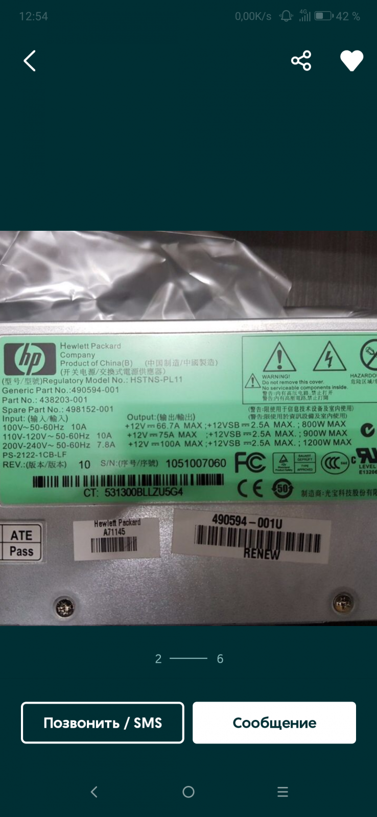

    By the way, I decided not to risk it and ordered another power supply, so that this time it was definitely enough for the future))
    Took a server unit HP 1200 with 12 volts 100a

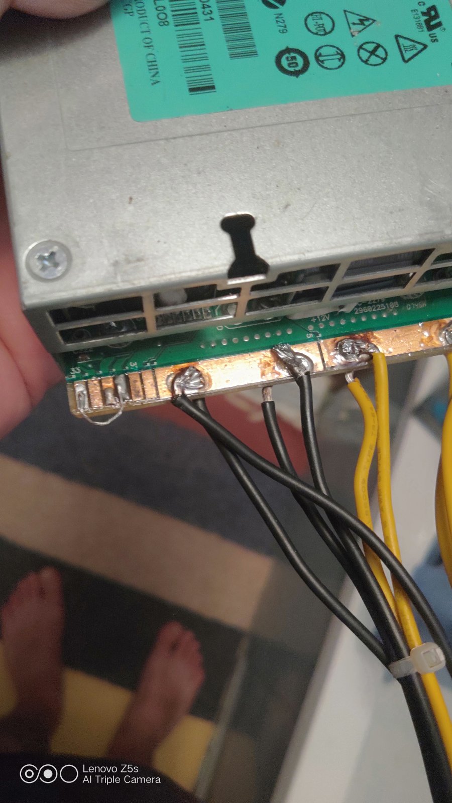

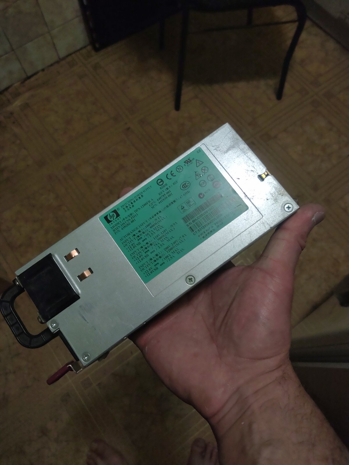

    I finally got the power supply. It is much smaller and more compact than I imagined, now I understand that I made a mistake when using power supplies from a PC.
    I had to tinker a bit with it while I started it, first I soldered a 1kOhm resistor to 33 and 36 terminals, it did not start, then I just put it with a jumper and it worked .. I used 1.5 mm2 wires, 2 for (-) and 2 for (+), total 8 wires for 2 motors, it was specially soldered in different places to distribute the load evenly, until I connected it to the simulator, I will immediately write a post about its work

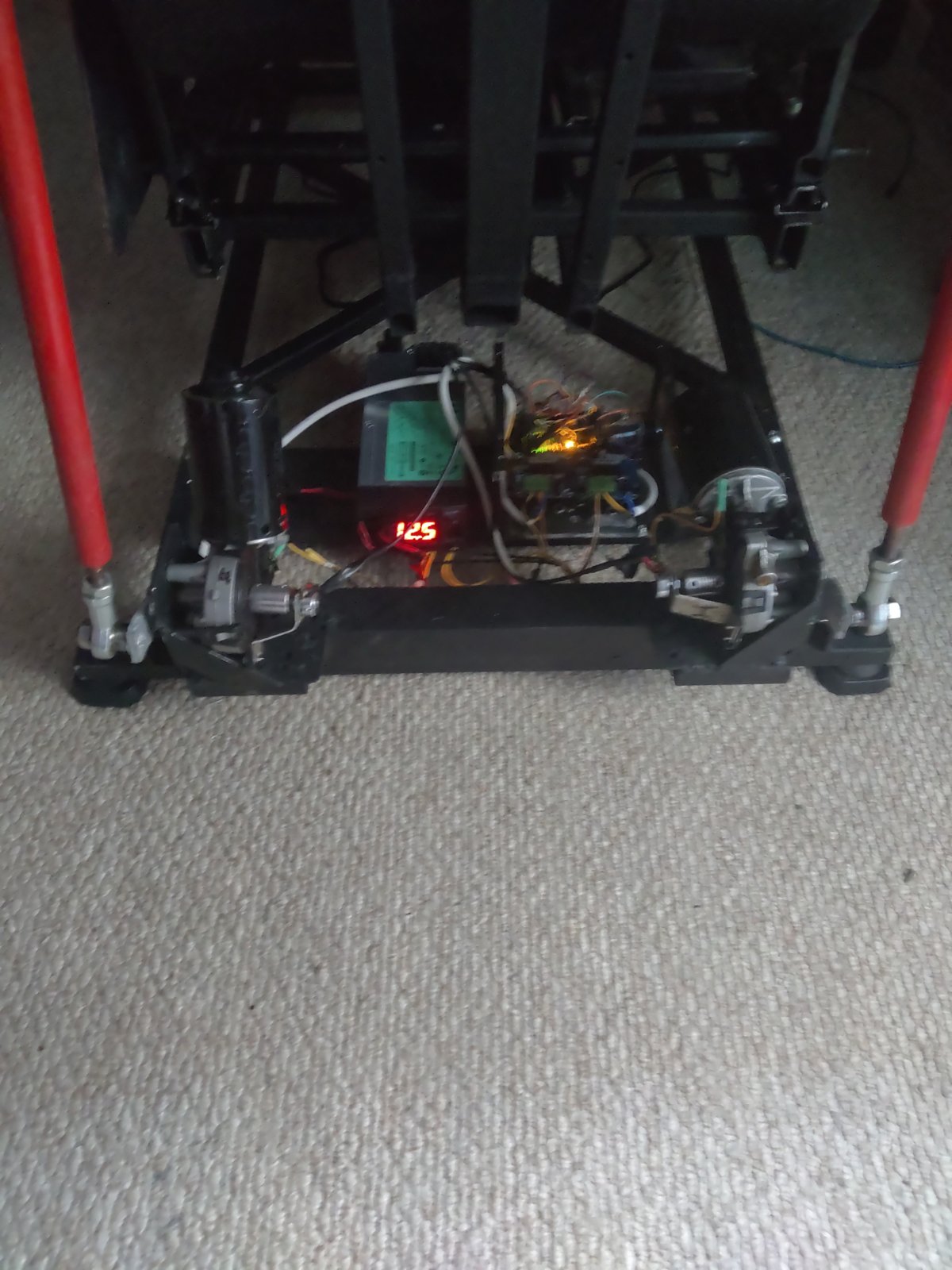

    I can finally start setting up simtools,
    The power supply works perfectly, it is very quiet and powerful at a price of $ 10, this is the best option, when setting pwMmax 230 and pwmrev 200, the voltage is kept at exactly 12.5 even at 0.1 does not fall.
    I feel now waiting for me a long time of settings ...
