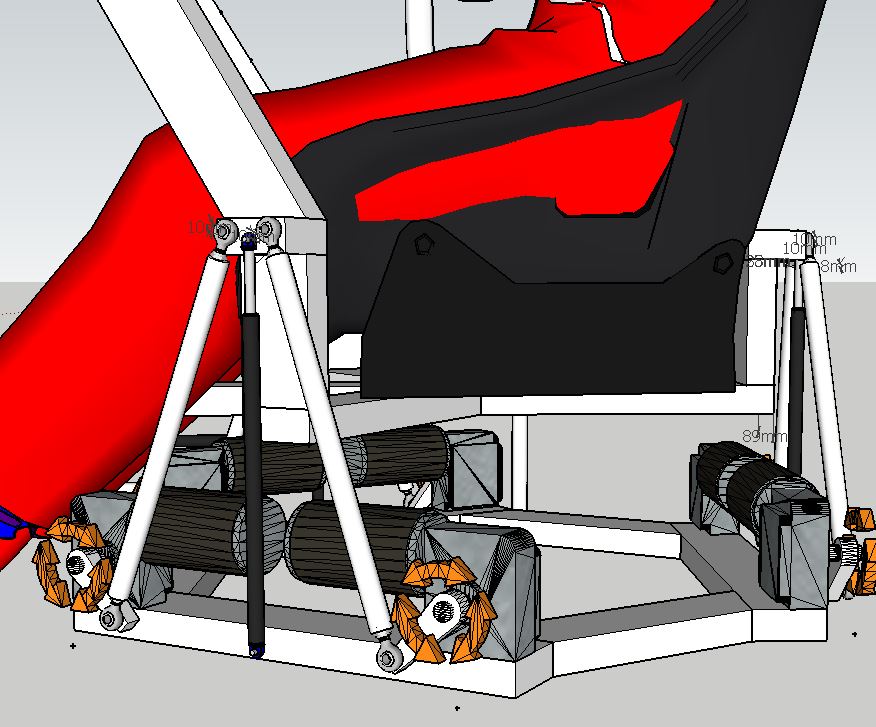

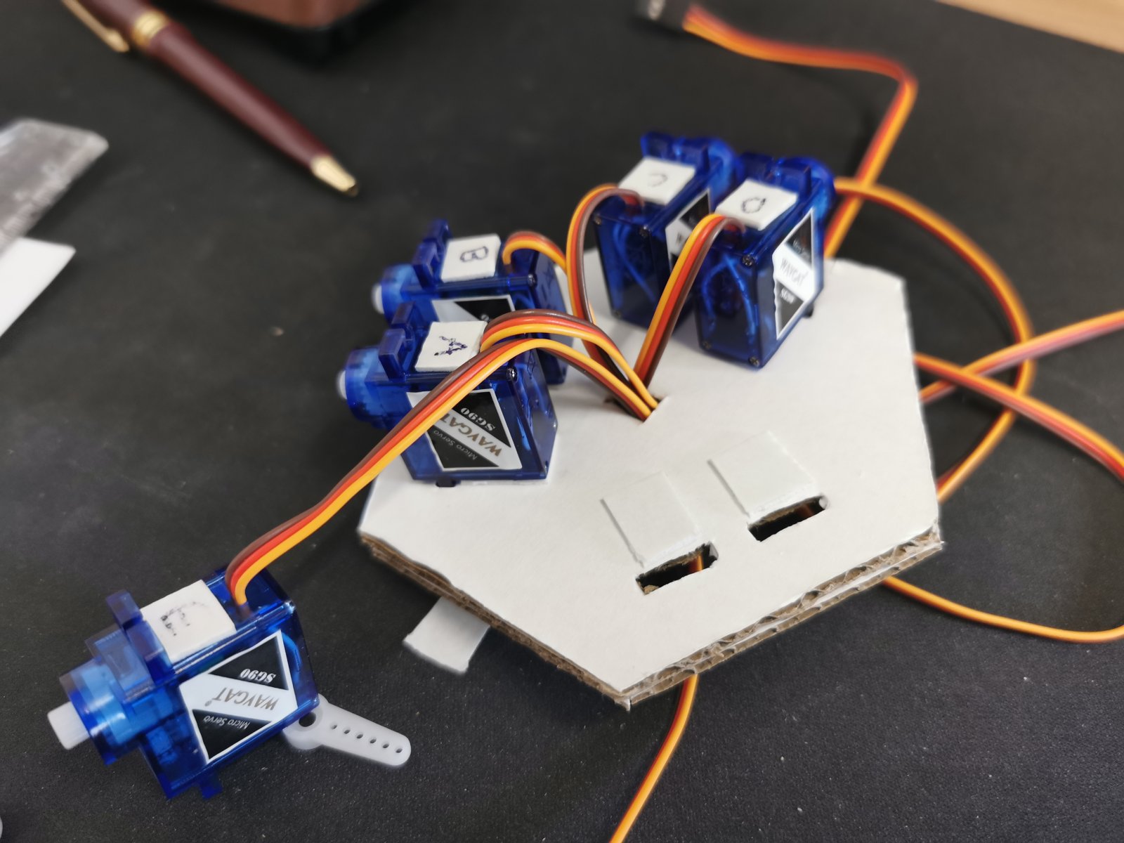

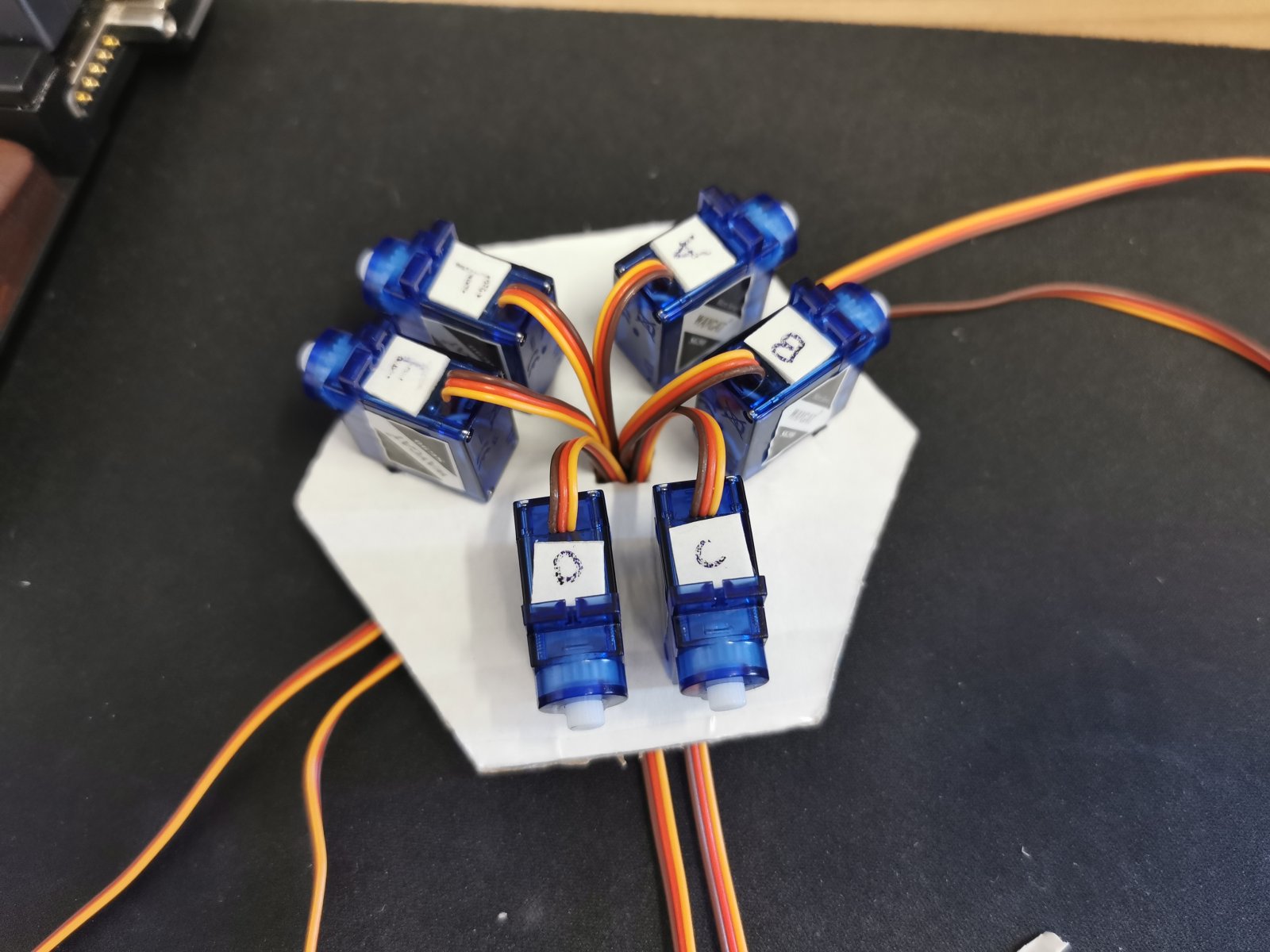

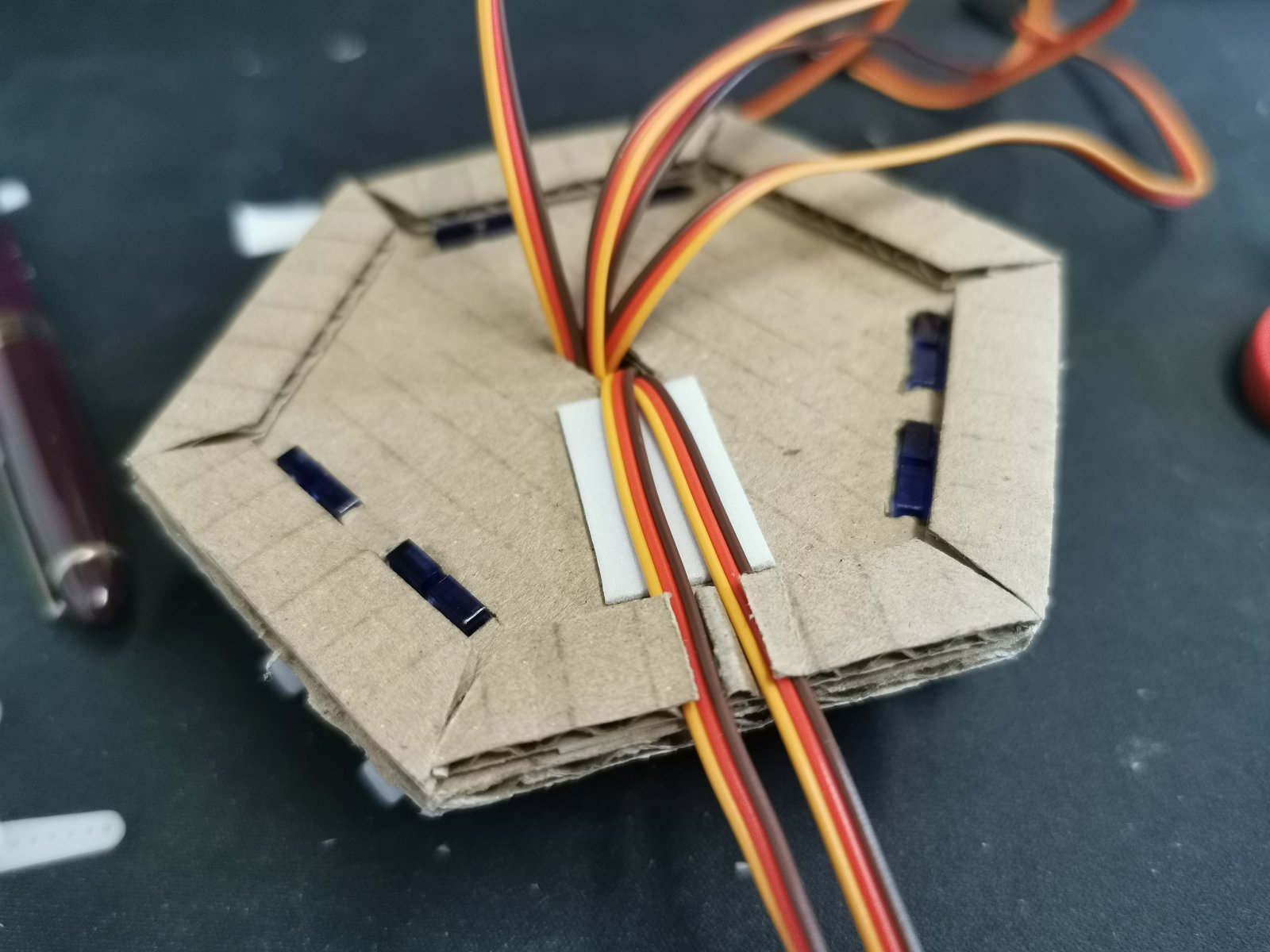

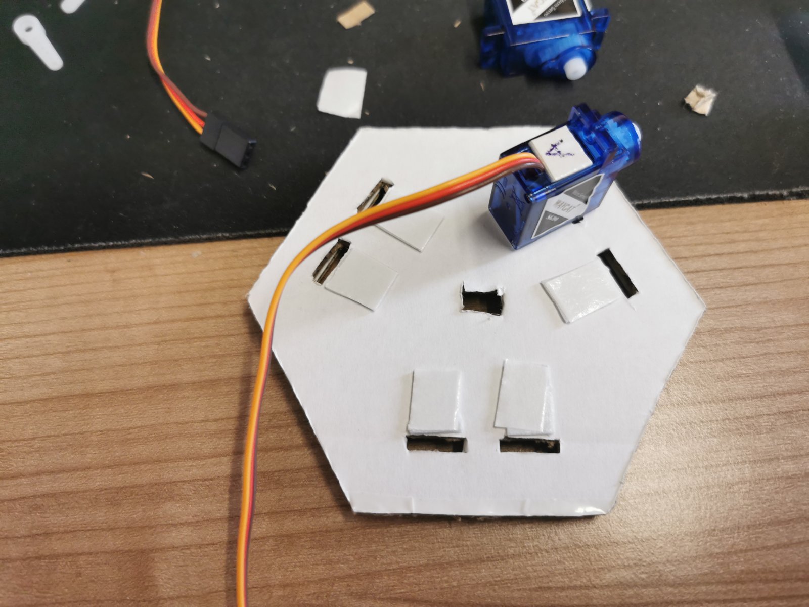

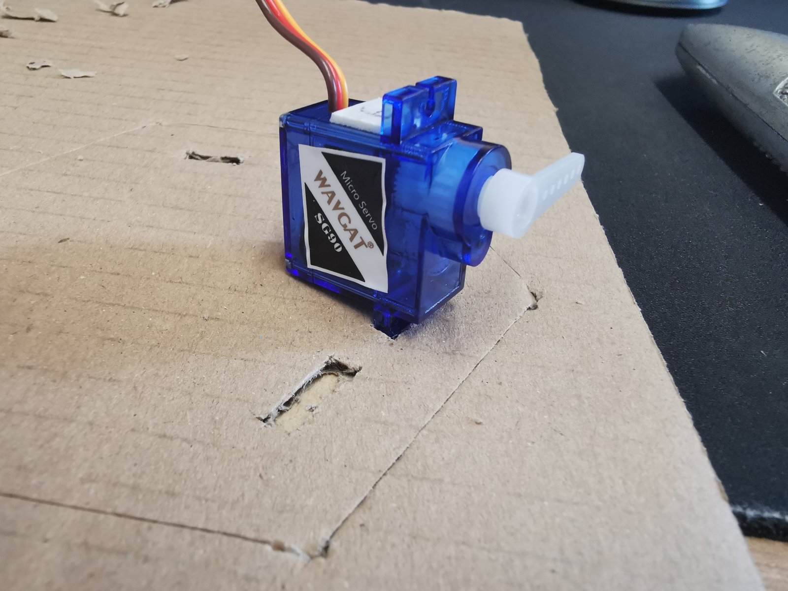

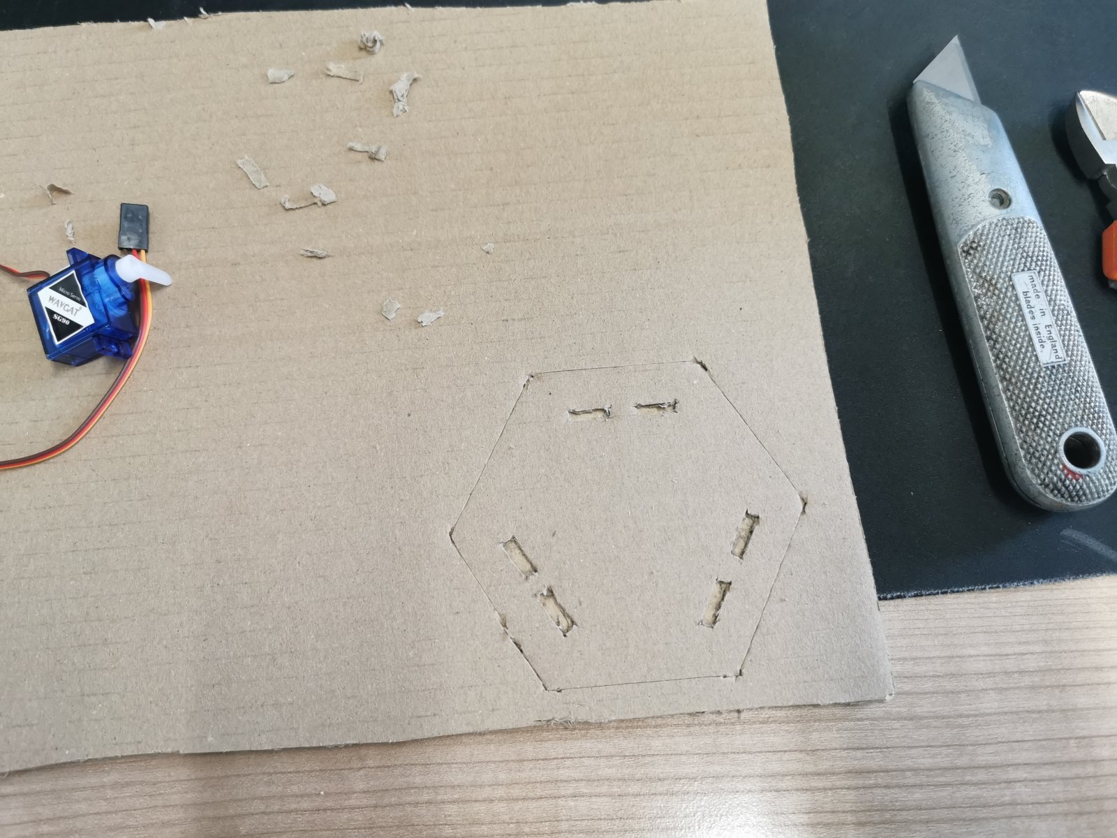

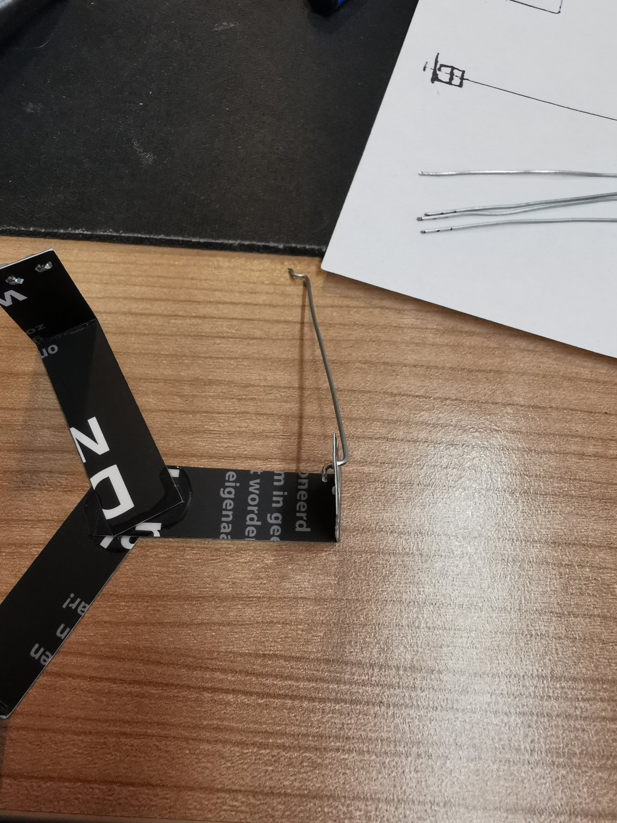

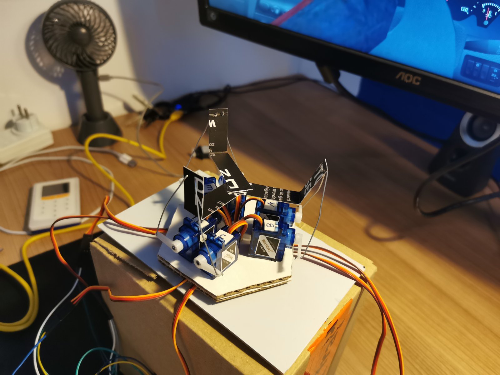

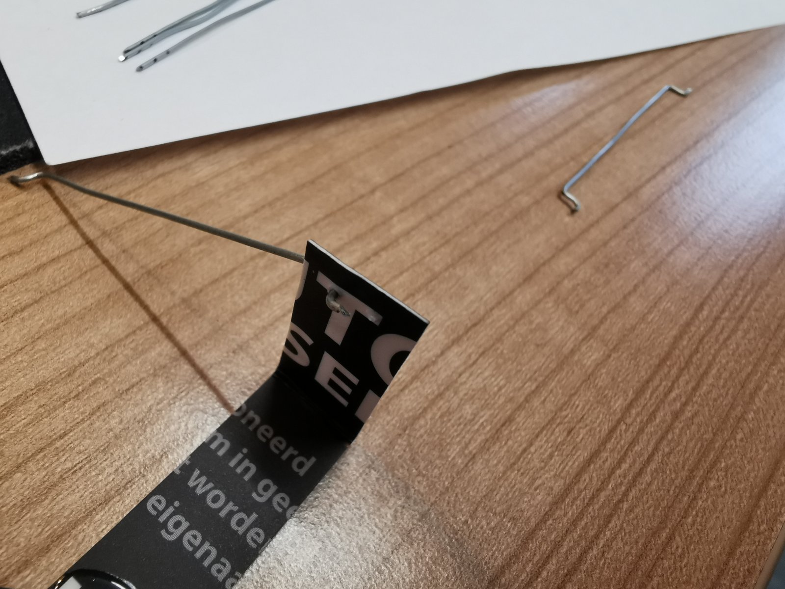

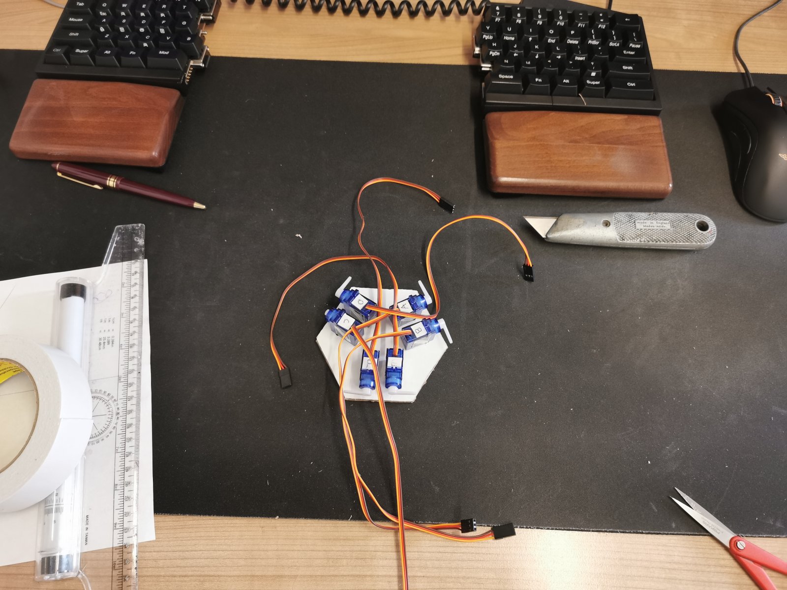

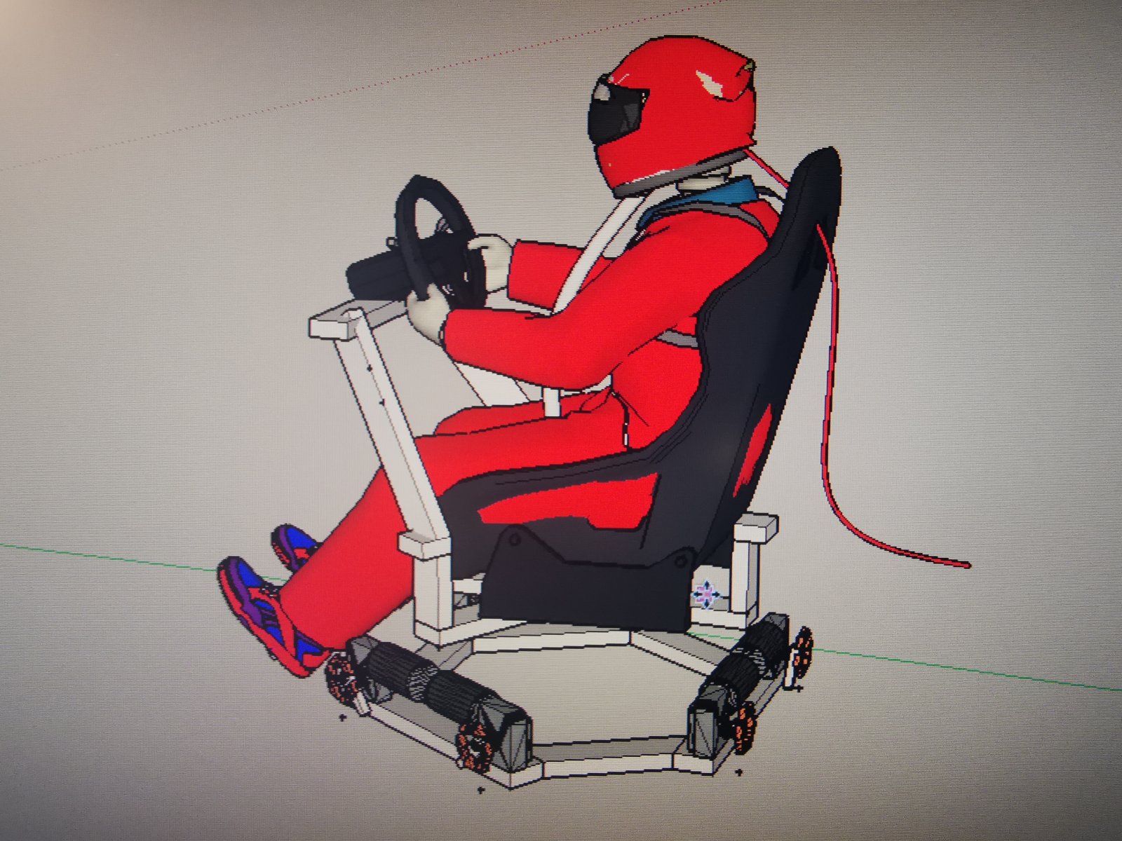

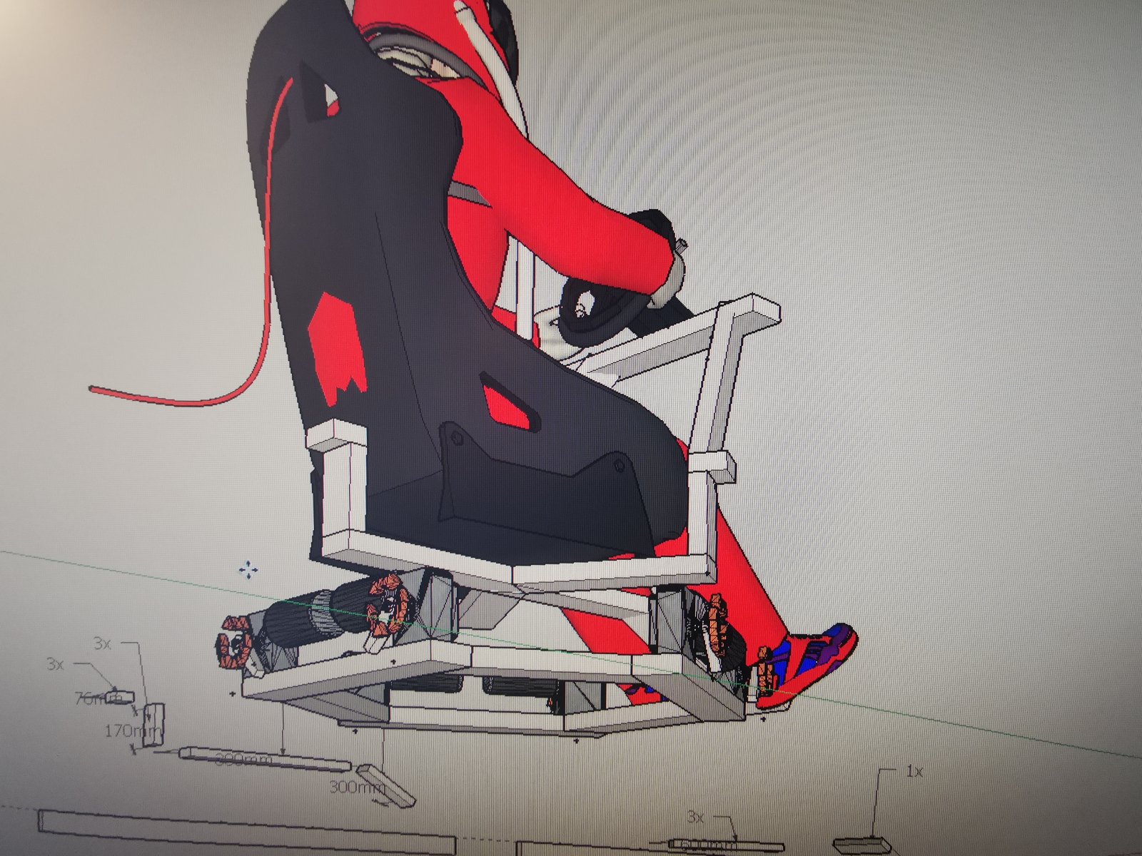

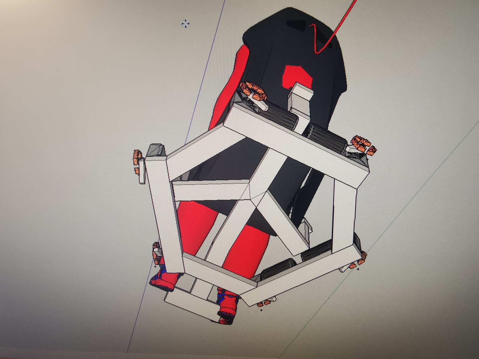

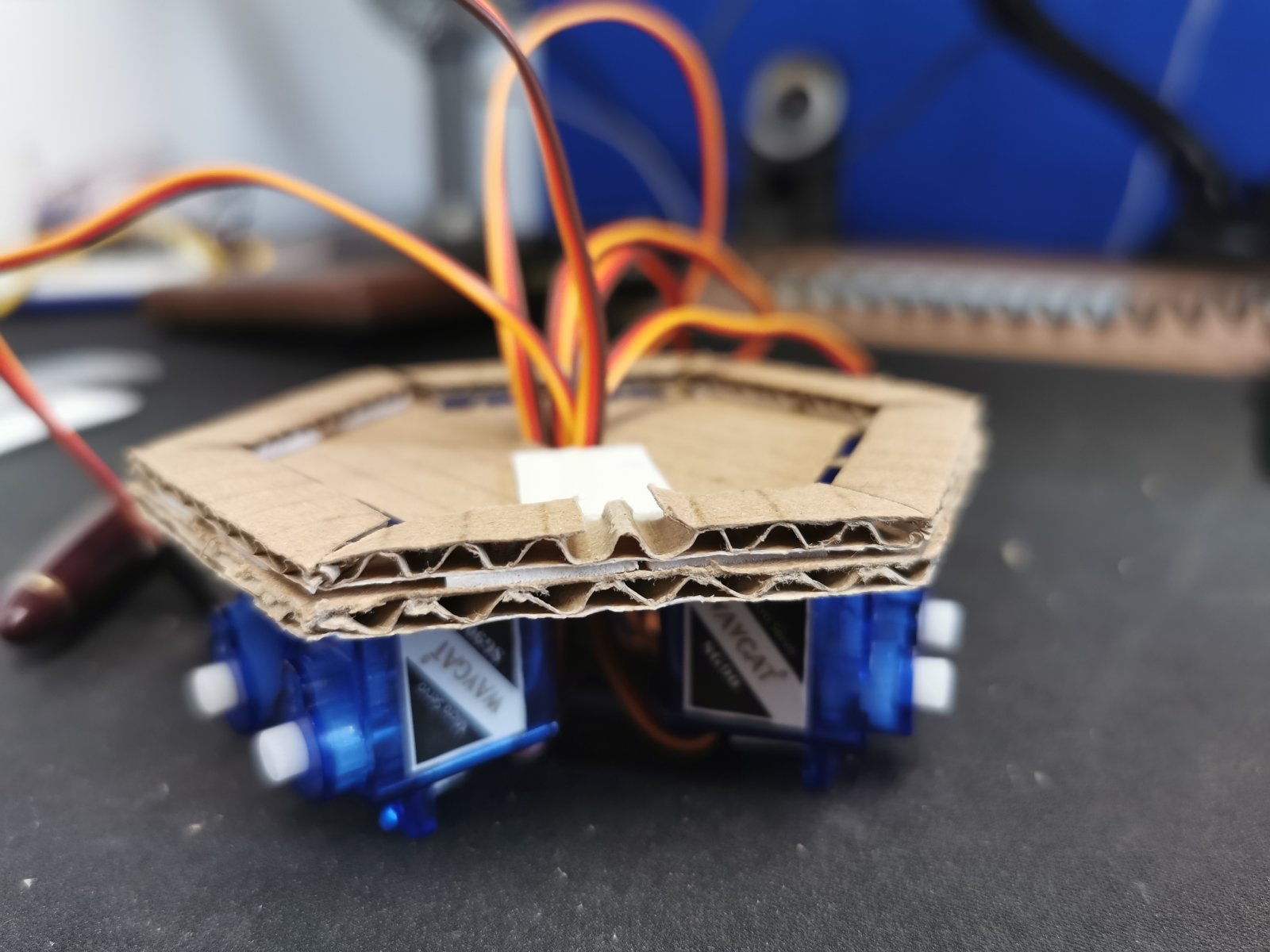

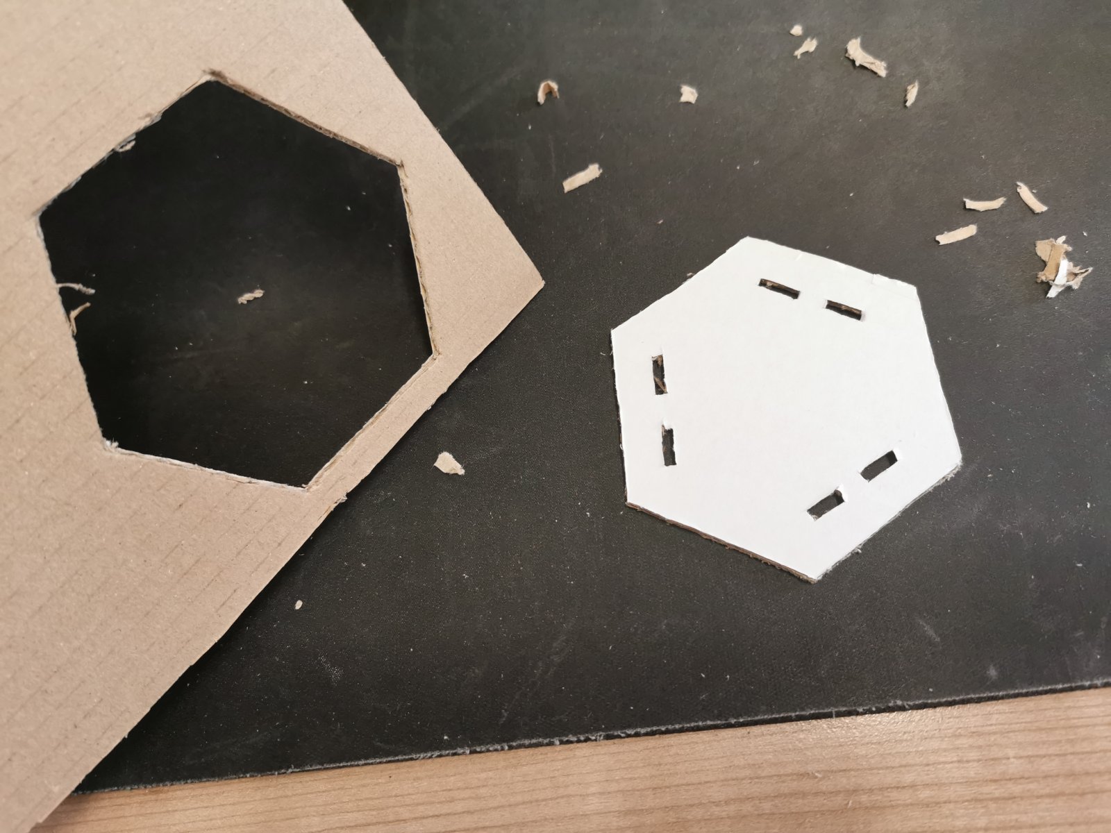

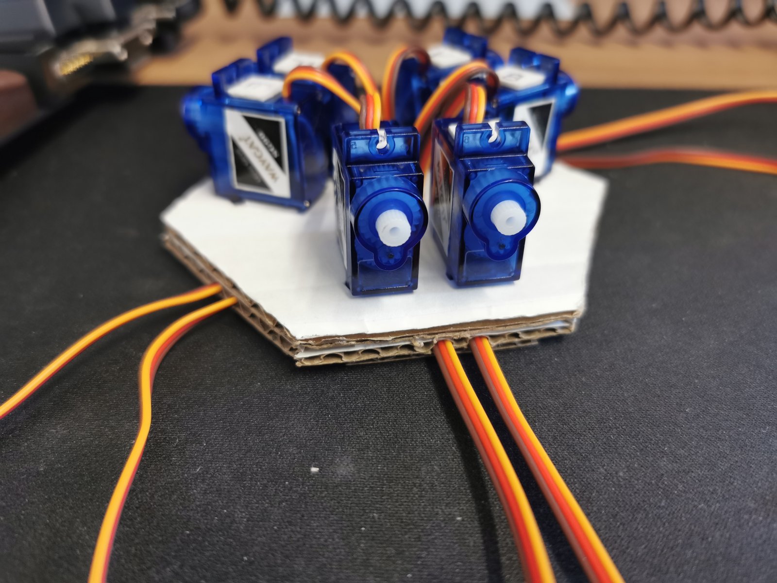

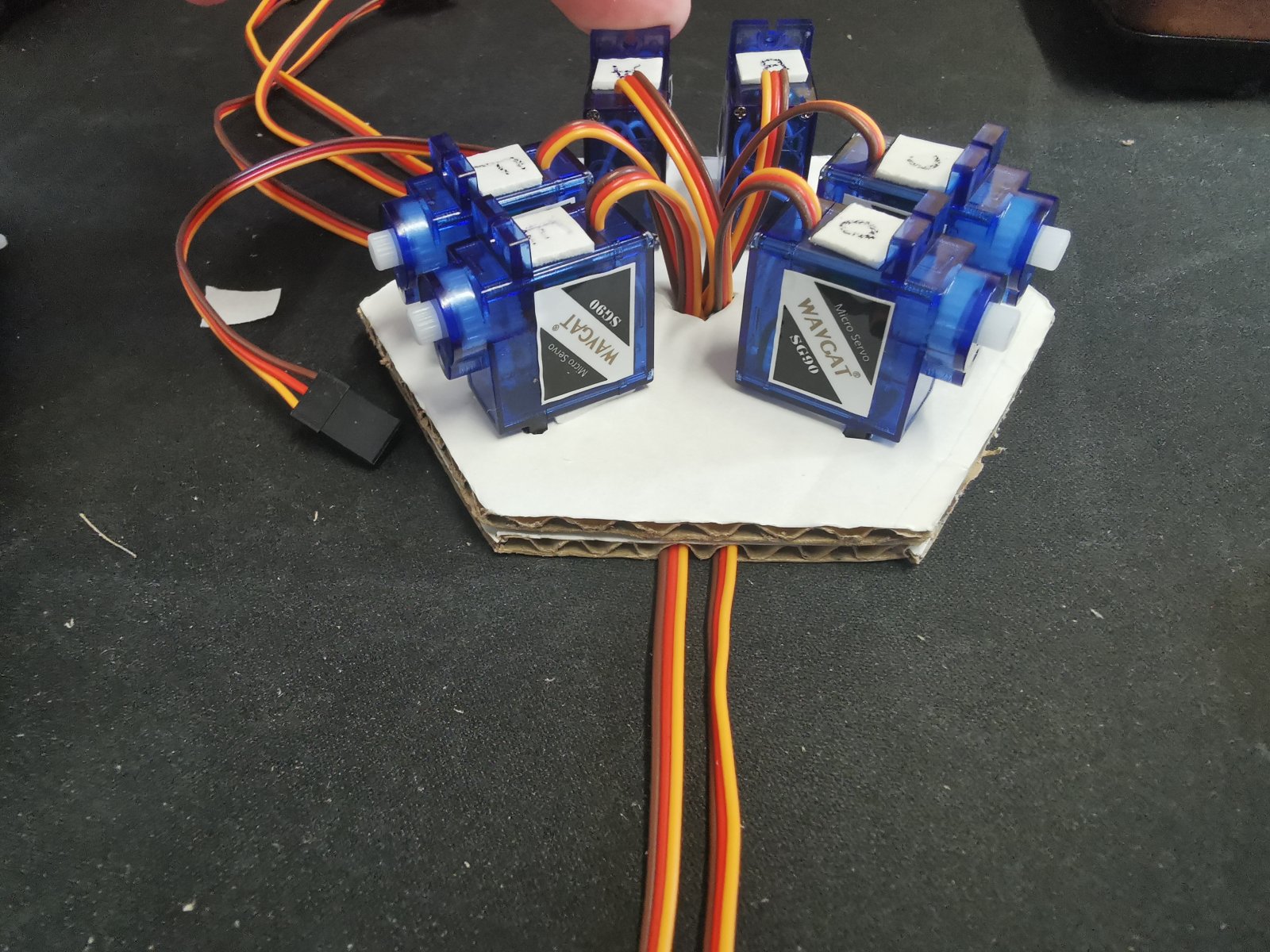

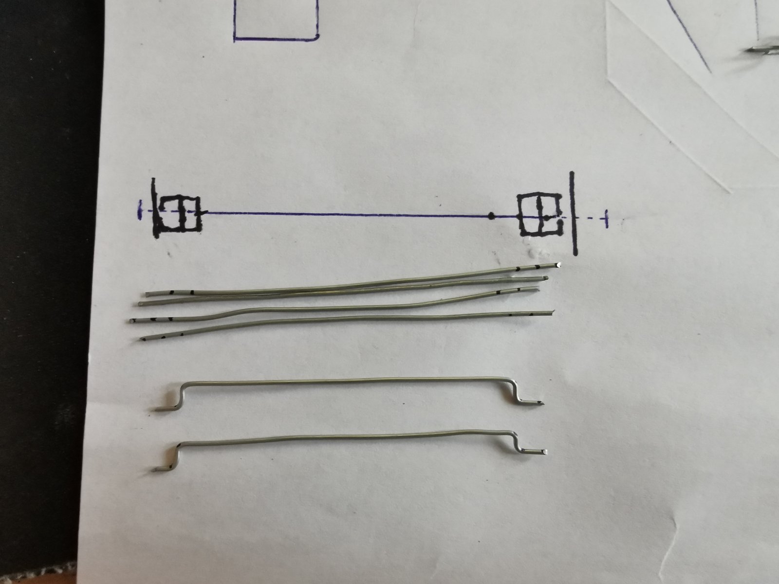

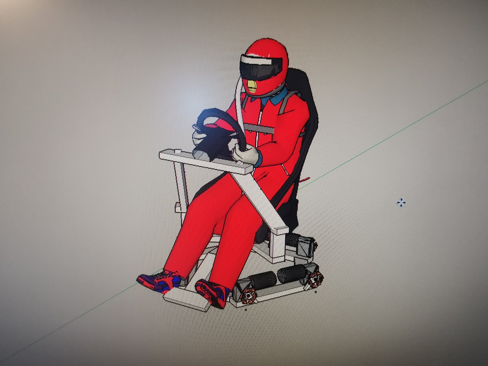

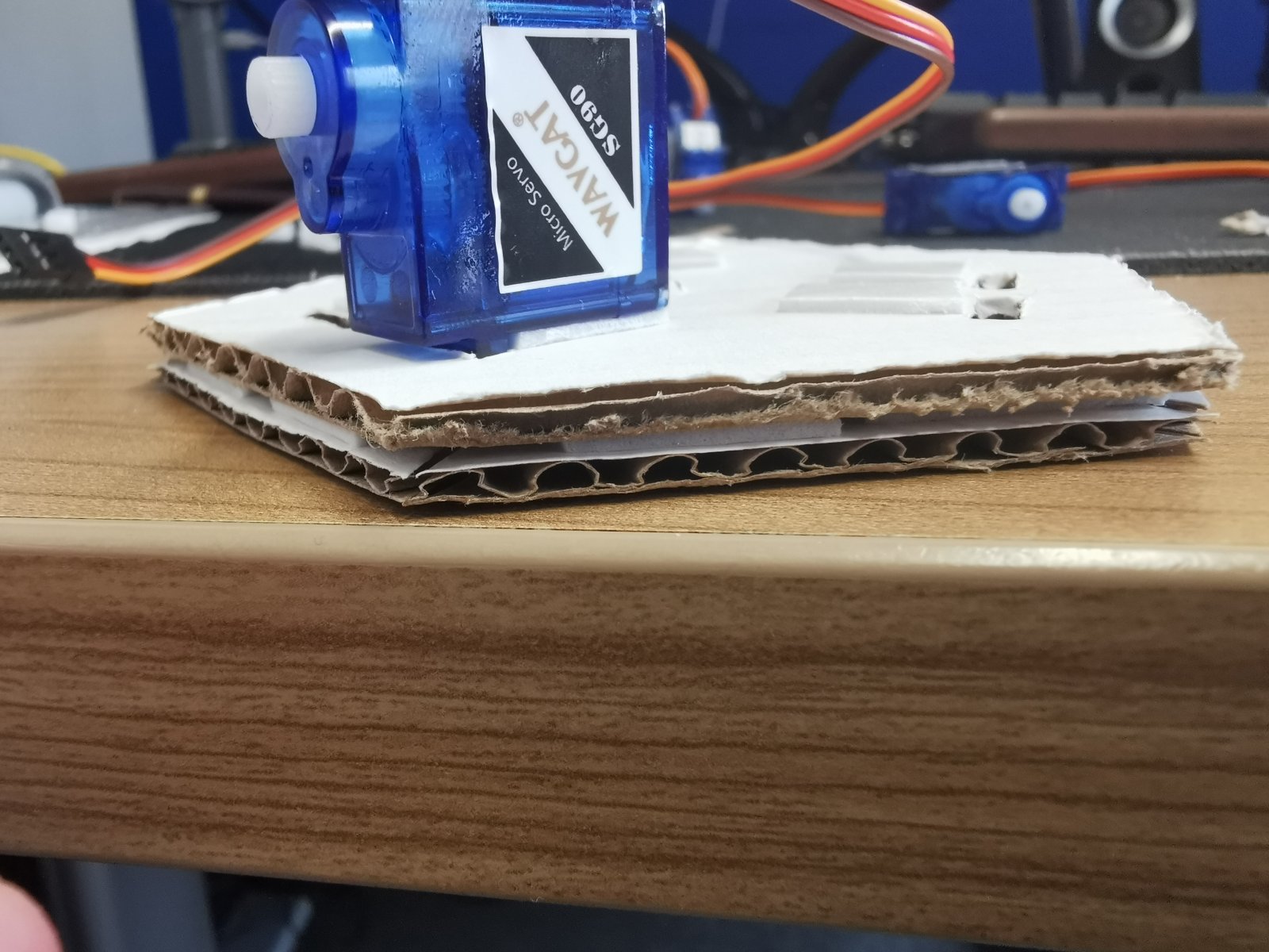

    Hi everyone,
    I did a ton of research and looked at many designs. I wanted a small footprint 6dof simulator. I didn't want to use actuators (to much noise in my opinion and would make the footprint larger as far as I could see from other designs). Please see the pictures of my small prototype with 6 small servo's. I also made a design in sketchup. I do not have decided on which motors, drivers, poti's and PSU to use for this project, and perhaps I can get some help with choosing these. I already have a DC motor so I could start some simple testing with a motor driver and a potentiometer (yet to order at least 1 of both). Then I can write some code and do tests see how everything works because all of this is still new to me. I am a programmer for many years so I think it shouldn't be a big issue to start from scratch (not planning on using SMC3 or any of that). I have done research on PID (pretty complicated in my opinion but learned a lot already), and will have to learn more about this during writing the code and testing things. Will see how that goes :o:. When all of that is working nicely I will proceed with building the frame (I will build it from wood for now). Maybe at a later time I will re-create a frame with different material.
    Of course I have a couple of question which I could use some help with.
    When it comes to the weight of the platform, I am a tall person and weigh around 95kg.

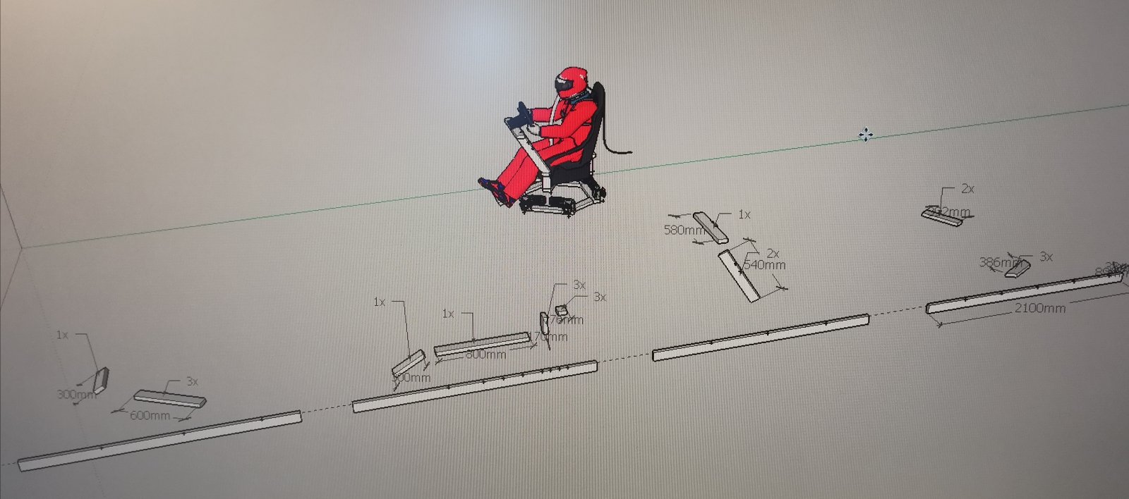

    Wooden frame that needs to be lifted by the motors is in total (LxHxW): 3798mm x 38mm x 89mm
    The wood per 2700mm weighs around 4109 gram. So in total the frame would weigh around: 5.8kg
    I do not have pedals nor steering wheel yet, but I do have a VR headset so there won't be a monitor mounted or anything. I assume steering wheel will be around 2kg, and pedals around 1kg. The chair which I don't have yet would be around 8kg.
    So to summarize all of that the total load would be around 111kg
    So correct me if I am wrong,
    but with the above it would mean each motor would require a torque of 9 N.m:
    = 111kg x 5cm CTC lever
    Note: 1kgF.cm = 0.0981 N.m in SI units
    I am not sure if my calculations are right, if someone could confirm it would be much appreciated :)
    I am also planning on using gas struts (see below picture):
    Any advice on what motors, drivers and potentiometers to use would be much appreciated. :nerd

    I have seen that controller, but I am trying to keep things on a budget (even though I have the money for it myself, I am trying to keep it as low cost as possible but still a 6dof because I want to create it for friends if it works well).
    Right now I am trying to figure out what DC motor would be a perfect fit for my design (to keep cost down).
    I had already looked at those designs you linked. I think almost all 6dof designs that I have seen on this form are much bulkier and require more powerful motors than mine. My design is similar to that of dofreality, but slightly smaller footprint.
    I also believe that because of the higher connection points onto the base the motor would require a little less force to move the base (but correct me if I am wrong).
    ps. I updated my calculations on weight of frame due to incorrect weight of wood, it was 270cm while I used mm in my math (I already had a feeling the weight was of). So total weight is around 110kg. What do you think about torque calculation? Is it accurate?

    Unfortunately DC motors are not cheap if you want them handle large loads, for 6dof you will need to be able to handle dynamic load of up to 300kg if your load calculation is 110kg (approximately 3 times the load). If you buy motors that can handle exactly the load, you will be running the system near stall conditions which means overheating drivers and cabling and higher risk of fire.

    I am not to sure about this, when I look at ac motors they are much more expensive. I have seen 100 dollar motors with 20Nm which should be fine depending on CTC. That's why I am asking if anyone can recommend some DC motors for my design. I think if I can know what dofreality is using I can use any similar motor for my project amd see how it works out.

    I think you didn't account for the cost of power supply and DC drive and possibly additional batteries/capacitors for back emf. Plus the cost of thick wiring able to handle 100A (in stall conditions) to avoid overheating). Been there doing all these back in 2007!!! 2020 now I don't want to look back in outdated and inefficient methods we had to relay upon. Back then servos cost 3000usd just for the motor, but now you can get one for 200usd!!! Isn't amazing how technology advances?

    I agree that the easiest way to do things would be to go with @Thanos method. But I am not going to. Instead I have contacted the supplier of dofreality motors and asked about their thought on what motors would be a good fit for such project. I got the email from @Mike Melga here: https://www.xsimulator.net/community/threads/newbie-starting-my-rig.15004/page-3#post-204762
    Motor specifications:
    24v
    No Load - 2000rpm +/- 10%
    Rated Power : 220w
    Rated Speed: 1500 rpm +/- 10%
    Rated Torque: 1.4Nm
    Gear Ratio: 1:25
    Rated Speed: 60 rpm +/- 10%
    Rated Torque: 26 Nm
    @T R Para I agree on this, but I just really want a 6dof. If I won't succeed, I will have 6 motors so I can scale down to 3 motors for a 3dof system and build 2 of them. One for myself and one for a friend.
