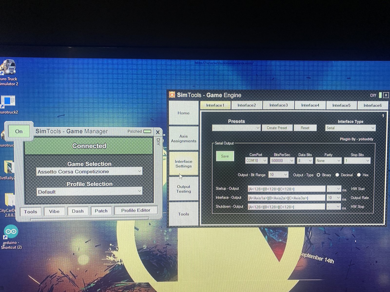

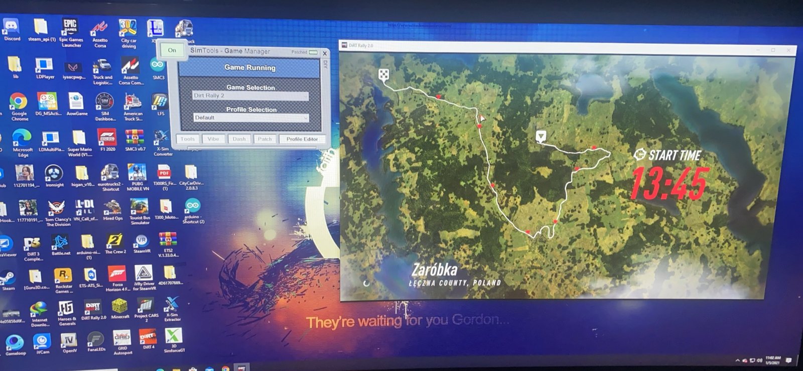

    Hello, I got troubles to make my SERIAL 2 DOF motion working with Assetto Corsa and rally 2.0. I work fine for LFS games but with the other game, game manager and game engine detect de game are running and are on, but no motion at all.

    Does the patching in Game Manger say successful when you patch a game for motion and if so does the rectangle top right turn blue and say Connected when the game runs?
    If the patching goes OK but Game Manager does not connect when the game is running then unpatch the game, temporarily disable both the Firewall and Antivirus, then repatch the game to see if either was interfering with patching.

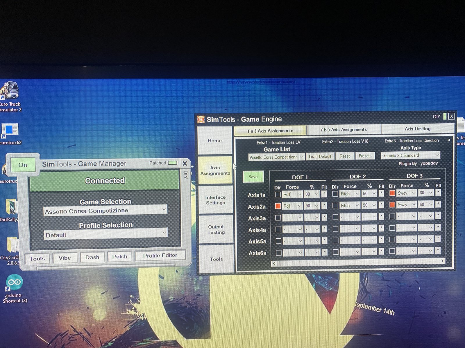

    By the looks of your settings, which need work, you will have to do some profile refinement, so grab a copy of the SimTools manual and keep it handy for reference: https://www.xsimulator.net/community/faq/rtfm-start-with-the-official-simtools-documentation.117/
    Then check out these motion profile refinement tips: https://www.xsimulator.net/community/faq/steps-to-create-a-motion-profile.228/
    Currently your Axis Allocations are way too big: https://www.xsimulator.net/community/faq/axis-assignment-percentage-totals.120/
    And the DIR check boxes for sway should be the opposite of roll, with sway leaning away from a corner.
