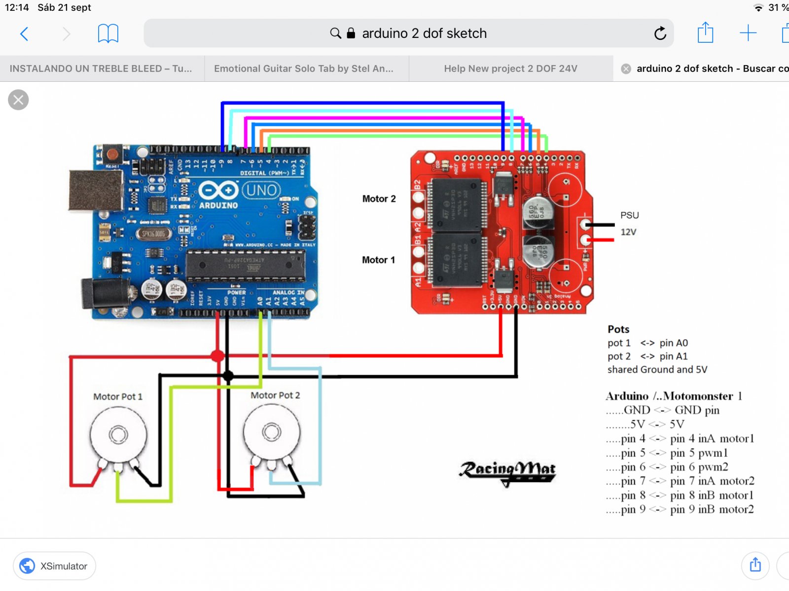

    dear all i'll start to make a project of a 2DOF with arduino uno and shield i need the scketch of arduino i need some help to start, i see a lot of post and for me it's clear the conetion, the only point that i have doubts is the shield exit that in all of pictures put 12V and the arduino sketch thanks in advance for your help

    403FF735-8009-4289-B9F2-AC08FAF86D85.jpeg Hi thanks for your help, I charge the Arduino sketch smc3 and make the conexions between arduino ,shield and potentiometers , at this step I can test if the potentiometers have movement with simtools? Or it’s necessary connect the motors? The photo is just that I make without motos
    Many thanks

    To test if the potentiometers work correctly it is not necessary to have the motomonster board connected, however, the next step is to test the direction of rotation of the motors, so it is necessary to have everything connected and follow the steps you will find in the first link to attach
