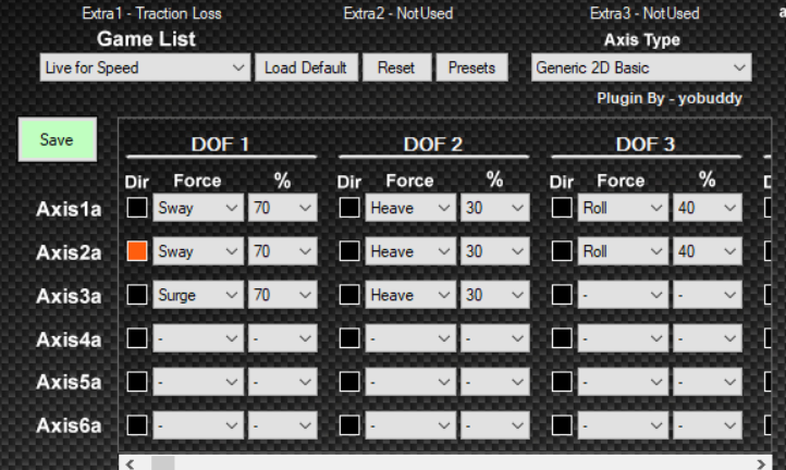

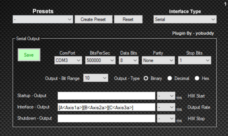

    I've set up smc3's axis assignments and interface settings. However, it's not outputing to SMC3?

    Please post pictures of all of your settings, and what hardware is being used.

    I'm using an arduino and a monster moto shield. Currently, I'm just testing with one 12v wiper motor. here are my settings. [​IMG] seettings 2.PNG

    Use 10ms as your Output Rate in Interface Settings.
    Create a Default profile in Axis Assignments and test in Output Settings.
    LFS need to have been run before patching for motion, as that generates some required files: https://www.xsimulator.net/communit...run-in-first-person-mode-before-patching.345/
    As an aside you Axis Allocation % total is going to be too high once all axis are included (roll, pitch, sway, heave, surge): https://www.xsimulator.net/community/faq/axis-assignment-percentage-totals.120/
    See the motion profile refinement tips and tricks in the FAQ: https://www.xsimulator.net/community/faq/steps-to-create-a-motion-profile.228/
    You can also grab a copy of the SimTools manual: https://www.xsimulator.net/community/faq/rtfm-start-with-the-official-simtools-documentation.117/
