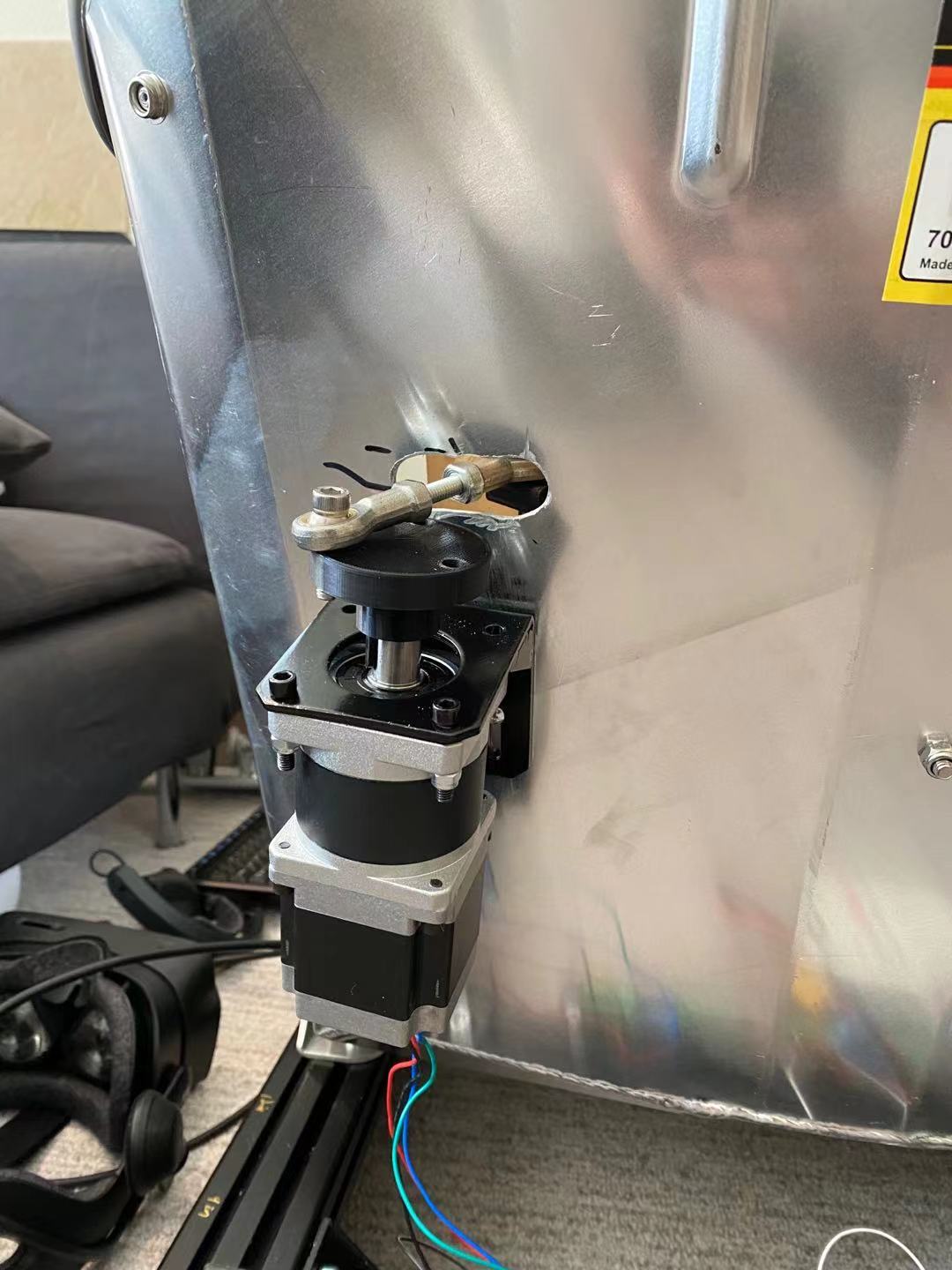

    I'm building a prototype with only back flaps and steppers(3Nm) with 5:1 gearbox. I did feel the buzzing from the steppers (maybe tunning matters here? , as people reviewed GS-5 did not mention that) The torque seems enough with 5:1 (definitely not enough for heavy brakers or for bottom flaps), but I ordered a 10:1 to see it would smooth out the steps.

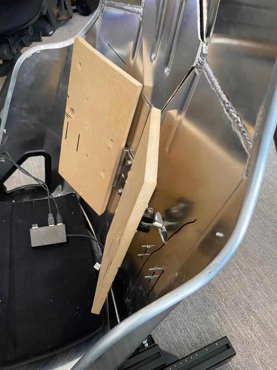

  10. Will0214
    Will0214 New Member
    Mar 31, 2020
    17
    Software Development Engineer
    Seattle & Hangzhou
    79Coins
    +7 / 0 / -0
    2DOF, 3DOF, AC motor, Arduino, Motion platform
    my very simple (maybe naive design). Please comment below if you have suggestions. Thanks! WechatIMG11.jpeg WechatIMG10.jpeg
  11. cfischer
    Sep 7, 2015
    343
    Colorado
    2,509Coins
    +241 / 1 / -0
    Looks like you're well on your way. The motor mount, gearbox, crank, and link design is the same as mine. Looks good. I will be interested to know what you think of the buzzing from the steppers. Also lets see some videos when the time is right!

    My initial thought is that it's the inhereted characteristic of the steppers. They turn in 1.8 deg a step. With reduction gearbox, it might help? We'll see when I get the gearboxes.
