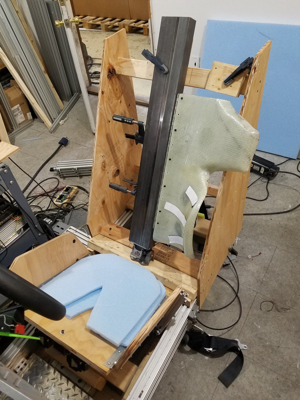

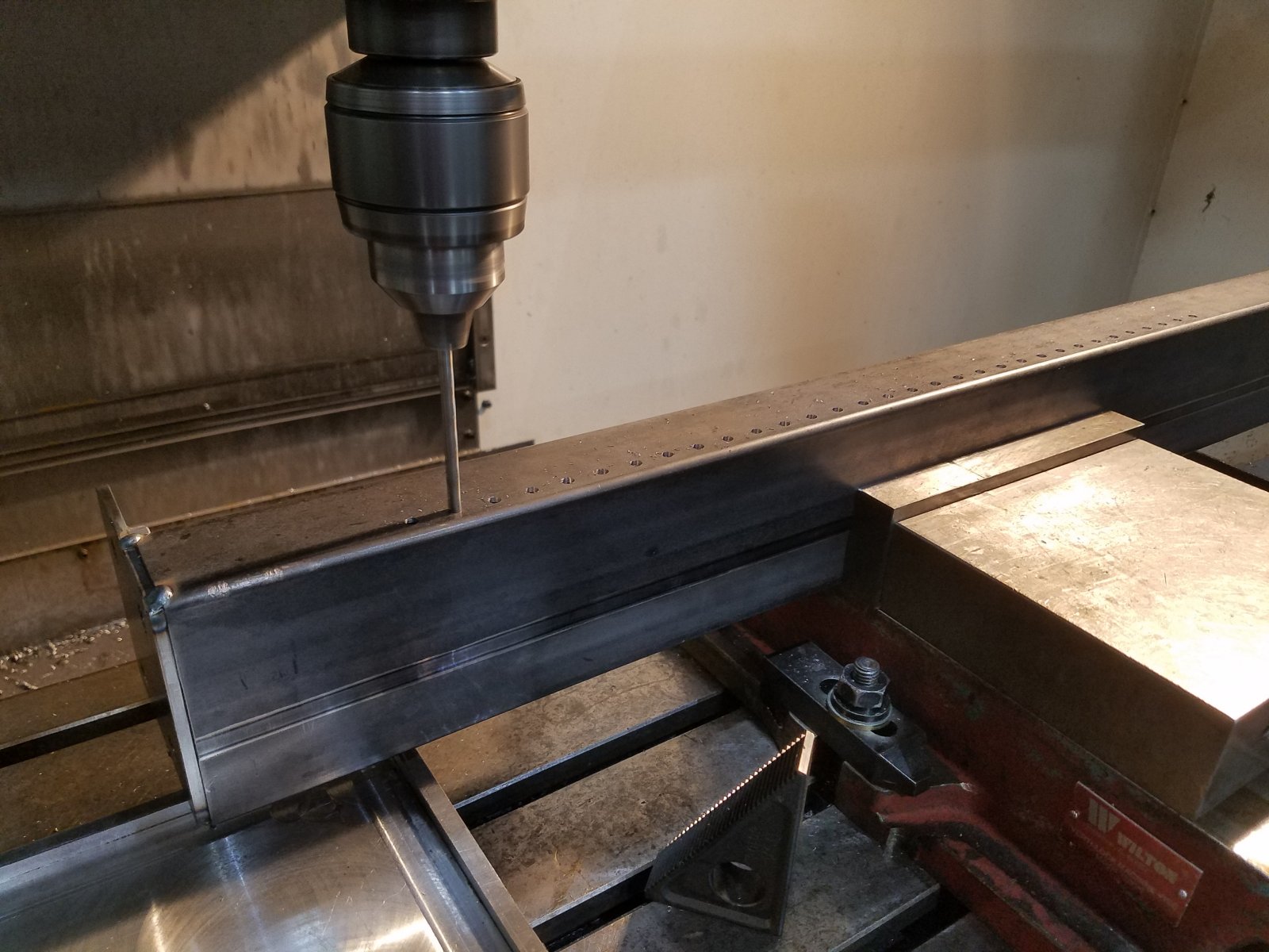

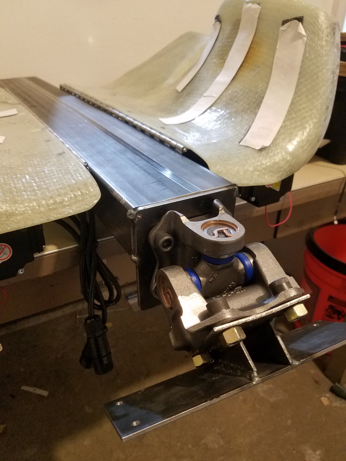

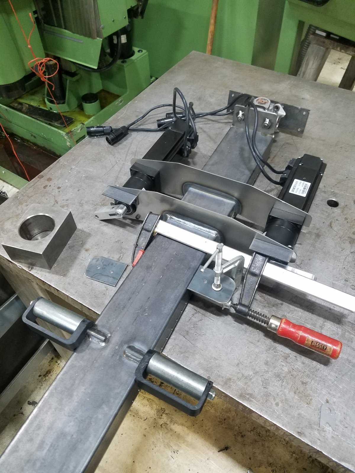

    So now onto the torso mover and planetary gearbox servos.
    Took out the old stuff
    Machined/tapped a bunch of holes in 2x4 steel tube.
    Welded on a plate for a beefy u joint.

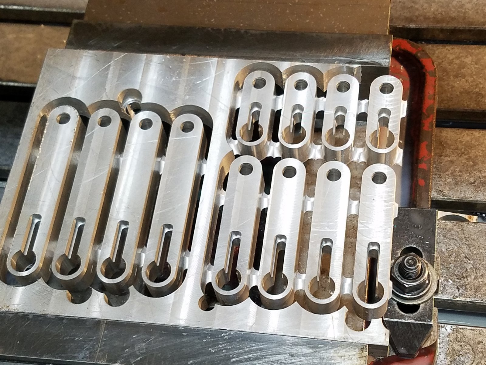

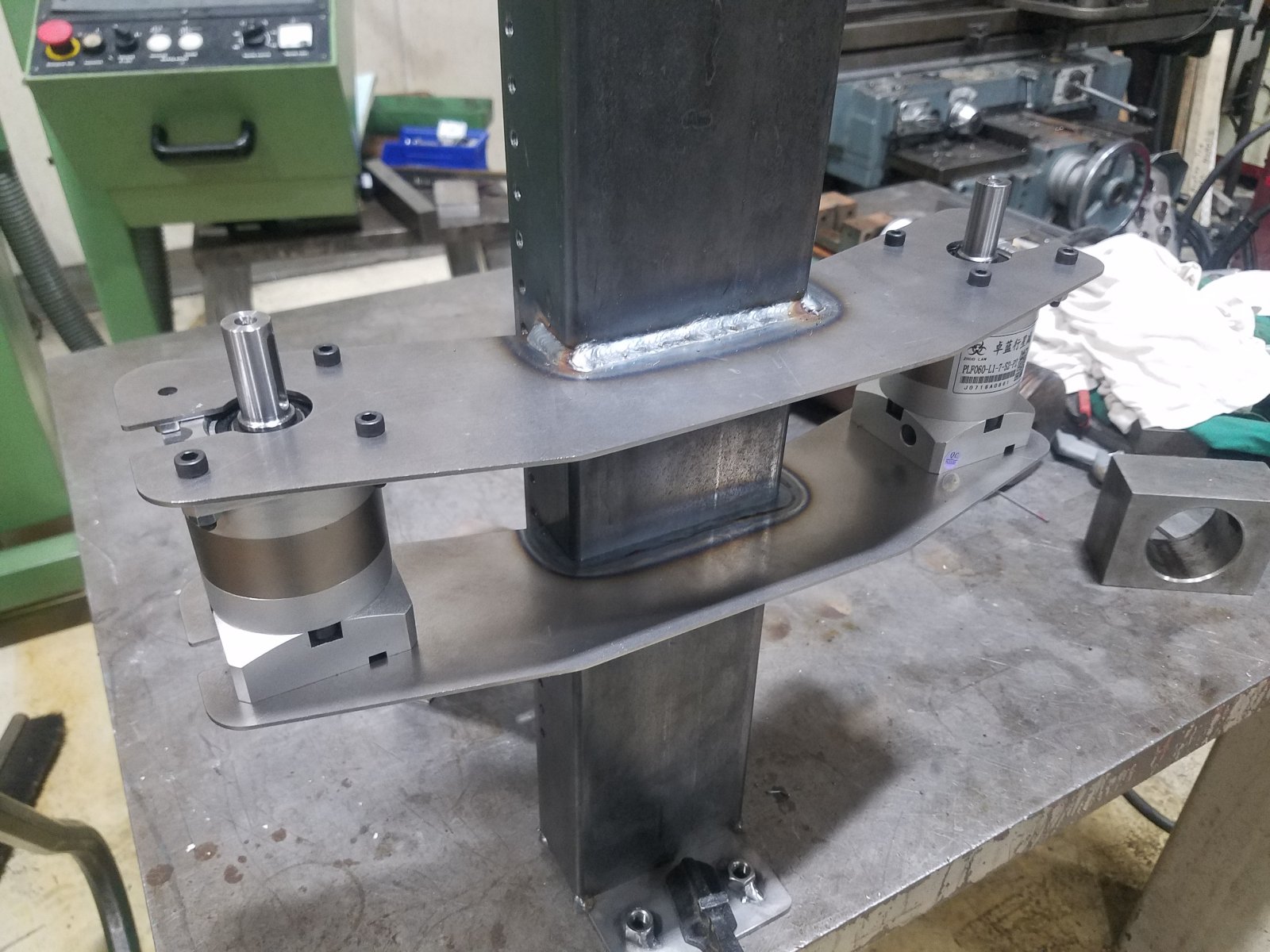

    I machined crank arms for the gearboxes, made some extra for experimenting.
    Welded on some laser cut plates to the tube.
    The bottom of the Ujoint is made to screw I to wood for now so I can quickly adjust it.
    Assembling

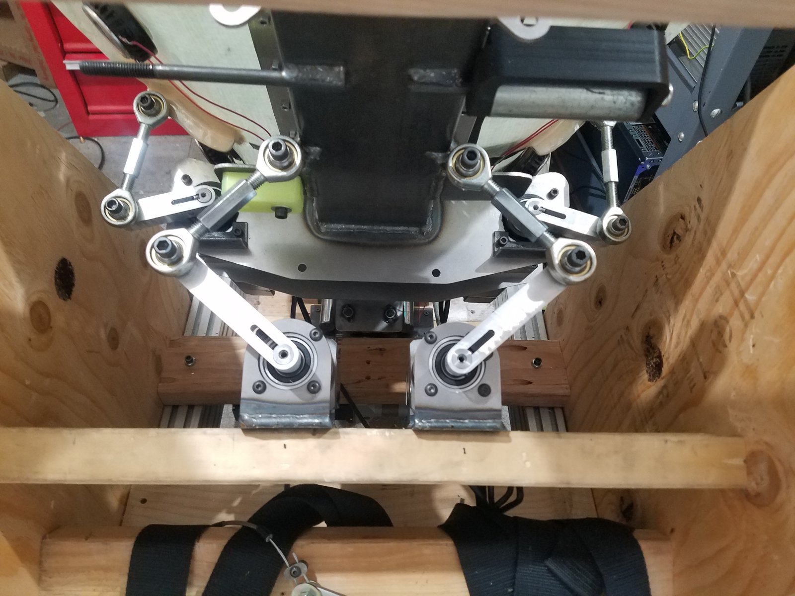

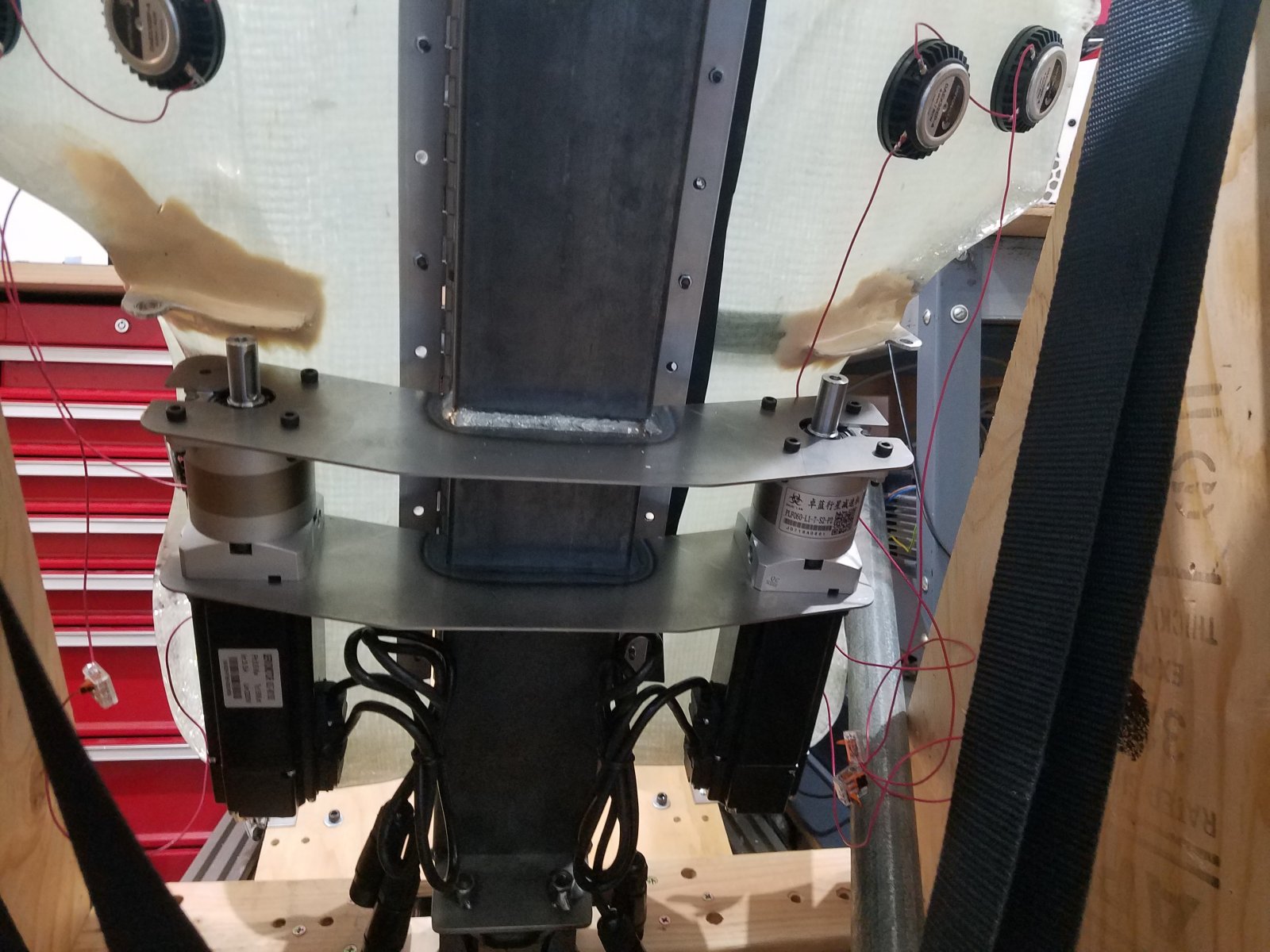

    Cranks and links
    Then I welded on some Brackets for Seatbelt and mounts for the mover mechanism

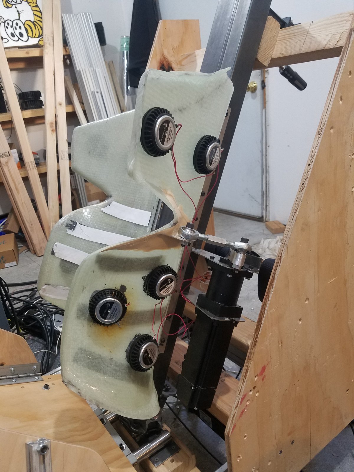

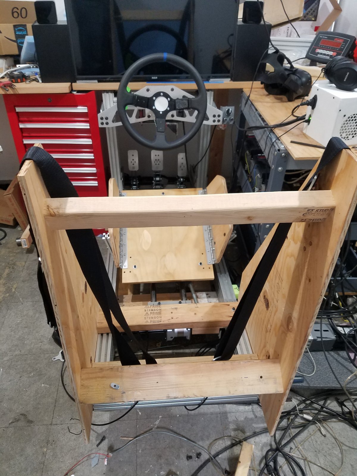

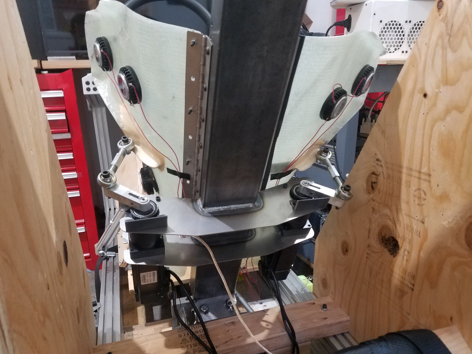

    Here are the motors and linkage for the gseat paddles and Torso mover.
    The wood plywood and 2x4 frame is nice for changing around the location of things while trying out ideas.
    The addition of the torso mover solves the false cue you get while being pushed hard from the outside paddle during a turn or getting pushed forward during acceleration.
    It works pretty well, plus it gives an excellent jolt from bumps to other cars or walls. The motors for the mover have a lot of smoothing applied while the paddles have lots of high frequency data in them.

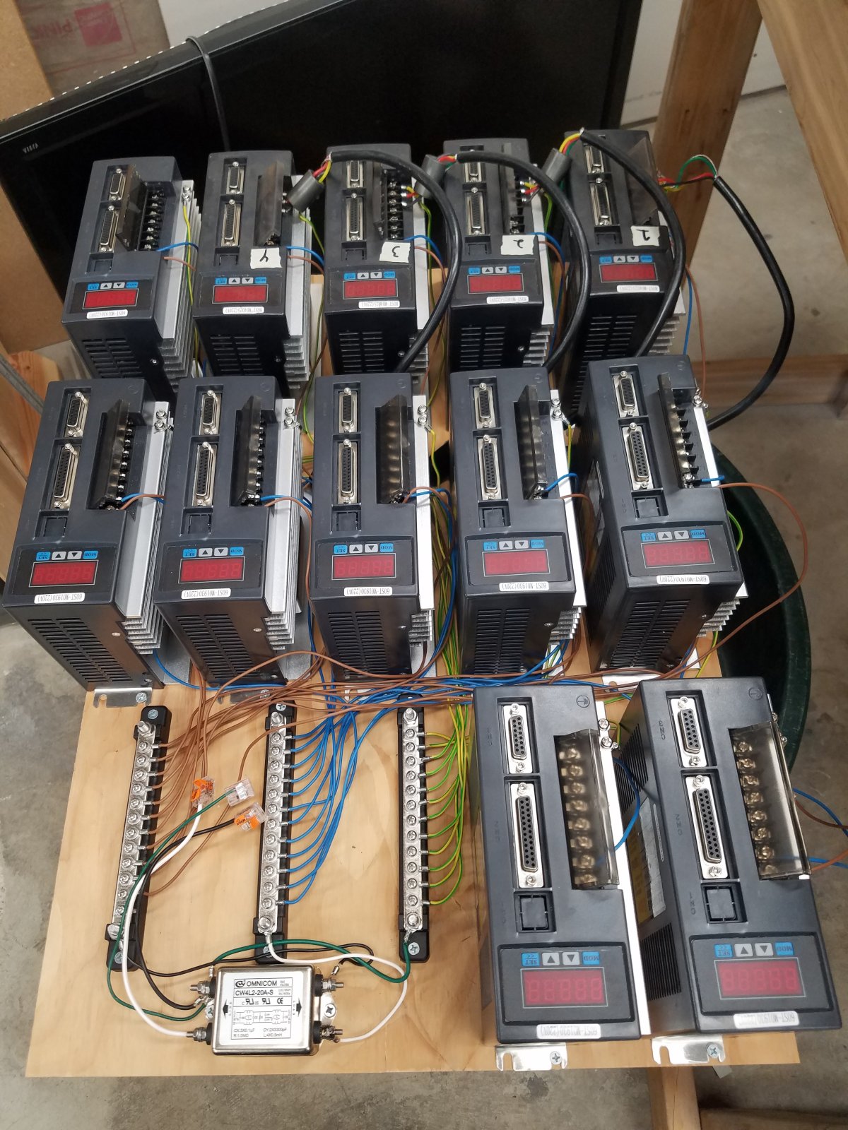

    +276 / 1 / -0
    Sure, 60ST-M01930 motors power everything you see in the later shots of the video. The paddles use 16:1 which I am considering changing to something more like 20:1 and the torso mover uses 40:1. You're going to love the servo world(I know you've already got some). Other than dealing with the damn drives that is.

    Thanks, appreciate it. I have found the AC drives to be almost plug and play compared to a high power DC setup.

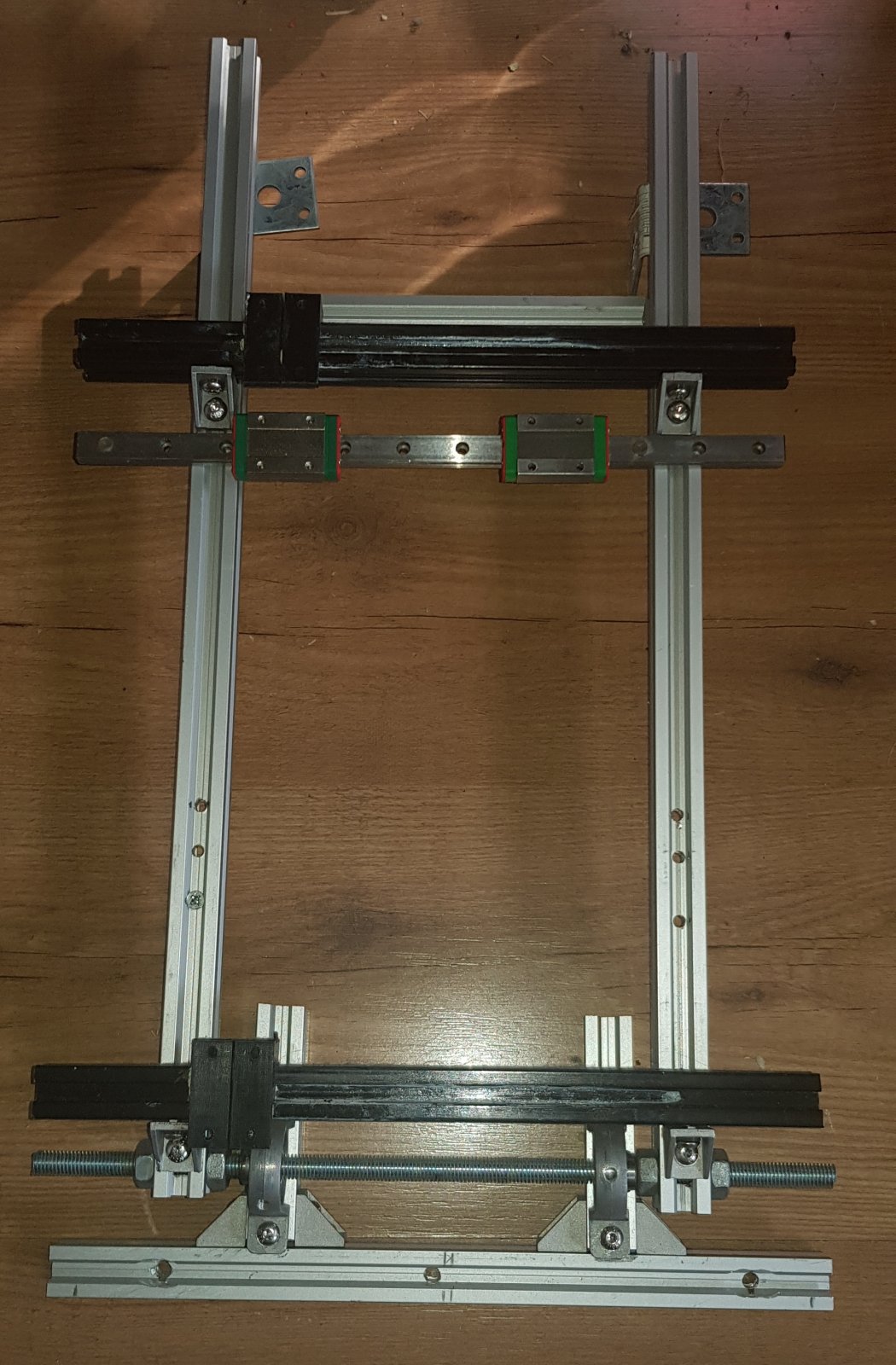

    Thanks. Whats always bothers me when using DC drives and gearboxes is the backlash and i feel like i loose a lot of detail. I dont know if its possible yet to set a minimal movement for small stuff in PT mover to overcome this lack of detail. When there is full load on the flaps you dont get it as much. Im still on the fence if i wish to use actuators or not. It makes it more complex and difficult to set up. But if im going to spend so much on it i'd love to have the detail of the ballscrews. Sadly i do not have the tools to fabricate all the brackets and arms that you do. Any chance you could make a few later on?
    Also if you dont mind me asking. Where did you get the U joint? I struggle to find the full assembly
    I dont have it on my rig at the moment but here's what i used to have and will install sliders on later. I do however find the torso mover concept to be quite nice too. In general you will tilt your back anyway so i dont think you actually need a linear slide in the back. Im seriosly considering just repurposing my 200mm 3x sfx system and go full G seat.
    The connections arnt quite strong enough with the corner brackets so it needs to be fastened better. Before i bought the sliders i used 3d printed ones inside the slots.
