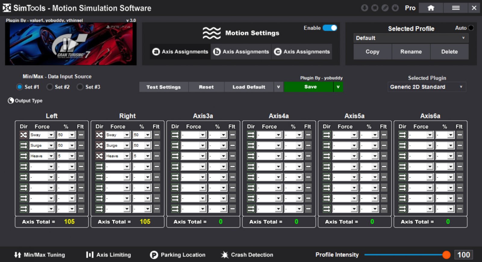

    The DIR setting determines which way each axis moves, so if an axis is moving in the wrong direction then correct it there.

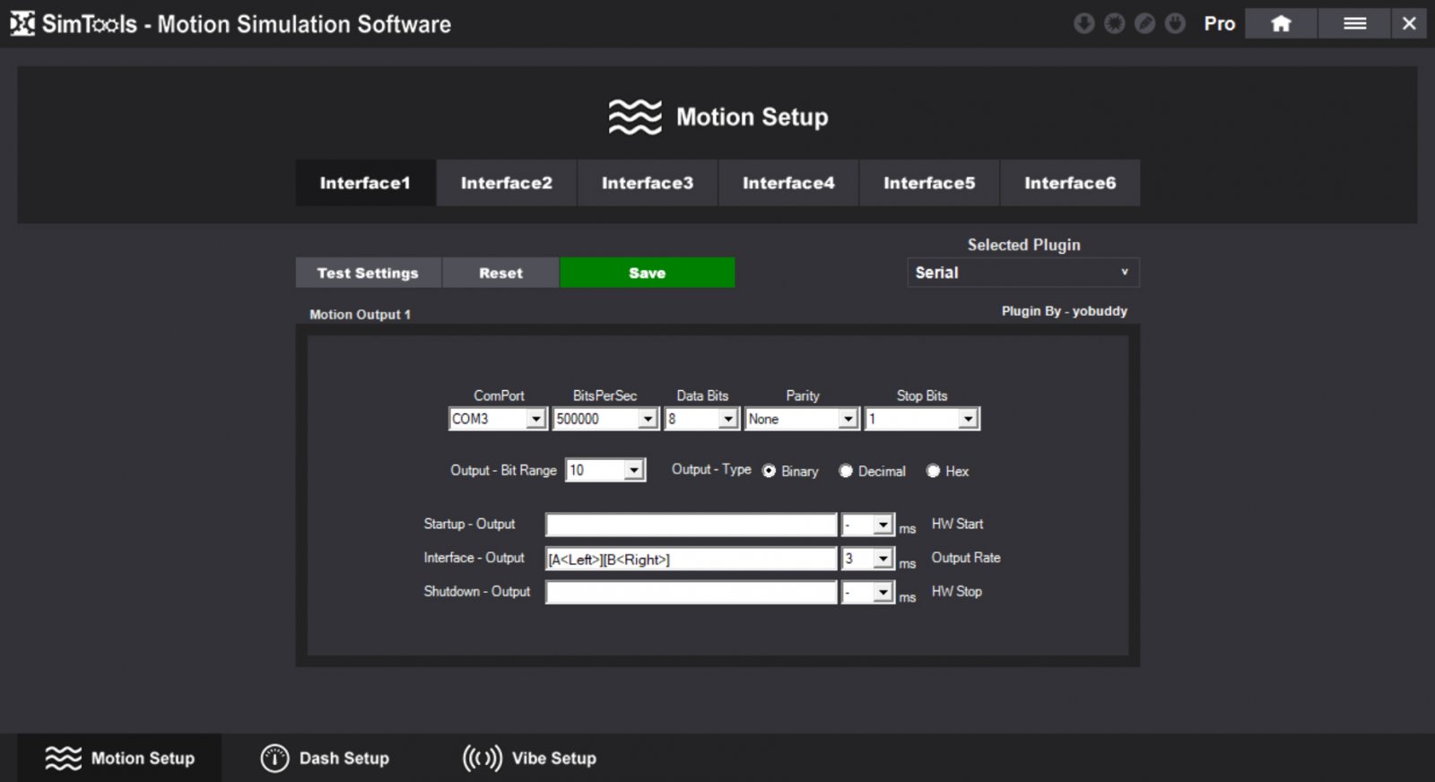

    As an aside, I don't know for sure with your particular rig hardware but you may want to try 10ms in the Interface Settings.

    I played around with the plugin from @yobuddy fot GT7 and I cant get it to work, I have always the front/back movement in the opposite direction. When I compare the GT7 GamePlugin with the one for ACC there are exactly the same settings (Sway,Surge, and Heave) but they feel totaly different. Maybe it has something to do that I have a njMotion Compact-R SeatMover and @vthinsel has a different motion system. I really dont know, and please dont be Mad at me, thats my 1st motion system in my whole Sim Career :) and what I did not understand is that I have a 2 axes seatMover 2DOF when I understand correctly, but I see always 3 parameters in each settings (Sway, Surge and Heave).
