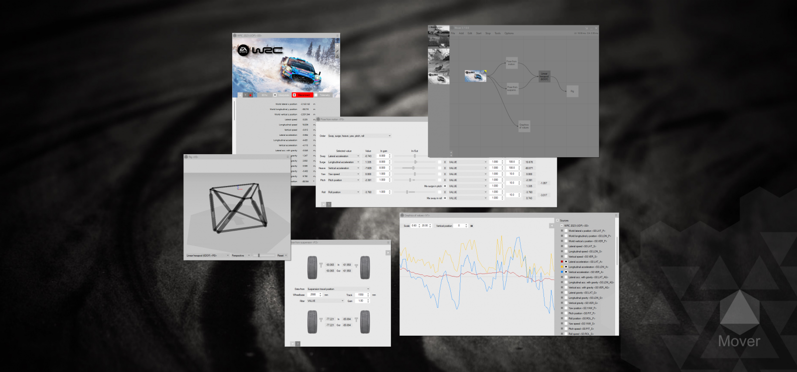

    WARNINGS Please read:
    First of all, this is a beta version, so expect many bugs.
    Be careful using Mover with your hardware.
    You should always have the emergency button at close range.
    Motion rigs can be expensive and specially dangerous for anyone (specially kids).
    Im not reponsible for any damage it might cause, physical or in the hardware.
    • Mover allows you to work "live", this means you can change anything while having motion. This can be dangerous, so be sure you know what you are doing, one of the reasons to have the 3D rig viewer. Do the tests using the viewer and when you think it's ok, connect the hardware.
    • COM ports are not detected automatically yet. Some bugs made me deactivate it. Careful with any problem it might cause (got crashes with the WITMOTION source).
    • Defining rig actuators gained a specific window and I'm not sure it's all bug free. If a rig has 2 types of actuators, you have different controls/windows for them, but usually one control/window can setup multiple actuators when they have the same specs like a linear hexapod with 6 equal actuators.
    • When using midi devices as control: They don't store the state of the controls, they work with events so if a knob is at value 0.5 when you start Mover it's value is 0.0 until you use it and it might be suddenlly 0.6.
    THIS TEXT IS WIP
  3. pmvcda
    pmvcda aka FlyPT
    Nov 3, 2010
    2,180
    Portugal
    15,391Coins
    +2,601 / 17 / -0
    New features:
    You can now assign controls to the numeric up downs, checkboxes and buttons (not all, I disabled some of them).
    This allows you more control from the rig without using a keyboard and mouse (it's easy to use the same control for multiple fields...).
    Besides joysticks and keyboards, you can now use midi devices
    WARNING, midi devices don't store the state of control, they work with events, so if a knob is at value 0.5, when you start Mover it's value is 0.0 until you use it and it might be suddenlly 0.6
    • On rigs you can now control the behaviour with 3 filters (assign some controls to them to make it easier to test):
      - Gain like we already have
      - Bass and treble to control the gain of low and high frequencies
    • Rigs have 3 motion alghorithms:
      - Keep moving actuators with available range - This ones moves the actuator still with range causing the loss of VR compensation and inducing strange cues. It's faster, but use only if you are sure that you never get out of range
      - Stay on last good pose - If the rig goes out of range, it stops causing a loss of motion, but keeps VR compensation.
      - Follow pretended pose even if out of range - This ones keeps movement, by scalling down motion near the out of range. It never goes out of range and keeps VR compensation, but can cause some strange cues, but not like in the first alghorithm.
    • We can now enable interpolation of data received in the sources.
      Can cause some lag, but only if the frequency is to low.
    • Some sources allow the use of a dedicated thread to get the data (MMF)
    • New filters/operations.
      The so talked IF... and some others like INTERPOLATE I added for experimentation.
      Sometimes I get confused with their behavior... please test all of them.
    • Outputs use a new code that should be way faster to generate the byte arrays.
    • New 3D graphics with better sence of depth, but no use of OpenGL or Direct3D.
      Should be light for the graphics card.
    • New Graphics module with lines and color selection for better visualization.
    • Main window looses the buttons that are replaced with a diagram showing current modules connection (some bugs there when deleting modules).
    • New default setups. On the main window you get a list of default setups that can be assigned to a specific game and vehicle.
      You can enable auto launch to open them automatically.
      Since some games don't have vehicle info, you also have general setups for all the vehicles that don't have a setup.
      This feature allows only one setup for each vehicle right now (on the future we can have more, but only one per vehicle for auto launch).
    • Introduction of variables. You can use a var in any filter/operation.
      For example in the roll calculation you can do something like:
      ADD(S0.LAT_A;S0.LAT_AG)
      Where S0 is a source with that key and LAT_A is the lateral acceleration.
      Another example:
      ADD(P1.Sway;S0.LAT_S)
      Where P1 is a pose with key P1 and S0 is a source with key S0.
      ...Might be easy to get some bugs here accessing P1.Sway in the pose P1...
      Another example:
      M2770A4A4.P24
      Where M2770A4A4 is a midi device and P24 is the pressure done in the note 24
    • Memory browser, a basic cheat engine for the crazy ones like me that want to get hooks.
      Needed this for some hooks, ended polishing it and introduced as a tool.
    • Added some basic tools to get info about software and launchers like Steam, Epic...
    • You can now patch and launch games from Mover sources.
    • Outputs have now CRC optional.
    • Motion compensation with extra settings for the ones who want to complicate like me.
    • Launch and patch games from the source windows.
    THIS TEXT IS WIP
