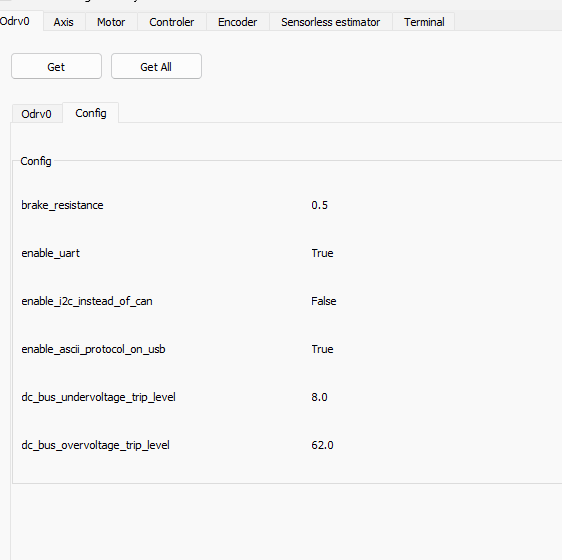

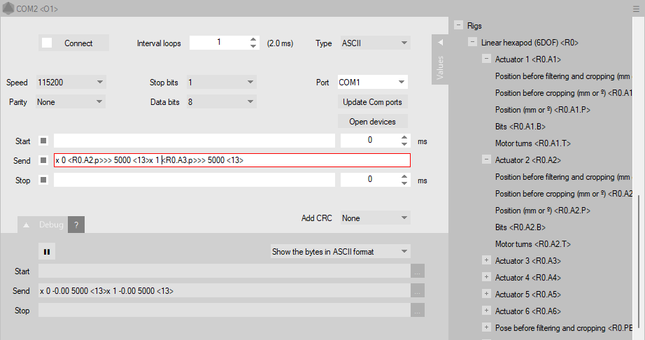

    tried this and the send values look good just no movement

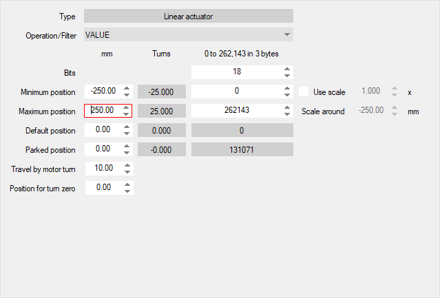

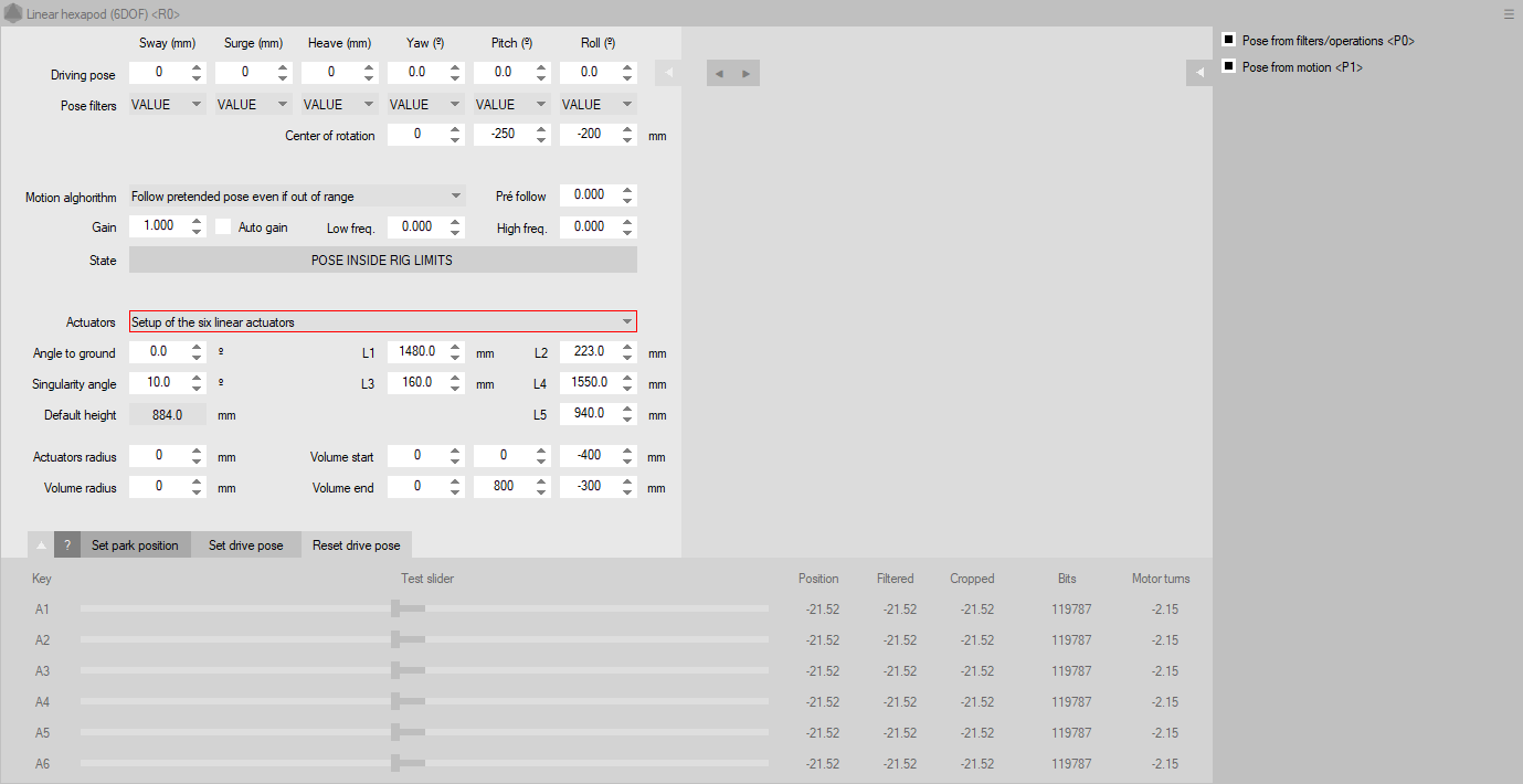

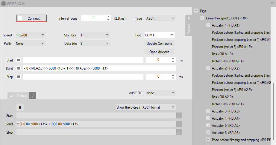

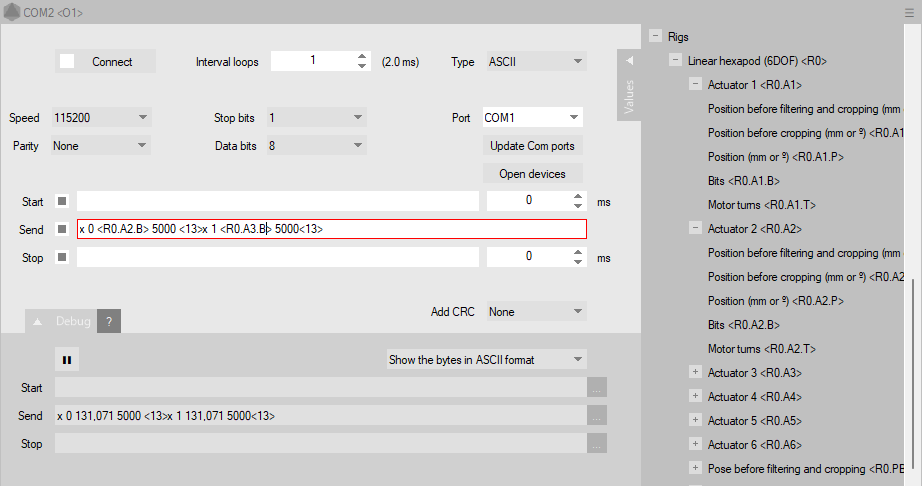

    So bit values. You used
    R0.A1.T
    That is turns
    R0.A1.B
    Is bits
    R0.A1.P
    Is position in mm or º
    So it should be:
    x 0 <R0.A6.B> 5000 <13>x 1 <R0.A1.B> 5000<13>
    Here R0 is the rig key
    A1 to A6 is the actuators
    T, B or P as above

    Ok, don't remember if it really was bits or position...
    If position use:
    x 0 <R0.A6.P>>> 5000 <13>x 1 <R0.A1.P>>> 5000<13>
    The number of > is the number of decimals (minus 1)
    If you have <50>>>, it will write 50.00
    the number or < is the minimum number of digits before the decimal
    For <<<<50>>> you get 0050.00
  4. SilentChill
    2,645
    20,604Coins
    +3,570 / 34 / -0
    Yeah I have tried T, B and P but none of them work. Maybe I have something else setup wrong but I cant see anything.
    with this it moves about a 10th of a turn

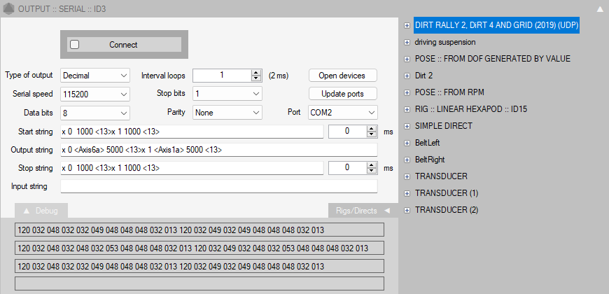

    In your old setup in the serial section, the data type is decimal. In your new setup, you are using binary, and Ascii. Could that be your problem?

    maybe I am completely wrong, but If I remember correctly, the insectatec Odrive firmware was expecting encoder counts ? So if you have set your AMT 102 to 8192 counts per Revolution and you want 400mm travel (10mm ballscrew) you had to send 400/10x8192 = 327680 counts. This are integers and not decimals.
    So if I understand the output rules correctly you should write : x 0 <<<<<<R0.A6.P> 5000 <13>x 1 <<<<<<R0.A1.P> 5000<13>

    ascii is enabled so I guess it should work
  19. pmvcda
    pmvcda aka FlyPT
    Nov 3, 2010
    2,272
    Portugal
    15,902Coins
    +2,716 / 18 / -0
    ascii and decimal are the same
    Reality is that bytes are converted to their ascii representation.
    @SilentChill , could it be a . and , decimal separator problem? How was it showing in the olkd Mover compared to the new one?
