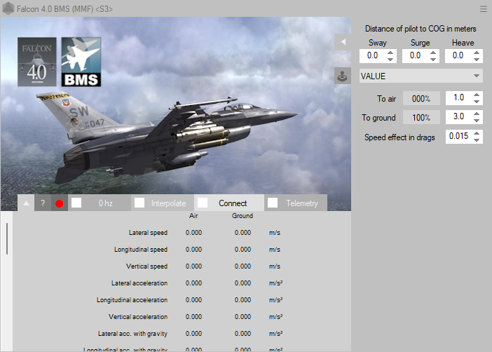

    Optimized air/ground code
    Added Falcon 4.0 BMS

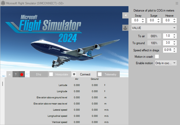

    Added MSFS 2024 (same as MSFS 2020, just adding image and links to start/stop MSFS 2024).
    upload_2024-11-25_17-48-39.png Solved bug causing thread to pause while trying to connect to Simconnect.
    Solved bug in image rotation (kept wrong image in some situations).

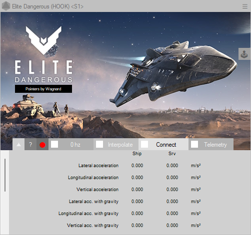

    Added Elite Dangerous(thanks to Wagnard hooks that are updated frequently)
    Needs more testing. I think current hooks need to be updated.
    It automatically get's the latest hooks.

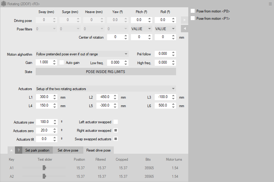

    2DOF rotating now similar to Mover 3.5.3 (swap and swap swapped added).

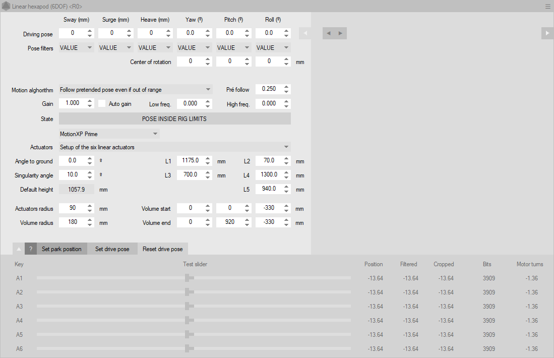

    Hi i am making a survey of the 3.7 to fit it to our M4S and MXP 6DOF linear platforms. I don’t get the drawing explanation of the physical parameters Lx of the rig module on the right. It seems also there was change of denomination from 3.53 because in 3D viewer and with same values in same Lx, the rig is banking and also calculated height is different, Moreover, L5 is not explicated….is it normal I don’t have the same kind of drawing as in 3.53?
    Also in the M4S output module, I could correct the 16/24bit for all actuators except for the first one that stay in red….

    It's WIP. Drawings are still missing because I was considering some chages in the dimensions.
    To use MotionXP Prime, use thhose dimensions:
    This one includes colision detection for the pedals.
    For MotionXP Bumble use:
    In the next release you can select a pre defined rig and will get more for those rigs soon.
    For the output, I have to check. Made some changes in the last build. Need more testing. But I think it stays red, but it's just a UI bug. I will check the output.
    This is still WIP with frequent changes and optimizations. Be careful.
    Edit: forgot to say about the actuators.

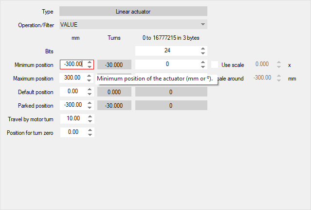

    Click on the button setup of the linear actuators
    There you need to set 24 bits and the range by sayin the minimum and maximum values
    In prime -300 to 300
    In bumble -200 to 200

    Hi Pedro, Just updated to 3.7.0.8. Excited to try the updates. but I'm not getting any data from MSFS data now. "Connect/Disconnect" flag is yellow. Tried 3.7.0.5 to make sure it wasn't something else and that it is still working. Also tried changing the values of the new pulldown "Enable Motion", but no luck.
  11. pmvcda
    pmvcda aka FlyPT
    Nov 3, 2010
    2,272
    Portugal
    15,902Coins
    +2,716 / 18 / -0
    Oh, I made something that broke it...
    It was working. I think I might have undo something. I had the var type wrong and might have reverted it...
    Will check and post a new build today.

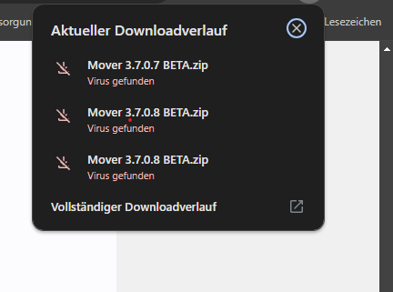

    Yes, now Windows is like that... I had the files in Google for virus check and they where marked as virus.
    Downloads where blocked.
    So I started using github because Mover makes the update alone and replaces the exe with the new one if you want to. The links in the first page are for github now. They should work, unless your antivirus is marking them also...
    You have to trust me. From what I know there's no virus in the files and I'm the only one with access to the files in github. So...
    To solve this I would need to register Mover or something like that and pay. Well, I don't want to unless this brings me a bunch of money to pay for that. (and I would need to do it at each release and have an installer and ... and ... € and $ and fu*** them Sorry just a rant, it's the world we live in now).
