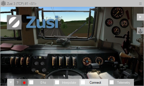

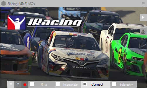

    Mover 3.7.0.1
    Download link in the first post of this thread.
    iRacing (new source)
    KayakVR (new source still WIP)
    Please enable telemetry in the game menus.
    Zusi 3 (new source still causing some problems - it's a train sim)
    To enable telemetry, on the Zusi3 menu do:
    Configuration -> Settings -> Sending interval
    Increase the frequency by lowering the value (0.001 is 100Hz - Zusi3 never reaches such value but will get maximum frequency).
    Also check to autostart the server.
    MSFS 2020
    Was not working due to compilation problems.
    Had to leave the dll's outside of the executable for now.
    Please keep SimConnect.dll and Microsoft.FlightSimulator.SimConnect.dll in the same folder of Mover.exe.

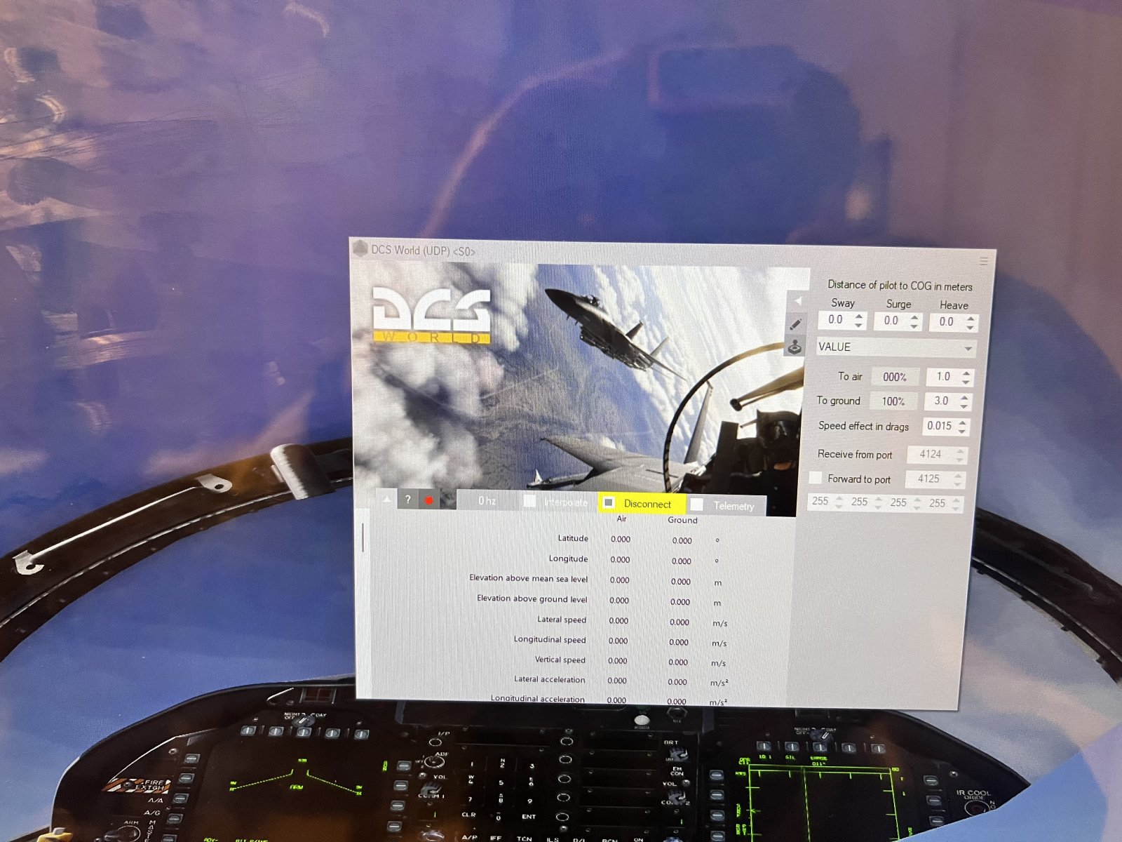

    FS2020 seems fine.
    Can I ask for DCS support in the next one? Seems dead for now.
  20. pmvcda
    pmvcda aka FlyPT
    Nov 3, 2010
    2,272
    Portugal
    15,902Coins
    +2,714 / 18 / -0
    Did you apply the patch?
    On the source you have a button for it and can also start dcs from there (pen and joystick icons)
    The lua file changed.
