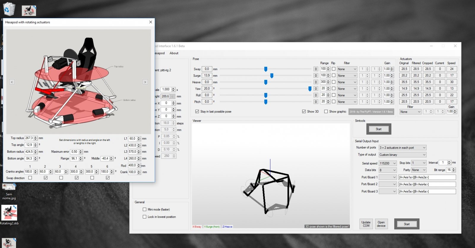

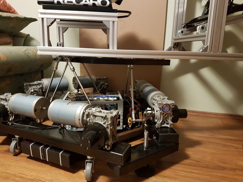

    Hi @pmvcda

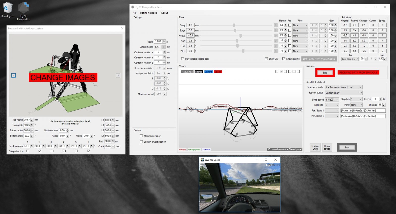

    I set my rig dimensions up, but it seems I was wrong, or I don't understand correctly the range and middle degrees.
    Before cranks reach low min position they jump 180 degree immediately on 3d show.
    Can you try it with my config file?
  3. pmvcda
    pmvcda aka FlyPT
    Nov 3, 2010
    2,237
    Portugal
    15,702Coins
    +2,674 / 17 / -0
    That's some strange values...
    Do you have an image of the rig? I would overlap the dimensions.
    Using 180º range is to much. It means a full rotation, you can go 180º up and 180º down.
    Might be a bug there, I see that changing the range affects the zero position...
    Let me take a look.
    Thank's for testing.

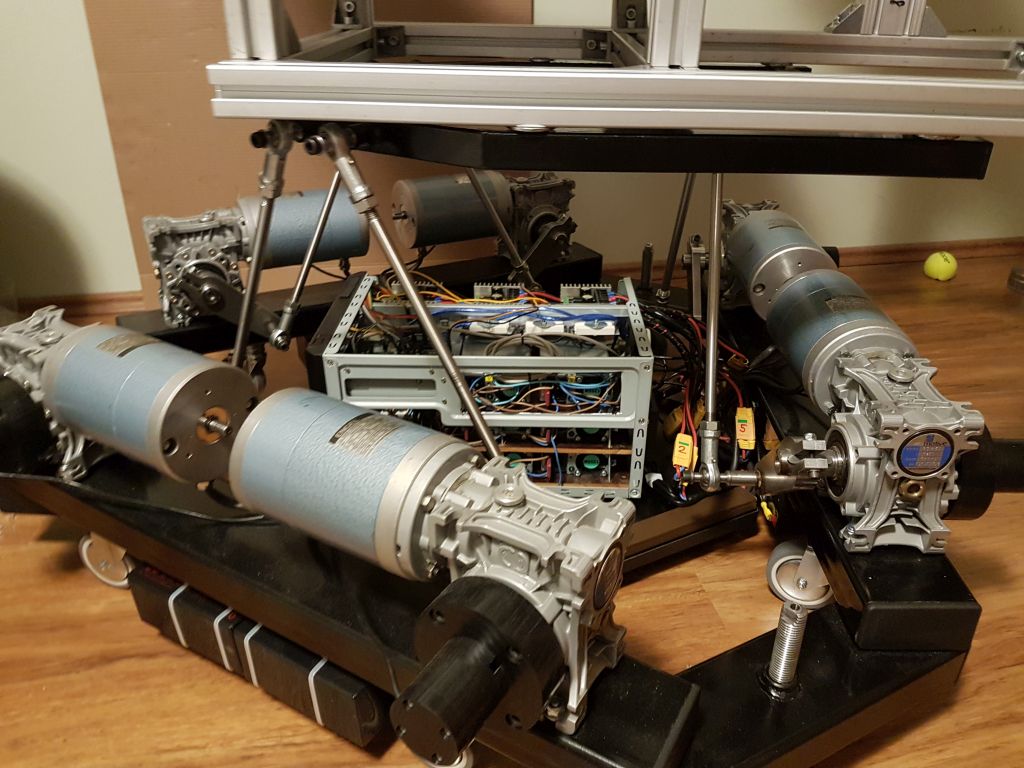

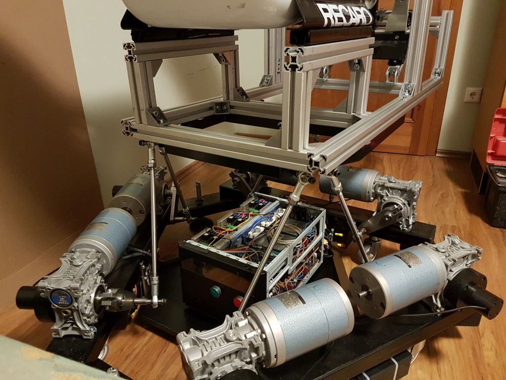

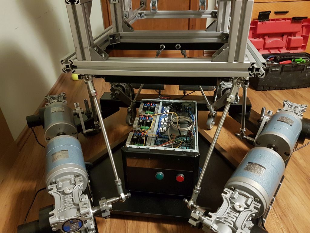

    I measured the whole rig and its still strange, I don't dare to test it :)
  7. pmvcda
    pmvcda aka FlyPT
    Nov 3, 2010
    2,237
    Portugal
    15,702Coins
    +2,674 / 17 / -0
    In doubt, please don't test!
    The Gray line in the top structure of the 3D is supposed to be the front of the rig. Are you sure it's your rig configuration?
    If you can share a photo, it would be easier to help.

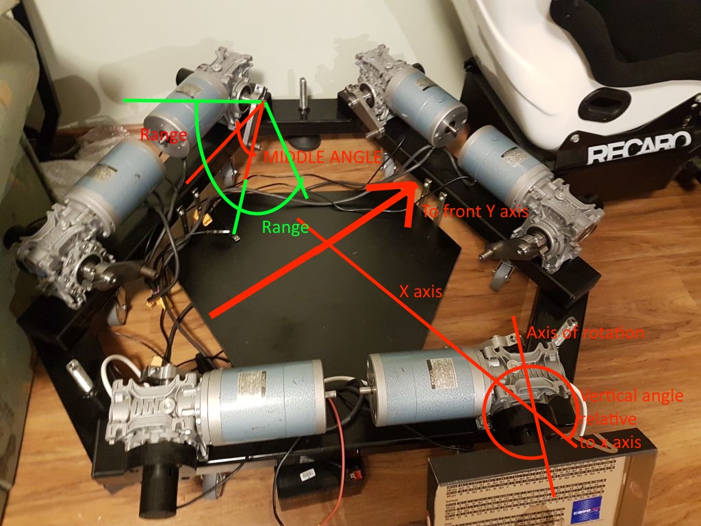

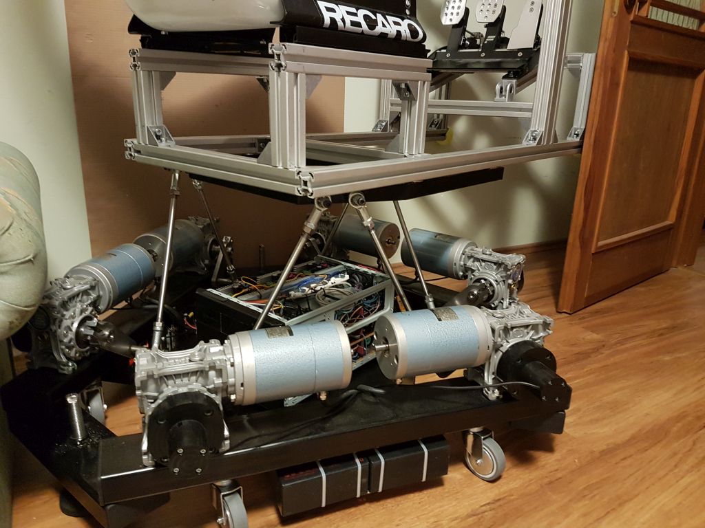

    When I change middle degree to 30 it looks good, at least strange movements are disappear. But about my rig geometry the middle position of cranks should be 41 degree from horizontal line.
    Anyway, the middle position seems correct with 30degree on 3D show
    Get well soon ;)

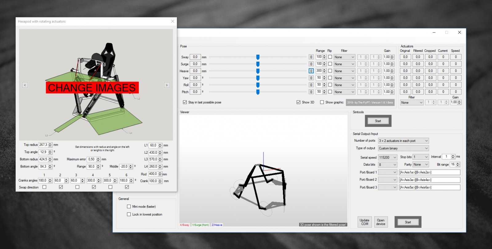

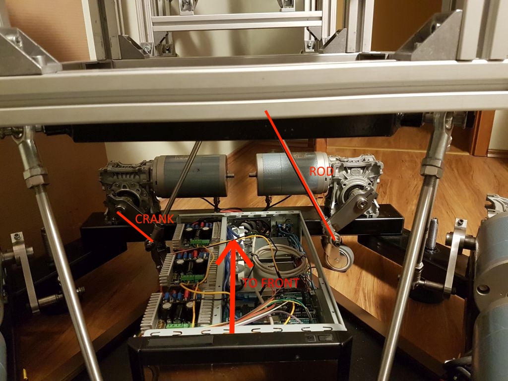

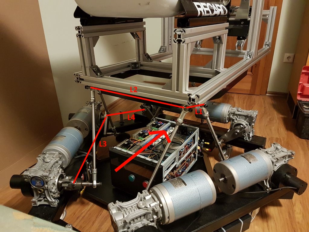

    Was trying your measures and decided to rotate 180º the vertical angles:
    Those measures seem to work OK.
    It seems there's an error in the angle calculation when the axis point outside.
    The result should be the same.
    Something I forgot somewhere. I have to take a look.
    Used your fotos to explain the measures for others: 20190106_174803.jpg
    It's a bit confusing, I will make something better for the program.

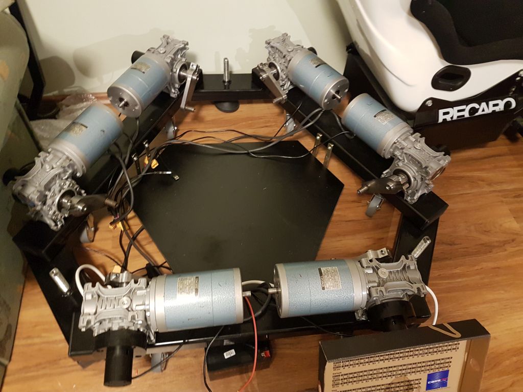

    Hi guys,
    I'm working on a new project and only now have I seen this discussion.
    I would like to introduce you to my project and get information.
    I am attaching the photos, I would like to change my brush motors with brushless motors, I have to use specific drivers for the program or is any driver good?

    This has nothing to do with the interface.
    You might be talking about Simtools.
    The interface in this topic is only for 6 degree of freedom based on hexapod's.
    To drive brush less motors you need a hardware driver for the motor and an interface, like an Arduino to control that driver.
    It's not for this topic, you can take a look at my build thread, where I used brush less motors and make all the control with ESP32 boards and a "cheap" driver:
    https://www.xsimulator.net/community/threads/flypt-6dof-brushless-diy-actuators.10799/

    Thank you very much. It looks good, tomorrow I will try that. Only one thing I don't understand yet, the range and middle degres. ( ok two things;)) I set all motors about 150-160 degree range limit with smc3 utils. And the middle position is about 40 deg from horizontal or 50 deg from vertical . Like you marked those lines on my pictures they are clear. But as I can see you set range to 90 degree and middle to minus 20. Can you explain that? I was experimentig a lot with those values and tried to understand what was changing, but I haven't got it.
    Anyway I fell in love with this interface. Very big thanks really. :thumbs
  20. pmvcda
    pmvcda aka FlyPT
    Nov 3, 2010
    2,237
    Portugal
    15,702Coins
    +2,674 / 17 / -0
    OK, to look for the correct value, fallow this procedure:
    Put middle at 0º
    Put range at 180º
    Now look what is the maximum and minimum angle before going out of range.
    For that, move heave up and down.
    I got for your rig this:
    minimum = -136.5 º = -211 mm
    maximum = 55.7 º = 61.4 mm
    So if we want to make middle based on angle, we have:
    range = (136.5 + 55.7)/2 = 96.1 º
    middle = -136.5 + 96.1 = -40.4 º
    This gives you a travel of:
    heave up = 136.2 mm
    heave down = 132.6 mm
    So you are right, it should be -40º, but you will never get more than 96º range or the rig goes out of limits.
    Meanwhile, I'm a bit lost, looking for the error that makes things different if axis is to the outside...
