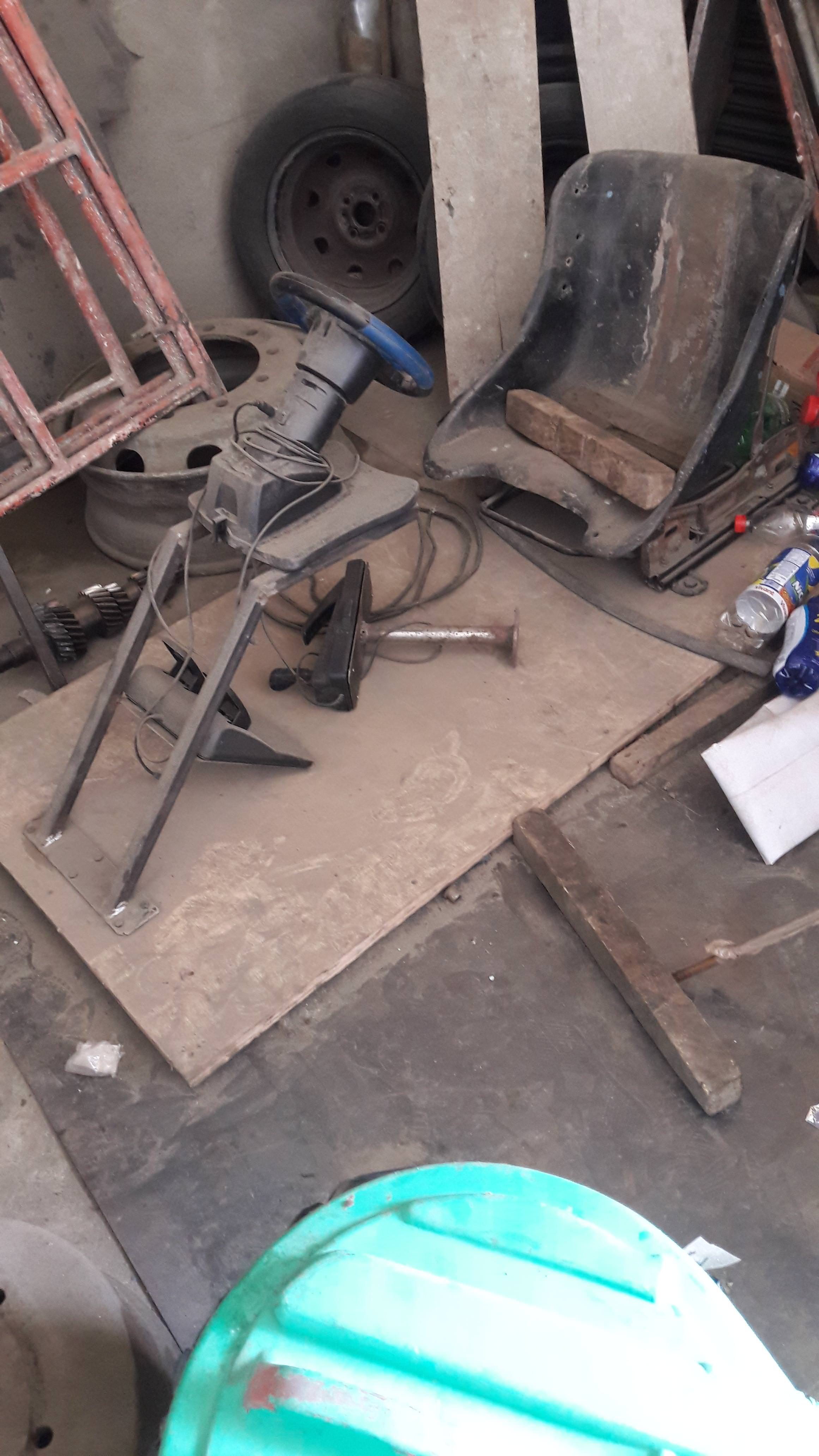

    Hey, here is the chassis. I made with wood for the weight. And take a tie rod of car like silentblock and also it can roll.

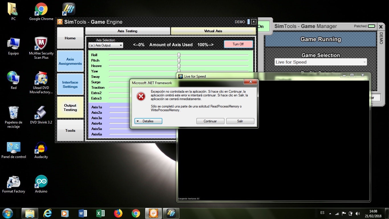

    Hey peop. Today I started with the fisrt test, but nothing for now. I cannot make that he indicator turn blue for the capture. I don't realy sure how star the game, like I used to do with extractor of xsim, but i start it manually, first i turn on the virtual axis then start the game, I either opened tunnig center window, to look the values but nothing change. The first test failed. Later I 'd have upload a video showing the prcess.
  17. noorbeast
    21,603
    151,275Coins
    +11,033 / 56 / -2
    What Arduino code are you using and is that properly configured and working?
    Can you please post picture of all of your settings.

    I am using the matt code for arduino, and it works good in output axis testing
    This is the code: https://www.xsimulator.net/communit...-and-2-pins-direction-hbridge-motomonster.67/
    Ok I been doing change and test, and nothing work yet. I read somwthing in the quick start about test only for the movement of the slider, I make evingerything but nothing yet. I will continue trying. I am thinks that maybe can be the power suply. Here the pics go. sorry the pics are not uploading, maybe later. Now gonna put a video link. They are, now let me now my error.

    Today I saw something about region, the 2dof dosen't wok, and never will do, because I live in a region where this soft doesn't work at requiered level. I bought everything, but have to put an advertence that never will work. There is no conection between engine and manager. the green indicator said that they are conected but the slider don´t move with any test. Maybe other thing wolud be the power supply, because i can move tilt the axis with the outputest, but no with the game. I've been thinking tha the demo mode of simtools program only work for a output test but not conected with the arduino board and motomonster and wipers too.

    My new test. I notice one thing. In the interface setting when i put L<Axis1a>R<Axis2a> then in output testing axis, when I turn on to begin the test, the ties rods dont move, but if i change L<Axis1>R<Axis2> , and turn on, there is movement without action, inmediatly I turn on. It's like the motors are taking position, but they are descoordinated. Then I click turn off and the motor go to the middle positon.
    now I'm receiving this message. I restarted the laptop, repached the livi for speed and nothing. sorry I don't know from where come that mistakes, only could it be the program that is a damage for my laptop.
