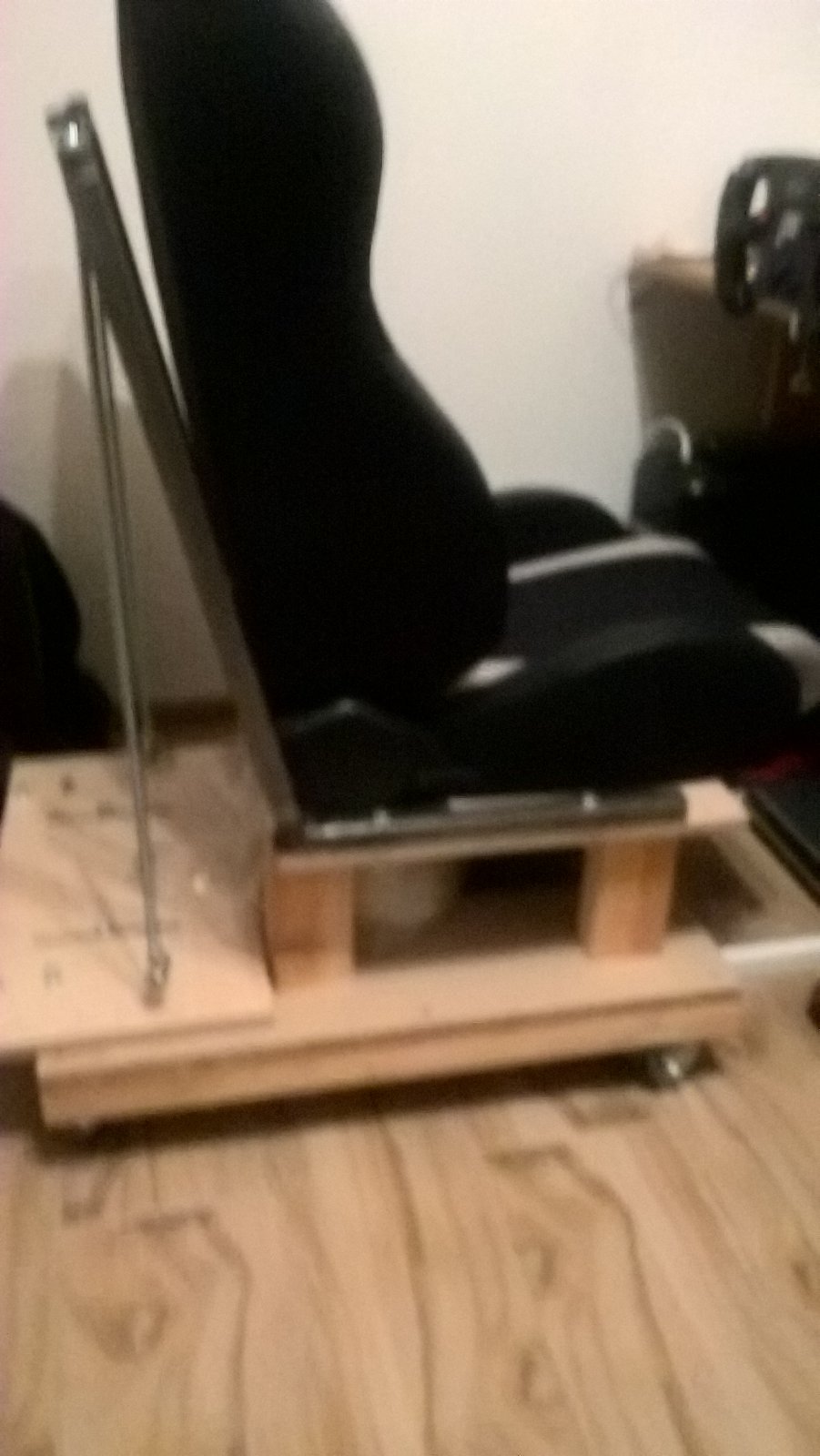

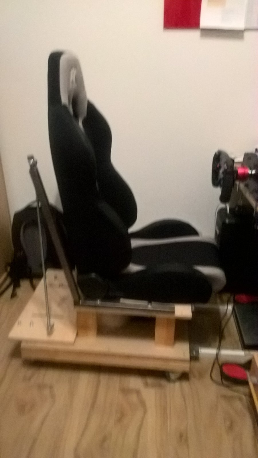

    my Name is Martin and some years ago I started planing my seatmover. The Project was interrupted by my hous-Building-Project but now I wannt to bring my seat to an end.
    I use a shoulder-mount design.
    I use These Motors: some sort of truck wipers.
    I´m not sure finally which Code to use racingmat´s or rufus´SMC3. It depends of using one or two MM

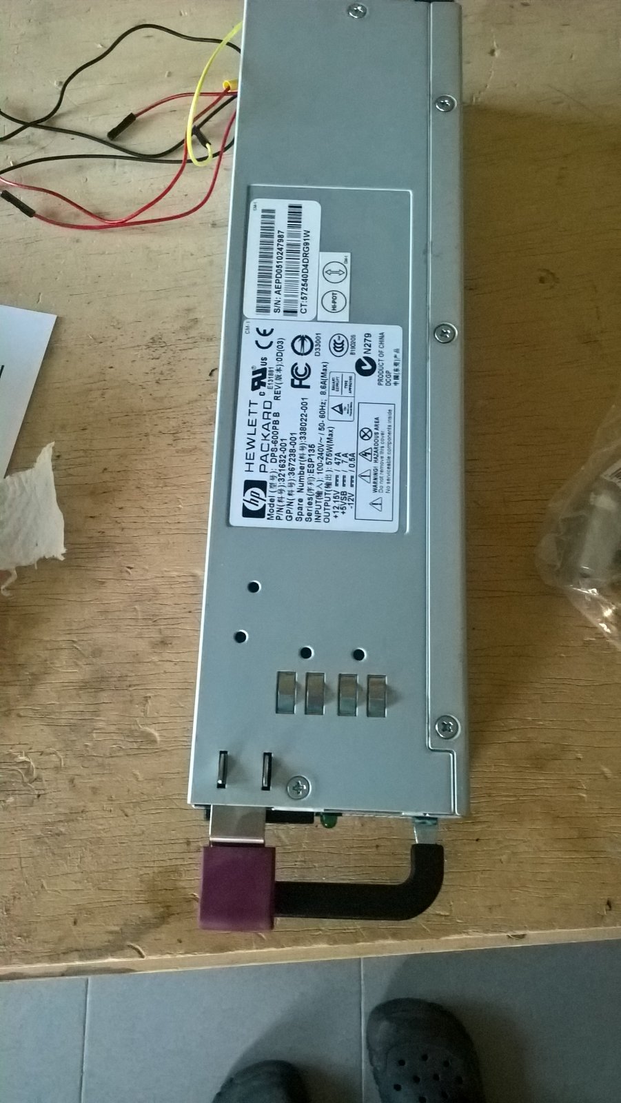

    electronics:

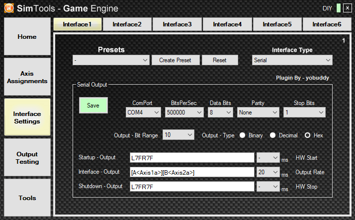

    Arduino Uno3
    2 Motomonster
    HP PSU

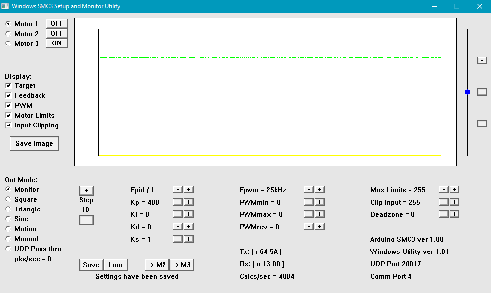

    So here are some Fotos of my Settings
    21,603
    151,275Coins
    +11,033 / 56 / -2
    For SMC3 try changing your Interface Settings to: Binary (not Hex)
  15. Martin.Berger
    Martin.Berger Member
    May 6, 2014
    71
    204Coins
    i´ll give it a try.
    Thanks Noorbeast

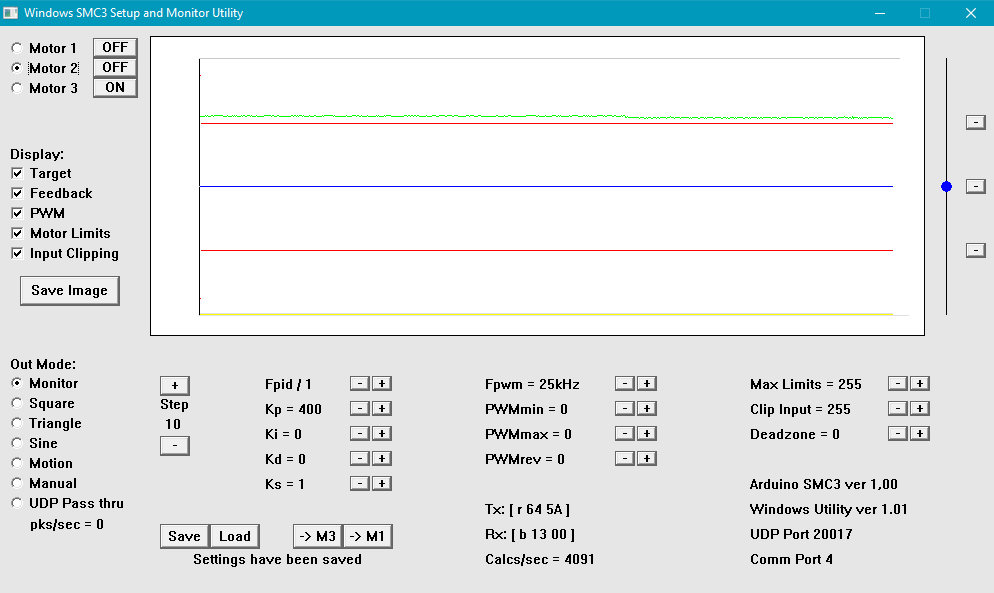

    No, my rig isn´t moving now. My MM doesn´t work as I want.
    I use SMC3 Code and weiring. But i can get just one Motor to work. 2nd doesn´t.
    I´ve no idea why. I checked it with an other MM. Same Problem. Just motor1 moves Motor2 remains at "off" in SMC3
    I recheked weiring 100 times.
    So maybe someone has an idea

    Can you please post pictures of all of your SMC3 settings.
    Have you swapped out the motor and control board on the side that does work to rule out hardware issues?
  19. Martin.Berger
    May 6, 2014
    71
    204Coins
    my Settings are the following:
