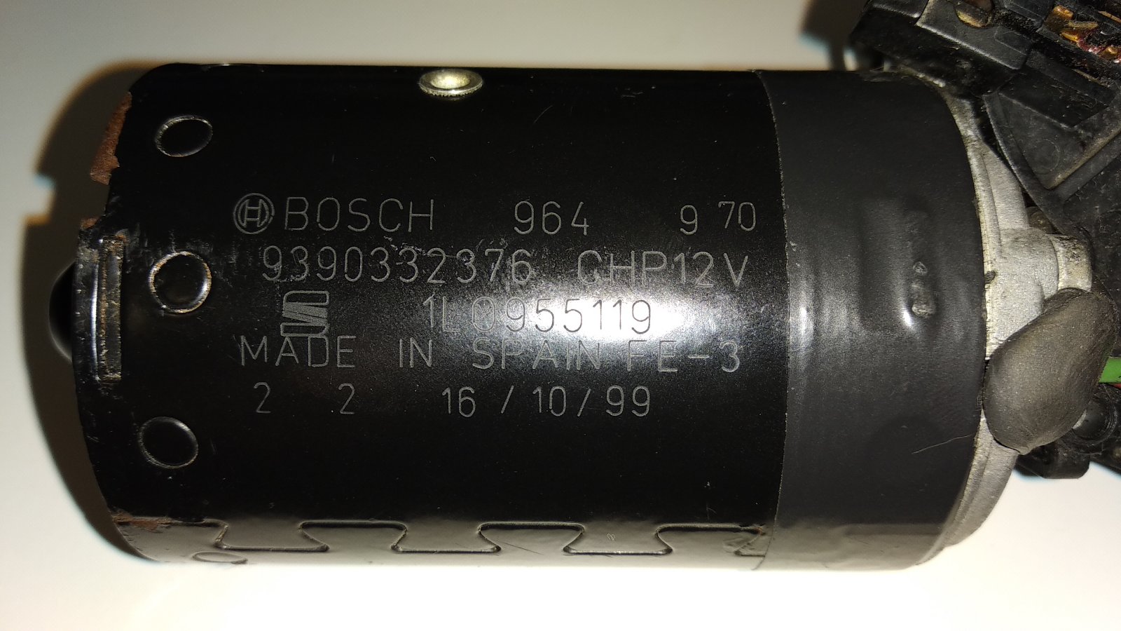

    In terms of hardware, I own a couple of 12v wiper motors and an Arduino board. I'm looking a monster moto shield, but I have no idea what kind of PSU I need. Another question I have are the potentiometers that have to be put in the motors. The last question I have related to the hardware are the gearboxes. Which gearboxes do I need?

    I have a couple of 12v wiper motors. How can I know what amperage they need?

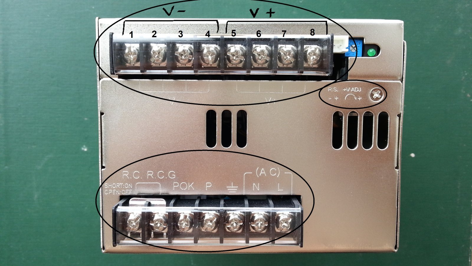

    I have already received almost all the components that I ordered, such as the motomonster, arduino, potentiometers, PSU... But I'm a bit lost with the power supply.
    I don't know where I should connect the cables that will power the motomonster.
    First doubt: (top of image)
    I have 8 connectors; 1, 2, 3 and 4 are V- and 5, 6, 7 and 8 are V +. Where do I have to connect the cables that will power the motomonster?
    Second doubt: (Bottom of the image)
    Where do you have to connect the positive cable of ac and where the negative?
    Third doubt: (Right side of the image)
    Is there anything I should keep in mind? Or is it irrelevant?

    We go in parts, first doubt, terminals 1 to 4 are V- and terminals 5 to 8 are V +, so you have to use a V- and a V +, for example with 1 and 4 you would feed the motomonster.
    Second doubt, in the lower part you must connect 230vac, N (neutral) and L (phase) and earth
    Third doubt, in the right part you have a small potentiometer to adjust the output voltage, if your source is 12vdc you can adjust a few volts up and down

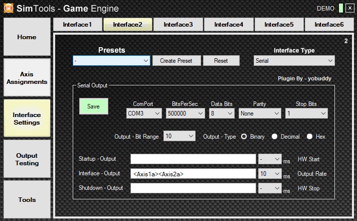

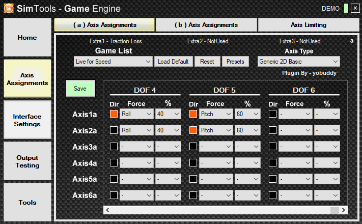

    Hi, after many tests, I have finally got the two engines to work properly. I had to use two Motomonster, because one chip on each board didn't work well.
    Now I have got the engines moving with SMC3Utils, but I can't do the same with SimTools.
    I have configured it and SimTools collects the data from Live For Speed, but when I try to move the engines from Axis Testing, nothing moves.
    How can I make it work?
