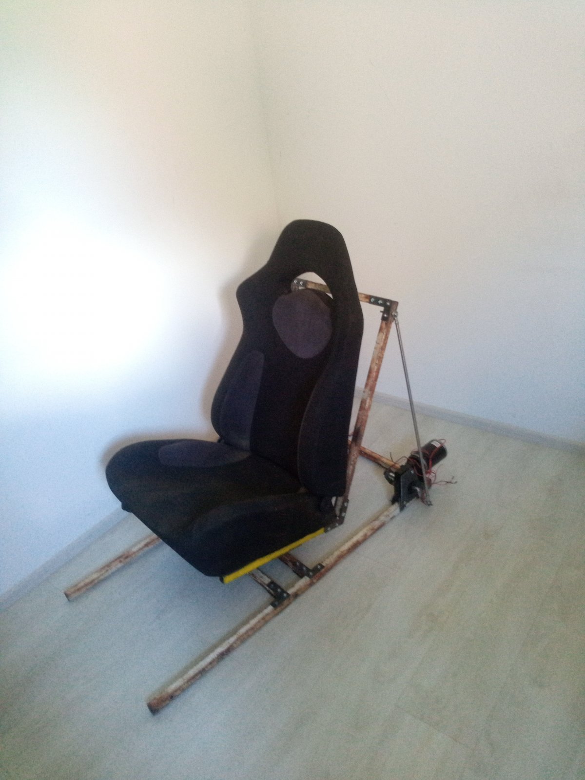

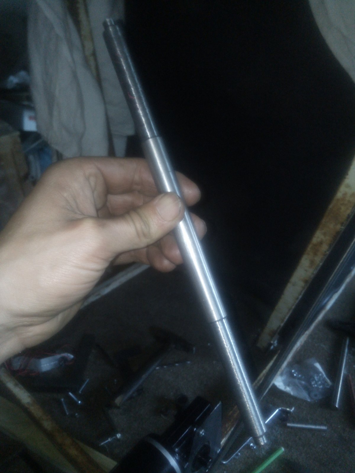

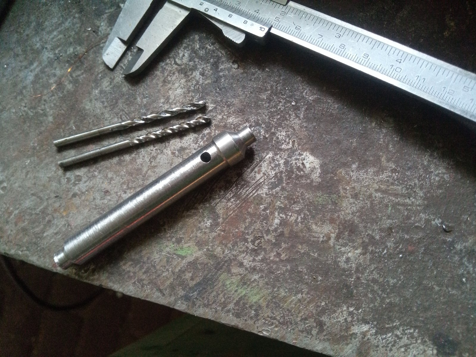

    Getting there, little bit of cutting and lot of learning turning using old lathe but I got things done.

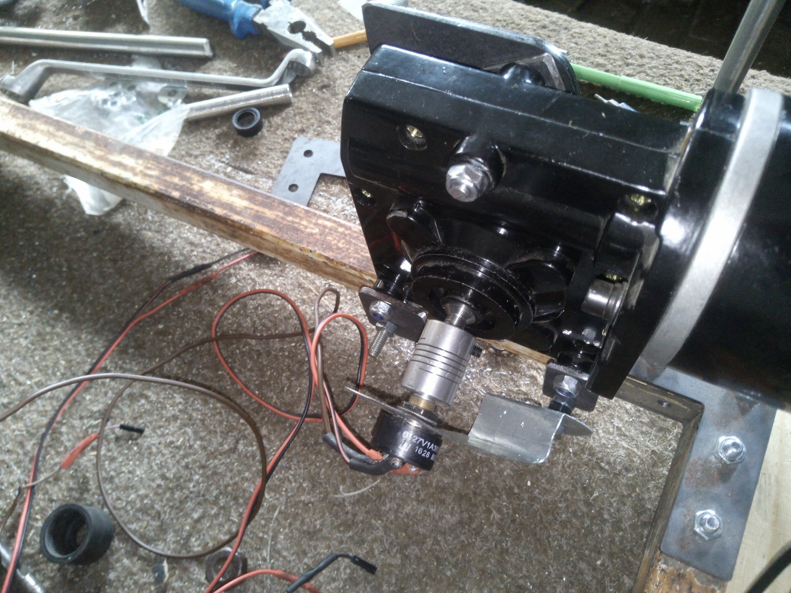

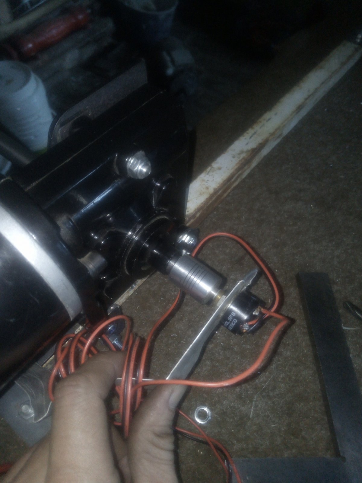

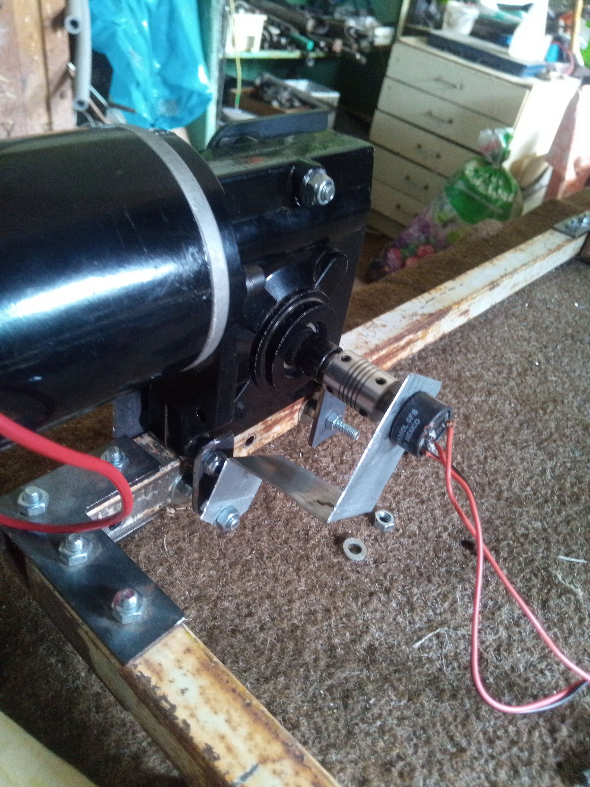

    axles and potentiometers fitted

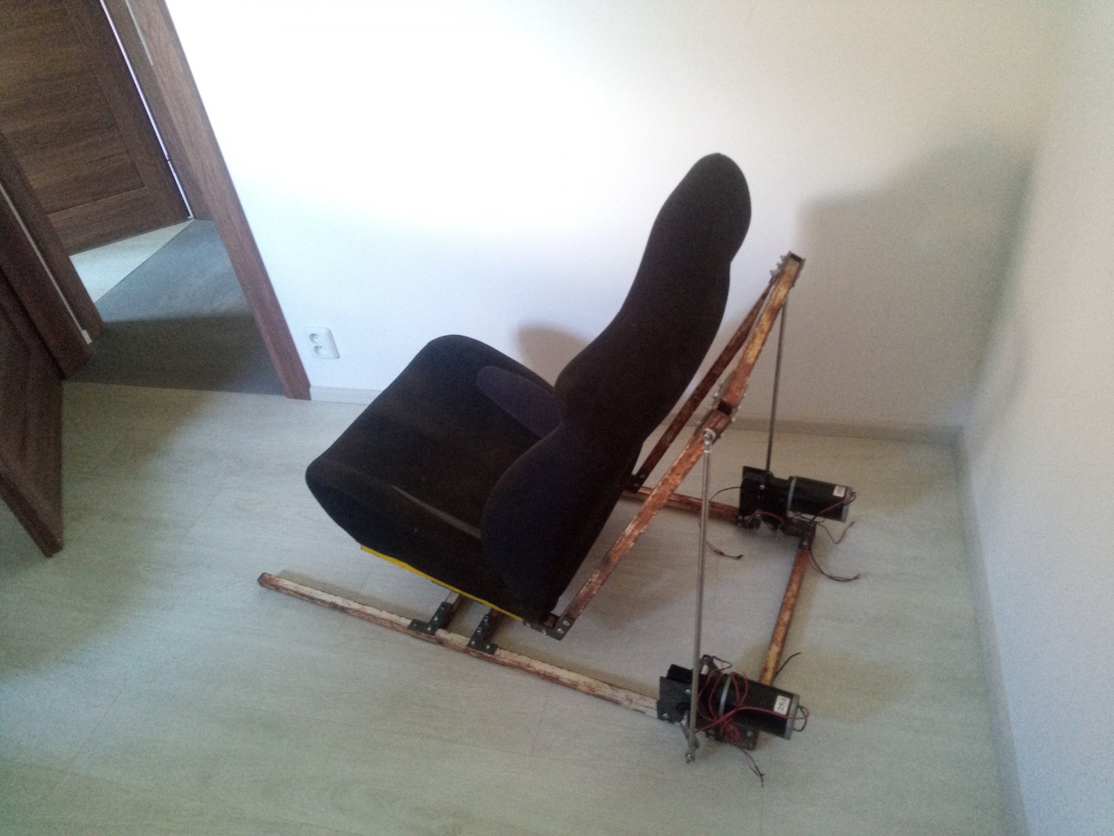

    All the mechanics done(finally, just shy of 5 years anniversary of starting with wiper motors)

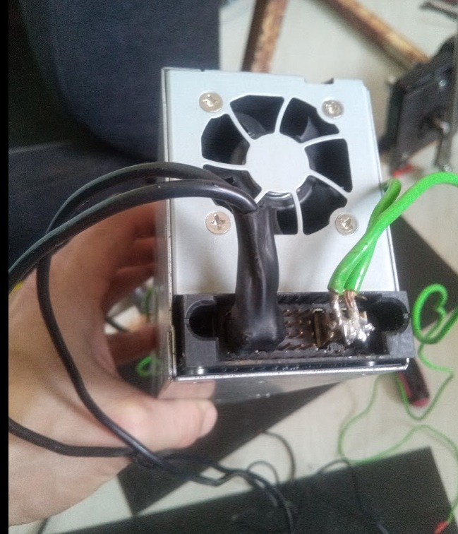

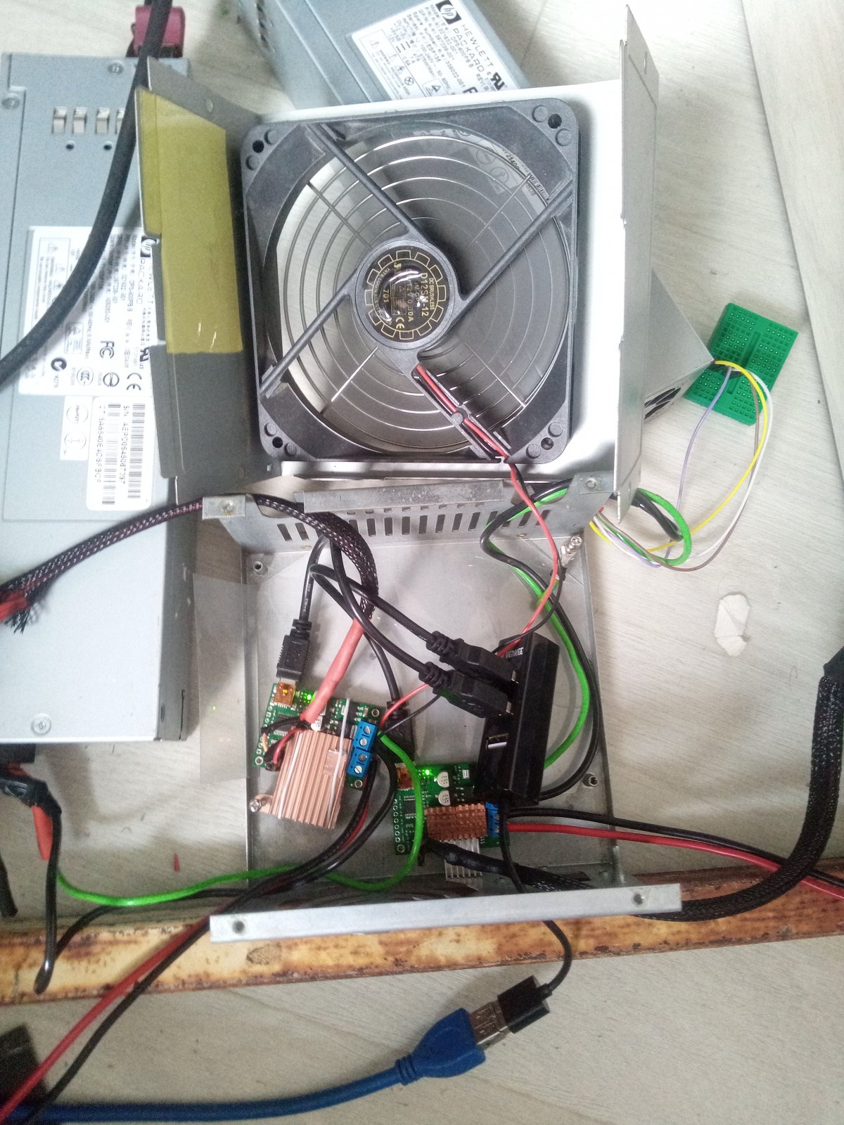

    So it looks like start with electronics won't be so quick as my both JRKs call "No Power" error in JRK app whatever PSU (modded HP 600W PSU),I have 3x PSU and all the same symptoms. Even no sparks from PSU connectors (earth to 12V). Did I blown them all away? Probably, hopefully JRKs are OK.
    21,726
    152,069Coins
    +11,065 / 56 / -2
    Did you test the PSUs with a Amp Meter?
    If they are modded are you sure you jumped the correct pins?

    Wait a second, I might be making stupid myself. I thought that the pins are for fan to lower RPM and potentially to add Power On switch. I just connected the earth together and 12V. I didn't get from the guide that any pins have to be jumpered to PSU turn on. It actually start fan when i plug it in.

    21,726

    That's the guide I have followed but did not realize that need to join pins 6,8 and 10 to Power up the PSU. It¨s running now!
    So in the meantime i ordered additional 2x PSUs on ebay and they were able to ship them this morning:blush
    ANd I have basically undone mods on my other 2x PSU "investigating".
    But one is running, proof of concept is working:thumbs
    Thanks again for quick help here!:cheers

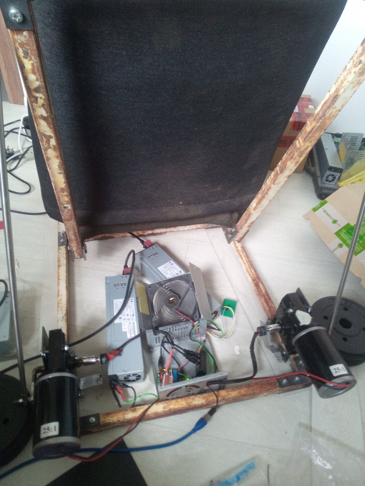

    Finally put both controllers togerther.

    Up and running, even able to initial setup of Simtools.
