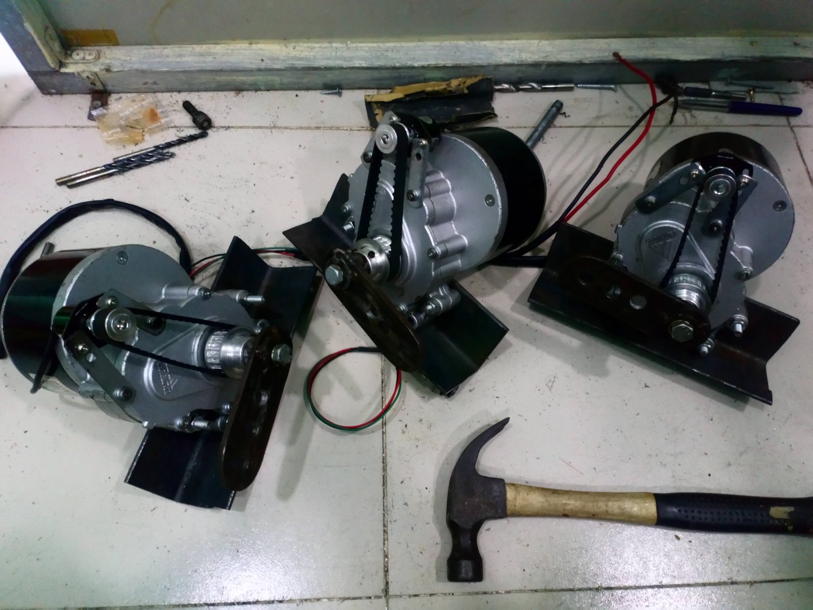

    pictures of my device
    3 motors 250w 24v 75rpm using 2.1 . drive pulley
    20 teeth and 10 teeth

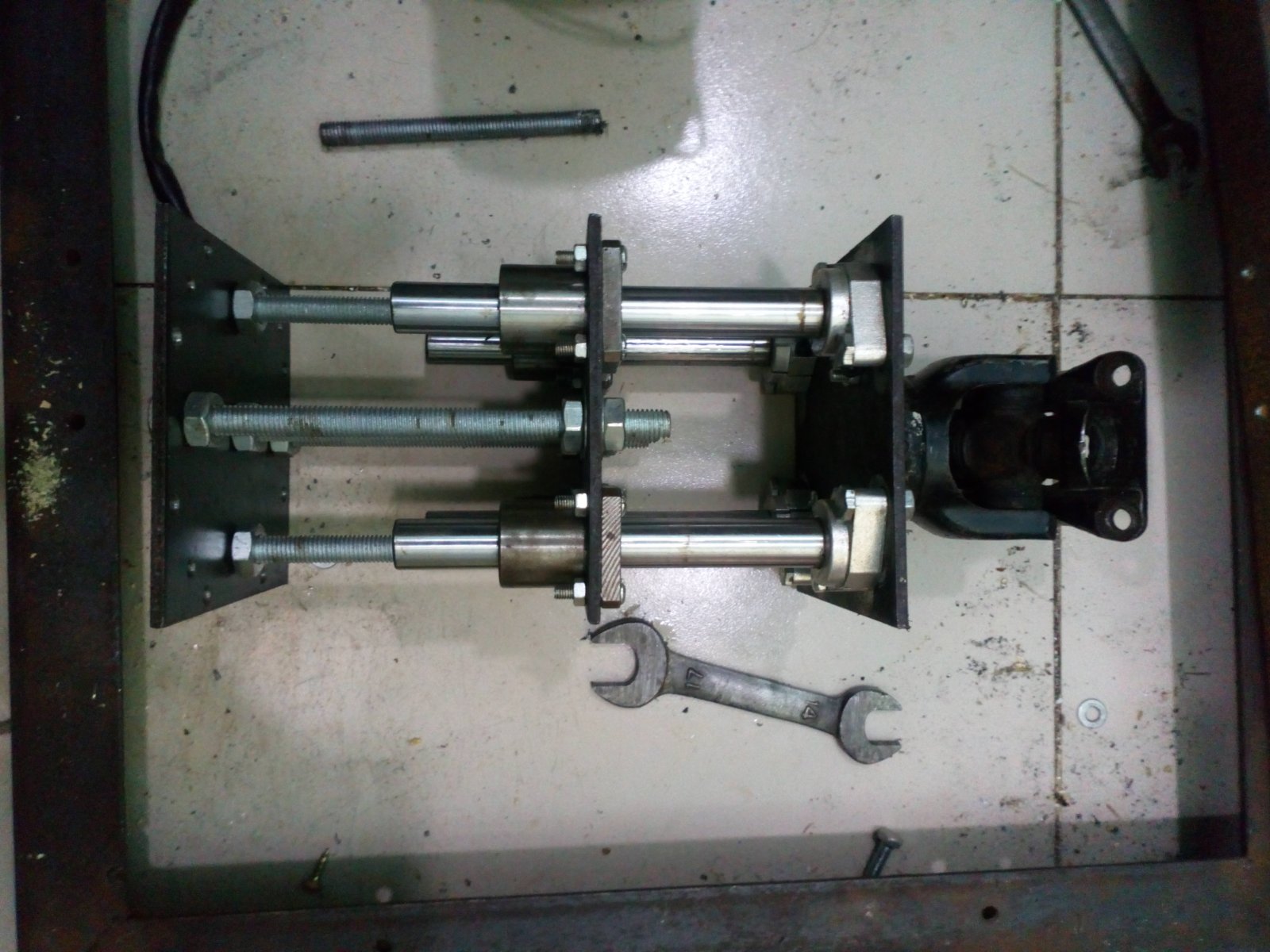

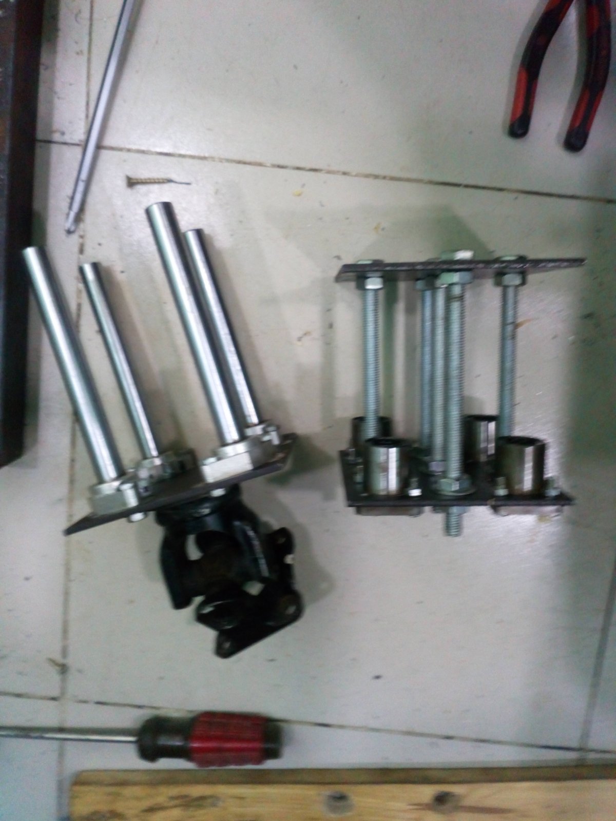

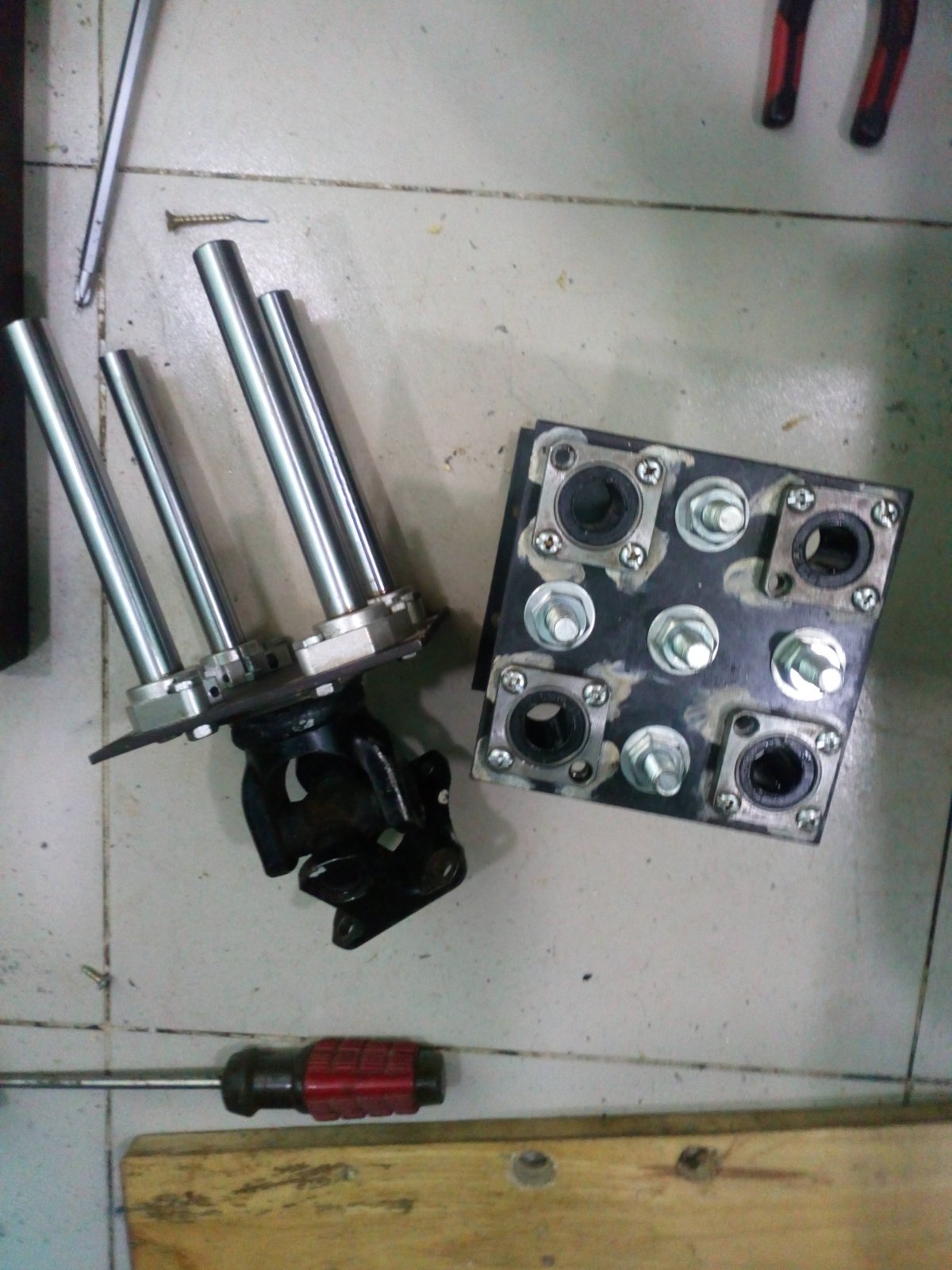

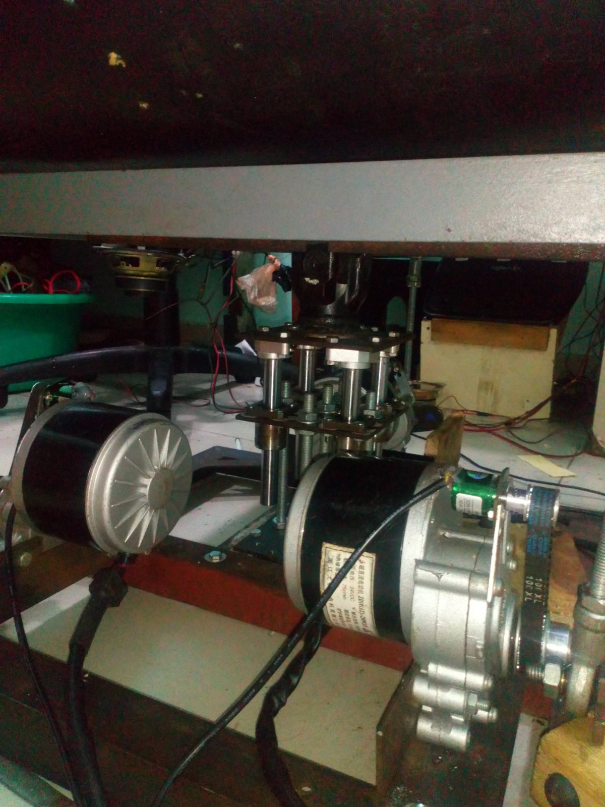

    heave mechanism

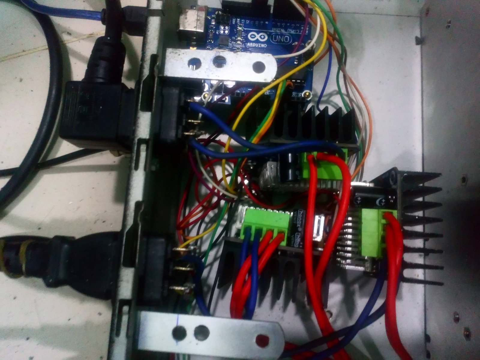

    control box
    3 meanwell 350w 24v
    3 IBT2 . electrical circuits
