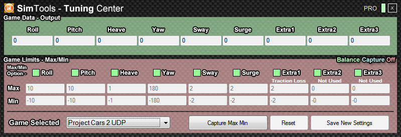

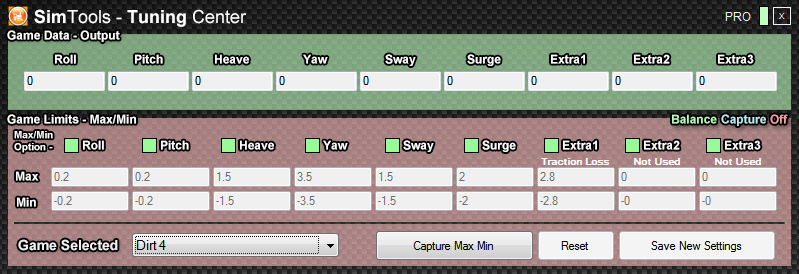

    in archive you can find some basic presets for DOFReality, pls import files in GameEngine.
    Also in attachment you can find some Tuning Center screen, pls make same parameters in your Tuning Center.

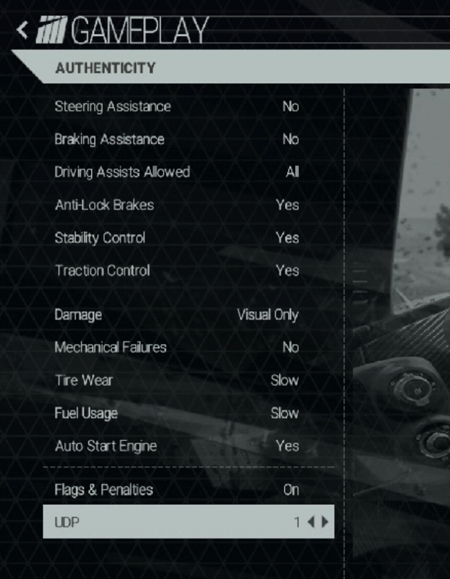

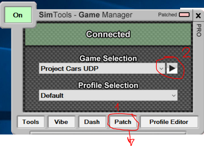

    PCars 1/2 UDP plugins.
    1) in PCARs game settings set UDP -> 1 and exit the game
    2) for manual run open SimTools Game manager and select Project Cars UDP plugin and patch the game
    3) press plugin start (play triangle button to the right)
    4) start the game and enjoy
    5) as you did manual plugin start before using motions in another game you will need to stop this plugin by pressing square button to the right of plugin in Game manager)
    6) if you have more then one of our platform with SimTools in the same local network you need to disable outgoing UDP traffic in windows firewall in order to prevent game movement information collisions.

    ahh thanks, btw, where are the axis 1, 2, and 3? these look like the old version of simtools

    There is screen of Tuning Center (not Axis Assignments).
    https://www.xsimulator.net/tuning-centre/

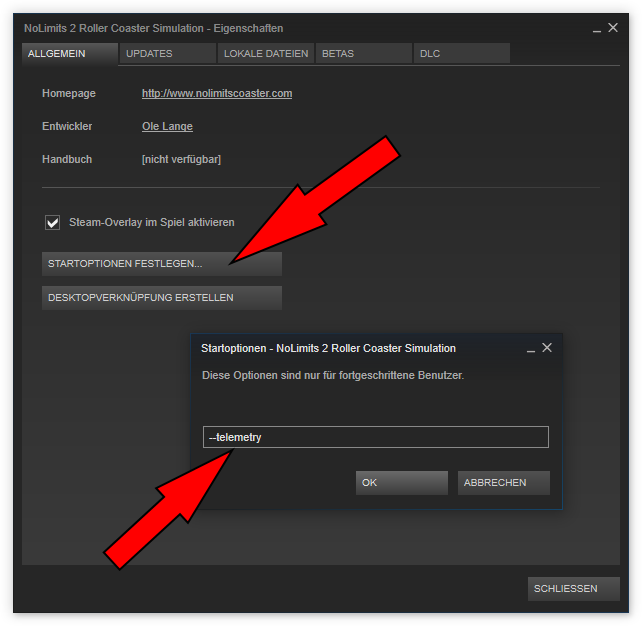

    Below is a picture how to get the NoLimits 2 Roller Coaster on Steam to work....
    In your steam client library right-click on the NoLimits 2 Roller Coaster Simulation, select Properties and click on Start Options and add --telemetry

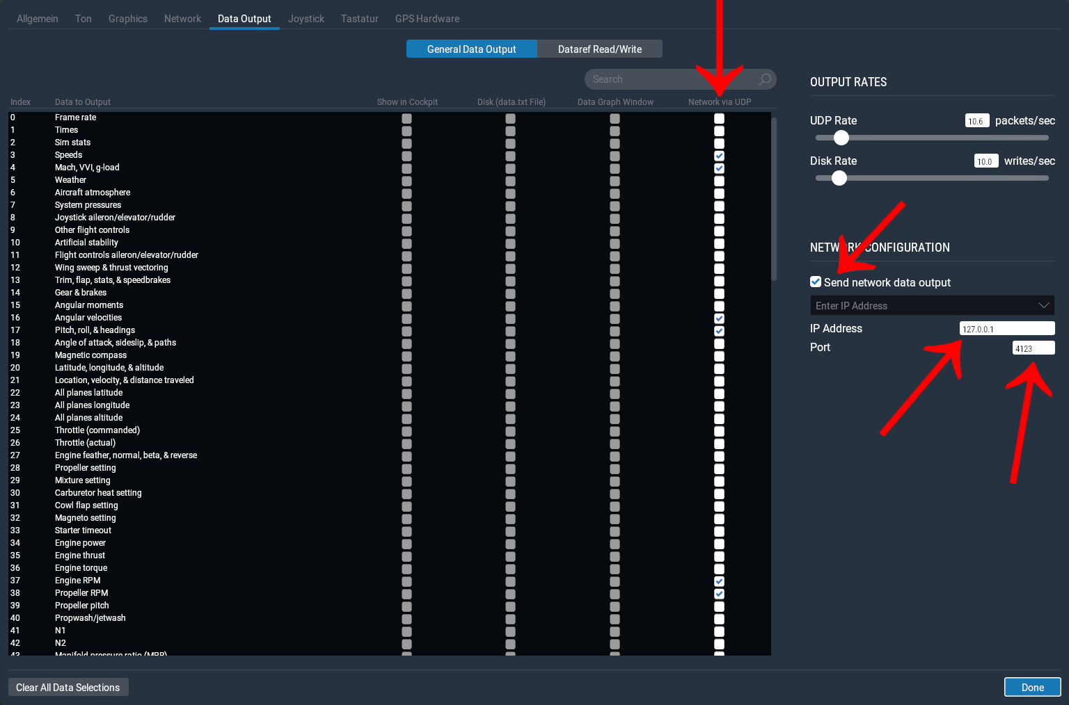

    To get SimTools talking with X-Plane, start XP and Click on Settings > Data Output
    Now that you have the screen with all the checkboxes, check the following items in the last column "Network via UDP"
    3 Speeds
    4 Mach, VVI, g-load
    16 Angular velocities
    17 Pitch, roll, & headings
    37 Engine RPM
    38 Propeller RPM
    Check the box, 'Send network data output' and enter IP Address 127.0.0.1 and Port 4123.
    Set the UDP rate to maximum (99.9 packets/sec)

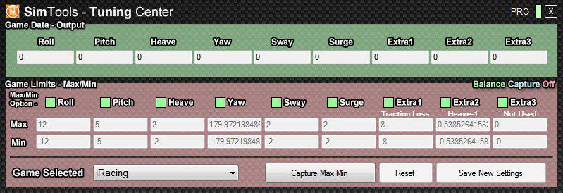

    In attachment settings for iRacing.
