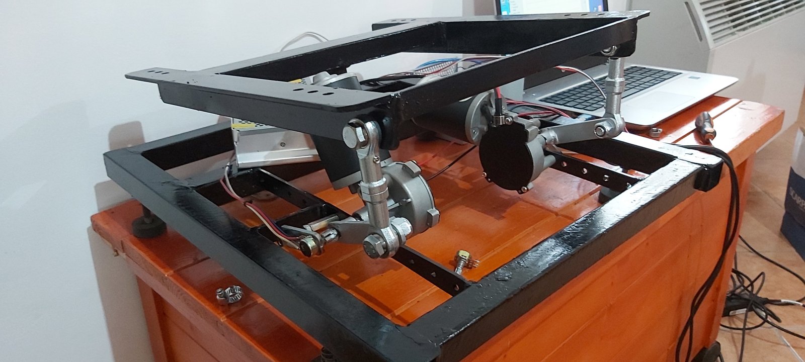

    This is my progress. Now I must assembly motor .

    I finally finished assembling the station. it seems to be working fine, but I have to adjust some parameters again to make it work perfectly. meanwhile, thanks to the forum that helped me a lot. then I will post the final parameters so maybe I can be useful to someone

    here is the test with the station. it moves a little too much so I try slowly to change something

    I have to change the engines are too weak they can't move the person when I'm sitting. pity it seemed that I was finished instead I have to find good strong engines
