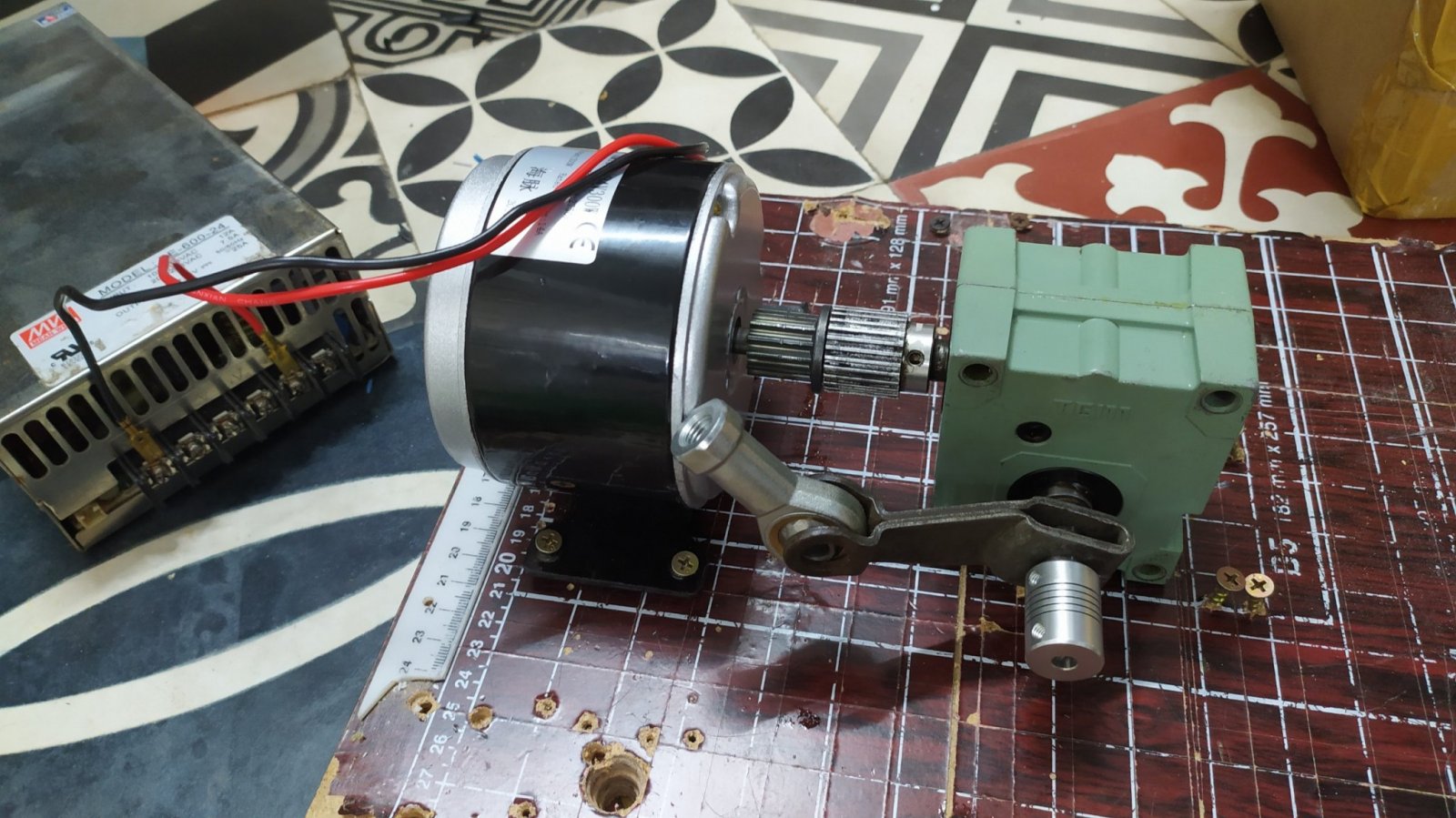

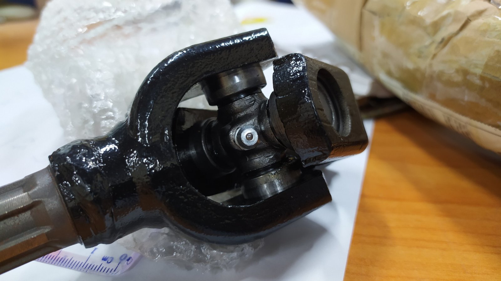

    Hi guys, I'm from Vietnam . This is my biggest DIY project ever

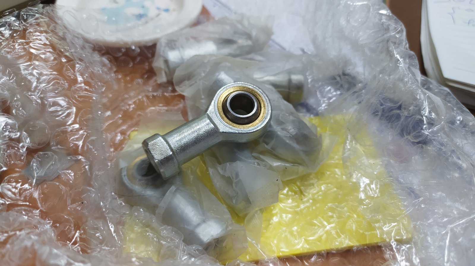

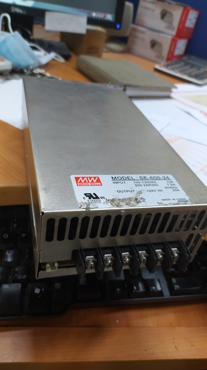

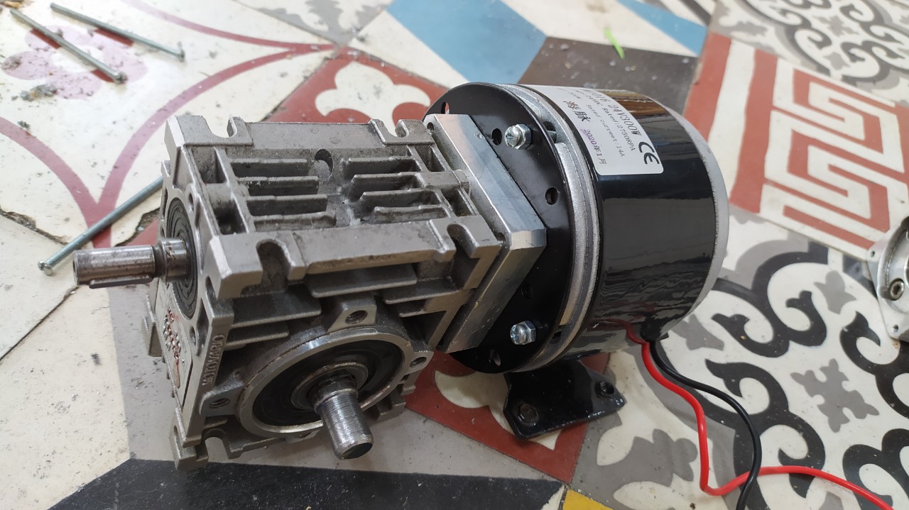

    I have purchased the following parts:

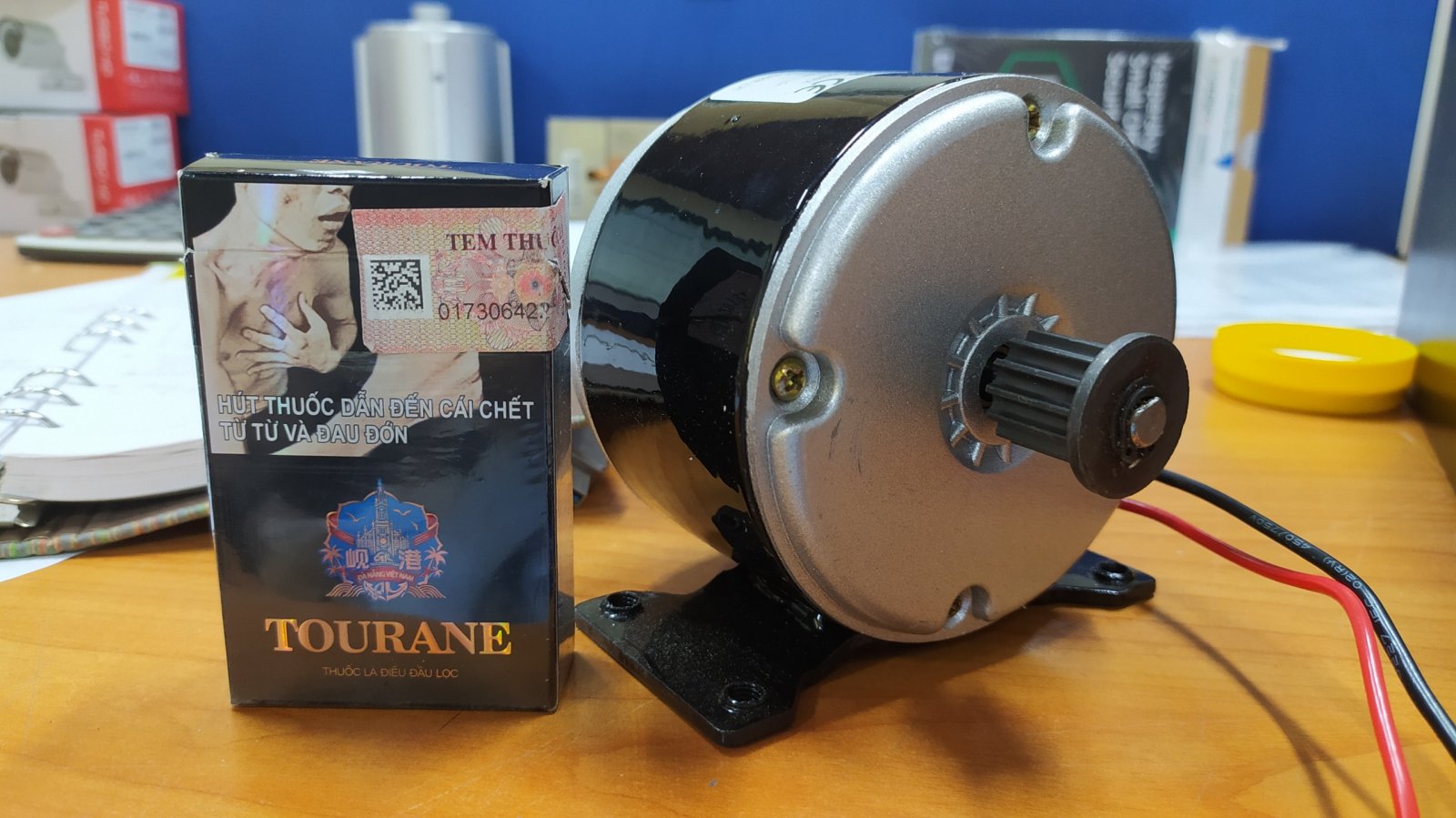

    1. 03 Motor My1025 24v 300W 2750 rpm
    2. 06 Steel ball joint M10

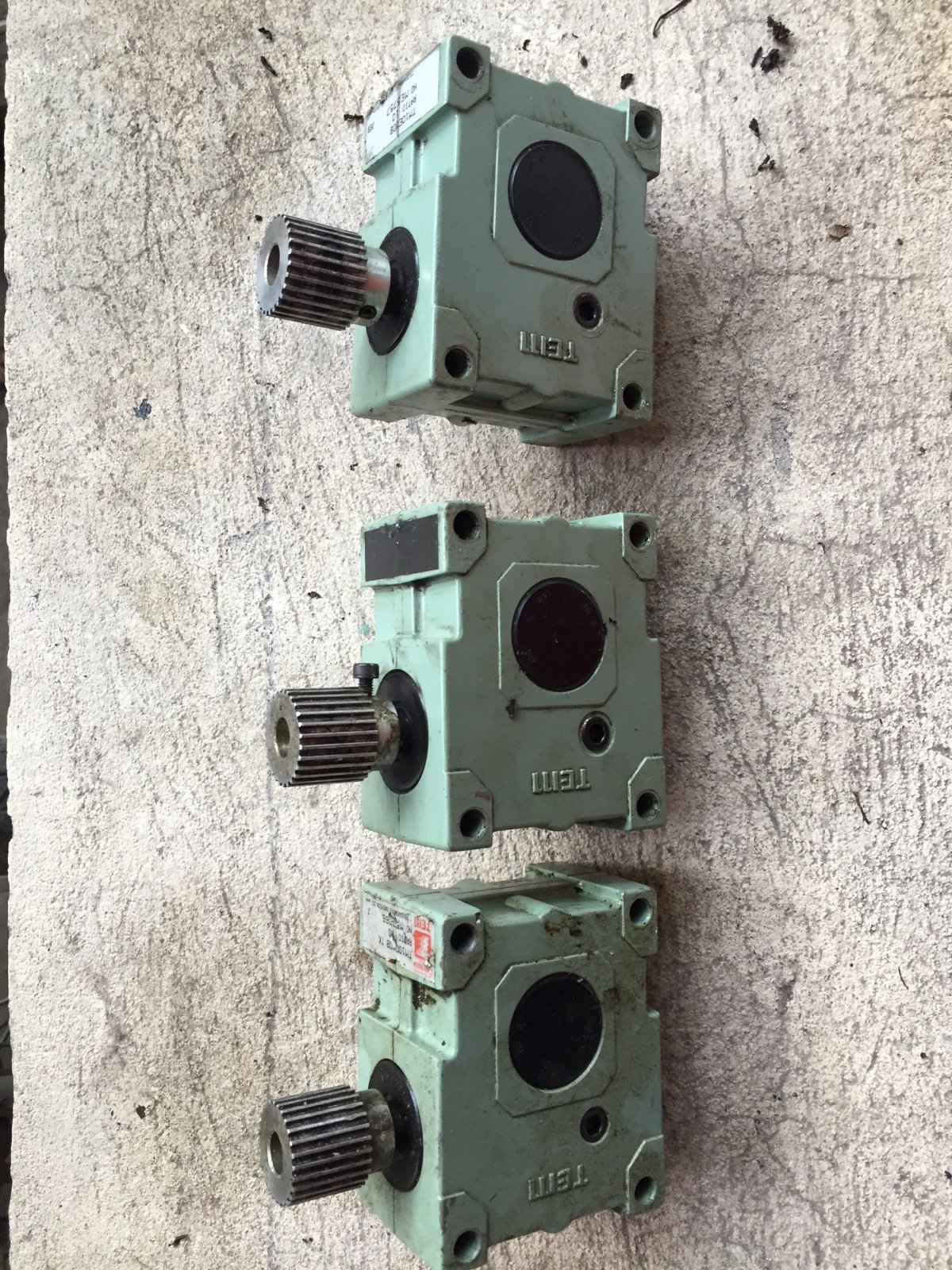

    3. 03 Wormgear Tsubaki TM10E ratio 1:10
    4. 03 electricity supply Meanwell 24V 25A
    5. 01 Universal joint
    6. I had 03 BTS7960 and Arduino uno r3 of the previous project
    updating....

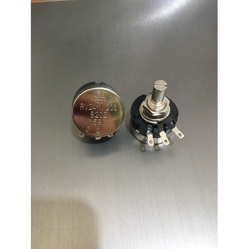

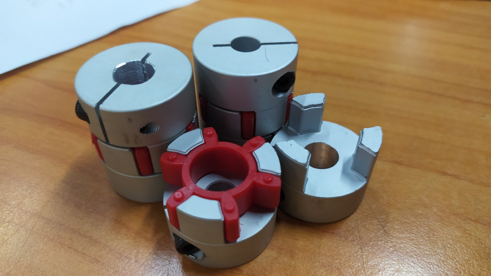

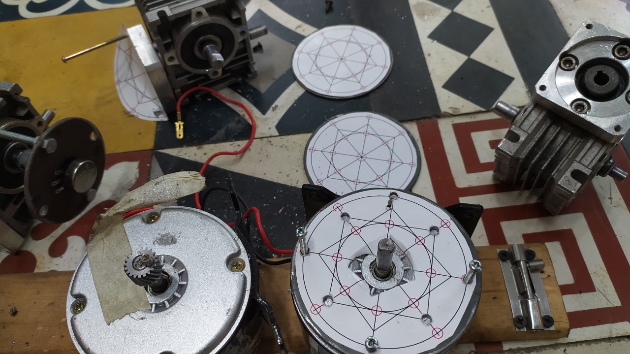

    7. 03 jaw coupler (for mount shaft motor with wormgear)
    8. 03 potentiometer
    9. 03 helical coupler (for mount out shaft wormgear witch potentiometer)

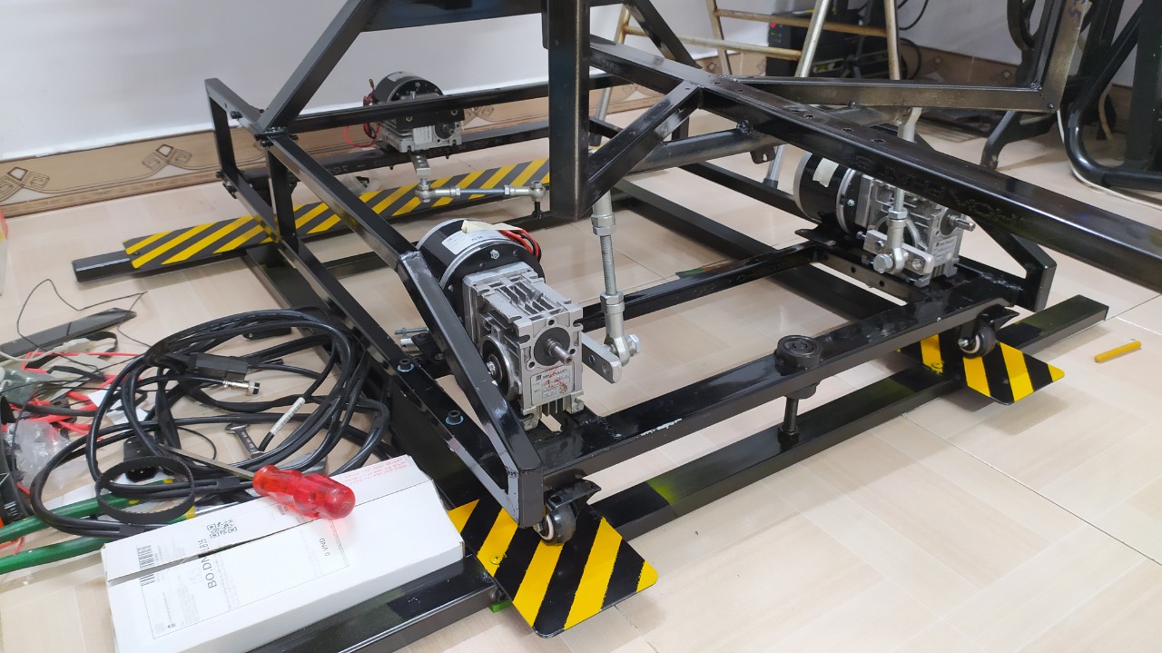

    Yesterday, I tried connecting the engine and gearbox, and happily, the lift was strong and fast.
    Today I will continue to draw the structure of the rig

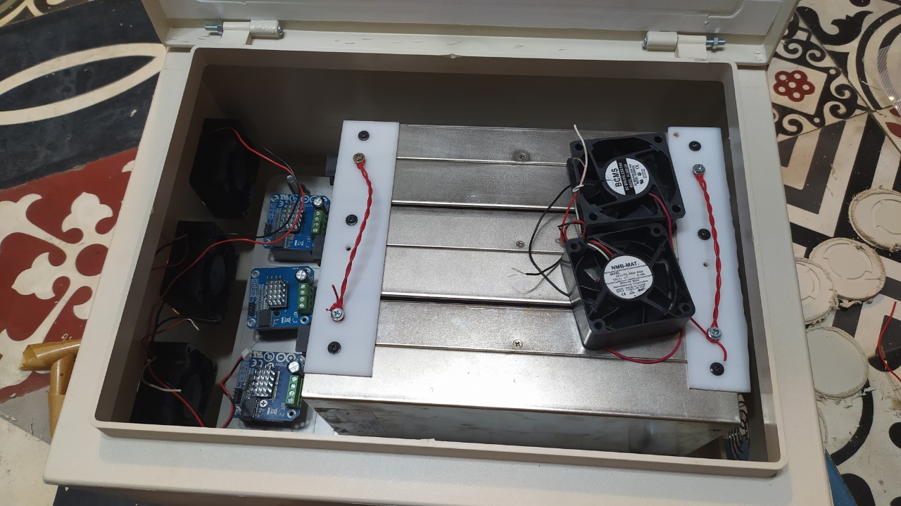

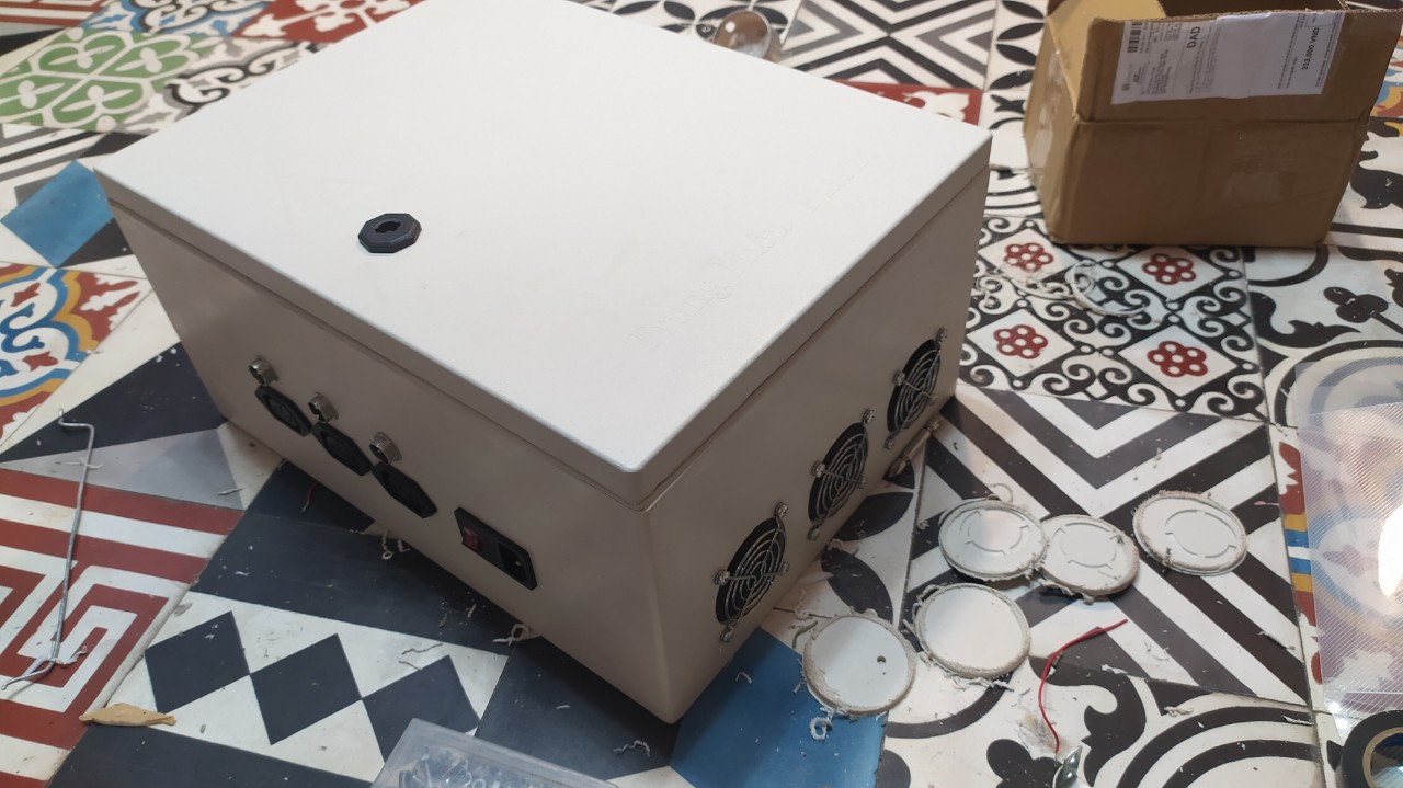

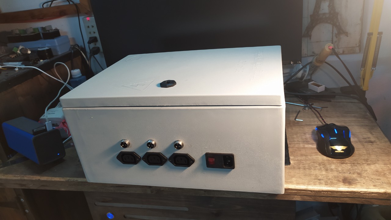

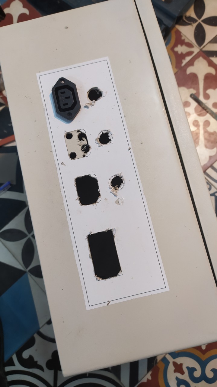

    electric box for rig

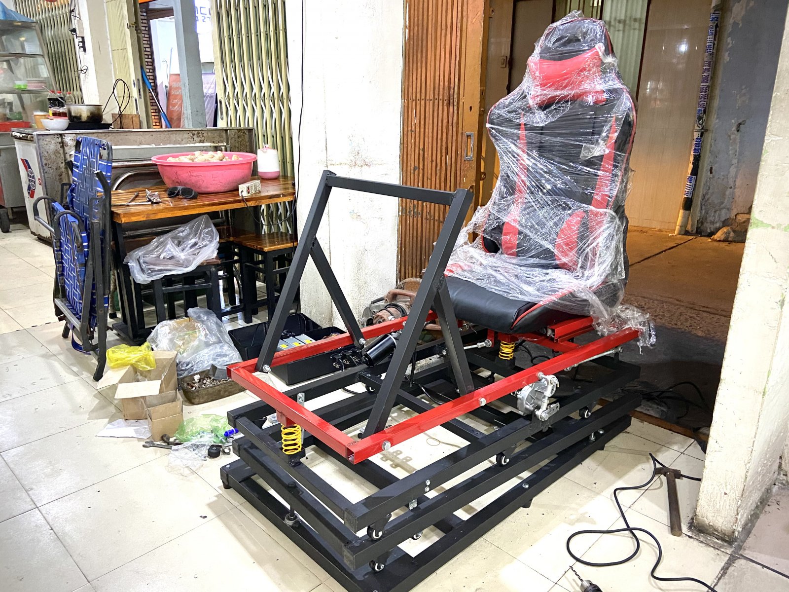

    Try to finish before noel

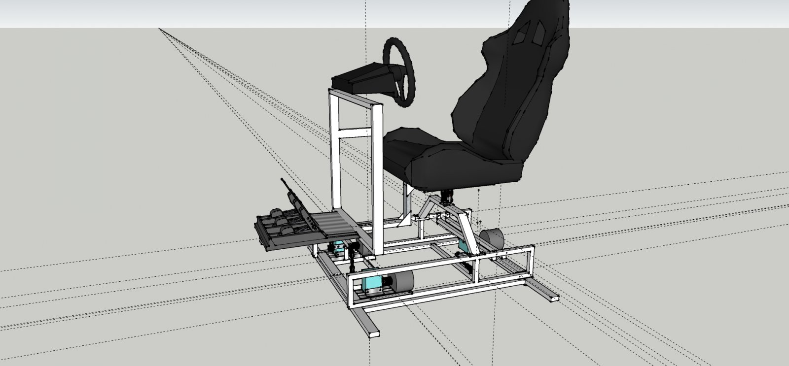

  6. amer
    amer New Member
    Oct 17, 2020
    17
    Malaysia
    157Coins
    2DOF, 3DOF, DC motor, Arduino

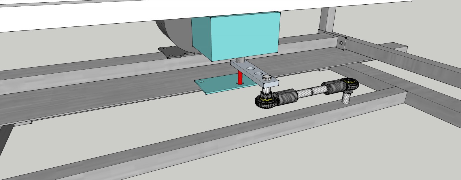

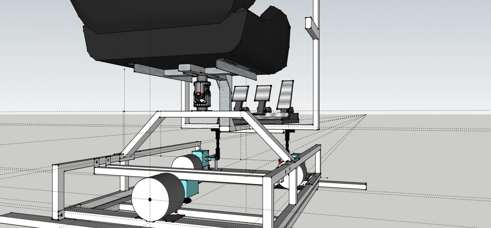

    nice project.. how do you connect upper platform with the base to get the movement for traction loss? what software you are using for 3d design?
  7. ahoenksiluman
    ahoenksiluman Member
    Nov 13, 2017
    91
    indonesia
    89Coins
    +47 / 0 / -0
    is that 1:10 enough..??
    i use 1:50 for the same motor, but it still progress....not running yet...
  8. leductrinh
    leductrinh New Member
    Aug 11, 2020
    17
    32Coins
    +25 / 0 / -0
    I connect as attachment picture , I use sketchup software for the design
    I'm hoping 1:10 will be enough. Try to get the correct balance to reduce the pressure on the gearbox

  11. amer
    amer New Member
    Oct 17, 2020
    17
    Malaysia
    157Coins
    hi, nice work.. can you show how do you attach lever to motor shaft? Im struggling to find the best way on how to attach the lever to the shaft..
  12. leductrinh
    Aug 11, 2020
    17
    32Coins
    +25 / 0 / -0
    i'm used parallel key

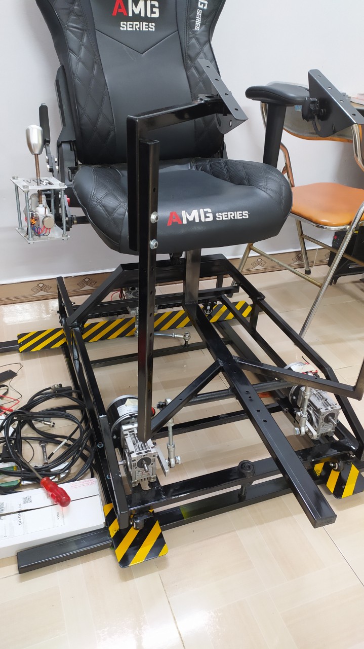

  13. leductrinh
    Aug 11, 2020
    17
    32Coins
    +25 / 0 / -0
    Hi all,
    it works pretty well, but I have a question:
