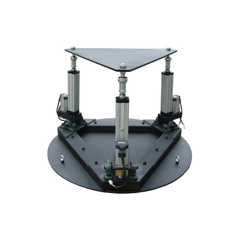

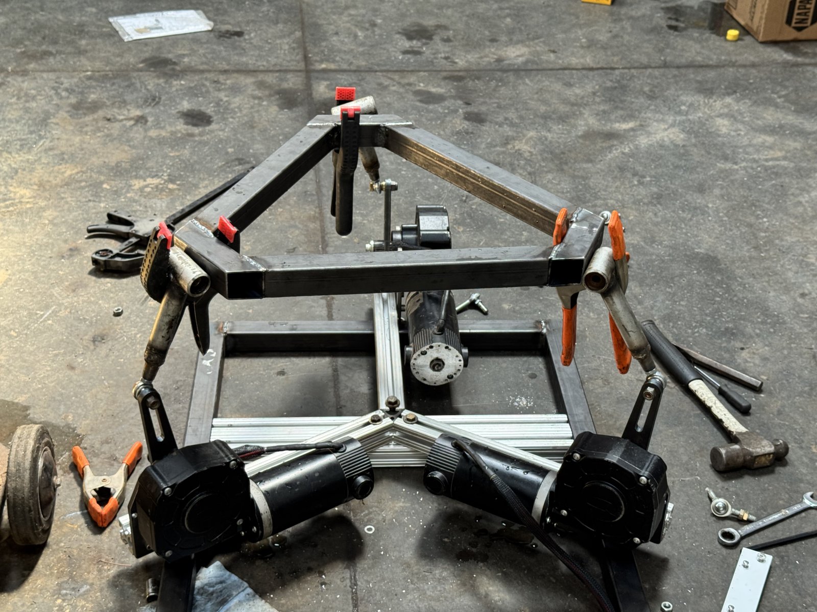

    My plan is to build something like the picture attached. I pulled this image from a google search. the concept I am going for would be similar, however my budget is limited on this project so there will be slight differences.
    But as you can see it will be limited compared to a full 6DOF Stewart platform. Which is why I am wanting to add the extra motor for yaw. My main use for this would be sim racing so I don't mind if there isn't a dramatic amount of yaw. Just enough to feel the tail slide out. I will probably make some sort of leverage linkage to get more range out of it if needed.
    I am still in the brainstorming process of the actual frame, so I am open to ideas. This is why I wanted to be sure it was possible and there was software backing for it before moving forward. I have an extra actuator if needed, but I think this design will be compact, and effective.

    Just a clarification to keep in mind, yaw rotates around a center point and is most prominent in flight based circumstances, traction loss has a pivot point near the feet and is more applicable to sim racing where the rear end breaks lose.
    Personally I think the likes of @SeatTime's 3DOF design if far less subject to torsional twist forces acting directly on the actuators, but as always look forward to others pushing the design envelope.

    Yes, I say yaw only because that is the typical name of the axis, but I plan to use a pivot point on the front in my design. for my upper actuator mounts, I'm going to use heim joints. unfortunately the bottom of the actuator will have to have some sort of wishbone mount so the platform doesn't collapse on itself.
    honestly my setup is super cheap for now. My dogs chewed up my couch and it had 2 29v dc actuator motors rated at 1000N torque. I ordered some 400mm 1605 ball screws and tossed the recliner ballscrew and made a makeshift mount for them. they actually have a pretty decent speed to them. However, this whole project is likely going to be underpowered, and not entirely structurally sound. but if I can get a good foundation, I will make improvements once I see it work!
    I'm setting up my electronics now, and I'm waiting on parts to make DIY hall pots from normal pots seen on a post here. I forget who did it. but that's where i'm at.

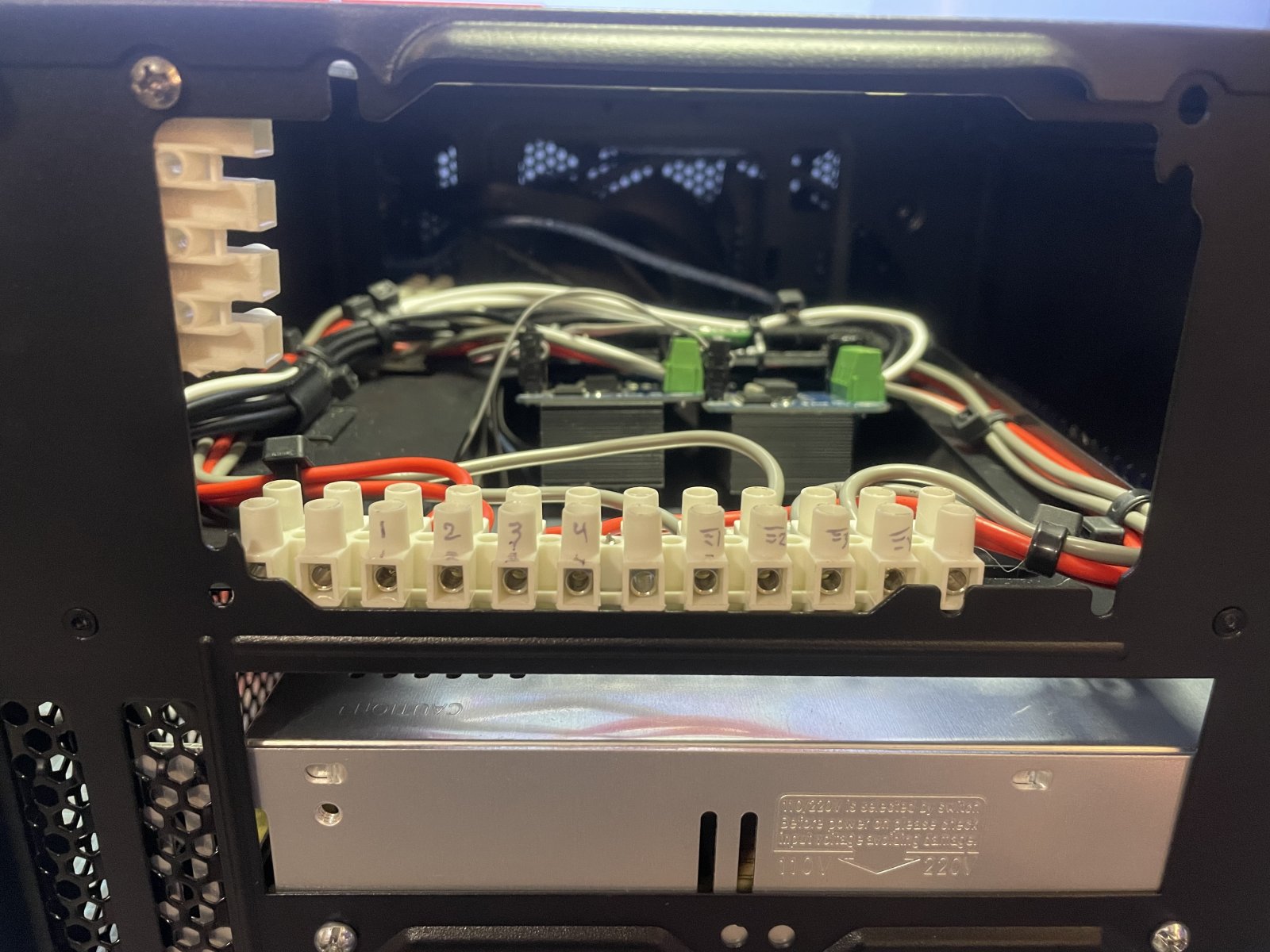

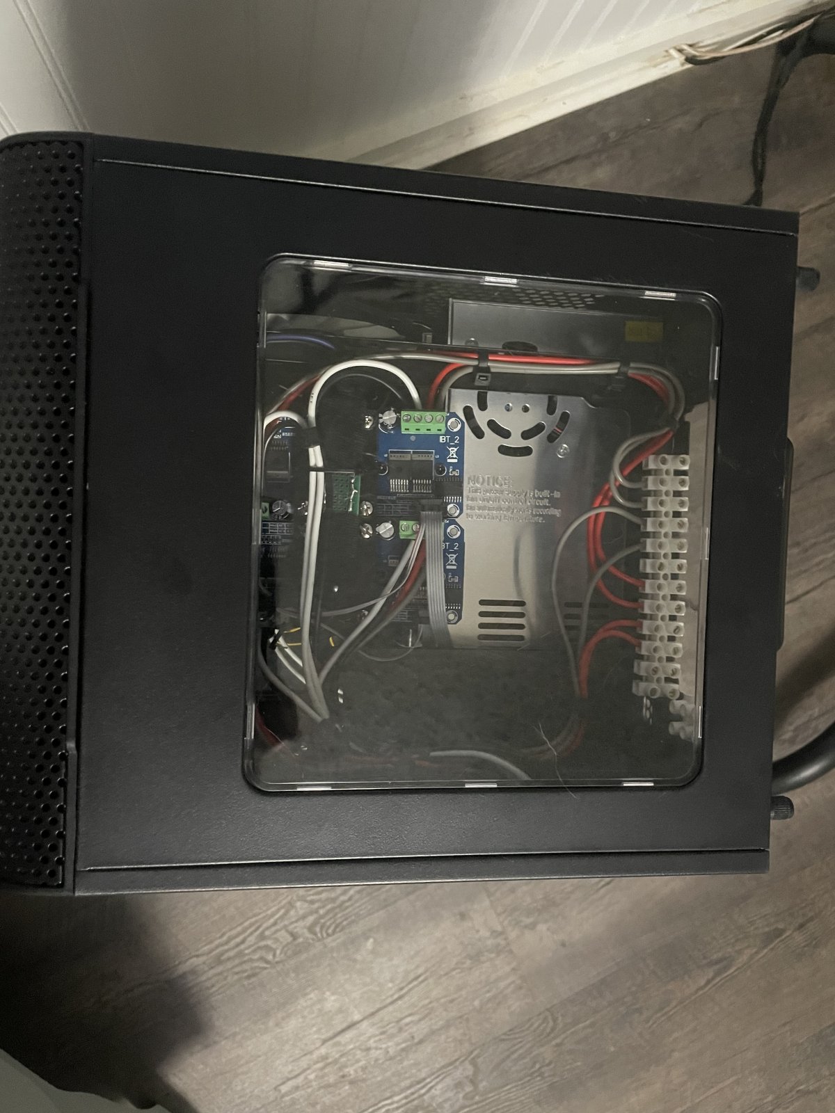

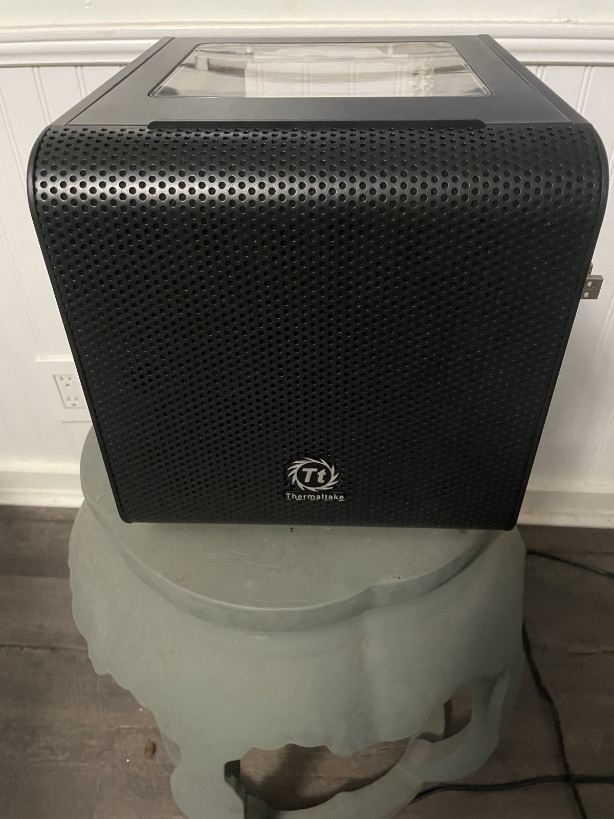

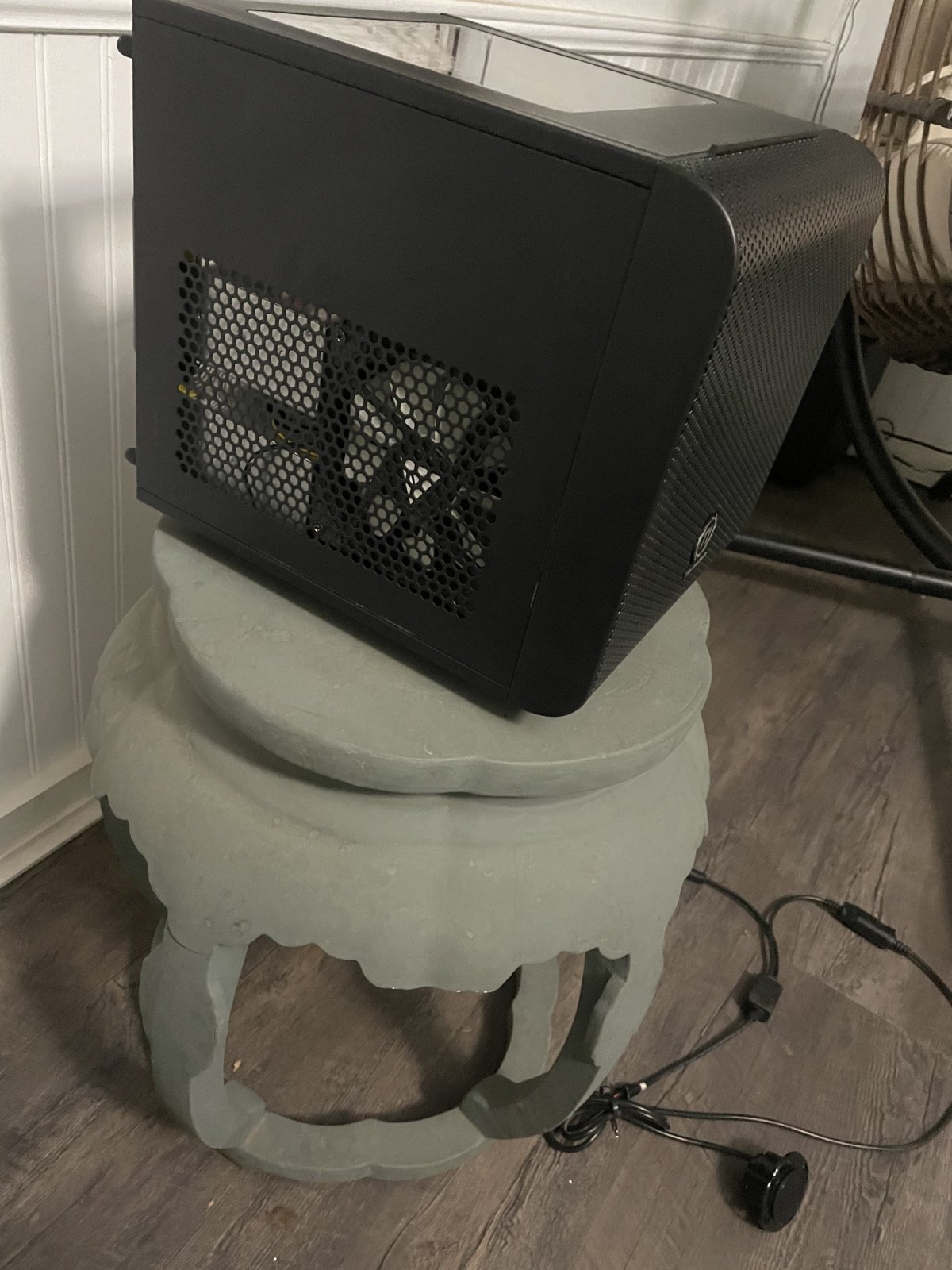

    Here’s my electronics so far. Part of the reason I posted this thread is I am at the point of wiring in all of my signal wires to the Arduino’s. But I’m at a crossroads because I don’t know if i should stick with one UNO, two UNO’s, or put a Mega in there. Haha
    I’m using a thermaltake mini itx pc tower to hold all of my electronics just so it’s tidy.

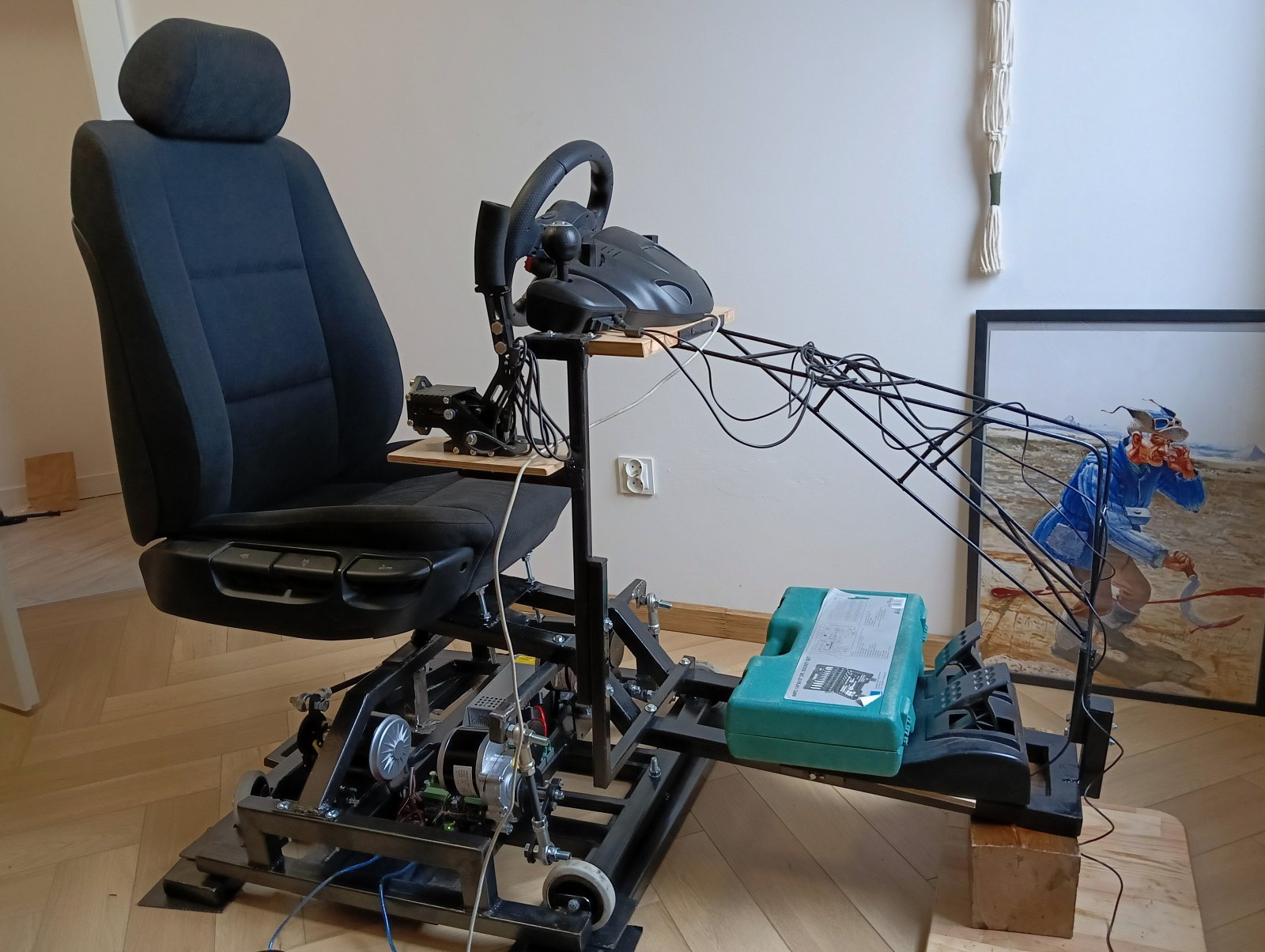

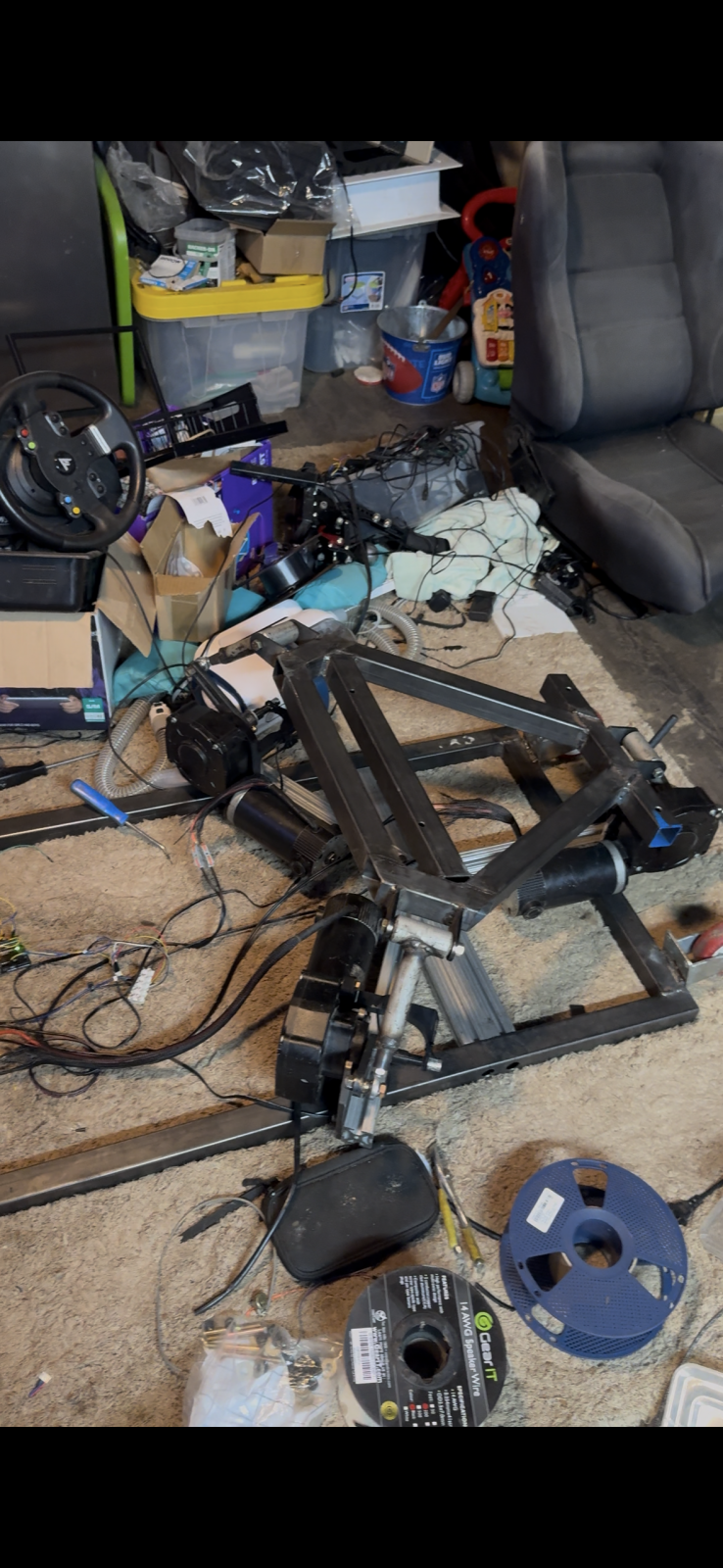

    Been a couple of years since I have worked on this, finally making some progress. As of right now I “had” the simulator moving, but need to stop being cheap so I ordered the correct 180degree hall pots because the jungle website ones I ordered worked, but not very well.
    Also, I’m not sure if there is a way to reverse motor 3 in smc3 but it currently runs backwards in smc3 utilities. I can reverse it in sim tools so it goes the right way, but as soon as the new pots get here I’ll proceed with finalizing, getting my tuning correct.
    I have posted images of the build process and a screenshot from the video when it was moving, ignore the mess lol

  13. noorbeast
    21,611
    151,323Coins
    +11,034 / 56 / -2
    You should be able to reverse the wiring for the motor that goes the wrong way, but as you say you can also easily correct it in SimTools.
