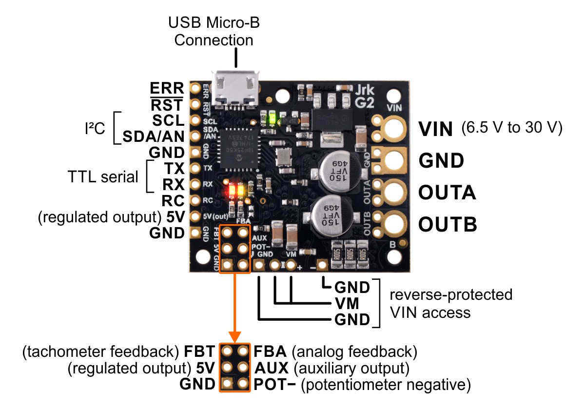

    If not, have you considered switching your electronics over to a pair of JRK's for simplicity?
    I realize that it would up your costs by a fair amount, but they might be worth it considering how far you've come with your build for what sounds like a very low cost so far.
    Last night I configured mine simply by following the manual on Pololu's site, and several great posts here in the forums.
    I chose JRK's over the Arduino + MonsterMoto or Sabertooth options specifically because I liked the fact that they are an all-in-one solution.
    Sometimes keeping things like electronics simple is best, to reduce the amount of setup and troubleshooting.

    Swapping to two JRK's would cost me more than one Sabertooth, that plus I don't have the money to spare.
    The Sabertooth is no more complicated in wiring up etc but the Arduino stuff and different modes e.g. Packet Serial or Simplified Serial is what is my problem bar any hardware issues
    Seeing that I have never read up on how to install JRK's I really am no judge

    I do like the specs on the Sabertooth, and that seems like a much wiser choice over those horrible MonsterMoto knock-off's that people are so adamant about using.
    Averaging a 1/10 ratio of finding a working one?????
    No thanks!
    I'd take a pair of JRK's or an Arduino + Sabertooth any day.
    Oddly, even before I started this DIY motion platform project, I had 4 unused Arduino's here from buying those hobby starter kits on Amazon.
    All I would have had to do was decide on the motor drivers.
    But after reading about all of the stories about people's adventures on that combo (Ard + MM's), the JRK's seemed like the simplest solution, and so far it has been.
    I'm sure had I gone the other route I'd be pulling my hair out by now.

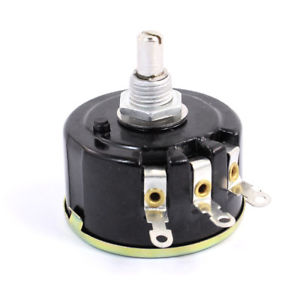

    I thought that Hall Effect's were the Holy Grail as far as feedback controls for our motion platforms, and am surprised to hear that one has crapped out on you.
    Good luck with the pots.
    The plus-side is that they are dirt cheap and if they work then just keep some spares on hand for when they wear out or break.
    I'm using a pair of simple 10k 5w wire-wound ones, and so far so good.
    I paid just under $12 CAD all-in for a 5-pack on Amazon, shipped directly from China.
    This is what they look like, and yes they are quite large in size as far as pots go...I guess that's the nature of wire-wounds.

    It sounds like you'll be just fine racing & flying in VR, as the added motion from the rig (if it's done correctly) helps to trick the brain into what you are seeing.
    If you're doing well in VR right now without motion, then it should be all the better with it.
    Ahhhh, now I see the problem with our previous communication as far as electronics go.
    When I mentioned that I'm using JRK's, you may have thought that those are also dependent upon also using an Arduino Uno.
    They aren't, as they are an all-in-one solution...you just use one for each motor.
    https://www.pololu.com/product/3146
    All they require is to use the included configuration utility to set up the communication method, limits, speed, feedback, etc.
    It's very intuitive when following the supplied guides and several threads here on X-Simulator.
    When I first started the planning of my project I read all lot more horror stories regarding the Arduino/MM/Sabertooth setups vs the JRK ones.
    Yeah, it did cost a few bucks more, but it does seem like a simpler solution.
    I do have a few Arduino's on hand, so if I do decide to build another rig I may try that route next time of an Ardiuino + Sabertooth setup.
    Hopefully you get it all sorted out soon. :popcorn
