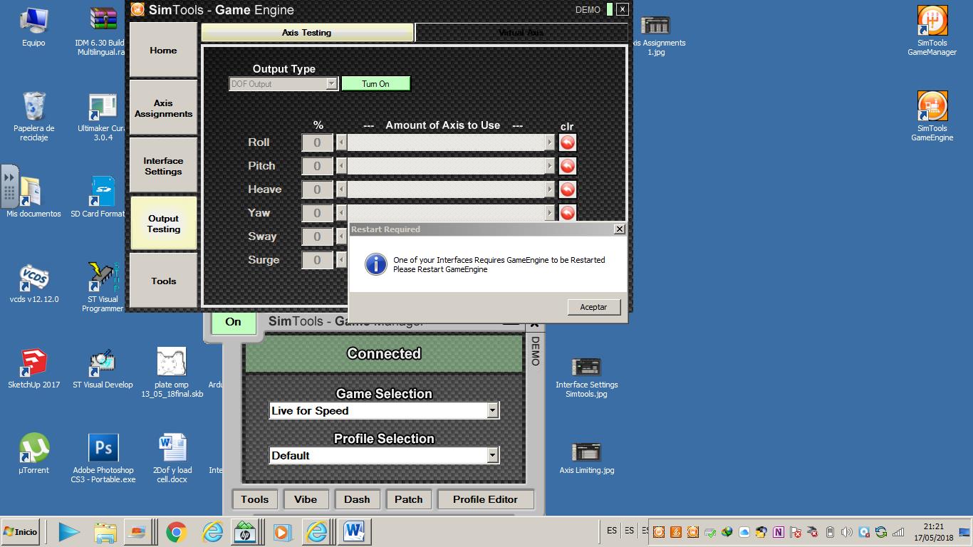

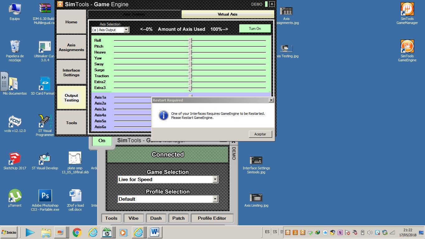

    Hi. I'm mounting a Motion with two SCN5 actuators and as an interface a USB Devantech RS485 adapter and I configure in the Simtools interface like SCN and COM and everything else and it tells me that I have to "Restart GameEngine", I do it and when I'm going to do the Output Test I get the message whenever I have to restart the program and it always does the same to me. Does this USB adapter know if it works with Simtools? I have tried the whole set with the "Lince" software from "Logykal" and everything works, but not with Simtools. Any suggestions? I've tried with one engine only. I have reconfigured the SCN5 with ID = 0 both, and with ID = 0 one and with ID = 1 the other and it does not work either. I put back the USB Drivers and neither, on another computer either ... (Sorry, I use Google translator from Spanish to English ...)

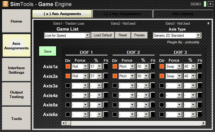

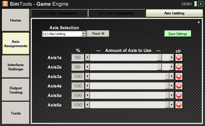

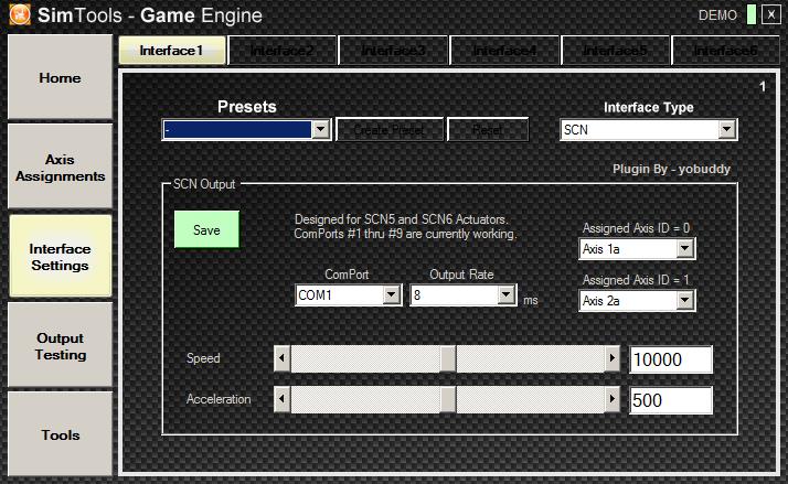

    Hi, I made some screenshots with my configuration in Simtools.
    Hola, he hecho unas capturas de pantalla con mi configuración en Simtools.
    Interface Settings Simtools.jpg Axis Assignments.jpg Axis Limiting.jpg Axis Testing.jpg Virtual Axis.jpg

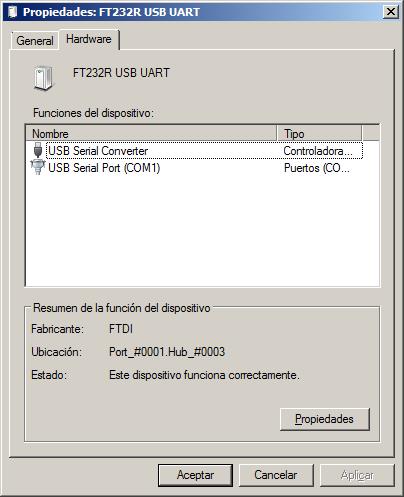

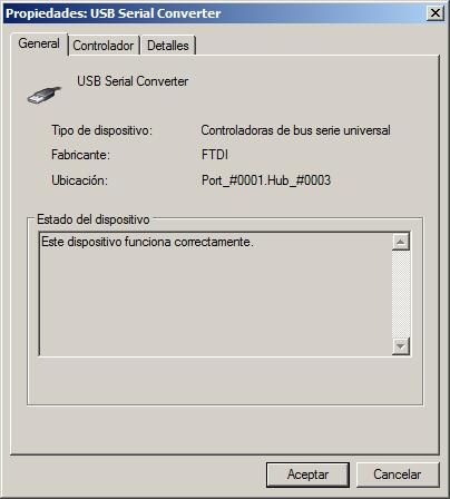

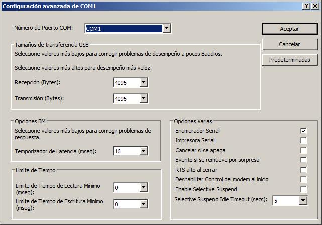

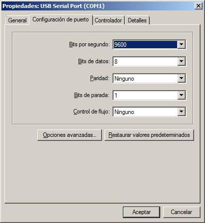

    Configuration in the computer of the USB controller Devantech.
    Configuración en el ordenador del controlador USB Devantech.
    Panel Control 1.jpg Panel Control 2.jpg Panel Control 3.jpg Panel Control 4.jpg

    You will get this message if one of the SCN's can't startup, or has not initialized
    If you are using both SCNs with a single RS485 you will need to configure the axis ID of one of the SCN's, so one is set to ID = 0 and the other SCN needs to be set to ID = 1, then wire them up to the same adapter: https://www.xsimulator.net/communit...on-software-simtools.4872/page-24#post-146927
    The other possible cause is faulty wiring: https://www.xsimulator.net/communit...ngine-with-2dof-on-1-rs485.11735/#post-152139

  13. yobuddy
    5,166
    48,215Coins
    +5,038 / 16 / -0
    Hi @cover4x4,
    Sounds like your SCN's are not getting fully centered on startup.
    Are you using a USB hub by chance?
    Also, please set the COM ports for a speed of '115200'.
    Lastly, try to startup one scn at a time to see if one SCN is causing the centering problem.
    Let me know how it goes buddy.

    Hi @yobuddy. I am not using a USB hub, I have configured the ports with the speed "115200", also with a single actuator (with the actuator ID = 0) and everything remains the same. I want to think it's a problem with the RS485 USB adapter, I'll wait for the one I ordered to arrive (https://es.aliexpress.com/item/WAVG...884.html?spm=a2g0s.9042311.0.0.feb363c0F5oC24). Do you know, or does anyone know how this adapter goes and how are the "jumpers" going?

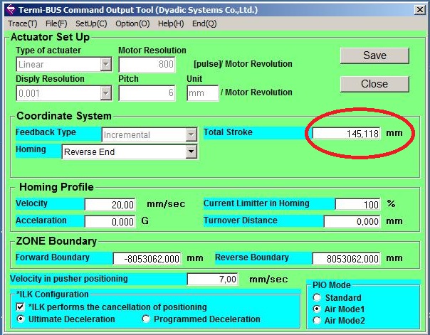

    Oh, one more thing. When I try to move the actuator using the Dyadic software and the actuator is already out, I notice how the motor wants to move and can not, as if it were blocked, but with the hand everything is fine. When I get to move it with the Dyadic software the actuator goes fine in all directions and at all points. Another doubt that I have is that the ILK does not work, I press the button and it does not do anything at all, the actuators work whether the ILK is activated or deactivated. I have reviewed the installation again and it is all correct, even the connectors. The ILK is in position 8 of the connector, in my case the cable color is Gray, and I have also checked the position of the cable in the motor card and it is also correct. I'm going crazy already ....
    Ah, una cosa más. Cuando intento mover el actuador mediante el software de Dyadic y ya está fuera el actuador, noto cómo el motor quiere moverse y no puede, como si estuviera bloqueado, pero con la mano todo va fino. Cuando consigo moverlo con el software de Dyadic el actuador va fino en todas las direcciones y en todos los puntos. Otra duda que tengo es que el ILK no funciona, acciono el pulsador y no hace nada de nada, funcionan los actuadores esté el ILK activado o desactivado. He revisado la instalación de nuevo y está todo correcto, incluso los conectores. El ILK está en la posición 8 del conector, en mi caso el color de cable es Gris, y también he comprobado la posición del cable en la tarjeta del motor y es correcto también. Me estoy volviendo loco ya....

    Well, I finally found the solution. The problem was that an actuator to make the connection to the game, when calibrating was stuck when it was out of the whole and try to return to the beginning, so the solution has been to change using software "TBVST Visual Setting Tool" the configuration of travel , shortening it from 150mm to 145mm to avoid the jam and thus make the connection with the program. In the end it was not a problem of the Devantech interface that works correctly and I leave it here in case someone happens to it. Greetings and thanks, ending the thread.
    Bueno, al fin he encontrado la solución. El problema era que un actuador al hacer la conexión con el juego, al calibrar se quedaba atascado cuando estaba fuera del todo e intentar volver al inicio, con lo que la solución ha sido cambiar mediante software "TBVST Visual Setting Tool" la configuración de recorrido, acortándolo de 150mm a 145mm para evitar el atasco y así hacer la conexión con el programa. Al final no era problema del interface Devantech que funciona correctamente y lo dejo aquí por si a alguien le pasara. Un saludo y gracias, dando por finalizado el hilo.
