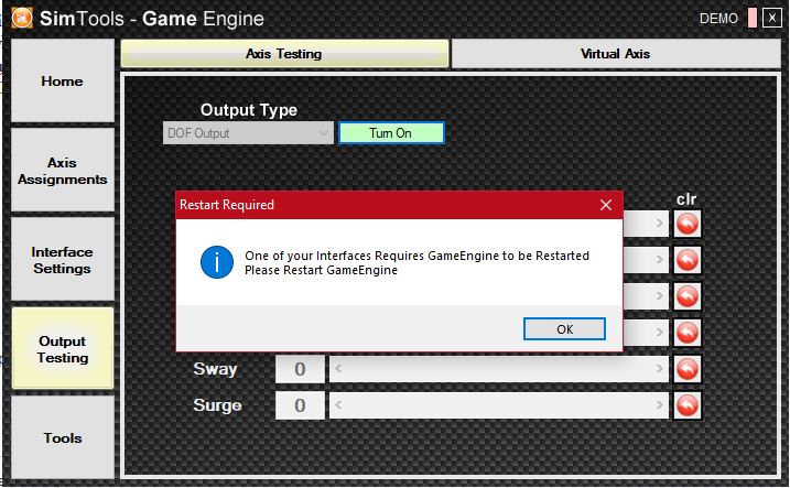

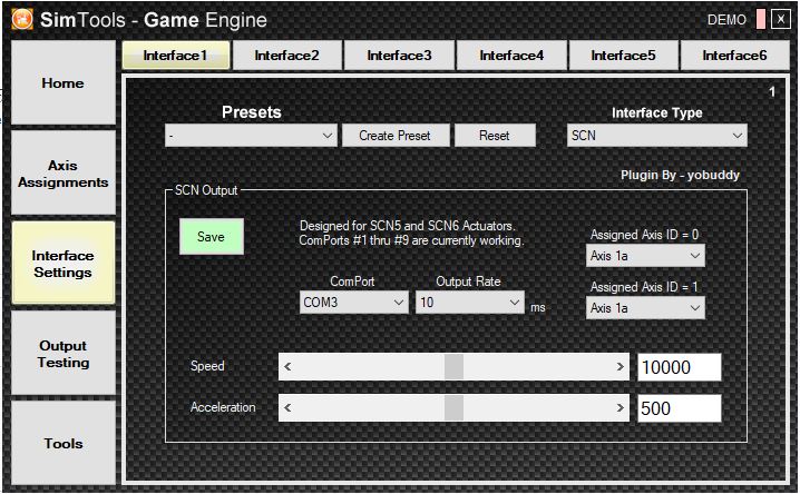

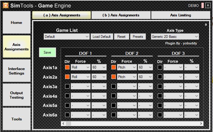

    Hello!
    I am using 2 SCN5 on a Single Converter (USB - RS485).
    I am using Simtools 2.2 which suposedly supports 2 SCN per interface.
    Everytime I go into the ouput testing a message pops up saying "One of your interfaces requires game engine to be restarted...." What am I doing wrong and how can I configure 2 SCN on a single Interface and COM Port.

    not sure I have never messed with scn interface but do axis id=0 and axis id=1 represent the two different actuators? if so you would need to change the assigned axis in one of the fields to axis 2a. otherwise both actuators are getting the same axis info which could cause a conflict.

    I changed the values as you said ID=0 Axis 1a and ID=1 Axis 2a and still the same results.
    I just want to make a test just to see if I can get the actuators moving. What should I do? Thank you ;)

  5. madVape
    madVape New Member
    Mar 5, 2018
    6
    Vape Store and Sim area
    Portugal
    104Coins
    Yes, I was able to fix the problem. I came to the conclusion that it might be bad wiring so I re did all the wiring and it's working fine now. Sim Tools detects the 2 actuators and I can use them both using the same COM Port and Interface. Thank you very much for your help. ;)
