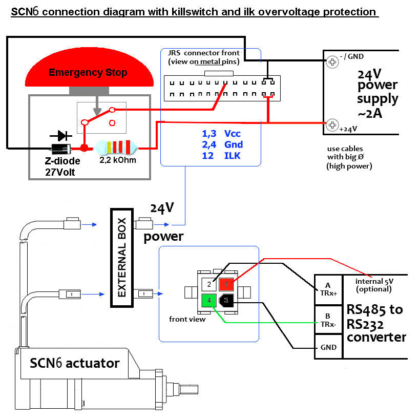

    This is a tutorial for explain what you need to correctly wiring two SCN5 to your simulator.

    For an electronic expert (you can find the official SCN5 & SCN6 manual at this link), this diagram and examples might be enough, but let me talk through that.
    In this diagram you can see:
    a) SCN5/SCN6 actuator (it will be two for this case)
    b) RS485 USB converter (it will be two as well)
    c) Power Supply 24 Volt
    d) Emergency Stop button
    (optional)

    THE WIRING
    After connecting the converters to the computer, and install the drivers, and disconnect those again, the wiring will be easier. Now we can start the actual work.
    The actuator has two cable, one squared with 4 pins for the signal, and the other flat for the power with 14 pins.
    Actually, there is another case though, if you have purchased a SCN5 from a reseller that use SCN5 actuator for their Motion Simulator, it's possible that you will find a completely different cable (like simXperience). In that case you have to search for a technical sheet and work out the ID number of the pins, and use that for reference. If you have some problem with the technical sheet, you can always open the plastic enclosure, and find the original connectors. In this way it's quite easy to trace the right PINs and proceed accordingly.
    On your USB Converter, you can find different kind of connector label, it depends on which model of converter you have. Anyway you can always find written on the contacts, or on the technical sheet of the converter, which pin is the negative/TRx- (sometime you can find only the symbol "-"), the positive/TRx+ (sometime only "+") and the ground/GND. Some models have just 3 pins, others have 4 pins, anyway it doesn't really matters, you can skip the 5V pin.
    For the wires connection you can weld the wires on the connector's pin or strip the back wire to reconnect it where you need. It will achieve the same result, choose the solution that will be more comfortable.
    Take the square connector of the first actuator, check the diagram at the start of the page and wire the pins that you will find in this table with one of your converters (no matter which one):
    1) PIN3 (the pyramidal one) to the GND PIN (ground) of the converter
    2) PIN4 to the B TRx- PIN of the converter
    3) PIN2 to the A TRx+ PIN of the converter
    OPTIONAL) PIN1 to the 5V PIN on the converter, but it's not needed, so I recommend to skip this step.
    Once you did that on the first actuator and the first converter, do the same thing with the second actuator and the second converter.
    Now we have wired the signal part of the tutorial and we can deal with the power one.
    Obviously, dealing with electric power, you have to take every safety precautions needed, and if you are not an expert of electrical devices, or a professional electrician, you need a supervisor that can avoid every dangerous mistakes that can happen.
    DO NOT SKIP THIS STEP.
    Look again to the diagram at the start of this page. You can find the second connector, the flat one, it's named "JRS connector". For SCN5 you will need only 3 PINs for this procedure, in order: PIN1 (VCC), PIN2 (GND) and PIN8 (ILK) and for SCN6 you need PIN1 and PIN3 (VCC), PIN2 and PIN4 (GND), PIN12 (ILK).
    You can proceed in two ways:
    a) Use a "kill switch", connecting a Emergency Stop Button on the power line.
    b) Use a simple on/off switch.
    On the diagram you find the kill switch solution, but I will explain briefly the on/off switch as well.
    a) First of all, keep the power supply UNPLUGGED FROM THE ELECTRIC POWER. DO NOT PLUG IT IN UNTIL YOU REACH THE RIGHT STEP. DO NOT SKIP THIS STEP.
    In the kill switch you will need all three PINs. In this case, the diagram does a better job explaining what do you have to do, just follow it. Be sure that you connect the PIN1 to the +24V line of your power supply, PIN2 to the -Ground (GND) line. Don't forget the 2k2 resistance between PIN1 and PIN8 (ILK).
    b) First of all, keep the power supply UNPLUGGED FROM THE ELECTRIC POWER. DO NOT PLUG IT IN UNTIL YOU REACH THE RIGHT STEP. DO NOT SKIP THIS STEP.
    For the on/off switch connect the PIN2 to the -Ground (GND) of the power supply, then connect the PIN1 to the +24V line and place a 2k2 resistance between PIN1 and PIN8 (ILK). Now you can add an on/off switch to the power input of your power supply (there are many ways to do that, pick your favorite) and it's done.
    Once you did that, you can plug the USB Converters to the PC (through a USB HUB, if needed), check if your power supply have a 220V/110V mode, set it to 220V (if you are using normal european electric power) and, WITH CAUTION (do not take any risk!), you can PLUG THE POWER SUPPLY TO THE ELECTRIC POWER.
    You can do that using a normal power cord, connecting that to the input PINs of the power supply, and ONLY AFTER that, plug the cord to the power.
    Now you should hear a little "rumble" coming from the actuators, that sound means that the actuator are correctly powered.
    With this last step you have successfully completed this tutorial.
    Now, you can setup the software on your PC and verify if everything is working.

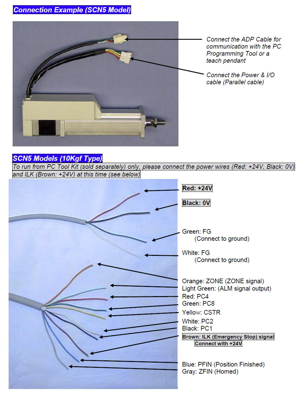

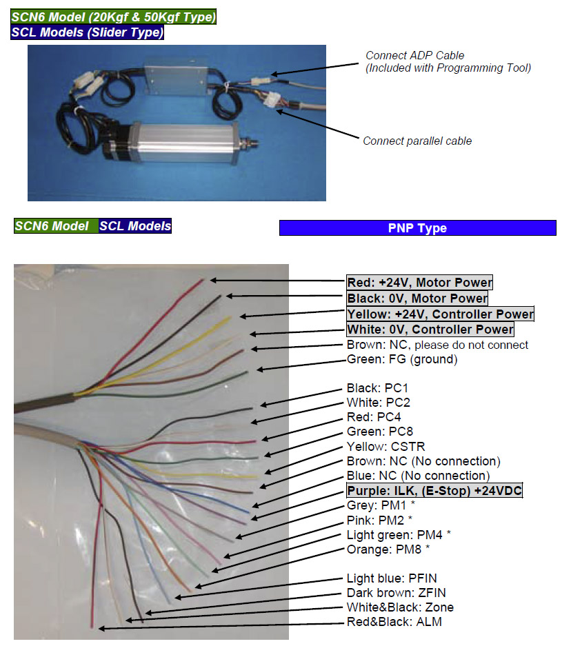

    Hello, excellent tutorialon snc5/6 actuators. I tagged this thread for futur reference . Just a question if nobody minds :
    what about those snc5/6 actuators from Japan (Frex for instance) ? do they work according to the same wiring ?

    If I understand correctly, the wiring in the tutorial should be applicable to PNP type, for Japan version, the ILK pin should be connected to 0V.

    they should work fine
