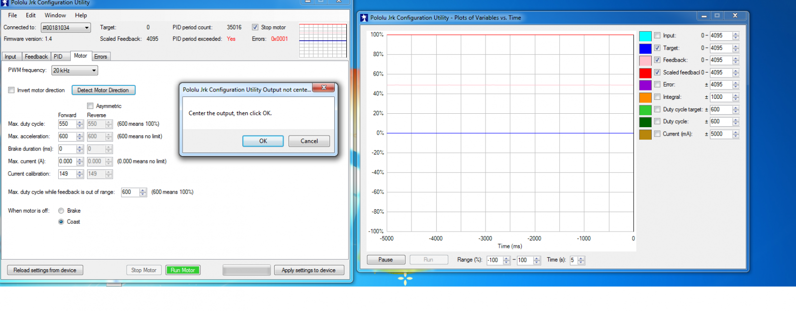

    So, I have followed a guide that was posted in a thread on this website on how to configure the JRK units.
    https://www.xsimulator.net/community/threads/playseat-to-2-dofseat.5401/page-2#post-56352
    When I get to the last part of the guide and click on detect motors I get a message that says "center the output, then click ok".
    Now, I have tried to position the lever in the center position and click okay, but this has not worked out. I am a bit lost on what to do next because I have not found a lot online regarding this issue. Maybe someone in these forums can help me out with this issue. Okay, for now I will get some rest as I been working on this thing for too long.
  2. MarkusB
    Jun 30, 2015
    552
    4,213Coins
    +597 / 2 / -0
    Hi @James Farrar,
    Not only the lever needs to be in the center position, but especially the potentiometer. Maybe you need to loosen it from the axis, turn it until the pot line in the JRK utility is in the middle of the diagram, and then tighten the pot again.

    Yes, I think this is my issue. I don't know which one is the pot line. I'm guessing feedback?
    Actually, I think I might have another problem. I might have connected the pot to the JRK in the wrong way. On my pot there are three pins labled GND, V out, and +5v. I connected the GND to the GND. The V out to the 5v (regulated output), and the +5v to the top right pin that is the feedback input.
  4. MarkusB
    Jun 30, 2015
    552
    4,213Coins
    +597 / 2 / -0
    Yes, you may have to switch the "V out" and the "+5 V" pins.
    About the curve: Yes, I guess it is the one labeled "Feedback", but it is easy to find out: Assumed that the pot is wired correctly, just turn the pot and watch which curve is changing.

  8. James Farrar
    James Farrar Member
    Apr 8, 2017
    45
    Irving, Texas
    335Coins
    +14 / 0 / -0
    I was wondering if anyone could help me sort this issue out. Here is a screenshot of what happens when I try to click on detect motor. In the plot I can see the feedback line and it changes depending on how I rotate the pot. Everything seems good there. What I thought of the center is between 100% and 0% on the graph. It looks like the feedback is between the 60% and 40% line so that looks good to me. This is also aligned to the center position of the lever. When I rotate the lever to the max up position I can see the feedback line shoot down to 20% and when I rotate the lever to it's max down position I can see it shoot up to 80%. Everything seems good to go to me at this point. However, I still have the same issue when I click on detect motor it comes back and tells me to center the output. I have the lever in the center position and the pot in the 50% position on the graph. So, I need some some help to figure this out.
    21,524
    150,764Coins
    +11,019 / 55 / -2
    Seems your PID period is exceeded, with the motor stop checked, so you also need to check your other settings as they are likely not correct.
    With the lever level disconnect the pot and turn it until it is in the center of the graph, then carefully remount it and run the setup again.

    So, the feedback line needs to be at 0%? That's the center? The reason I thought 50% was the center was because anytime I rotate the pot sensor it goes down to 0% and then shoots back up to 100%. It never drops below 0% and into the negative bottom half of the graph.

  11. MarkusB
    Jun 30, 2015
    552
    4,213Coins
    +597 / 2 / -0
    Hi @James Farrar,
    no, the center position is definitely at 50% as you assumed.
    I also did my configuration with the tutorial you mentioned, and it worked. The only difference is probably that I am using a regular pot instead of a hall effect sensor. I have no experience with hall effect sensors. Maybe they need to be handled differently?
    @cgodwin: You explained the behavior of your sensor. But is there anything else to be considered in comparison to usual pots?
  12. noorbeast
    21,524
    150,764Coins
    +11,019 / 55 / -2
    Sorry I am confusing you, I meant the middle of the top graph 50%.
    Please post pictures of all of your settings, something is triggering the PID Period being exceeded.

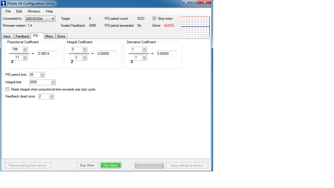

  14. James Farrar
    James Farrar Member
    Apr 8, 2017
    45
    Irving, Texas
    335Coins
    +14 / 0 / -0
    Here are some screenshots of my settings.

    Hey, So I been toying around with the JRK utility program and I managed to get it setup. Sort of... I reset everything back to factory defaults after I centered the hall sensor and that seemed fix my issue with getting the prompt to center my output. The motor kicks slightly and and I can move the motor through simtools.
    Here is the problem that I have now. As I move the slider for the axis the motion is not smooth at all, and after awhile the power supply to the JRK disconnects. I noticed on the back of my PSU the green light for the power goes out and I have to unplug and plug in the PSU again to have it come back on. After that I can go back to the Simtools program and move the motor again.
    When I get some more time tomorrow I will have to resolder some of the pins on the other and JRK. Hopefully after I do that I can set up the other axis.
