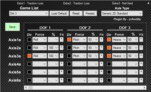

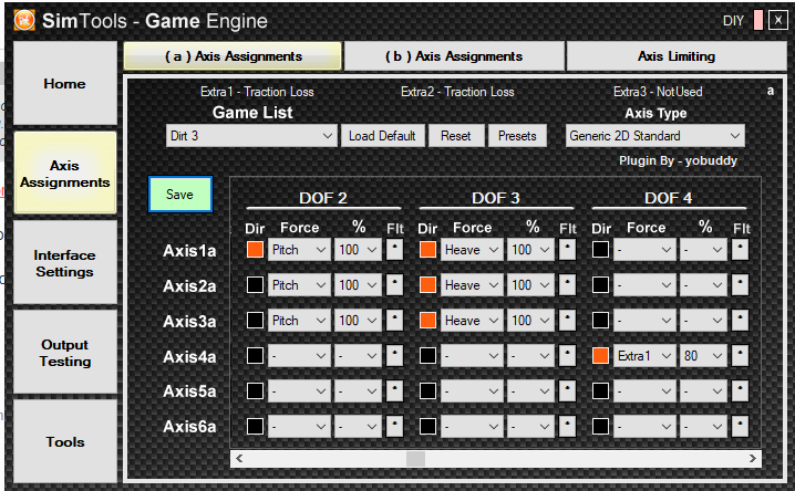

    I have a 4dof sim and my 4th axis is for traction loss but when I use the Extra1 on axis 4 in Dirt2 and 3 the motor#4 is receiving surge input from the games instead of traction loss. In Simtools it is indicated that Extra1 is for traction loss. Tuning center is also displaying surge input in the Extra1 cell when I'm accelerating or breaking. Is there an other step we need to perform to get traction loss from these games? Could the latest version of Simtools have changed the way the engine digests Dirt2 and 3 telemetry? Dirt Rally runs perfectly with traction loss. Tks!

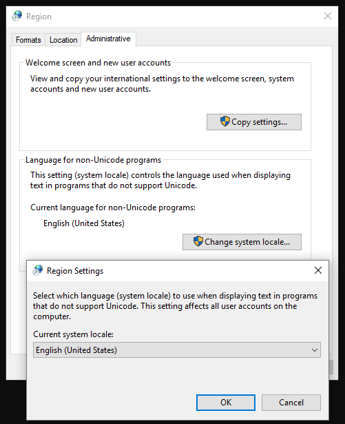

    Can I check and see if your computer is set to English Local: https://www.xsimulator.net/community/faq/simtools-language-setting-bug-change-to-english-local.233/

    Tks for your response noorbeast. The Axis 4 allocation is 80 and is not share with other motion input since the motor is used only for traction loss. System locale is English. As mentioned, the same settings in Dirt Rally and also Assetto Corsa works great with traction loss allocated to Extra 1. But Simtools interpretes Extra 1 as surge in Dirt 2 and 3.

    The Axis Allocations on the others are 200% which really is too high and just complicates getting the best out of the motion profile.

    Thanks @noorbeast. Is 200 too high even if I have 3 motors (3 independent axis) to share the pitch/heave motions? Yet these motions perform well and are very smooth with the current setting. At 50 on each dof the pitch/heave motions feel weak and incomplete.

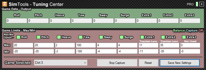

    In the actual plugin (2.0.0.1) Traction Loss (Extra1 or Extra2) have nothing in common with surge.
    Traction Loss is calculated as the delta between the speed vector and the heading of the car while surge is the longitudinal acceleration of the car.
    Use 50 for pitch and heave instead of 100 and play with the values in Tuning Center.
    You might want to play with your settings in Tuning Centre, if you don’t feel happy with the movements of your simulator.

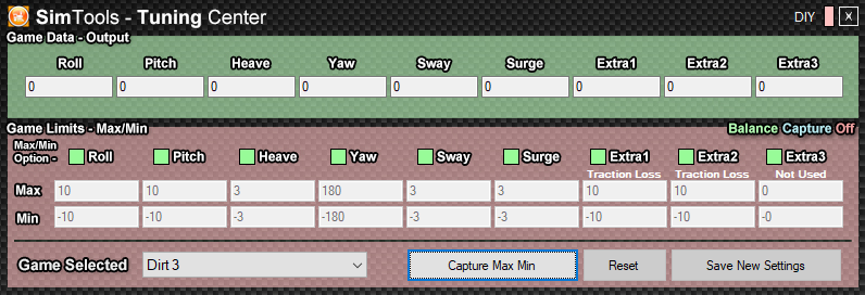

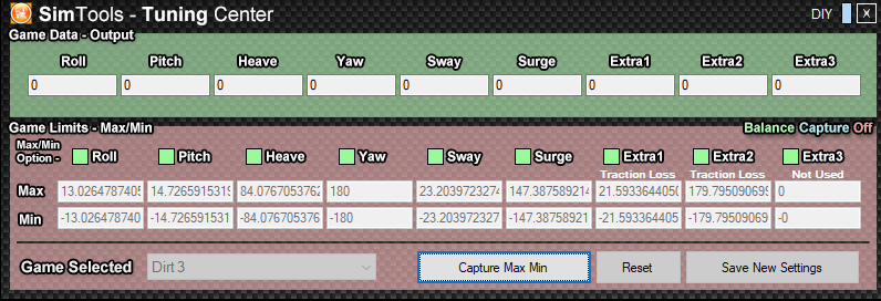

    Right-click on the Game Engine icon in the System tray and select Tuning Centre to open the Tuning Centre. Click on Capture Max Min to change the Max Min values. The lower these Max/Min values the more intensive the movements.

    I have 4 motors (4 axis). In Dirt 2 and 3, when I hit the accelerator or the brakes, the motion goes to my axis 4 which is dedicated to traction loss (Extra1).
    See my videoclip of the traction loss motion:
    In Dirt Rally, Assetto Corsa, etc, gas and brakes are doing the normal pitch motion and traction loss is moving my axis4. My Simtool settings are the same in Dirt 2, 3, Rally, Assetto. I did the tuning and I'm still getting the problem. It happens only with Dirt2 and 3. Do you think it could be due to the way the latest Simtool version is interpreting these two games? They're getting old. Tks!

    Yes 200% total is way too high and will cause clipping.
    You need to do a motion profile for each game, doing each axis/force in turn, try smaller tuning Center values for snappier motion: https://www.xsimulator.net/community/faq/steps-to-create-a-motion-profile.228/

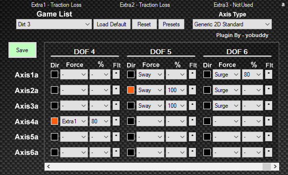

    Agreed, but why is accelerating and braking in Dirt2 and 3 sending a motion input to my axis4 which is for traction loss (when I hit the gas my cockpit yaws left and when I brake it yaws right)? I'm putting Exta1 in Axis4, not surge. Therefore I should receive traction loss motion on that axis, not acceleration and braking. That's what I can't figure out.
    Can you please send me a screen capture of your motion profile for Dirt 3, if you have one? Thanks for helping. Sorry to keep coming back but I'm really stuck and I'd like these two games to work with traction loss. I can make a video of what my cockpit is doing when using these settings.

    Tks Value1. Here are my settings for Dirt3.
    upload_2018-3-25_13-25-35.png upload_2018-3-25_13-26-0.png upload_2018-3-25_13-30-13.png
  20. jjanu
    jjanu LiveForSim Gold Contributor
    Apr 13, 2013
    72
    Multimedia
    Québec
    650Coins
    +63 / 2 / -0
    Good news guys, I just redid a new capture in Tuning Center for Dirt3 and it did the trick. Motions are great and the traction loss input works perfectly. Strange because I did it twice recently and still had the error. And now it works. That might have something to do with the pitch/heave that are now at 50 each instead of 100. That's the only explanation. I'll try the same with Dirt2. Thanks a lot!!
