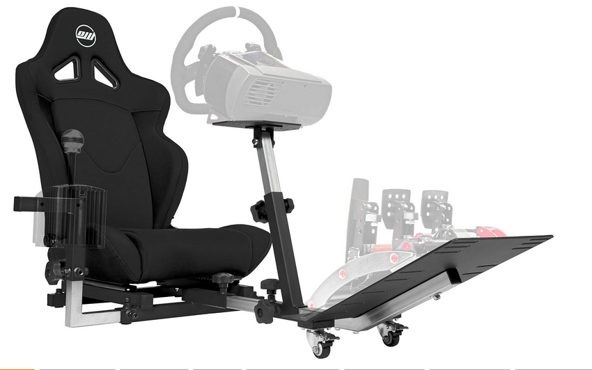

    Hi all, been weighing options/designs for my first build over the past few weeks, and this is a thought I had, which I couldn't find much info or experiences on. TLDR at bottom if you don't care for the details/thinking out loud.
    So I want to build 2DOF to start out, and like the idea of having the pedals/wheel mounted directly to the seat. I keep starting to plan out a design in CAD so I can price out the steel I need to order for a frame. However I am 6'4" and ~240lbs so I am a bit nervous about trying to guess at distance/angle for the pedal box and wheel. So ultimately I keep looking at ways to add adjustment ability to the design.
    This always comes down to a couple design options:
    • square under seat with 2 rails coming out the front (similar to the DIY in the FAQ)
      • side rails will have double sized square tubing to allow length adjustment, as well as diagonal/vertical adjustment on the wheel
      • potentially more stable/rigid
      • probably weighs more
    • square under seat, 1 wide rail coming out from under the center of seat, wheel post comes up between legs
      • same adjustment approach for wheel, unsure of rectangular tubing /sliding adjustment feasibility
      • probably lighter but less rigid
    However the complexity of adding adjustment seems like a lot of additional work/materials that I am unsure is worth it. I also have not found/purchased an exact seat yet, though like the size options of some cheaper sparco or nrg seats. With that said the cost of just the seats is anywhere from $200-$400, and it seems like there are some pretty decent options on amazon for a steel frame + seat with a lot of the adjust-ability aspects figured out already. However all of the designs I have seen appear to rely on the floor to provide rigidity for the pedal box, but I am a programmer so not super well versed on materials or structural engineering so looking for some experienced opinions.
    TLDR: There are some steel frames + seats on Amazon which look like they would be pretty suitable for the top portion of a frame mover setup. One I am looking at in particular is "Openwheeler GEN2 Racing Wheel Stand Cockpit" (new here so no links yet, just search on amazon) which looks like a good starting place and minimal additional metal could be added to stiffen up some parts. Is this a smart move to take or would I be better off welding up a whole custom frame to essentially do the same things but out of known gauge/strength steel stock?

    it's to fragile to be a dynamic simulator part IMO

    Thank you for the image. Upon watching a lot of videos/reviews of that exact seat, the pedal portion is definitely weaker than it appears and I agree with your assessment. I think it makes more sense to "do it right" and design/weld something myself since it can be made much stronger and more cost effective.

    AC motor, 6DOF
    Just a FYI. I have the OpenWheeler GEN2 Racing seat that you are showing.
    I can tell you it is a very high quality product and an excellent platform.
    If you live in the US the customer service is A+++.
    They have sent me several extra pieces (steering wheel stands W/ knobs) free of charge shipped over night!
    The distributor is Team HomeRacer
    Right now I am in the final stages of completing this latest platform.
    It is a 3 dof rig incorporating @noorbeast 's brilliant heave solution.
    I may post a build article when finished.
    I trimmed the factory video to show its adjustability and accessories that are indeed available from Team HomeRacer in Florida and some are distributed by Amazon.
    I am 220lbs 6Ft and the rig is plenty rigid for my weight.
    If you get the OpenWheeler I would be happy to help answer any questions you may have.

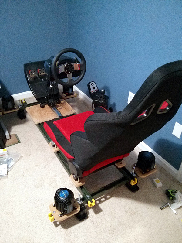

    +72 / 0 / -0
    Also if you're worried about the Open Wheeler frame being too flexible, it wouldn't be too hard to make a simple base frame for it out of a few aluminum extrusions or strut channels or something like that. That's basically what I did when I wanted to add some big transducers to mine.
