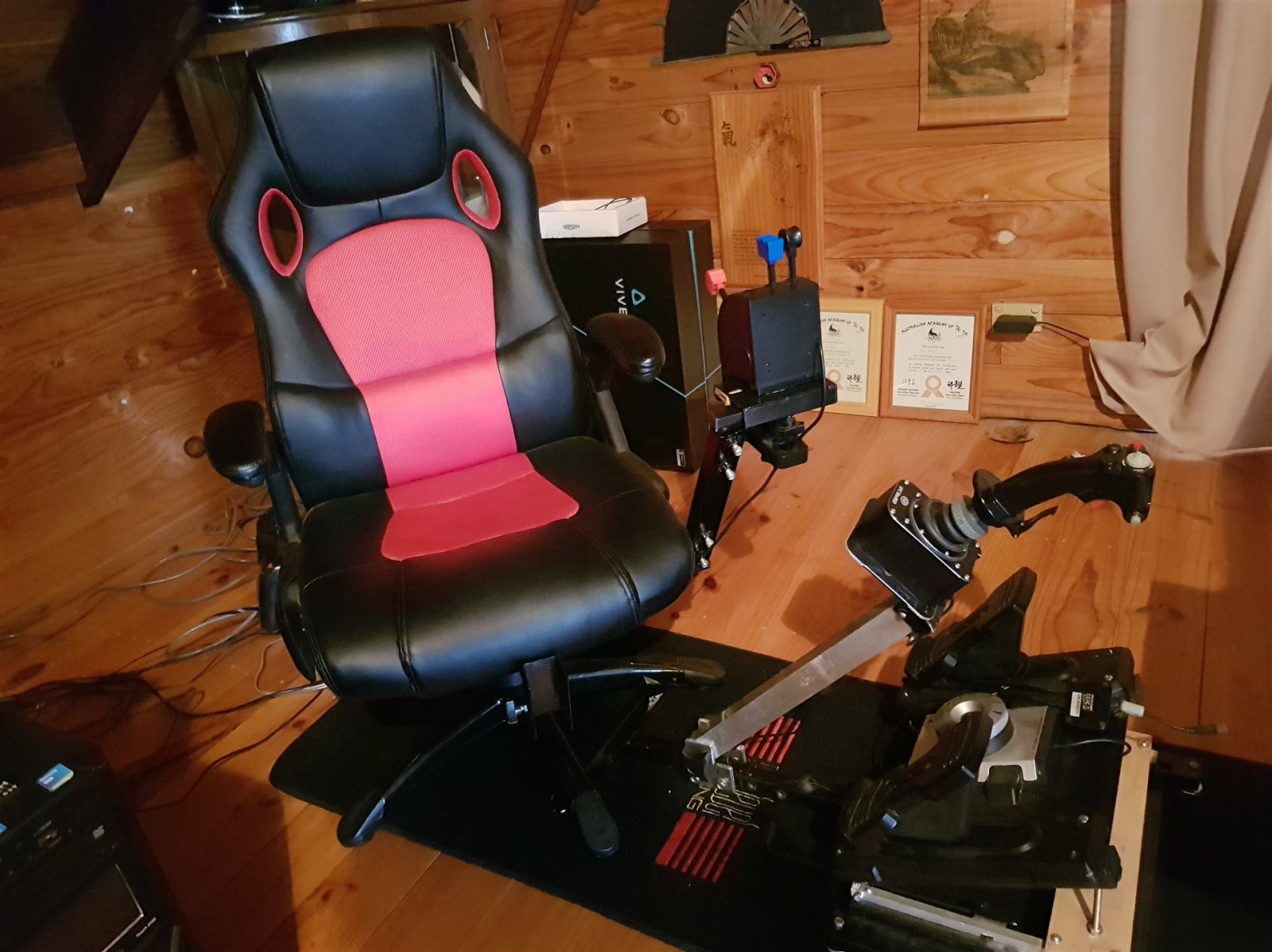

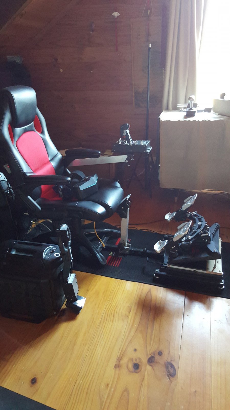

    My 88yo father, affectionately known as Teddles, is the oldest student pilot in Australia and loves War Thunder.
    I am deeply grateful to @Ville Pesonen for updating War Thunder to include Game Vibe support, and to @yobuddy who extended SimTools Game Vibe to include common flight sources such as flaps, landing gear and guns. Teddles got to test the pre-release War Thunder plugin at Christmas 2018, and was amazed at how effective haptics can be in VR, even without motion. The War Thunder plugin update inspired the new VR Haptics rig for Teddles.

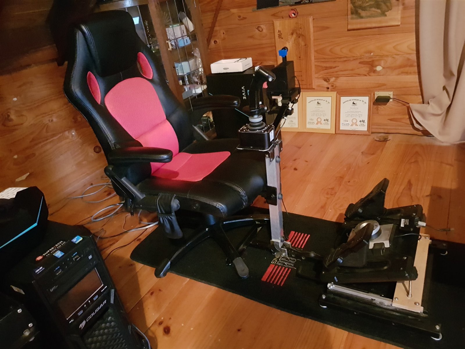

    The criteria for the rig were that it had to be simple to get into and operate.
    The basis of the rig is one of these pretty cheap race style office massage chairs, as they have 8 built in rumble motors: https://www.ebay.com.au/itm/Compute...005065&hash=item5d8dcd9e40:g:-CMAAOSw6eJdJapz
    An additional 2 rumble motors were added under the pedals.

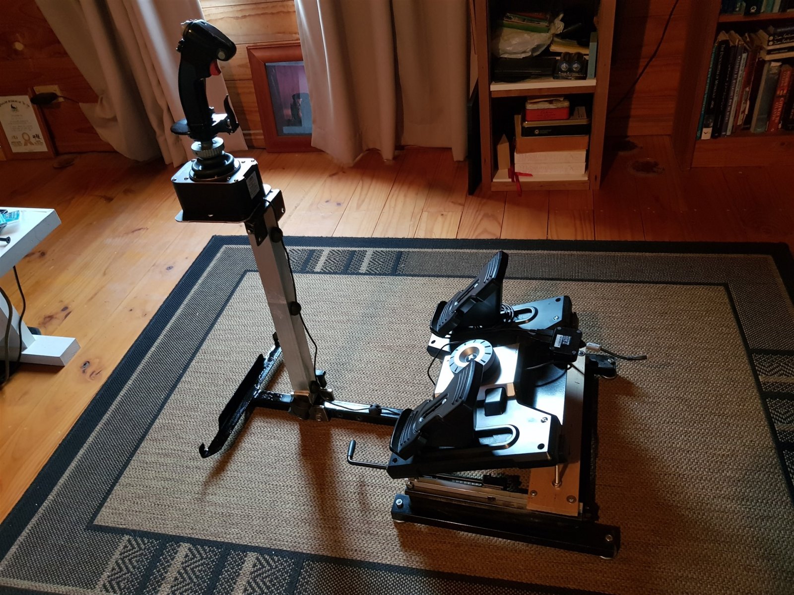

    The rig itself is pretty simple, the office chair legs simply slip into the pedal base and the slots and shape of the chair legs lock it in place.
    The joystick post pivots and locks to the chair with a simple thumbscrew. Once undone the chair can fully rotate, to make it really easy to get in and out of. I added another thumbscrew to the seat back mount, so it can also fold down, which makes this a simple rig to put away or transport.

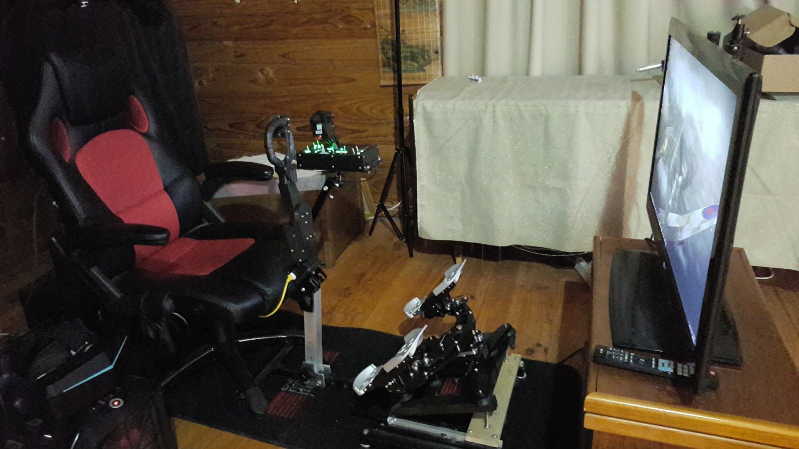

    The throttle stand is square tube and in addition to the throttle mount it also has a Aidata swivel mouse pad, again to make it easy for dad to use in VR: https://www.ebay.com.au/itm/Aidata-...ouse-Pad-De-/233288259879?hash=item3651105927
    The pedals use car seat rails to move fore and aft, with two bolts to adjust the tilt angle.
    The screen mounted wind simulation is handled by 2 X 120mm 7000RPM fans, they push out a surprising amount of air for a cheap system, enough to make Teddles complain about it being too cold to use them in the winter: https://www.ebay.com.au/itm/12V-400...tion-Fan-AU-/152944347332?hash=item239c3188c4
    The 3D printed fan shrouds can be found on Thingiverse: https://www.thingiverse.com/thing:2884277

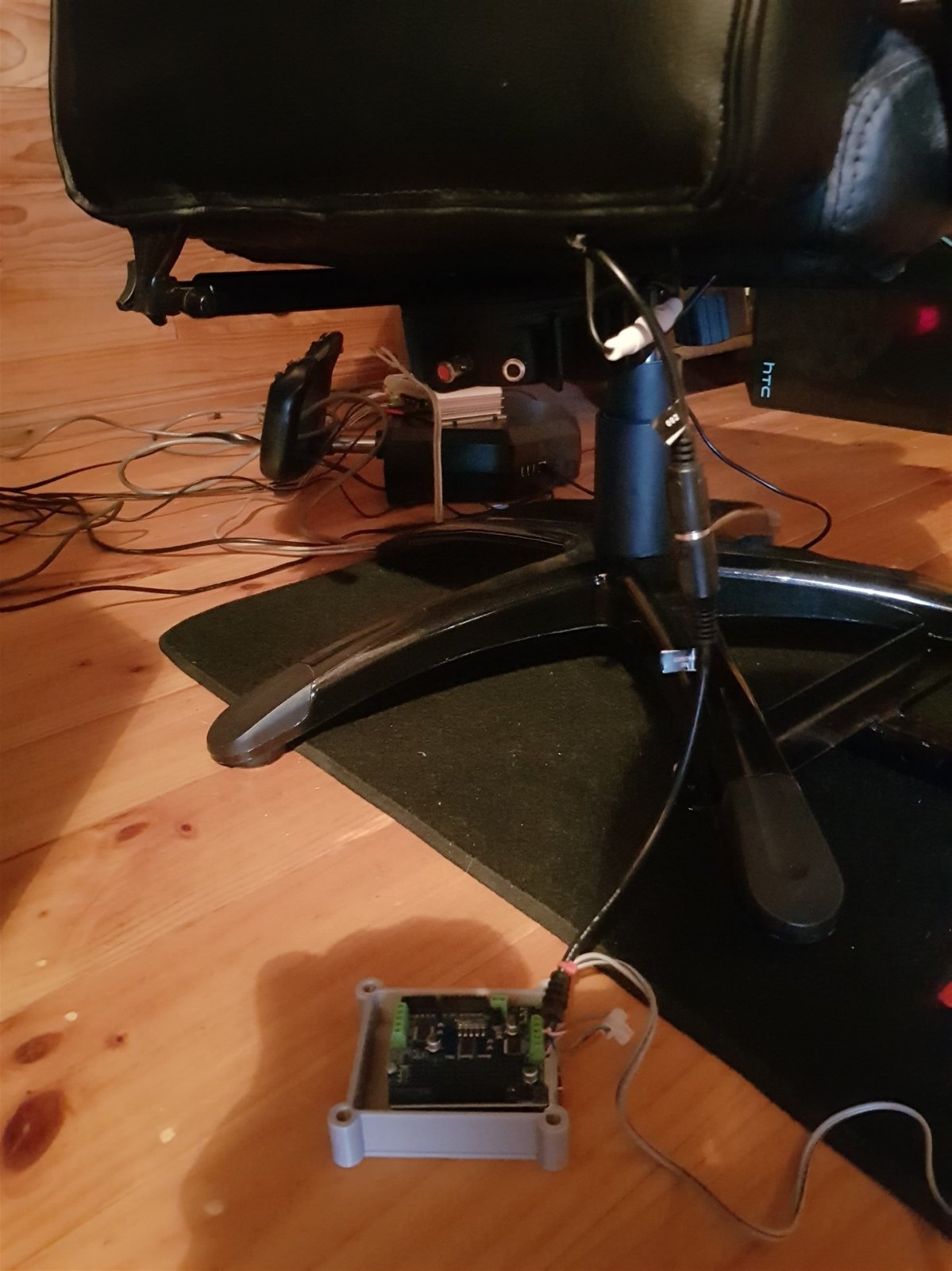

    The rumble motors and wind simulation are both handled by an equally cheap I2C TB6612 Stepper Motor PCA9685 Servo Driver Board Shield, which plugs directly into an Arduino: https://www.ebay.com.au/itm/I2C-TB6612-Stepper-Motor-PCA9685-Servo-Driver-Board-Sheld-V2-F-Arduino-Robot-PWM/262691494510?ssPageName=STRK:MEBIDX:IT&_trksid=p2057872.m2749.l2649
    An Aura 50W transducer I had laying around is also used with Game Vibe.
    I have all the parts to add a pneumatic G-Seat, but have not yet had the time to put that together. I will shortly be ordering Teddles a 2080ti, so he can take full advantage of the Pimax, which now has the Deluxe Audio Strap mod.

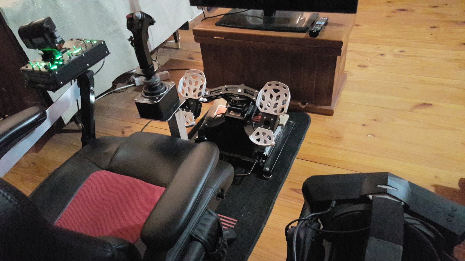

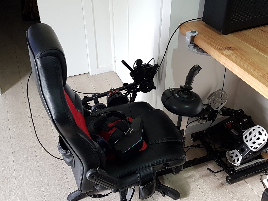

    Added the DIY Authentikit Spitfire joystick, the recommended springs are very light, especially for roll but I could not find anything better, so for now have used elastic cords to add a bit more resistance.
    I have made a modified mounting post and plate, so it is easy to adjust the angle and detach the Spitfire joystick for Teddles to get in and out.
    I also added a second 50w transducer to the back of the joystick mount post, for a total of 10 rumble motors and 2 x 50w transducers, now driven by a 100w Nobsound amplifier.
    21,597
    151,245Coins

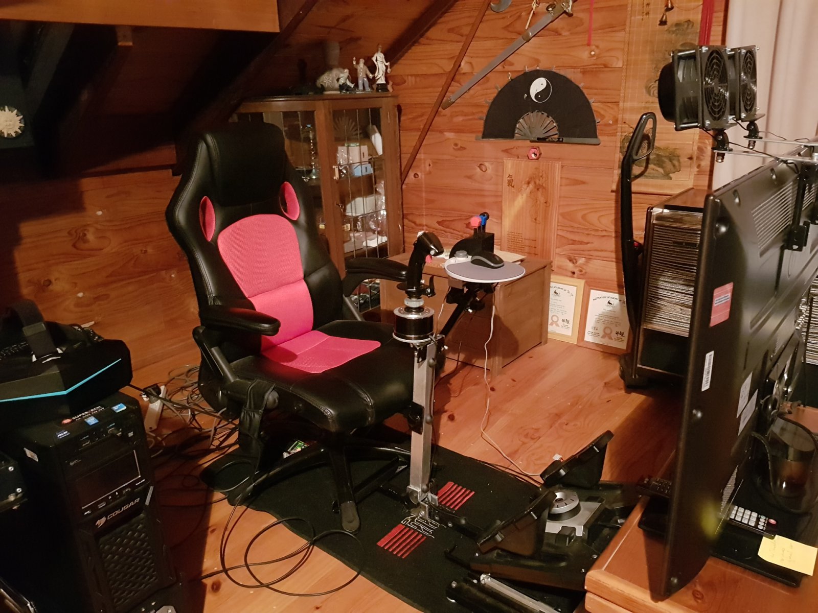

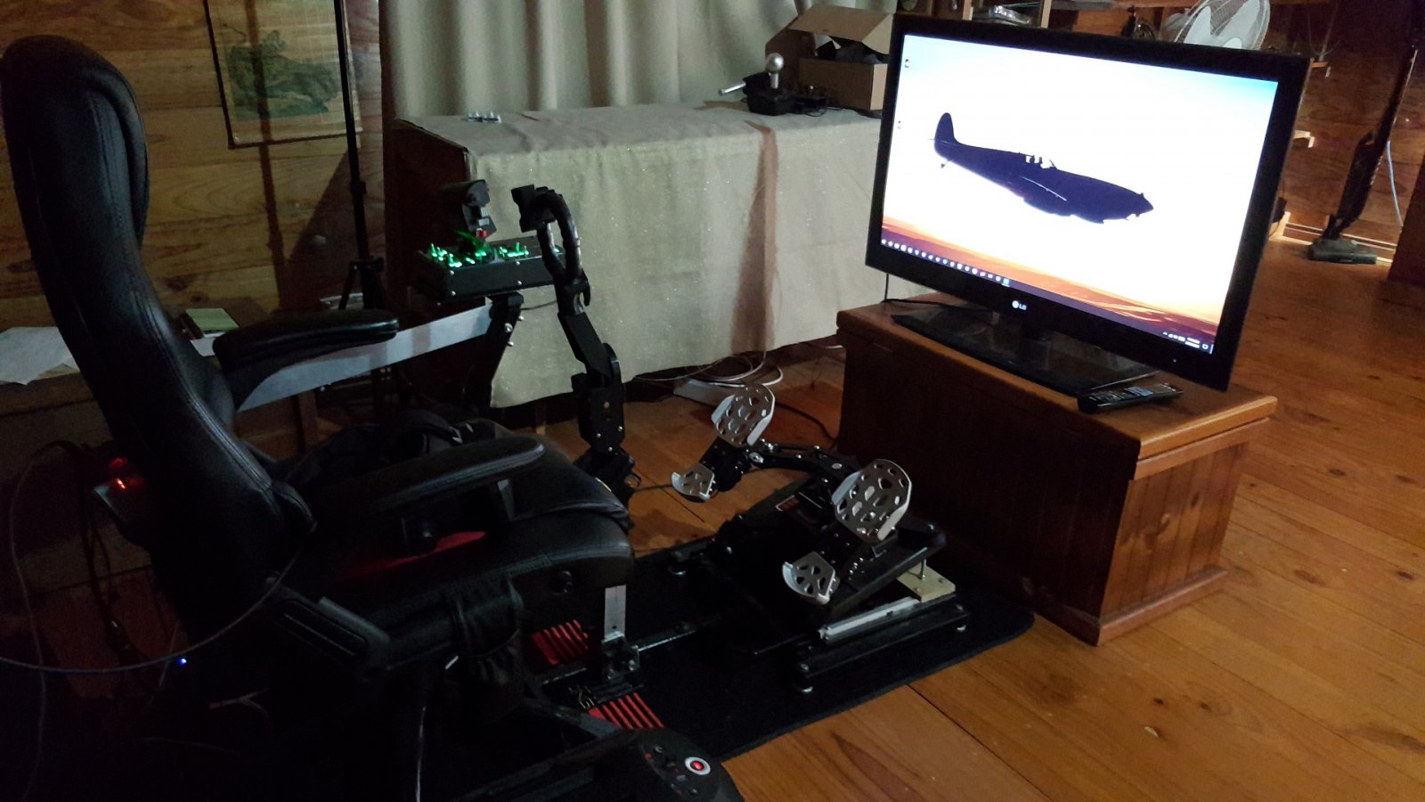

    Teddles health has been declining so I have moved his rig from upstairs to my office, so it is easier to access.
    A new throttle and trim wheels mount was adapted to the chair itself, a mod of the original Authentikit idea of using monitor mounts for adjustable and swappable controls, also added a bunch of buttons to the trim wheel housing, for easy use in VR, those are hooked up to the Bodnar board that serves the rest of the Authentikit controls.
    I am currently messing around with a Sidewinder 2, as Teddles likes the FFB. Eventually we will mod it for increased FFB, 3D print a new less bulking housing for it, and adapt the Authentikit Spitfire joystick to the Sidewinder base, as lack of ' flight feel' was Teddles only gripe with their excellent DIY 3D printed Spitfire controls.
