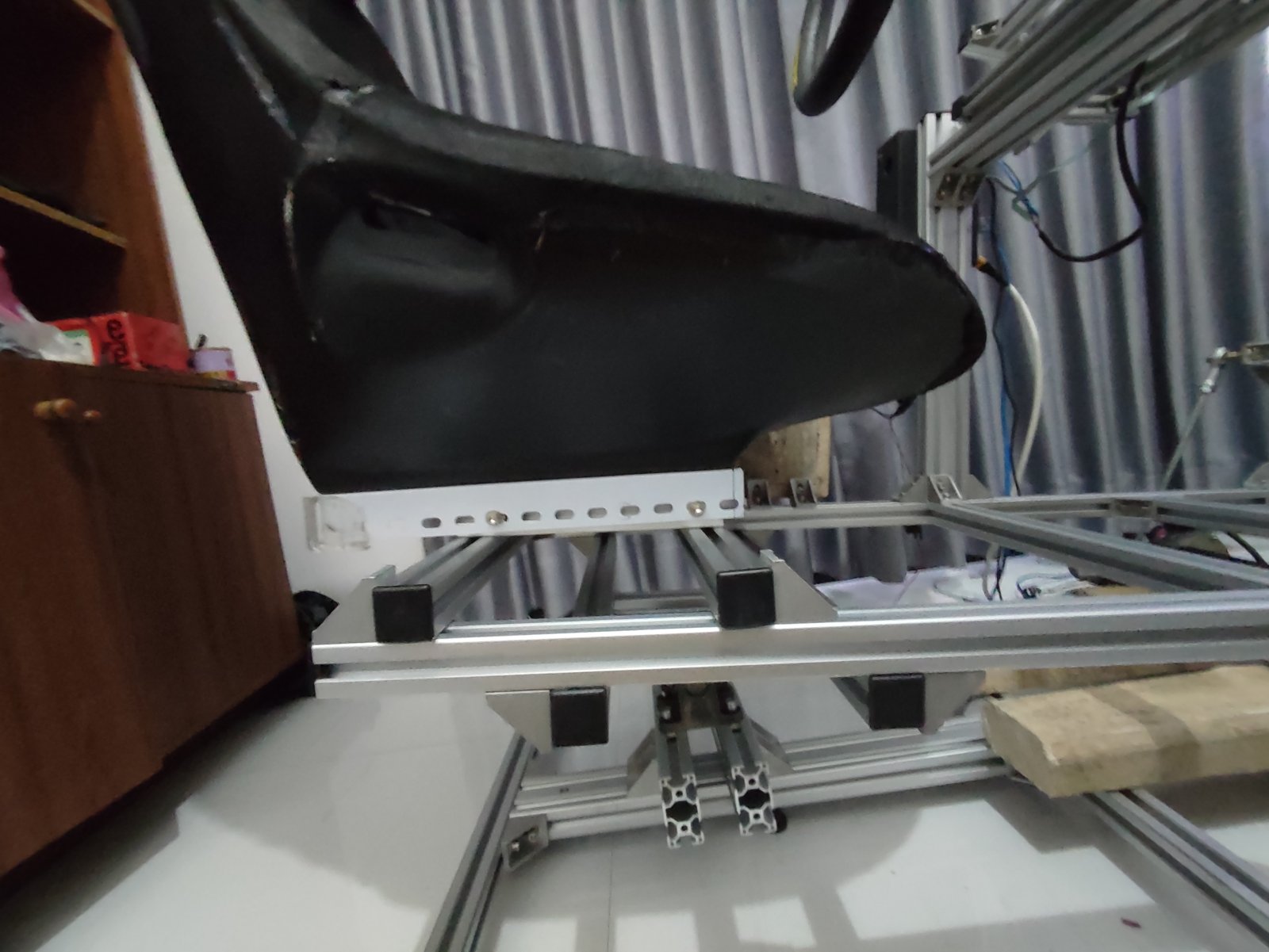

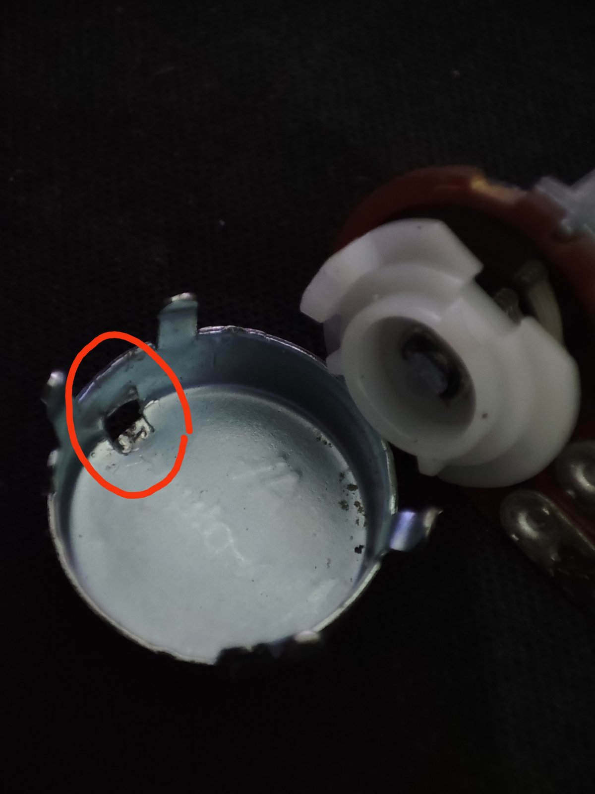

    Do some little revisions. I set the seat move a little bit more to back and I can see the different before and after, the motor less hot than before.. Maybe on previous setup the balance is off.
    And I got my potensio broken, and I do some little mod to the potensiometer, to make it allow rotate 360°. I cut the stopper, and it works well. IMG_20220110_083614.jpg

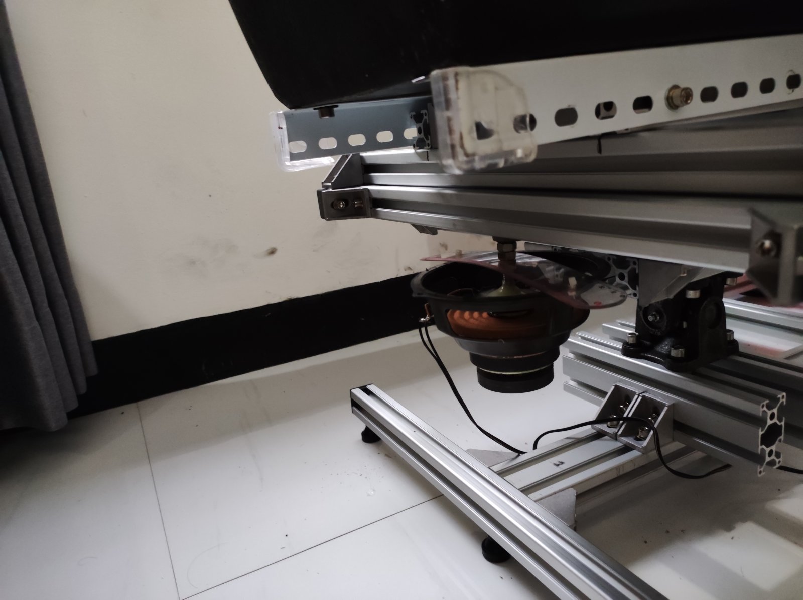

    Sorry I came and again ask a question.
    I just manage to equip the rig with diy bass shaker. And I'm using simhub. But the effect doesn't work. And when I fix in simhub, the simtools instead that didn't works.
    I have looking for the answer using search feature but cannot get a clear answer.
    Hope someone can help me.

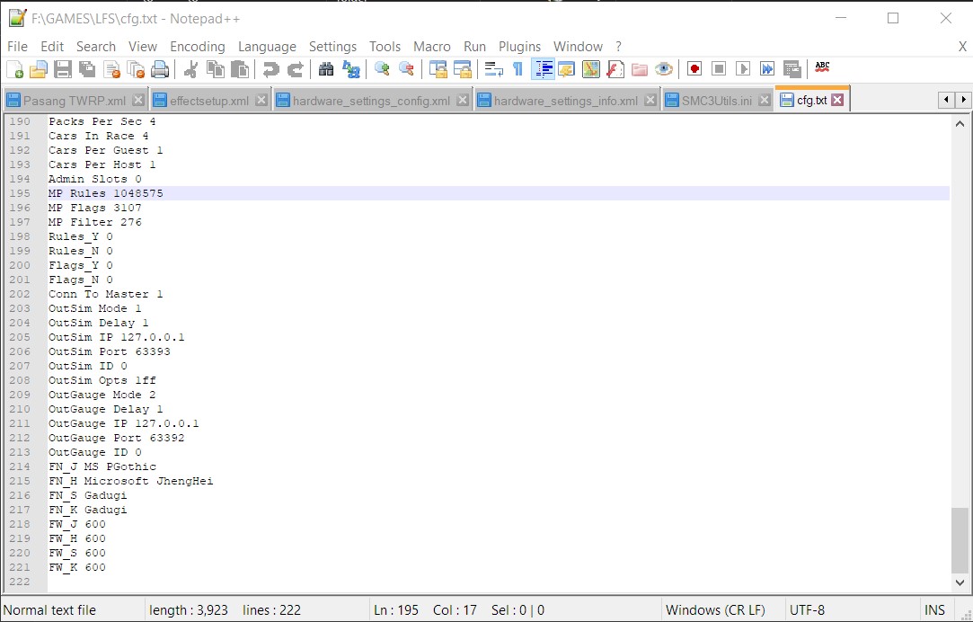

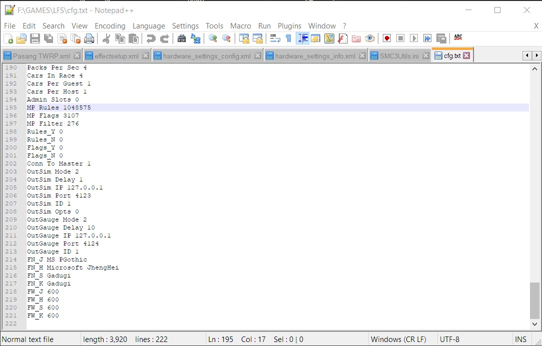

    so I try to configure how simhub and simtools to work together base on the FAQ. but still I cannot get it work on LFS.
    here some screen shot from the config file.
    when I set the config in simhub the config on FLS game change to this.
    and the simhub works, but not simtools. so I re-patch the simtools. and the config file in game change to this.
    and it works one but not another.

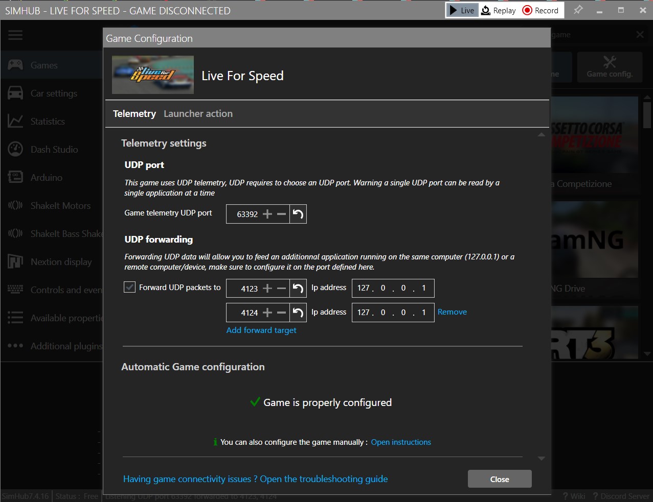

    so I try this setting in simhub.
    but still I cannot get it works.
    so do you have any solution @noorbeast , or anyone have the same problem and probably has solve the problem?

    I don't use SimHub, other than on the tactile flight rig I built for my father, as SimTools provides Game Vibe for transducer support: https://www.xsimulator.net/community/marketplace/simtools-v2-game-vibe.201/
    That said the core issue is a port conflict. So will SimHub allow 4124 for itself and forward to 4123 for SimTools, as that is what the latter expects.

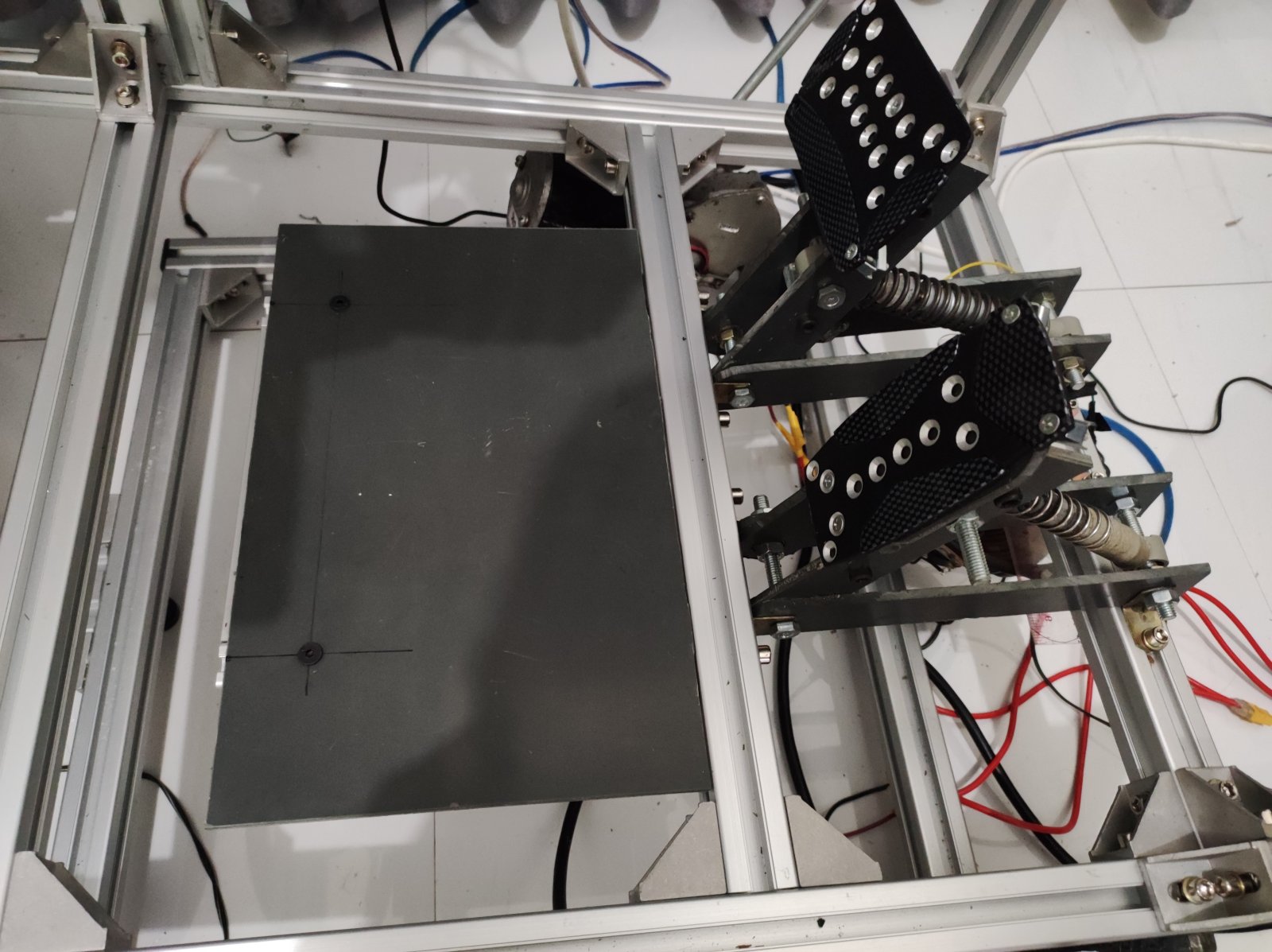

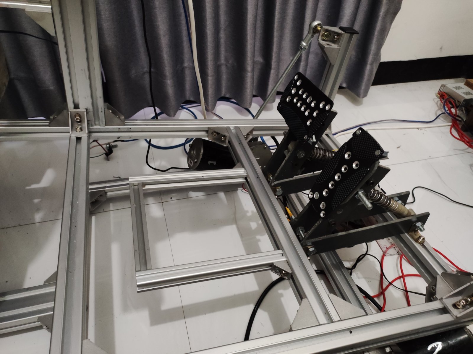

    Really excited to share some update. With this the balance is better and the weight is significantly decreased.
    I make a revision on the pedal base using pvc.
    And it's do a great job. In the future I'll upgrade it to metal material. And probably using a load cell.

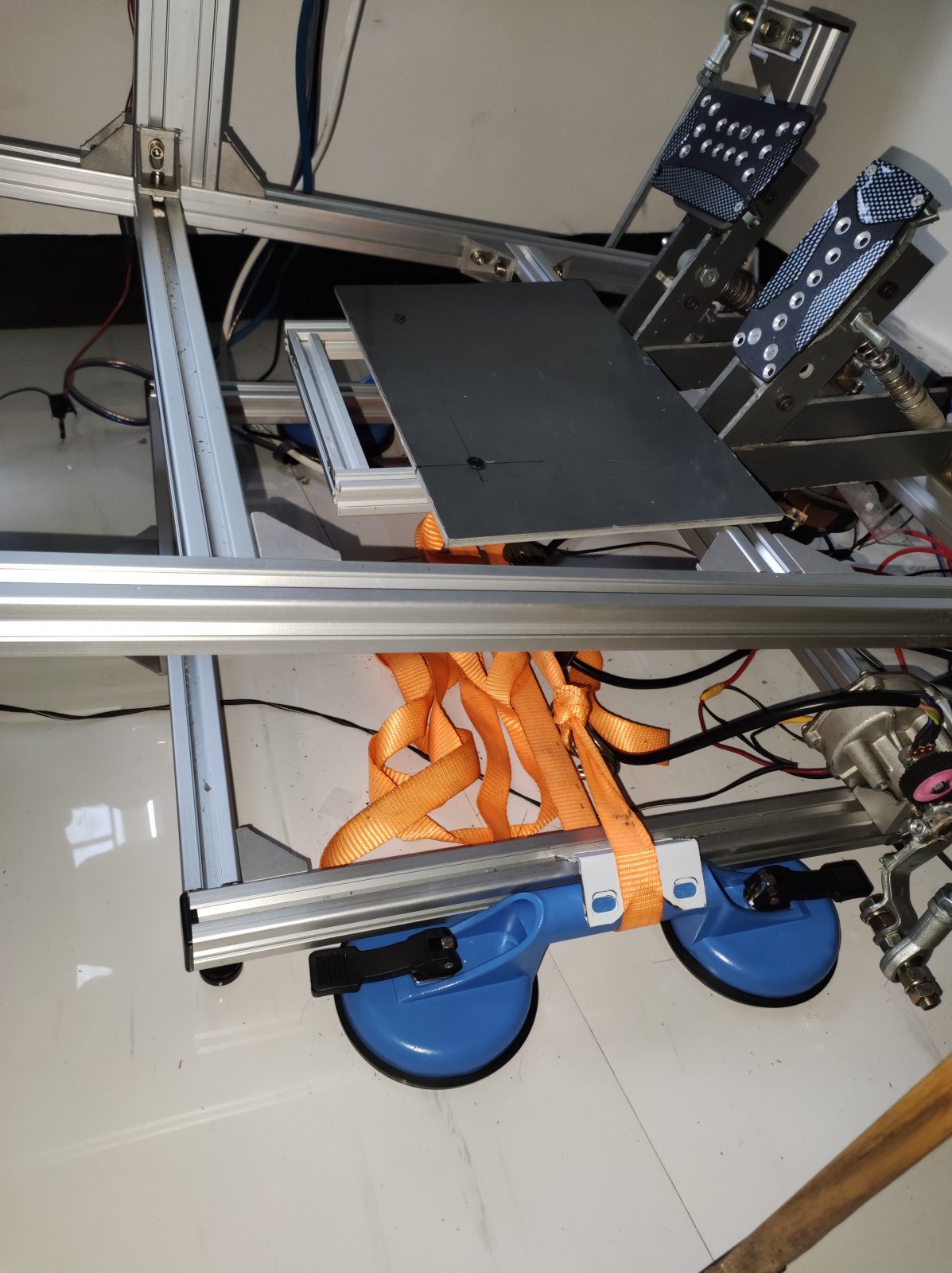

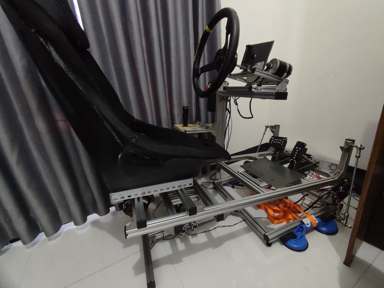

    And I wanna share another update with my motion rig.
    Before I use some dumbbells 20kg each, to make my rig stay on the floor.
    And now I use a heavy duty cup suction and a ratchet strap to make it stick better.
    Here's some pic of it.
    So anyone have a same problem and how you guys make a better base that stick to the floor even the force from the engine is hard enough to throw you to the ground?
