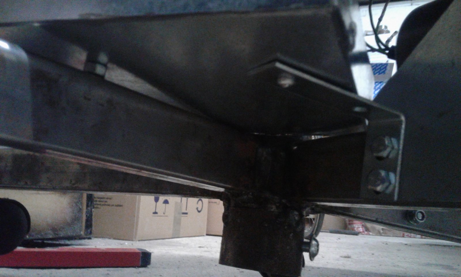

    fixing the footplate

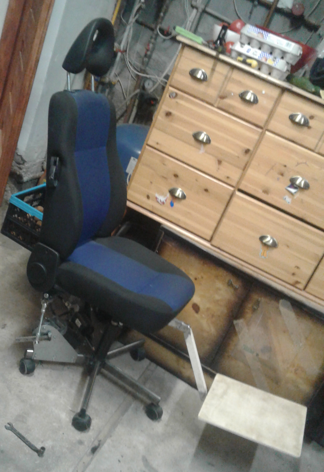

    Footplate

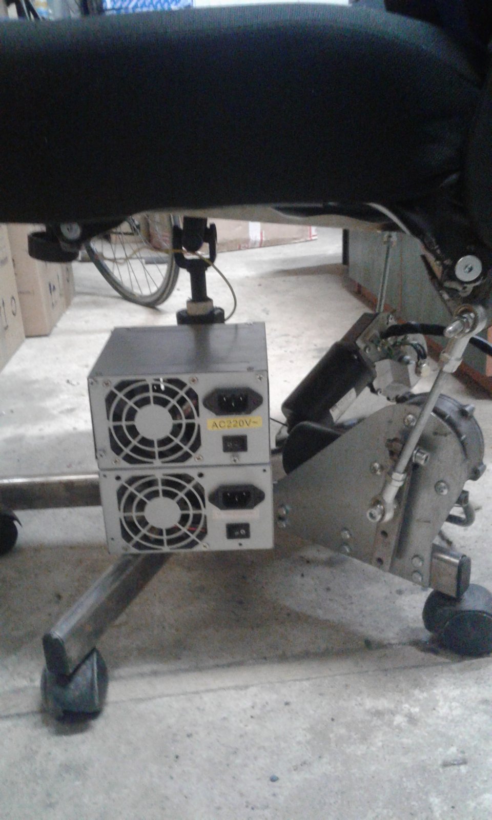

    power supply 2 x350 W
    2 x 12v -24V
  5. tadeusz
    tadeusz New Member
    Nov 4, 2025
    34Coins
    Importent :
    In one of the power supplies,
    the ground should be separated from the housing
    if you want to connect ATX power supplies in series

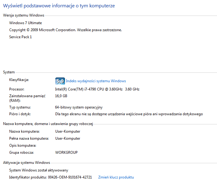

    Hello
    I got a free Simtools 2.0 key and I cannot register for a some reason.
    I can register - only version 2.31 to which of course I do not have a key :-(
    Is I doing the right?
    1.installes Sim Toools 2.0
    2 unpacks Registration_Update.zip to the desktop
    3. I run SimTools_Registration from the desktop
    4. enter the key from 2.0
    5. Unfortunately, I have a message
    Please help :sos
  20. tadeusz
    tadeusz New Member
    Nov 4, 2025
    34Coins
    It's not good :blush:blush:blush
    I tried to register sim Tools 2.0
    for 3 different PC's
    1) WIN 7
    2) WIN 7
    3) WIN 10
    I always have information
