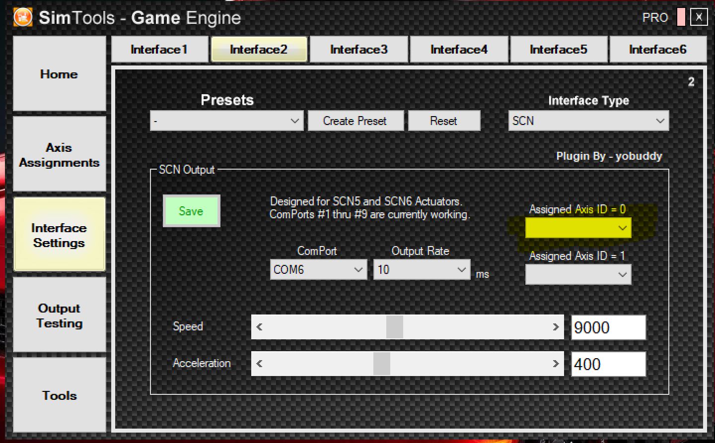

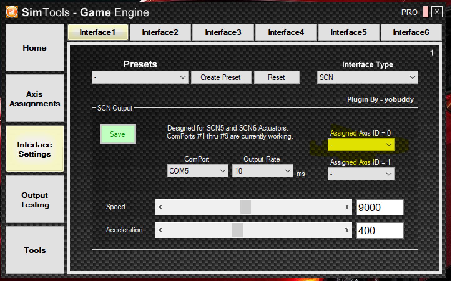

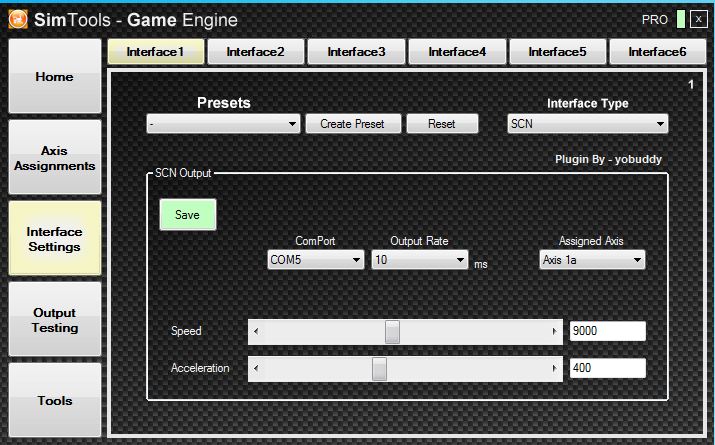

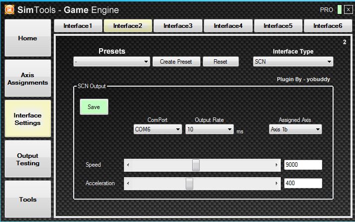

  11. Viper Mad Max
    Viper Mad Max New Member Gold Contributor
    Jan 29, 2017
    Indiana, USA
    233Coins
    SCN5
    2.3.1 Interface 1.JPG 2.3.1 Interface 2.JPG 2.5.1 Interface 1.JPG 2.5.1 Interface 2.JPG
    The 1st 2 pics show how it was when using 2.3.1. The 2nd set of pics are how it came up after installing 2.5.1. Notice that the assigned axis is blank, I have it highlighted. When I click in that field it will allow me to select axis 1a and axis 1b respectfully. After that, I click save. When I close the game engine and then reopen it those 2 fields are blank again. Normally when I first start the game engine the actuators will move to their limits and center. Now they do not move at all.
    I'm thinking that those 2 fields not being able to be saved may be the issue. If not please let me know and I will load more screenshots.
    Thanks for looking into this.
    Brent

  12. noorbeast
    21,592
    151,215Coins
    @yobuddy is that expected behavior?
  13. yobuddy
    5,408
    50,690Coins
    +5,166 / 19 / -0
    This is because the interface now supports 2 axis per interface. (different interface plugin)
    So the saved file is not in the correct format to save the new settings.
    To fix this, simply un-select the "SCN" plugin from the interface Type drop down. (Simply select the "-" option.)
    It will ask you if you want to delete the old settings, say yes.
    Then simply re-select the "SCN" plugin Interface type and re-setup your interfaces.
    Let me know how it goes.

  14. Viper Mad Max
    Jan 29, 2017
    Indiana, USA
    233Coins
    SCN5
    yobuddy,
    That did the trick!
    Thanks so much!
    Brent
