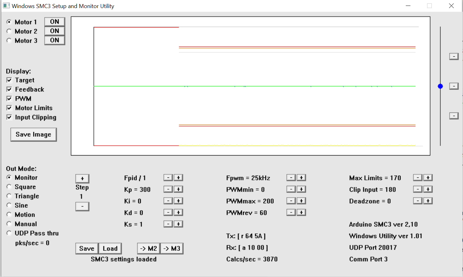

    Please run the Sine test and re-post the SMC3 results.
    How did you arrive at the settings you have? I ask because I would have anticipated Kp to be higher and PWMmax and PWMrev to perhaps be a bit lower.

    OK, will run the sinewave test and repost. It's possible the shudder is a reflection of sliding the sliders with the mouse, though it didn't feel like it.
    I arrived at the settings I have by running the motors without load (because it's impossible to run just one motor under load in 6DOF). My reasoning for the PWMmax and PWMrev maxed out is that I think I need all the power I can get from my motors. 255 is basically max power, so why not use it when I can? Same for the reverse: why not use max power for stopping when needed? Is my reasoning flawed? The question is if I can find settings that work well with it. Higher Kp didn't work well without load, but maybe it's different under load, so I can try increasing it.
    Thanks, I see that Kp is much higher than mine. I'll try yours.

    The benefit of the SMC3 interface is to allow you to properly tune settings to suit your particular hardware and rig. Max settings are not the way to go. While written with an other controller in mind here is a gentle introduction to PID tuning: https://www.xsimulator.net/community/faq/a-laymans-analogy-guide-to-pids-pid-tuning.219/
    Unfortunately the picture of the settings does not post the Sine test properly, please directly upload the example settings: https://www.xsimulator.net/community/faq/upload-pictures-or-files.81/

    Strange, I see the image in my previous post perfectly well. Here it is, attached again.
    Tuning is difficult with 6DOF, because it's 3 separate boards and 6 motors that I can't isolate under load, so I can't test motors under load individually, as they are all linked and have to move together. So I can't use the normal procedure of commanding motor from SMC3 Utils software and adjusting the parameters based on the graph.

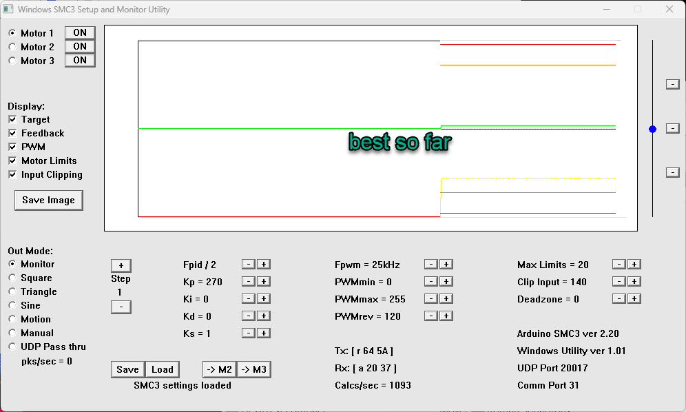

    That picture shows the settings but is not running the sine test in Out Mode.
  13. Ronan Design
    Jun 4, 2021
    266
    Toronto, Canada
    1,696Coins
    +138 / 1 / -0
    Oh, I thought you meant sinewave test in FlyPT. How can I run the sine test in SMC3 Tools under load when it can only control one motor at a time on a single board? I can't run all of them together, as the app doesn't let to rune more than 1 instance at a time, and just running it on a single motor would just crash the rig.
    21,641
    151,504Coins
    +11,041 / 56 / -2
    You could disconnect the top frame and run them unloaded, following the SMC3 setup instructions, taking note of the PWMmax value when the rig starts to move, and once settings are tweaked run the Sine test: https://www.xsimulator.net/communit...3dof-motor-driver-and-windows-utilities.4957/
    Other than that it would be an educated guess. Mine would be reduce the lever CTC by one hole, initially set Kp to 400, Ki and Kd to 0, Ks to 1, PWMmin, PWMmax, and PWMrev as per your current settings.

    I played with all kinds of settings and some are better than others, but while it got better on medium movements and fast movements are very responsive, very slow movements still have the small even shudder. It's small, almost a vibration. This is common with all settings and if it changes, only a little.
    I'm starting to suspect that what I'm feeling is what's called "cogging", i.e. the interaction of the gear in gearboxes. I didn't feel it at all with 2DOF PGSaw motors, but they had a worm gear gearbox, different from the Yalu motors. Also, my 2DOF is very soft, bendy and spongy, so it is not very precise, so maybe this effect was dampened. My 6DOF wooden frame and plywood top platform is flexing a bit, which actually may be an advantage that softens the rough motion, but still, the movements feel way more precise and really fast compared to the 2DOF. I had to use LPF 200 damper filter on the whole rig just so as not to feel scared to break the rig and myself, and it still feels very fast and powerful. I guess that 6 gearboxes moving together would amplify gear vibrations or do all kinds of phase-related effects amplifying and cancelling each other's cogging. That also may play a role.
    I guess I'm too picky. I'll have to try it in an actual flight simulator and racing games. I suspect it won't be very noticeable under constant movement. Small slow bank turns could be a problem, but then I'll have engine vibration via transducers masking it somewhat, I guess.
    I'm out of ideas what else to try to decrease it. Reducing lever CTC could help, though it will reduce the movement range. Maybe I will see the practical application with this CTC and if I keep noticing it - will try to reduce CTC. It could reduce cogging amplitude I suppose.
    I've seen a few videos showing shudder/vibration problems with an expensive DOFReality rigs, so if they have this problem, I'm in good company. Though if I keep noticing it in practical application it will be annoying. We'll see.
    Here's the settings that seem to be working the best so far:
