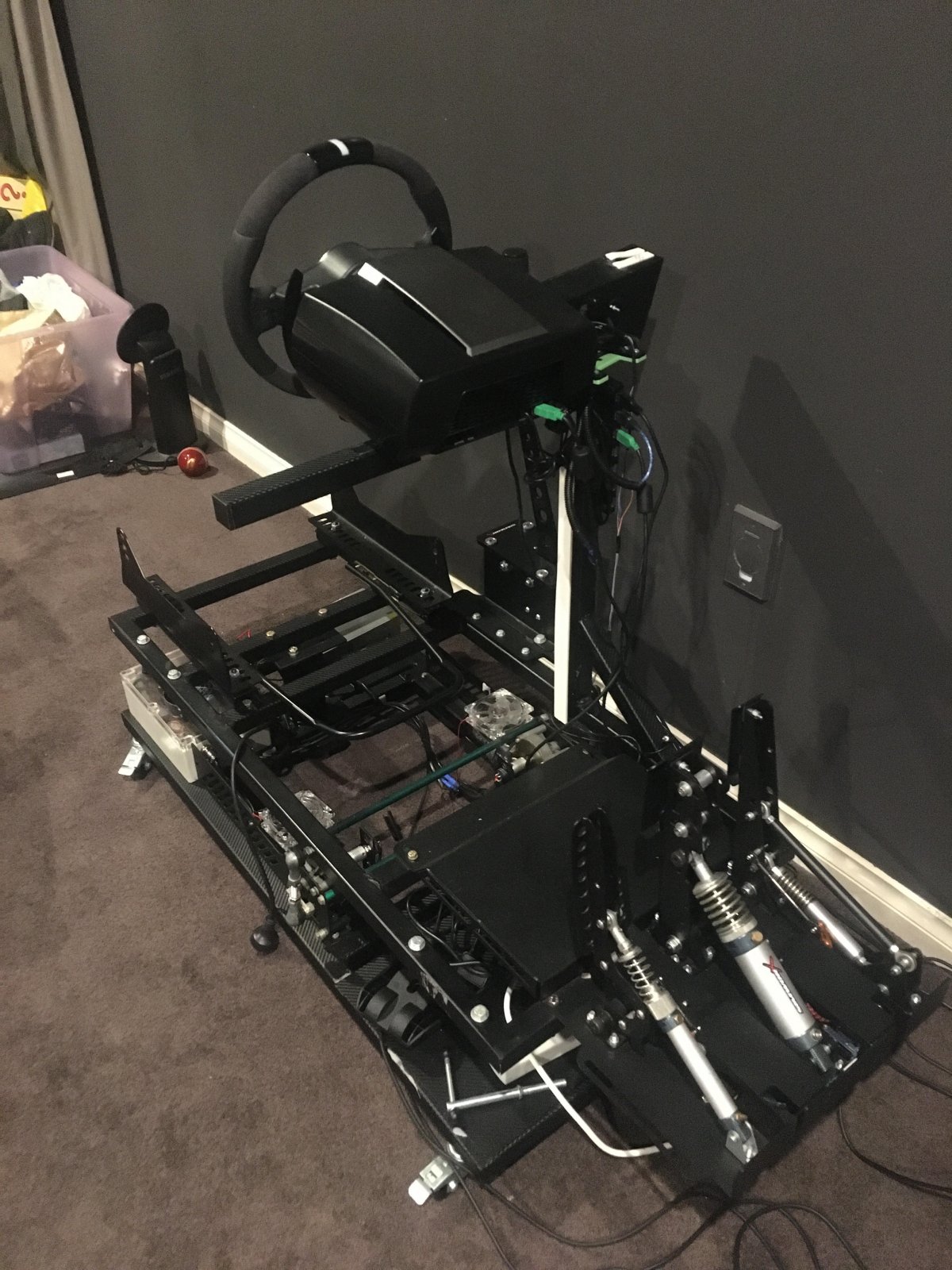

    Hi All
    So long story short my friend bought this off a guy that built this custom sim. He used it for a while then for at least a year or longer it sat at his house unconnected so I've bought it off him. Very nice pedals and shifter, good wheel and handbrake etc.
    He's forgotten how it all works, but knew it used a SimTools program. So I guess my dilemma is a bit different than most people. It should be all programmed, it should be all working, I just don't know where to start haha!
    I've done some research and this is what I've observed:
    - Uni-join connecting base to motion base
    - Motors each side
    - Has 2 boxes, one of which is a power box with a cord going to mains supply. Second box I'm going to call a control box which has power cables coming into it and random cables going out and in from the motors.
    - Control box contains a Duinotech UNO circuit board which means it runs the Arduino?
    - Control box has a usb connection coming out which I assume connects to a PC.
    Just bought the professional SimTools license, will buy a plugin for Assetto Corsa.
    So I guess the big question is how do i get this going!
    Thank You

    Thanks for sharing your new purchase.
    To get started can you please add a picture of the control box, so we can see what hardware is being used.
    Did the seller say it had previously been configured and used with SimTools?

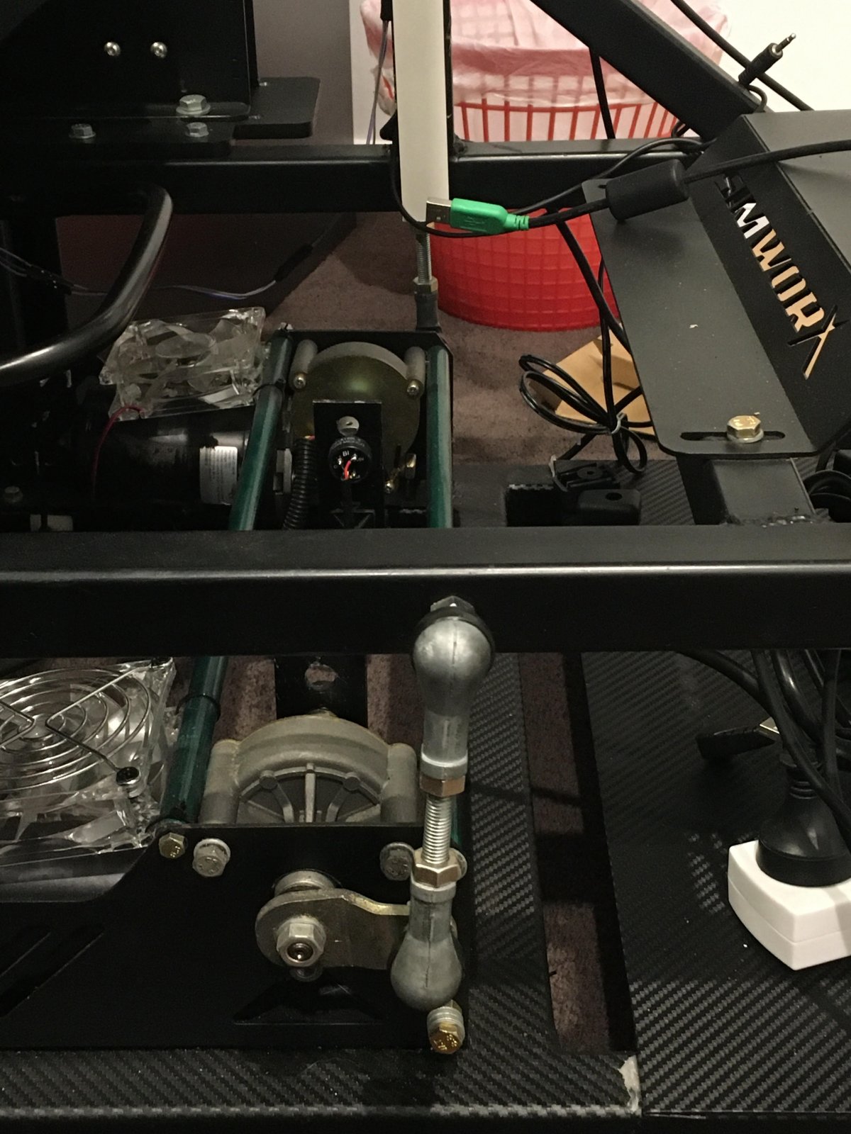

    I have been reading through the various FAQs and I've learnt the following things about the rig since I last posted:
    - Appears to be a Monster Moto (MM) board being used in the control box
    - Pots appear to be connected correctly at a glance
    - The motors are 12V 70W Wormdrive motors - model ZD1631 with the following stats:

    Pictures as requested:

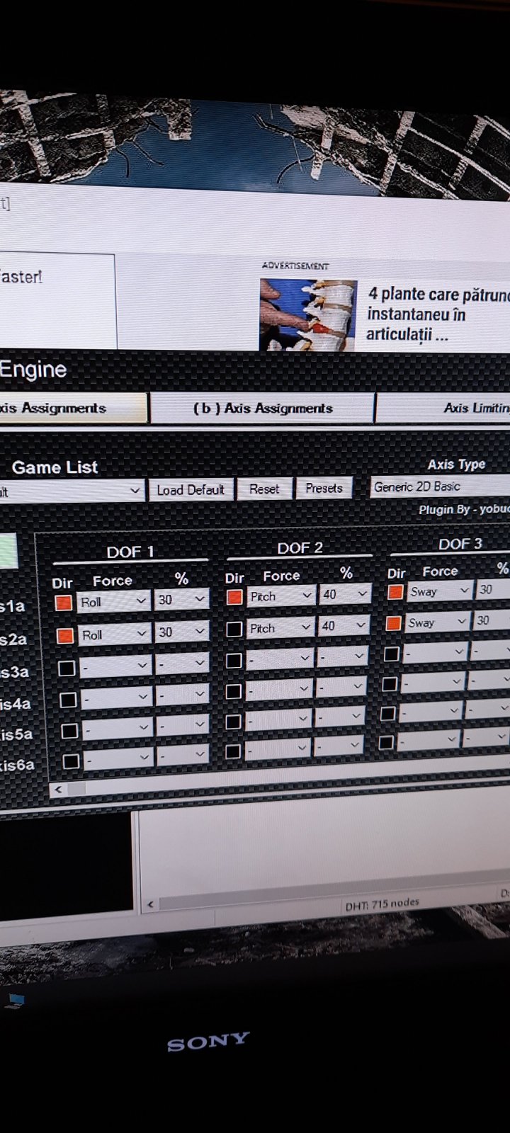

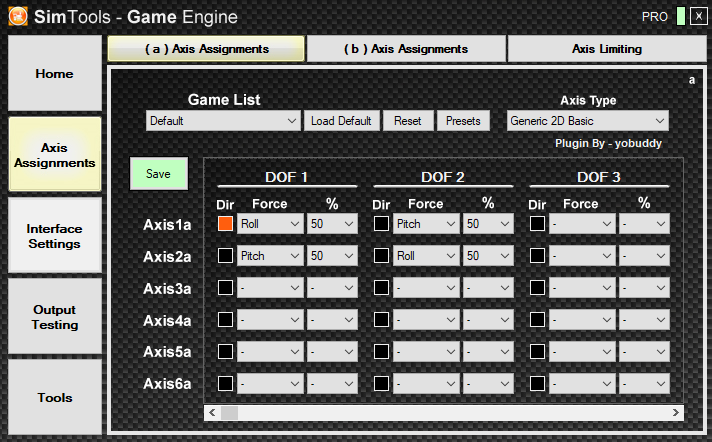

    You were correct regarding the language. I entered the SMC3 settings and was able to get the motion working by using the output testing section.
    I have set the axis assignments based on the FAQ on what I think is correct for this design however when i did reverse a direction it didn't change how the sim moved?
    Other things I've noted on the sim:
    - vertical connectors from motor arm to motion base are not 100% vertical. I'll have to measure distances etc but perhaps the sim is not 100% identical for mounting points from left to right. (see attached picture)
    - When going full back pitch (the front of the sim rising) the left side rises slightly slower than the right side. (this might be related to the angle of the mountings?)
    - There is a DOT2SR K-WOON VWS-100 4 ohm vibrating subwoofer under the seat which has a positive and negative wire going to nowhere. Wires currently tucked away.
    What would be my next step? Should i be tweaking settings in the game I'm going to play (most likely assetto corsa first) or should i be doing it in the LFS testing environment?
  8. ivan jack
    ivan jack Member
    Mar 10, 2019
    53
    412Coins
    +29 / 1 / -0
    Hello ! Sorry for jumping in, on axis assignments you should have something like this because you will have conflict I think. On first Column you have both Roll and Pitch and that is no good. One column represents all motors , so column 1 roll, roll , column 2 pitch,pitch .

    In Axis Assignments keep each axis in the same DOF column, so DOF1 would have roll 1 and 2 and so on.
    Set up for roll, pitch, sway, surge and heave.
    Next is to make sure everything moves correctly for each axis, which is controlled by the DIR box being checked orange or not, this is what SimTools expects: https://www.xsimulator.net/community/faq/which-way-to-set-simtool-axis-movements.230/
    See my initial post about the SimTools manual and in particular the Motion Profile tuning tips, so initially do each axis at time, I would stick with LFS, once that is done its settings can be copied and then tweaked for AC.
    The transducer will need an amp and can be driven using a low pass filter on game sound, or can be managed and tuned with SimTool GameVibe.
