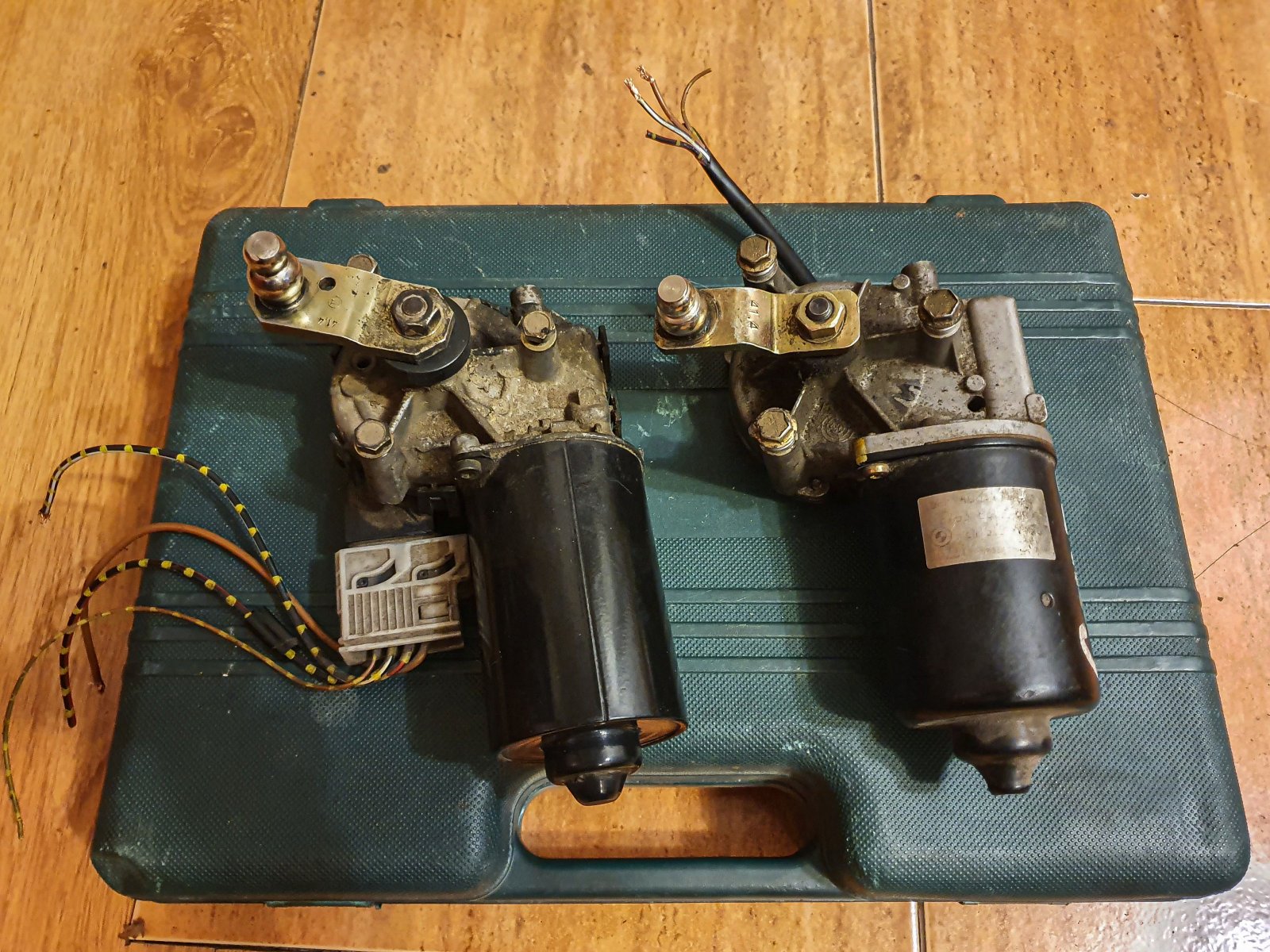

    Hi All,
    I googled motion rigs and got here,
    It's my first try with DIY motion addition (I did tactile shaker-car amp myself) and am inspired to do more to my simrig so please, be gentle, but firm on recomendations. If my learning curve will improve I will aim to buitld sfx-100, but for now, wiper motors.
    Looked at this article and this what I managed to supply/order(30.01.20):
    It all starts with junk yard wiper motors one from bwm e36 and another one bmw e46, I hope sliding is in their blood.

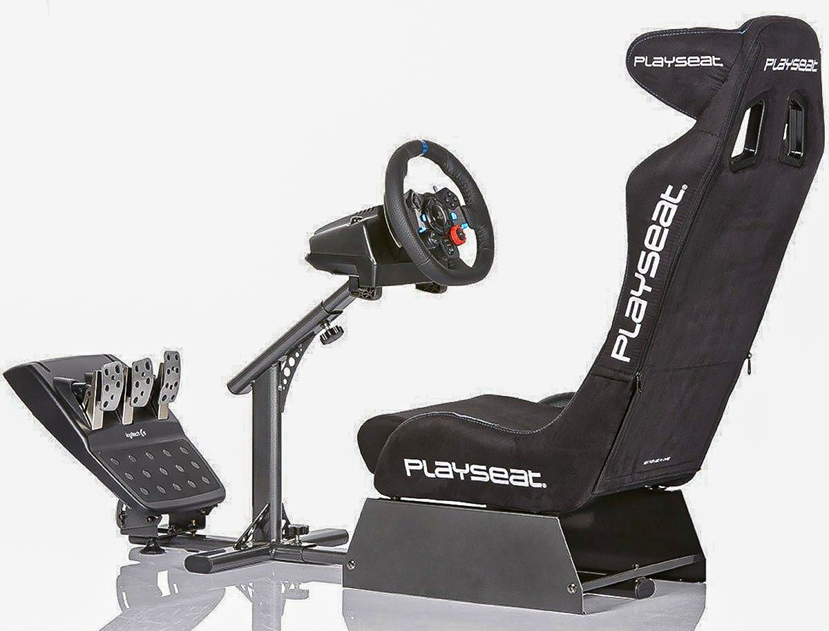

    1x Playseat evolution
    2x Wiper motors (for now I need one to work)
    1x Arduino Uno clone (ordered one spare)
    1x Monster Moto Shield VNH2SP30 stepper motor driver (ordered one spare)

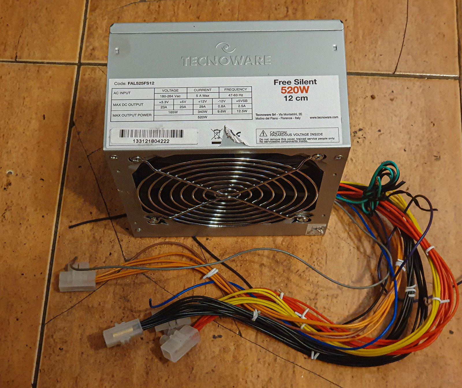

    1x PC power supply - with on 29A 12v rail
    1x Wires to pin everything
    5x 10k omhs Potentiometers
    If my understanding is correct at this point I have to manage hardware stage - (mounts) and software - and no I havent done any of that before, but my luck is with you guys, right ;)

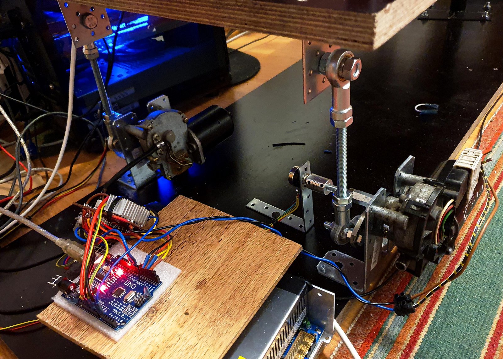

    232Coins
    +24 / 0 / -0
    Part 2 - 19.03.2020 - covid-19 :confused::(:eek: (slowed down everything )
    1 dof traction loss seemed more difficult than 2dof hence change of direction
    Before getting parts I managed to fail building platform twice - and thats even without motors...

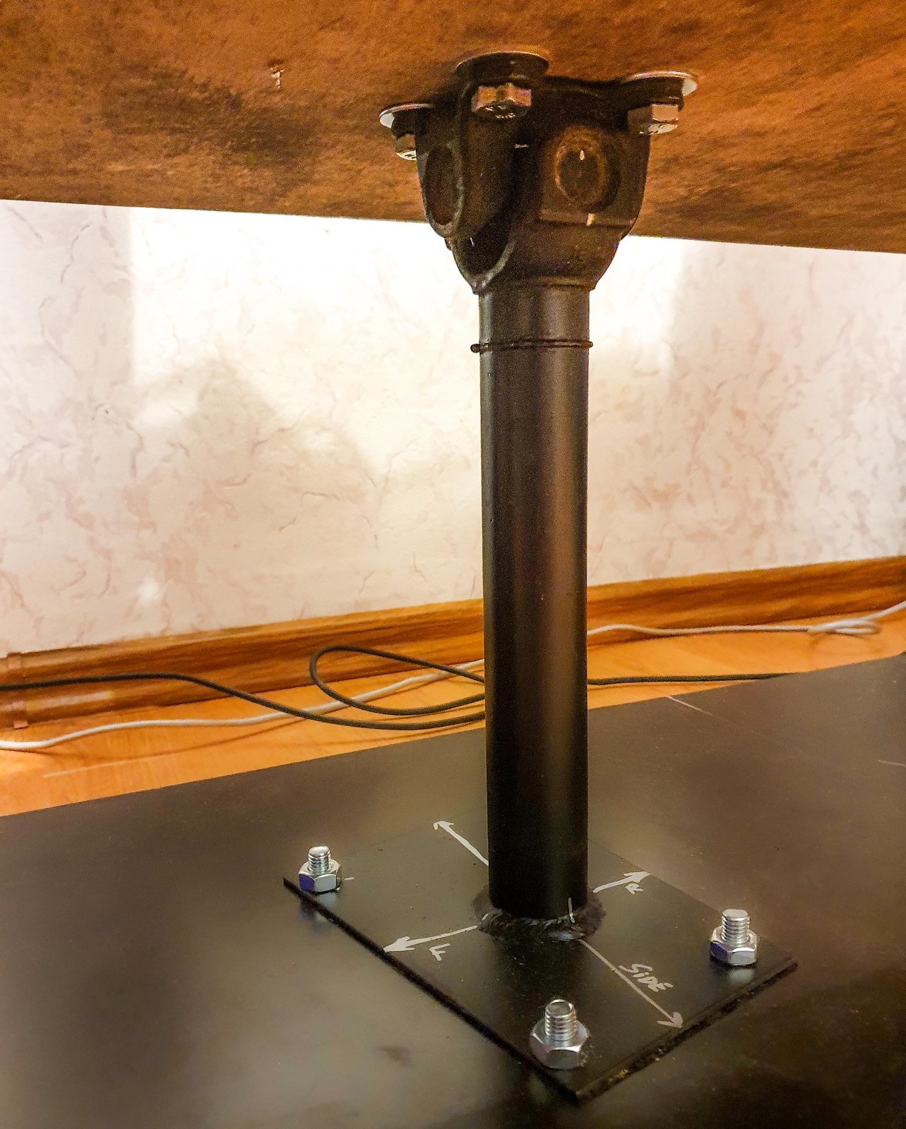

    Now I got - e46 driveshaft, Arduino Uno, MotoMonster, pots, pot couplers, rod end joint bearing, and lots of wires I began process once more.

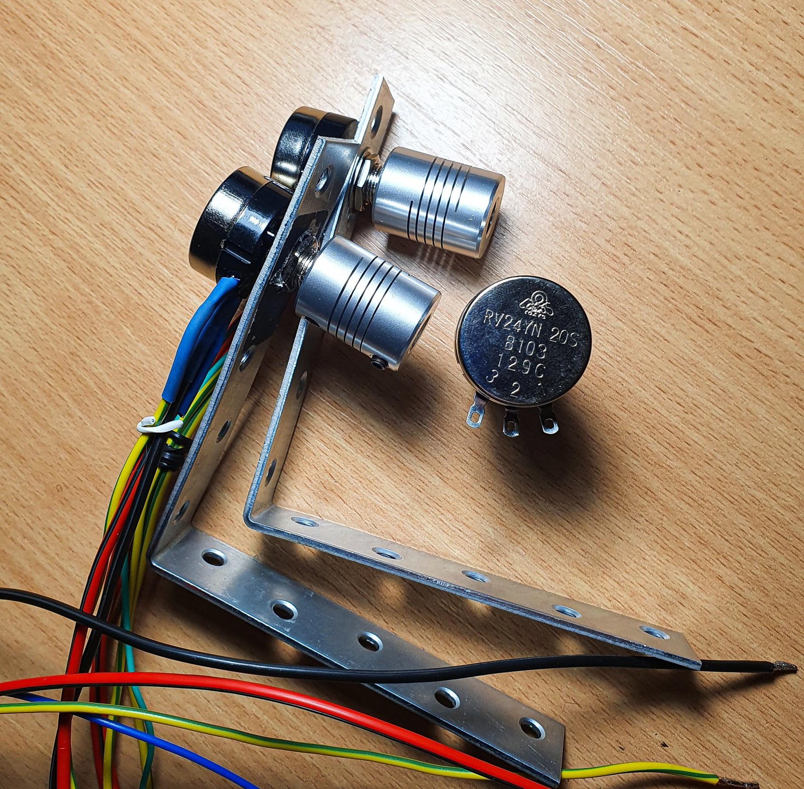

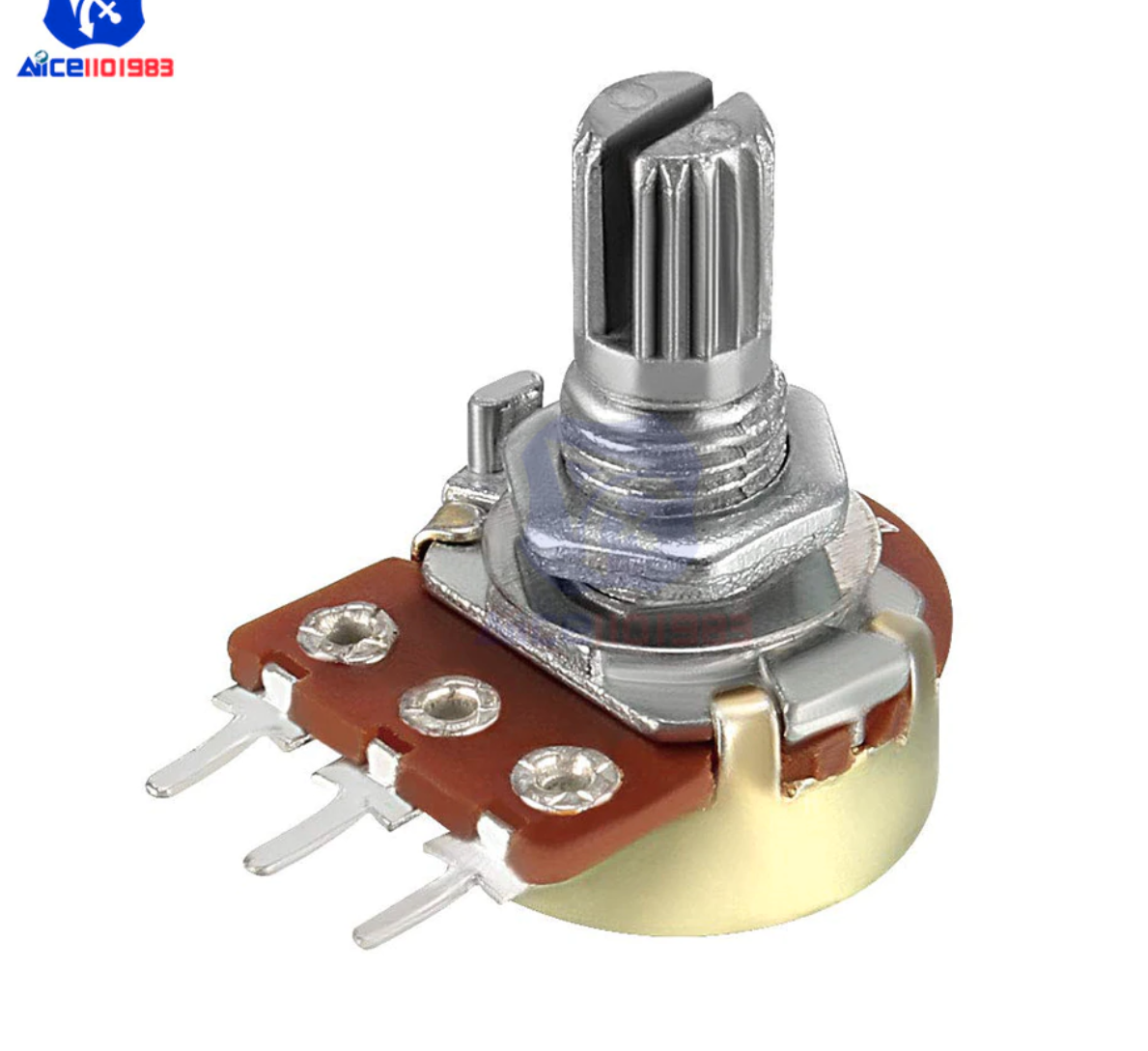

    1. Pre-soldered pots and got them into angles

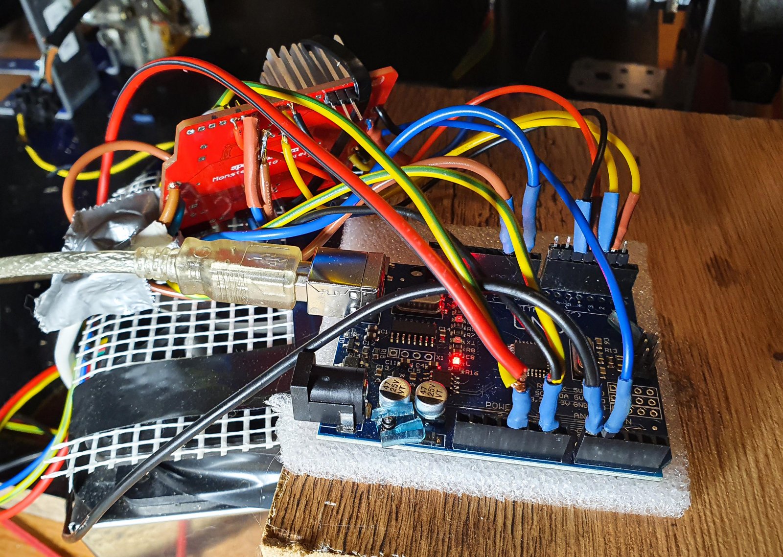

    2. Wired Arduino and MM - uploaded sketch - SMC3
    3. Hard part - wires from arduino kit failed, and I was looking into other stuff while troubleshooting so now I soldered tips to thicker wires,

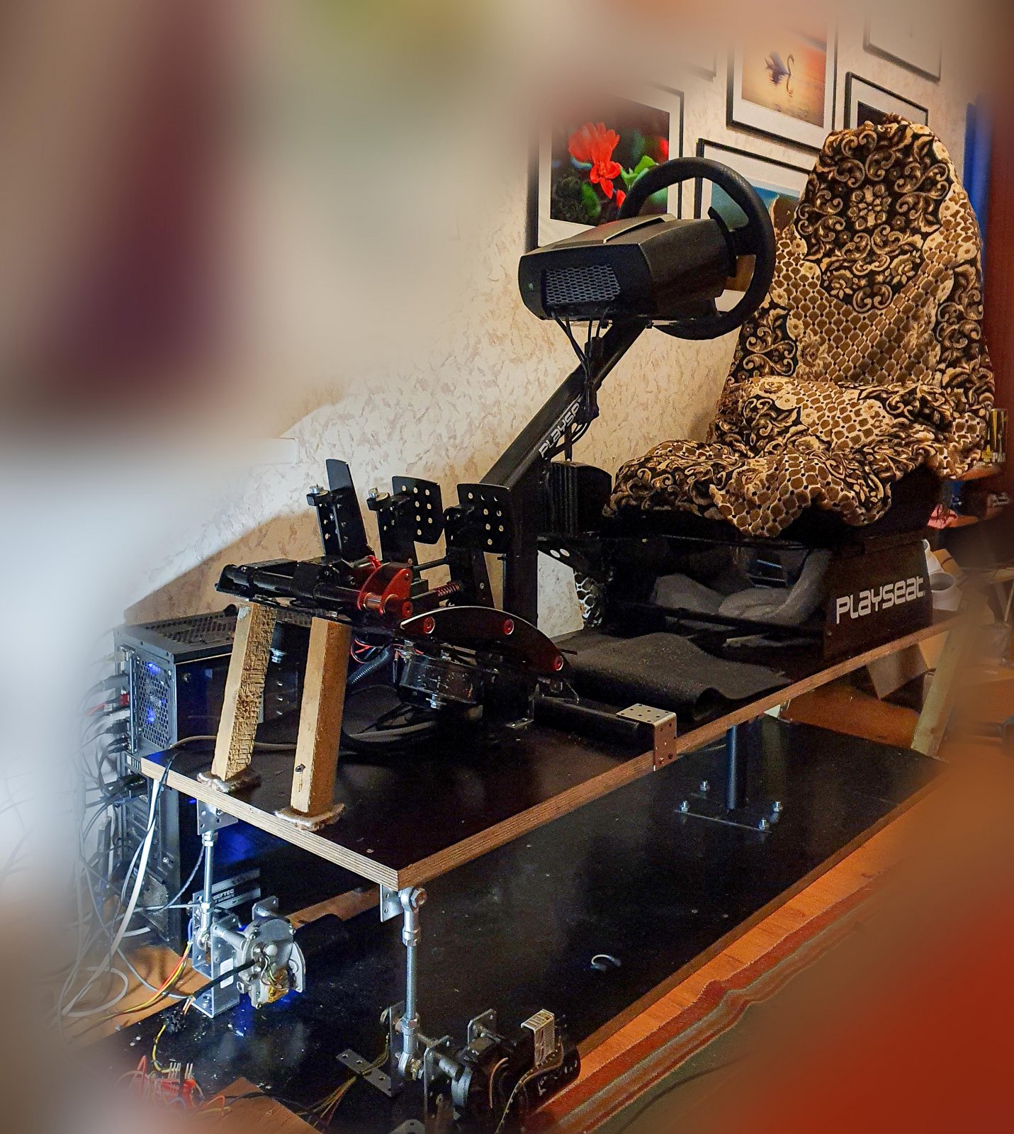

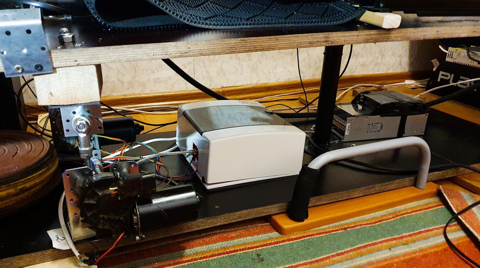

    4. Mounted motors on plywood boards, conected all and also got my playseat on it
    next will be movement tests - now I have everything so chop chop :nerd
    pots_prewired.jpg arduino_mm_wired.jpg mounting.jpg e46_drive_shaft.jpg playseat.jpg seat on.jpg

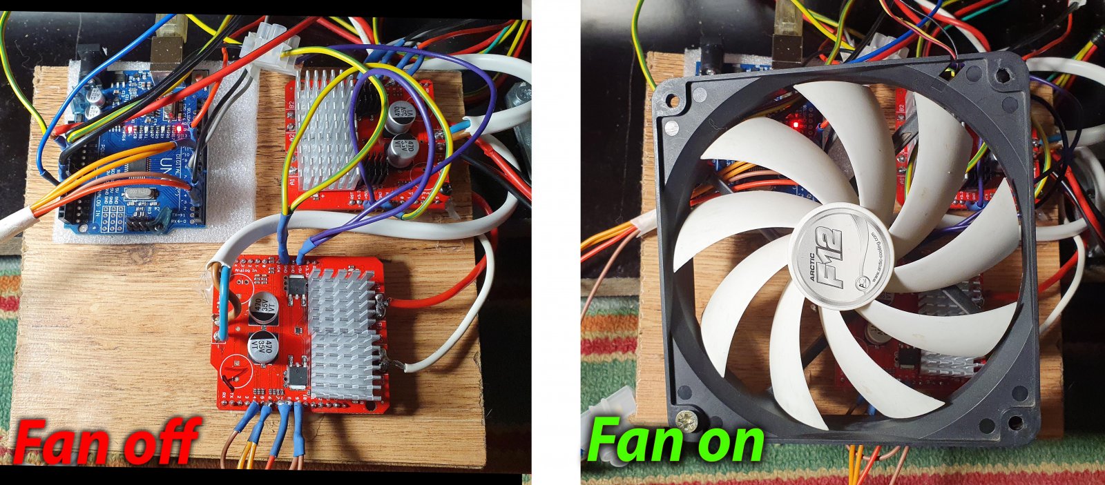

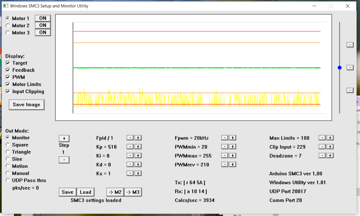

    Part 3 - 21.03.2020 - IT'S ALIVE
    Learned a lot and got lots of ideas to continue
    Got everything together, now I had 2 main issues mainly power to the motors and software tuning.
    Lots of info on MotoMonster bridge wiring thank you! About MM - cooling is a must - had small aluminium blocks on them to begin with but with bridge wiring added fan to keep all cool (without it got hot to touch).

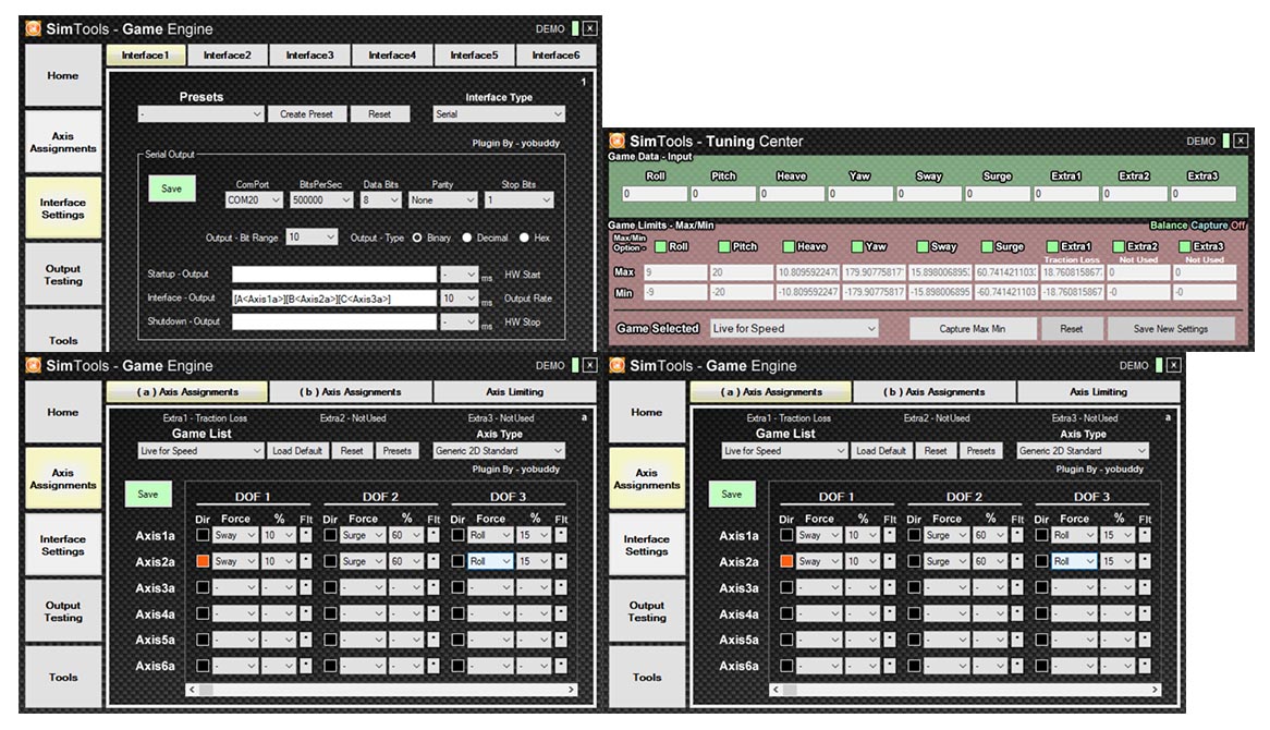

    To get movement I followed SMC3 guide and here are my settings for today (since Im still newbie they change often)
    Once it was done - downloaded Simtools + LFS game, and began motion testing and tuning.
    Sounds cool but it was more like - learning programm, youtube video research, and lots of reading here. At this point this is where I got.(had to learn new words ex. - surge, pitch. added image for fellow no native english speakers )
    At last I have motion video on cam ;) -

    3. I need different pot's, these are too noisy and not that precise.

    Plans for the nearest future - rebuilt it - lower, with less free play, with bigger motors+ traction less capable upgrade path. For now I'm happy I got here, thanks to xsim community, my friend who donated stuff necessery for built and aliexpress:grin

    1. Swapped playeseat to junkyard bmw seat (together with bmw wiper motors build is now complete:grin)
    It seats 20cm lower, so without cutting I got myself lower to reduce my 95kg inertia upstairs.

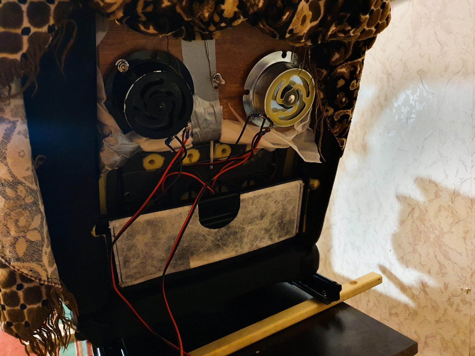

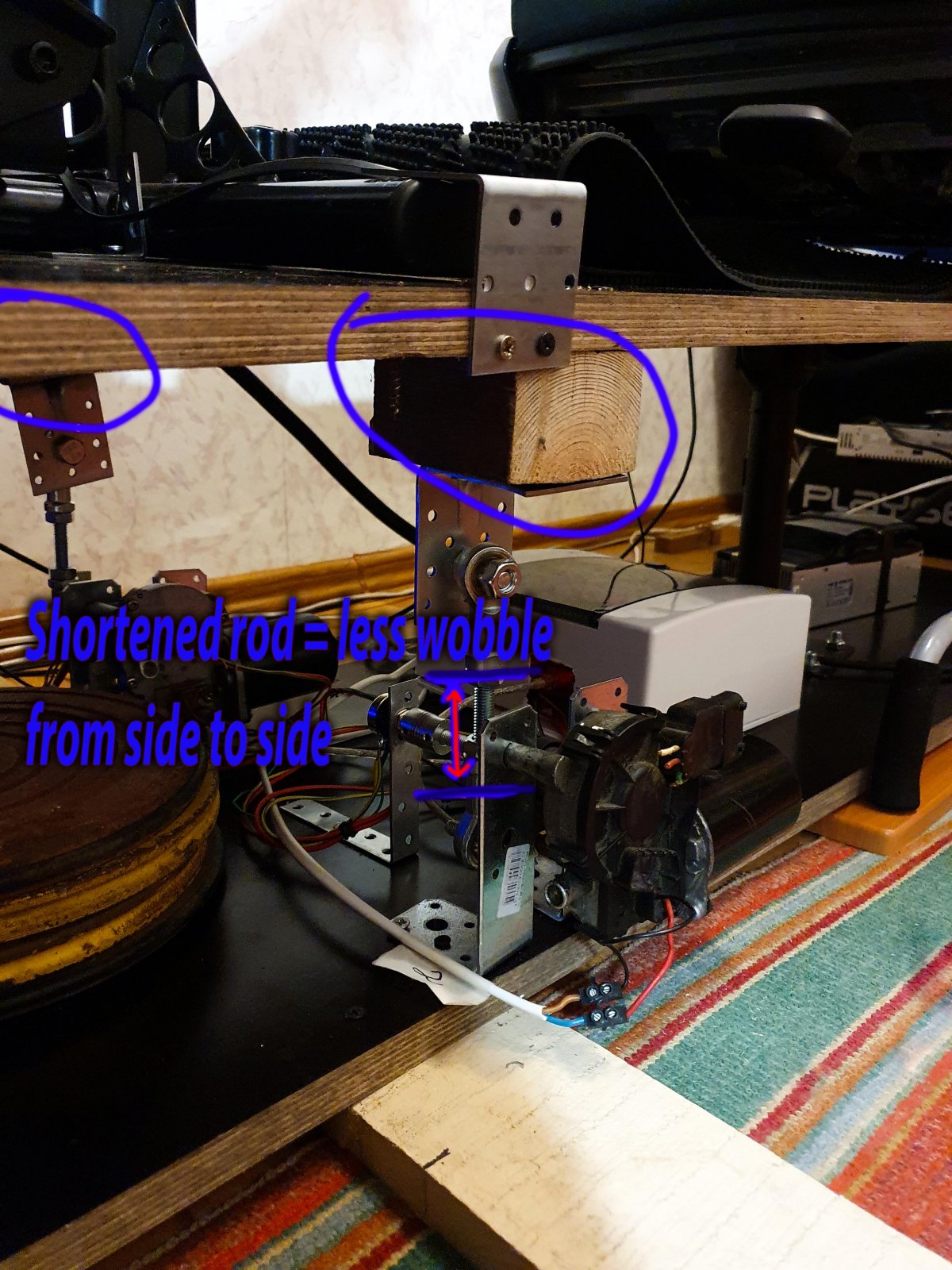

    4. moved base support inward planned to shorten(cut) whole thing to make it more compact, but changed my mind since this is proof of concept and that I can make stuff, I will plan new frame from ground up (obviously borrowing ideas from here)
    5. Added transducers for more immersion on small details.
    All that has been done was really budget friendly I have not spent more than 135e :nerd, lots was given to me for free(motors, wood bases, drive shafte and other) and lots was reused materials from shed. Once I will plan proper frame, playseat will be sold and money moved toward it plan to make it more compact, but for a while will enjoy this one, oh, while I wrote this sentence remembered that two wheelchair motors are incoming soon (+140e for them), so more will be done to this poor frame :eek:

    I can't say it's massive, but it is clear win, main issue now is flex in board itself, I'm wobbling, since seat is moved to the rear to unload wiper motors, but its trade off +/- motors feel better/less precise feedback, overall I'm smiling while race because am getting new feels of track, I must add, Im not quicker since battling motion and training core :D on it, I think new motors and sturdier frame would sort this out.

  15. Rifly
    Rifly Member
    Jan 30, 2020
    55
    freelance photographer
    Latvia
    232Coins
    +24 / 0 / -0

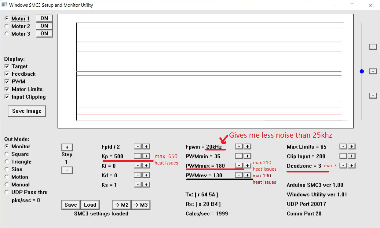

    1. Im more or less there:
    a) my pots are slightly better than the cheapest ones there, so I've set dead-zone to 3
    b) have issues with motor over-heating too much even with fans if I drive them too hard, so at this point I have two ways to help them, in smc3 - look image - safe for me, settings in red are fun but overheat wihout proper fans (1h playtime and jumping back and forth with intensity)
    2 . followed tutorial in smc thread - worked!
    3.
    To give motors easier time in simtools I change 2 things even with these setting it feels crazy, when I set 91% on axis and 100% intensity its definitely fun, but motors heat up too quick and it's harder to drive :confused: safe and normal for me is 80% axis and 20-30% intensity, with proper active cooling you can drive motors harder
    Im still jumping back and forth for fine tuning, tomorrow hopefully will get wheelchair motors, and tuning will begin again :nerd
    P.S. Since you are making seat mover motors will be less stressed and you could drive them harder without same penalty as me.

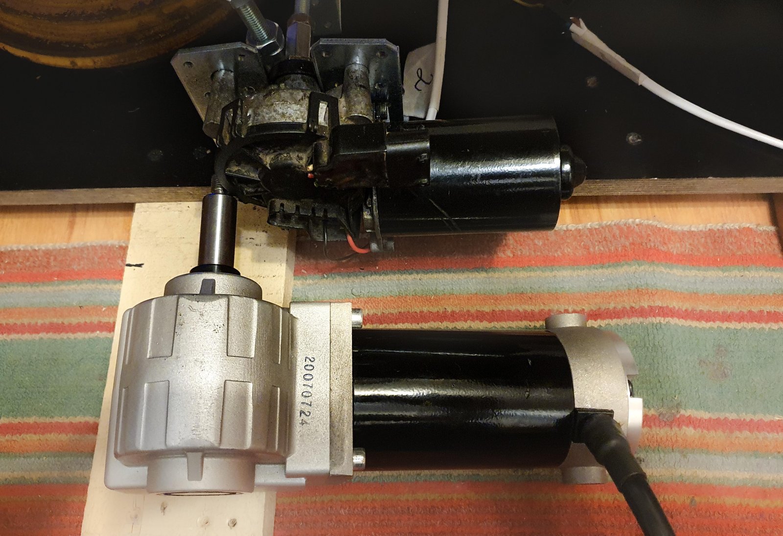

    New motors are here :o:, Saturday they will replace wiper ones, luckily shaft height is the same so it's direct swap.

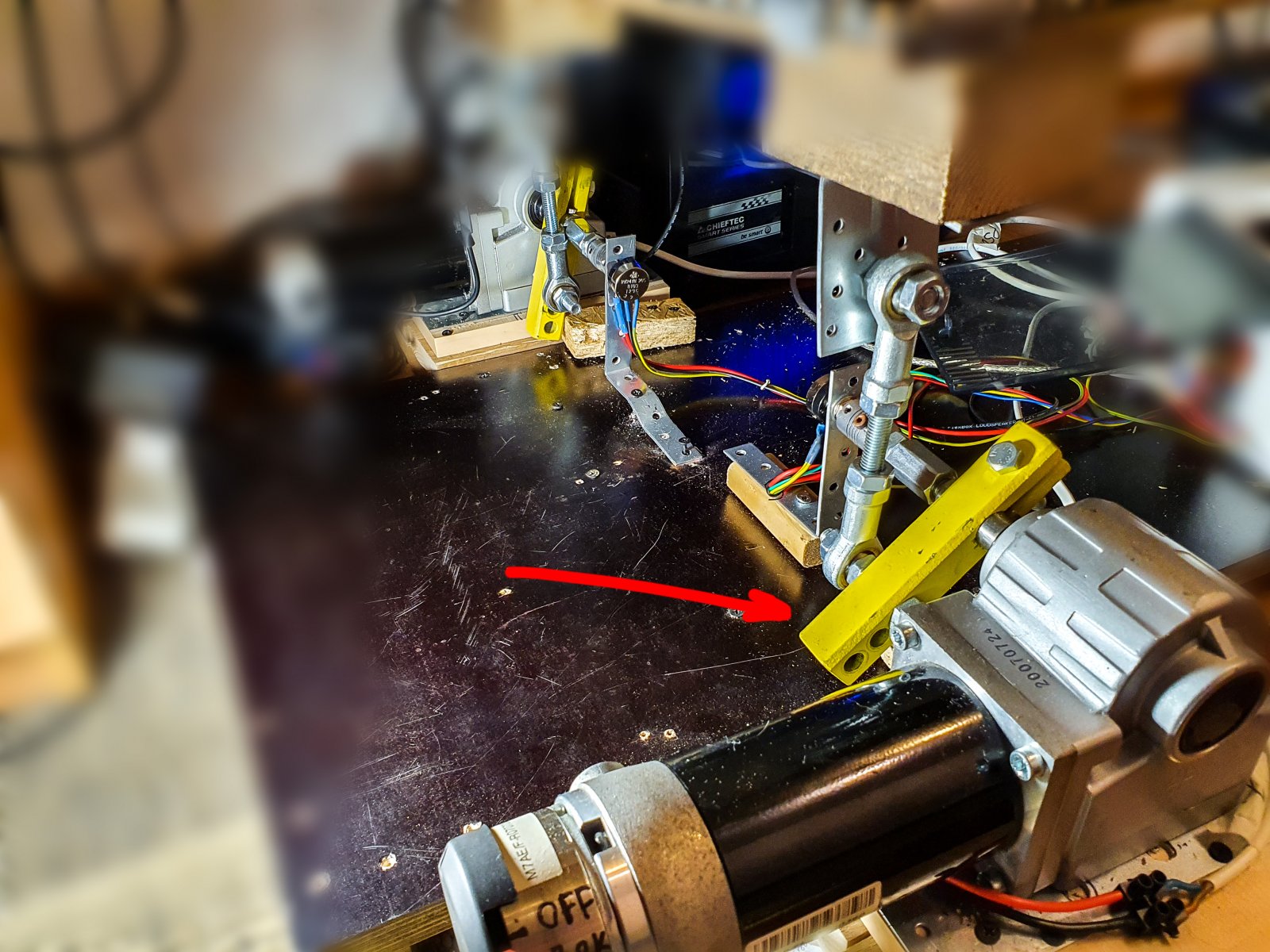

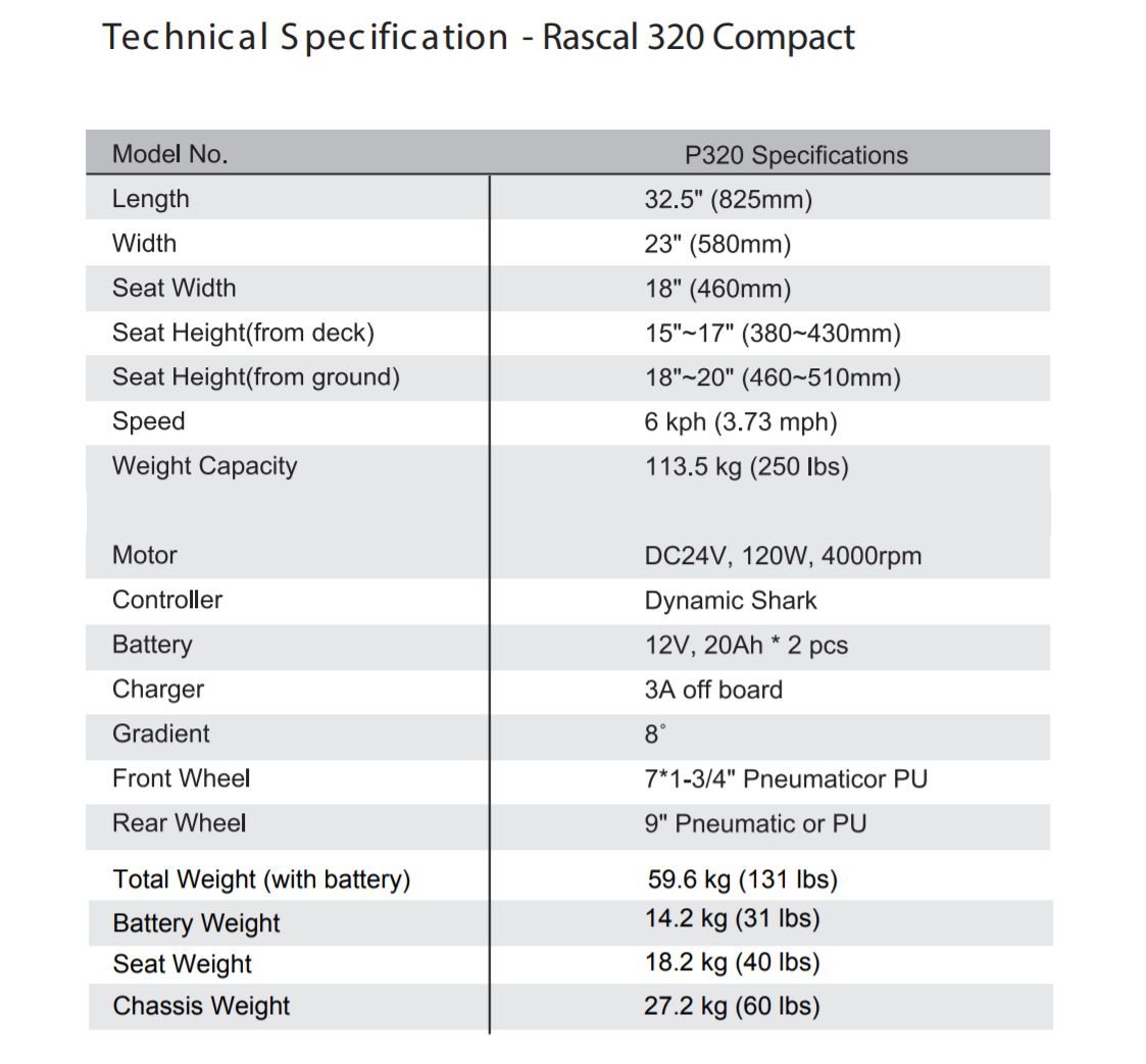

  18. Rifly
    Rifly Member
    Jan 30, 2020
    55
    Latvia
    232Coins
    +24 / 0 / -0

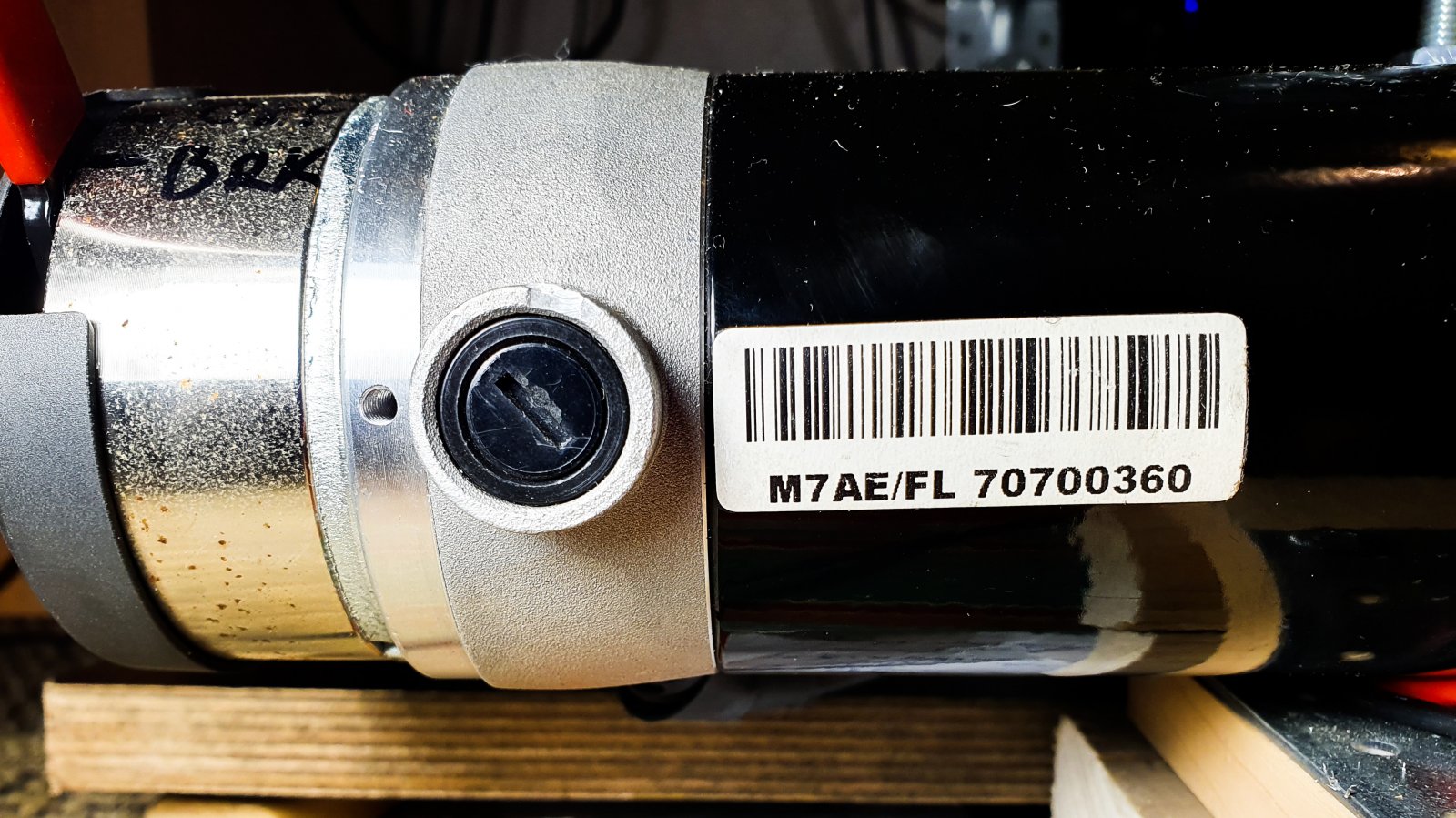

    Got wheel chair motors and it seems they have less torque than wiper motors because they stall after going down. I gave manual load/pressure to check stall current and they fail after resisting just to 5-7v
    What I already did:
    1) Added power in SMC3
    2) Cranked from 13.2 to 14.8v supply voltage to add more juice
    3) Moved motors forward to give leverage
    Edit:

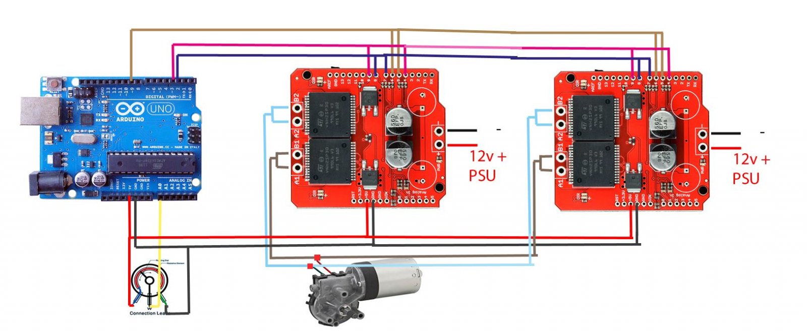

    4) Wired two H-bridged moto monsters to one motor, more resistance but still stalls
    5)
    Separated MM to two different psu - one rated 12v30A other one 12v41A - both cranked to 14.8V
    ^ with 2xMM it is nipier in mid lever settings, but once it drops lower than this (image) it's unable to come back
    Still fail, did get wrong gearboxes on them? Or 1 H-bridged MM can't give enough amps?
    @noorbeast
    All info I could find about motor -
