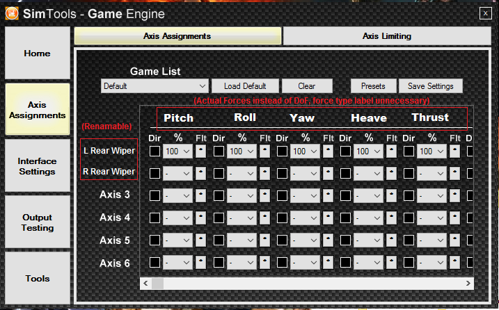

    I am a newbie here, setting up from scratch, and I can't quite wrap my head around the axis assignments screen. I read the manual repeatedly, and maybe I am just stupid, but as far as I can glean, the 'DOF 1-6' are the *actual* 6 degrees of force, and the 'axis' are not actually axis at all, but *actuators* to provide 1 (or more) of the DoF?
    (If this is true):
    Why the hell are they labelled DoF1, DoF2, etc? Why wouldn't they be named to the *actual* DoF (pitch, thrust, etc)? Is there any benefit to them being arbitrary, or does this just add confusion for confusion's sake?
    If there is no benefit, it would be MUCH more comprehensible to name them the actual DoF.

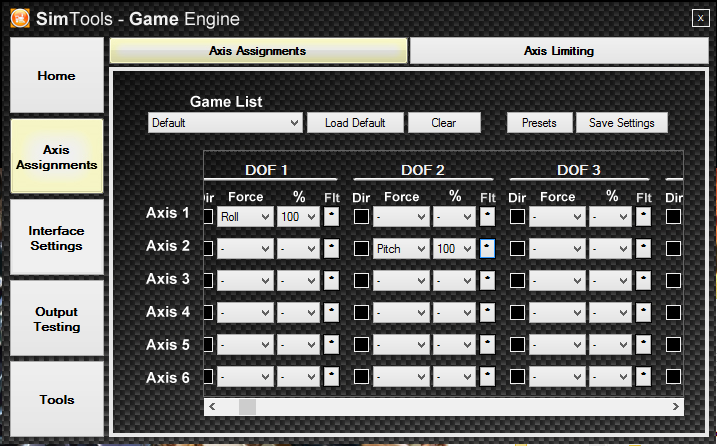

    I have Rock N Ride, 2 DoF, where a single actuator controls a single DoF. Is the attached picture correct?
    Thanks in advance!

    You can assign up to 6 DOF's per Axis.
    So in your pic axis 1 is assigned to roll as 100% and axis 2 is assigned to pitch at 100%.
    I suggest you load a couple of the presets to take a look at what's going on.

    Hi @yobuddy, thank you for your response!
    So an axis is in fact an "acuator" then?
    I checked out the presets, but it didn't help. For example, the preset for rock n ride (which I own) set an axis for heave and sway (of which the sim does neither) and put them BOTH under DoF 1...which didn't make sense.
    The example in the user manual seemed to make sense, and verify what I think:
    1) That DoF 1-6 ARE roll, pitch,yaw,etc. and are named arbitrarily for no apparent reason
    2) The axis are actuators and their actions can cause any combination of DoF by construction/combination.
    This http://www.xsimulator.net/community/threads/6dof-preset.5800/ 6 DoF proile seems to confirm it as well, just want to be sure.
    Why are DoF 1-6 not named specifically?
    Thanks!!

    what are you intending to build? 2DOF?
    Axis one and two represent the motors on a 2 DOF. You would need to test each to get the motors moving right, hence highlighting one of the boxes or both, or none at all.
    Each DOF is what you set to the axis' talked about, so axis 1 and 2 would, for example, use pitch, then DOF2 roll, DOF3, sway, DOF4 surge, DOF 5 heave. It doesn not have to be exactly like that, I am only giving an example.

    @Keroppi, you can only use 6 DOF's per axis, of which a plugin can have up to 9 DOF's.
    what your suggesting is to have all 9 dof's listed at the top, but only let the user select 6 of them?
    So every time the user selects 6 DOF's from a given axis row, the rest of the DOF's for that AXIS would need to disable themselves.
    To me this just causes a bigger GUI and some confusion.
    This is why I choose to do it the way I did.
    Also, about the AXIS naming;
    You assign an Axis output in the interface section, so leaving them named as Axis1 thru 6 only makes sense to me.
    As you use <Axis1> to output axis 1 data from a given interface and so on...
    I hope than makes sense?
    also keep in mind that with a 2dof simulator (a seat mover) the user would use sway and surge to run the simulator.
    As the user wants to ride the G-Forces of the game. Roll and Pitch would just tip the chair with the car in the game.
    take care!

    Hi @yobuddy
    No, I was recommending to have the same exact 6 DoF listed at the top, same as it currently is, simply renamed to the actual 6 DoF names. The "extra" 3 DoF the plug in provides are not set here and still wouldn't be. To my understanding, when a user sets up their profile, they arbitrarity assign DoF 1 as "pitch" for example, then underneath it they assign every axis (actuator) that assists in pitch force the pitch DoF in the dropdown. If they make DoF 2 to be "heave" they would do the same, rinse repeat for all DoF used. No deselecting of anything. I was not using the actual assignments in the example pic at all, i did not set them, just the labels I has showing.
    My recommendation was simply to preassign the DoF name and pre-select that force, which every example I have seen is the same, am I missing something?
    I understand an axis is set to interface #(x)...but to be able to name them is simply a convenience...to easily remember which actual motor/actuator the user has assigned to axis 1-6.
    I also understand the you can assign any axis to assist in any forces, but in the case of rock n ride chair, the only literal movement is pitch and roll. "Just tip the chair".. that's all the chair LITERALLY does. Seems much made for flight sims, which use less heave/sway/thrust..
  10. Keroppi
    Keroppi New Member
    May 28, 2013
    16
    USA
    - 129Coins
    2DOF, Motion platform, 4DOF
    @yobuddy
    ...unless the case that I am not understanding something. But this is the most elaborate preset I have seen, it is all 6 DoF, and 6 axis/motot, made by user vulbas:
    ...and I seen many other presets like this one. User decides which DoF 1-6 equals and then has to assign that force. Under every DoF is the same force assigned for the actuators that assist in that force.
    So my idea would be like the example: DoF 1 pre-named Roll, 2=Pitch, 3=Heave, etc. Why would it be beneficial to assign this all manually?
    You are obviously much more intelligent in this than me, so it makes me feel like there is a good reason NOT to do this, and that I am missing something fundamental (that should be super obvious to me,) so I want to understand!
    The axis label still makes sense to me. Totally not necessary, but I can see no reason it wouldn't be helpful.
