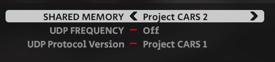

    After installing the Plugins and manually patching the game, the UDP Protocol version you can change to Project cars 2,
    You need to open the tuning tab in sim tools follow this linked it helped me
    chrome-extension://efaidnbmnnnibpcajpcglclefindmkaj/viewer.html?pdfurl=https%3A%2F%2Fsimtools.us%2Fwp-content%2Fuploads%2F2018%2F05%2FTuning-Center.pdf&clen=1137472&chunk=true
    let me know how you went.

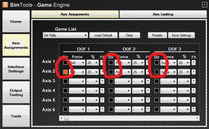

    looks like you are going in the correct direction, you need to check if the outputs to the Motors are not reversed, on my Sim when i steered to the right the g-force would be on the Right and when steering to the Left the g-force would be on the Left, that is where the issue is, so i had to set individually set the rotation direction InkedAxis Assignment - DirtRally VR SeatMover V-3 SimTools Page 1_LI.jpg
    Copy and paste the below to a Google chrome browser
    let me know how you go

    Hi SunTzu when you are going up hill check the tilt of the rig if it is re-versed then you need to change the Dir section for pitch or increase it need to check that if you go up the hill it needs to tilt back wards if you go down hill it needs to tilt forwards, let me know how you go

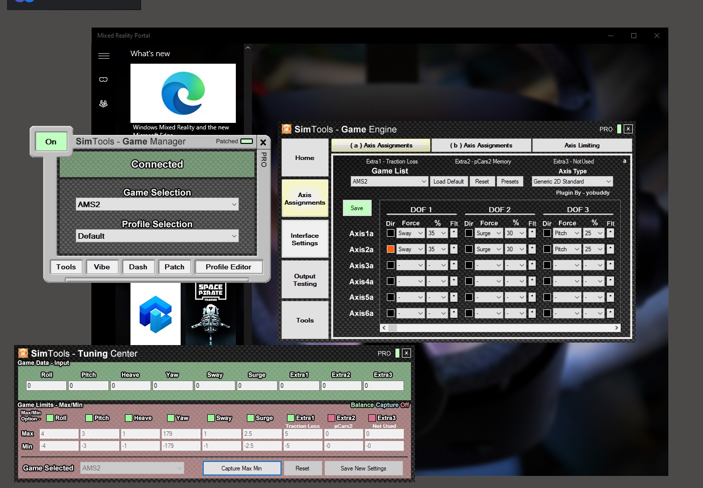

    hi men is it possible too tell me what i did wrong ?
    these are my settings right now.
  15. Salvatore21872
    Salvatore21872 New Member Gold Contributor
    Sep 8, 2021
    24
    Technician
    Australia
    - 90Coins
    +10 / 0 / -0
    Hi send me a photo of the rig the way the motors are used
    And try to change the direction of pitch
    I can’t see the settings for roll and heave
