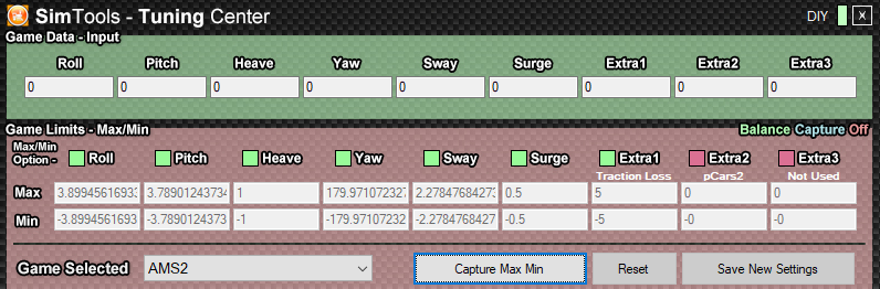

  2. Grand Strate
    Grand Strate New Member
    Feb 13, 2020
    16
    - 45Coins
    +3 / 1 / -0
    Hi. Thanks for your advices. I have set the min and max parameters in the tuning center and it works. Thanks again, this game is awesome in dynamics.

    - 57Coins
    Any examples of decent tuning center values?

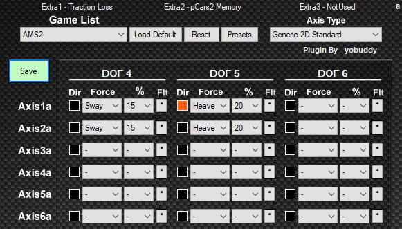

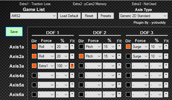

    Hi Guys,
    I just setup the profile for this game but after hours fiddling around i still have three issues that baffle me!
    First one is that i had to reverse/tick the DIR option is axis assignments for Extra1 (Traction Loss) as it was drifting in the worng direction. All other games don't require this. Its not much of an issue as its working but still confuses me as to why its so - only in this game!
    The one that is REALLY annoying me is that the game seems to register accelleration etc as surge as opposed to pitch, so if i reduce the numbers for surge in tuning center - to feel the gear shift i end up with the rig pointing upwards, irrelevant of what i set in pitch.
    I have confirmed this with output testing because as soon as i press on the gas, surge shoots up, in other games its mainly pitch which responds. Due to this i cant find a good balance where i can get the surge when shifting gears and at the same time not look at the ceiling when i press the gas :)
    The third issue is that heave does not really have any fine details at all.... if i crash or go over a bump i feel them perfectly but detail in tarmac and apexes is not really noticable.
    Would apriciate if you could let me know how you got around this and if it was an issue with your profile as well.
    Settings below:
    22,184
    154,726Coins
    +11,194 / 57 / -2
    It is normal to use surge to simulate acceleration and braking on a 2DOF and pitch to simulate going up and down hills, though both do use the same axis SimTools mixes them on the fly.

  6. GWiz
    GWiz Active Member
    May 12, 2019
    191
    Dentist
    Aberdeenshire, Scotland
    1,510Coins
    +124 / 0 / -0
    To get more detail with heave, you can adjust the tuning center heave values to less than 1, i.e. try 0.5. Use this in conjunction with the SimTools percentages to get a good feel with out rattling out your teeth.
    Alternatively, raising the percentages will allow you to get fine detail for the tarmac and a bigger movement in a crash or cutting over a kerb. (You may still need to lower the Tuning center value a little). This will cause motion clipping in a crash, but that's OK.

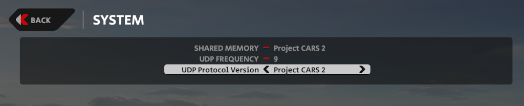

    hello, i can't make it work the plugin pcars 2 udppc and pcars 2 2.0.5.4 for ams 2, i have try several attempt with several options system in ams 2, but it dosen't work.
    what to do for work, sorry for my english, thanks.
  16. noorbeast
    22,184
    154,726Coins
    +11,194 / 57 / -2
    Have you completed all the required configuration:
    How to activate AMS2 telemetry output:
    ❉ In steam add the launch option "-ui:pcars" this will allow you to enable UDP and SharedMemory. Its using the exact same data output as PCars2 for shared memory.
    ❉ once you have enabled shared memory in the system setting using the pcars ui you can then delete -ui: pcars from the launch options in steam to return to the AMS2 ui
    ❉ Also the max min settings in the Tuning Center.

    I added the option in steam>library>property>general> launch options>-u i : p c a r s
    but dosen't work.
    must it also launch pcars 2 for enabled shared memory in the system setting using the pcars 2 for it work ? because i have delete it.
  18. franckk06
    franckk06 New Member
    May 21, 2018
    16
    france
    213Coins
    ok, i find one solution but is not the best... it work with ams 2 only if i use in the same time pcars 2.
    Anyone have anohter solution please, thanks.

    brasil
    649Coins
    +165 / 2 / -0
    added some info for people who wants to be run AMS2 with movements: just copy exactly same min max of project cars 2 and put manually. ok i dont know why my pic dont upload. right, values: 10 -10, 10 -10, 1 -1, 180 -180, 2 -2, 10 -10, 8 -8. cheers.
