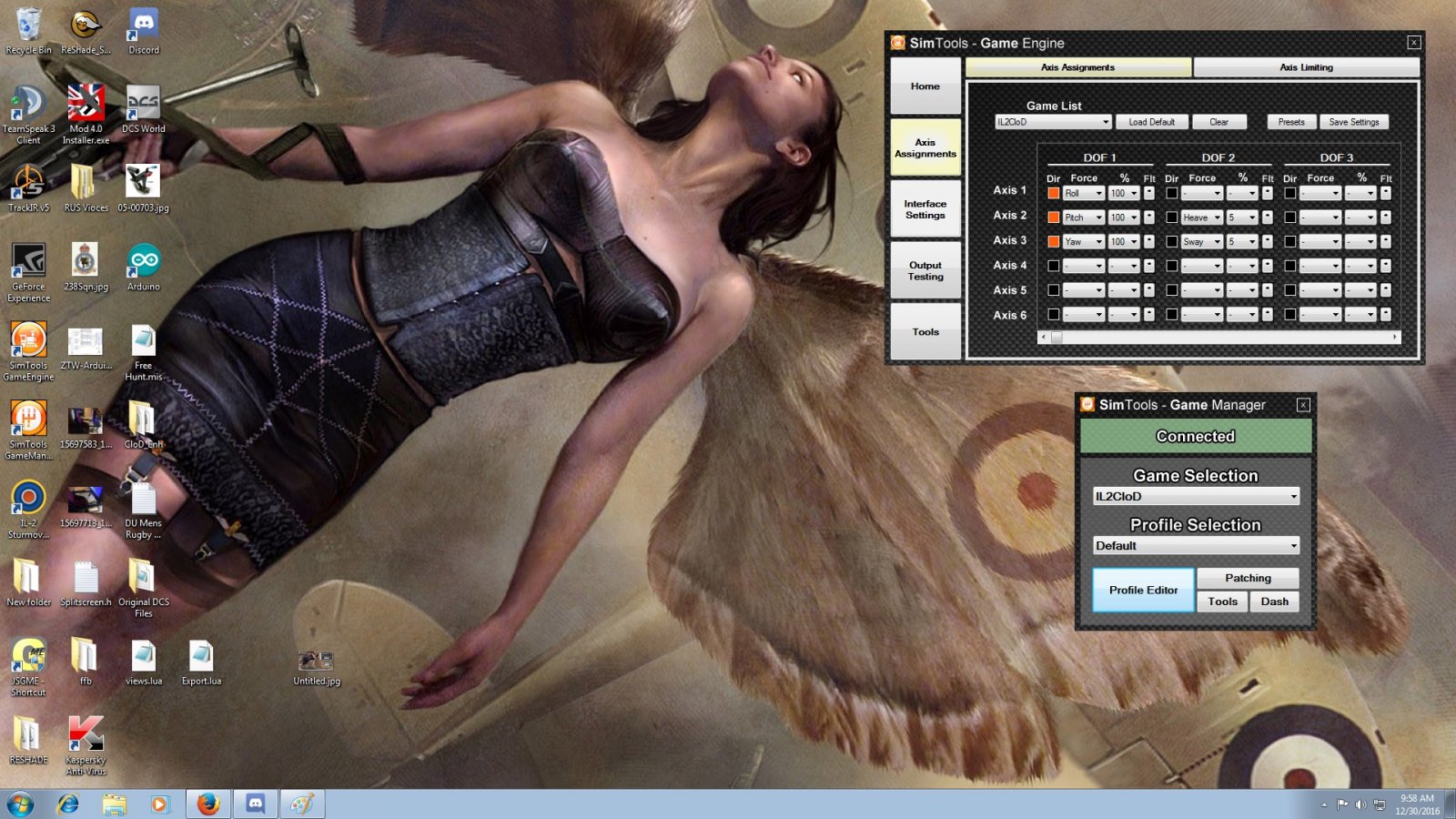

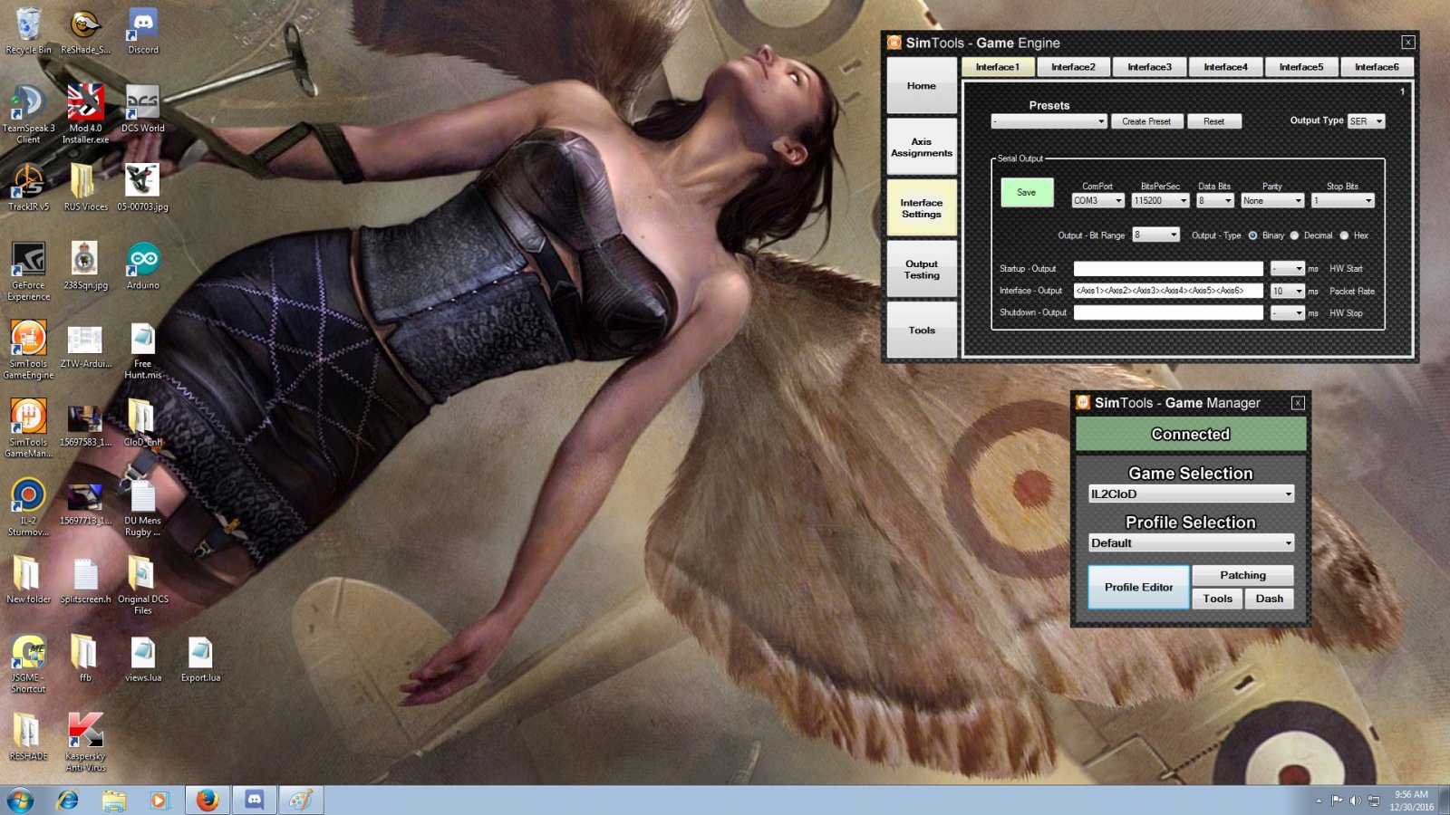

    Ok been awhile since I posted and went the audrino route but in axis virtual with just the board connect I am not seeing any axis's move. say game is connected.

    You need all the hardware connected and I really don't understand your configuration. Your Interface is set up for 6 axis but you are only using 3 in the Axis Assignment.
    Has COD been patched for motion and if so to what patch?

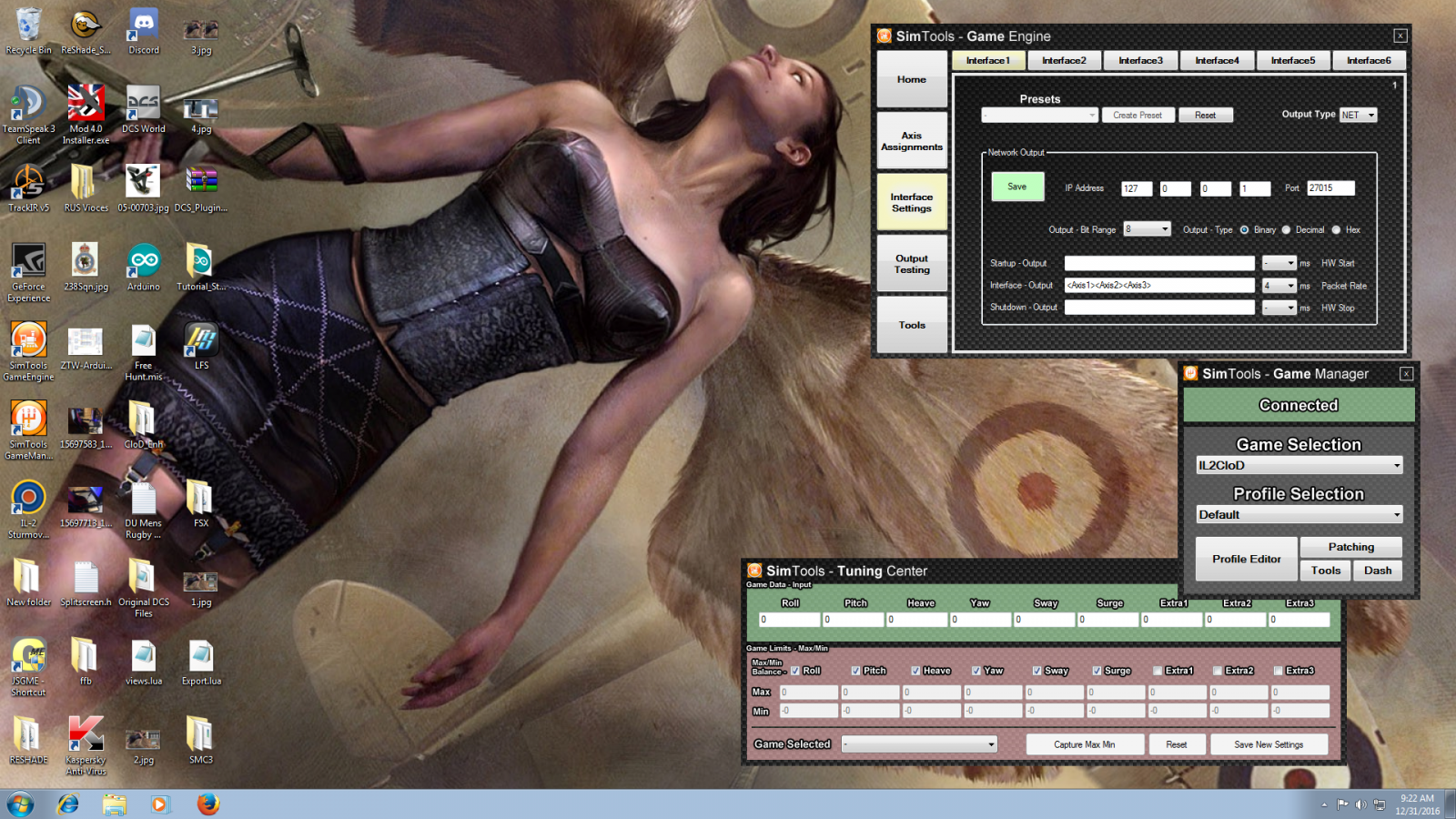

    Ok I am struggling here to even test the virtual axis it is turned on and the game manager says the game is running but still no luck. I hook the Audrino to the MB so that it would read the com port and nothing. Tried the live for speed walk through and could not get that on rolling under net. Not sure if 127.0.0.1 and the port is correct. Will try again today but I tried Cliffs of Dover and put in the port on the config file and noting their either. Any help would be greatly appreciated. all my motor controlers get here to run the steppers next week and I would like the game at least connected to the software and showing the movement under Virtual axis.

    What needs to go into the Interface Settings to test the Virtual Axis's?

    The LFS settings for use without a simulator specifically state to use the settings as described, which means Output Type has to be SER, not Net: https://www.xsimulator.net/community/threads/game-engine-exceptions.7080/#post-82208
